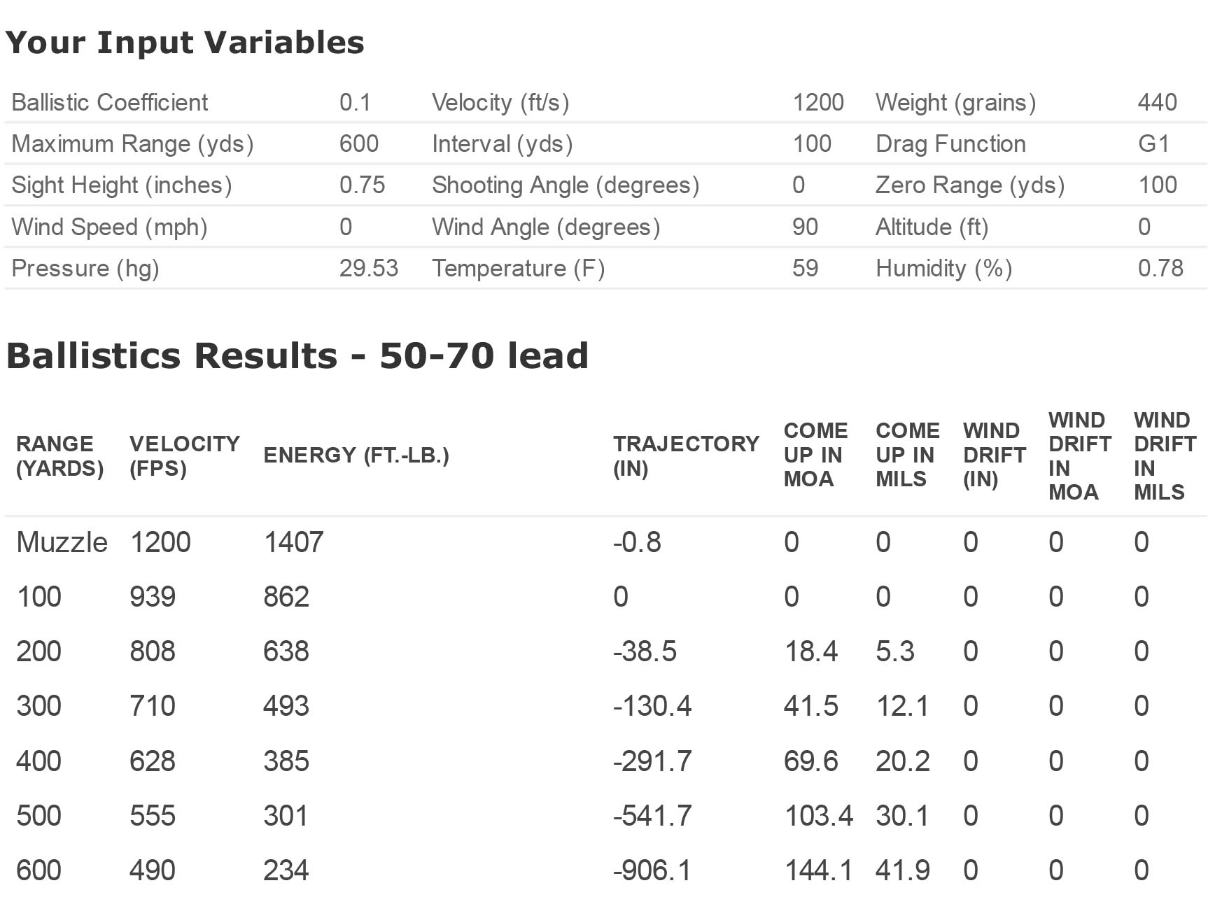

Could be wrong, but 0.317 doesn't seem right to me - that's SP bullet territory isn't it?
With a g1 bc of 0.1 (not too dissimilar to match 22lr), here's what I came up with:

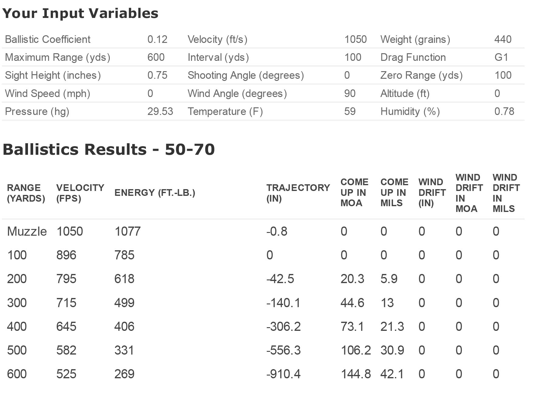

Here you go: "BC changes with the shape of the bullet and the speed at which the bullet is traveling, while sectional density does not." source http://www.chuckhawks.com/bc.htm I take it they are referring to muzzle velocity here. I was under the impression the coefficient calculation itself indeed factors in bullet slowdown, but the actual starting BC value that you feed in should ideally change based on MV. Not so much of a concern for unchanging target loads (or surplus ammo); the BC is pretty constant up that end of the spectrum, but becomes more of a factor down the low end. Again I might be wrong though... if so, flame on
Anyways getting back to OP, how about this ND:
Slightly higher BC with the lowered velocity. Do you have any more data ND? Any recorded drop for other distances? Also, how about sight height?
