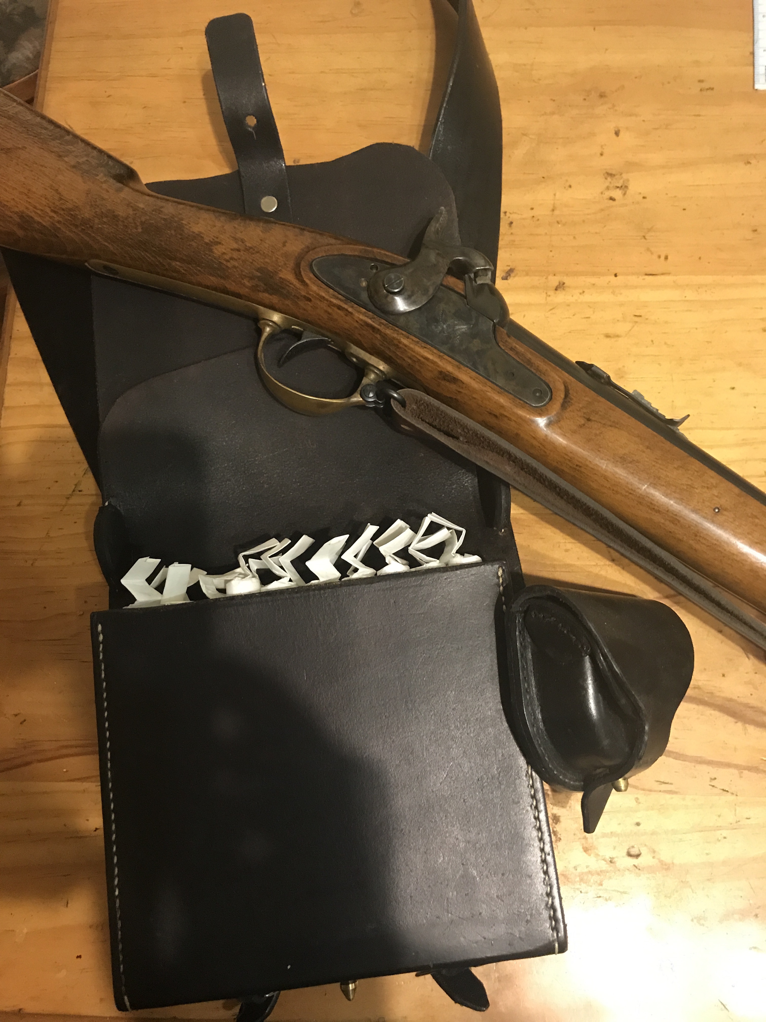

This weekend is The Seymour Black Powder Club's AGM weekend with a bunch of once a year events including the "Military Walk Up"
Its 5 rounds at each distance and fired from 150, 100, 50 yards off hand so I've been making paper cartridges for my .58 cal 1863 Remington aka "Zouave".
The leather cartridge bag (and cap box) is my own effort and holds 40 rounds.
The cartridge is a 530 grain pure, soft lead Minnie from an RCBS mold and lubed with a good slathering of 50/50 beeswax and bacon lard, 60 grains 2F powder. This load will put ten shots in 6" circle at 50 yards off a bench. Fingers and eyes crossed for a good score :-)

Don't know yet. I've just st fitted it's 4th rear sight. This one is the he best so far. It's normally shot up to 80 yards and previous rear sights required a 6 o'clock hold under the target board to get a hole in the paper at the top of the 2' standard target. Now I can aim at the bottom of the black centre circle.
I was going to try it at 150 last week nd at Noisy Ranch but guess who left the lead home?

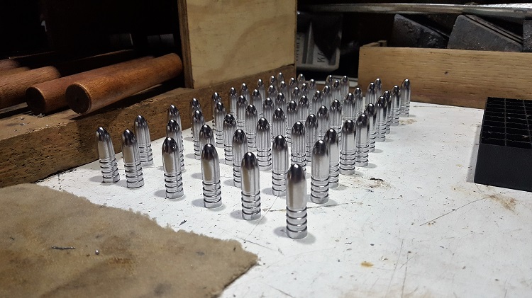

Here are some "soldiers" ready to go and do their bit!
440 gr of 20:1 set to be loaded on top of 70gr of 2F black-powder in the .40-70 Sharps and sent down range @ Cooyal this week-end.

It is the ratio of Lead:tin. The tin in the mix hardens the lead up, ( also makes it shinier, but that is not why it is used ).
The shine is also the result of having high quality molds and the right temperature of lead and mold.
Too high a temperature will cause "frosting" which is instantly duller.

If the metal you have is indeed "printers metal", it should be linotype. It should have a BHN of 22. Pure lead is 5. Lead wheel weights are usually 95.5% lead, .5% tin and 4% antimony with a BHN of 9. Mixes with antimony should be avoided in black-powder rifles due to the fact that they tend to "lead" the bore.
If it has a BHN of only 8 it would certainly be soft enough, I would be casting a few up to see how they go before going overboard.
