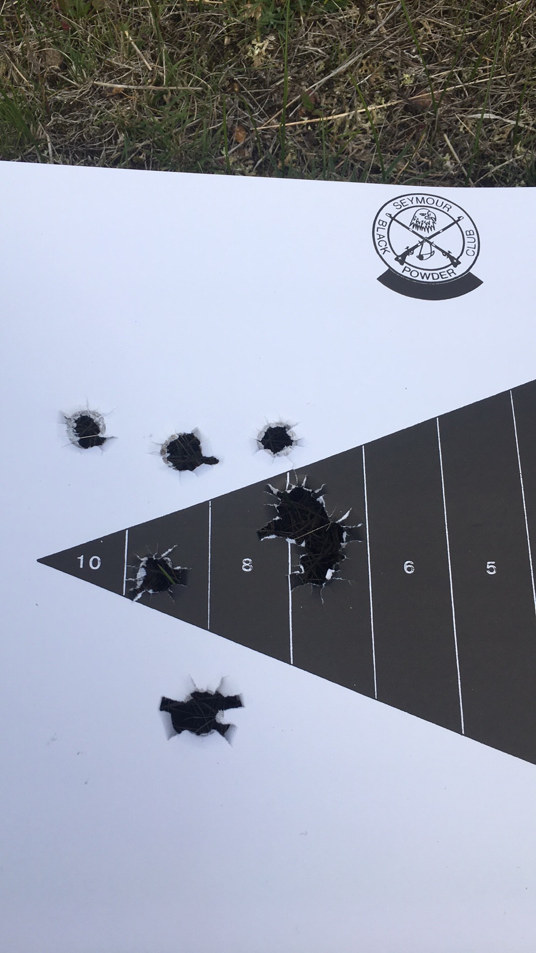

How accurate can a round ball muzzle loader be? This 1/8th target has ten shots in it! Shot off hand at 30 yards. The standard target is shot off had at 50 yards.

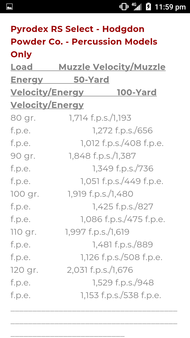

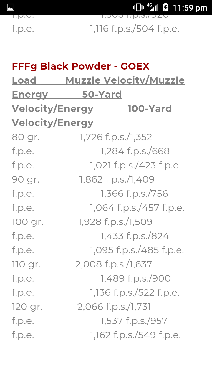

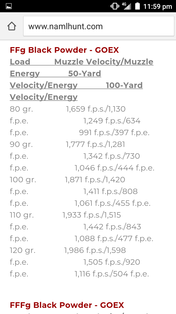

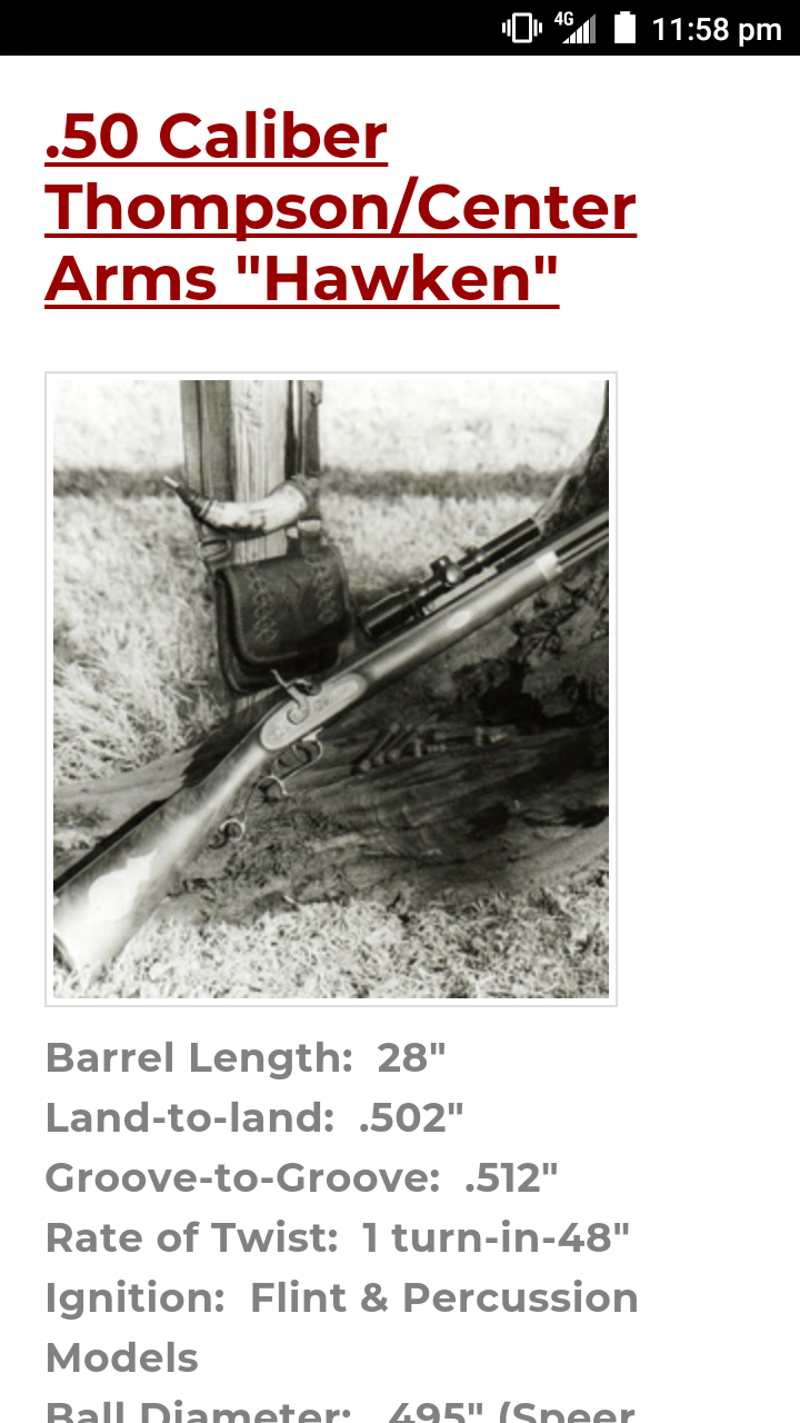

Here's some load data from the North American muzzle loading page just to give you an idea of velocities and stuff

Yeah,they go through a bit lol.

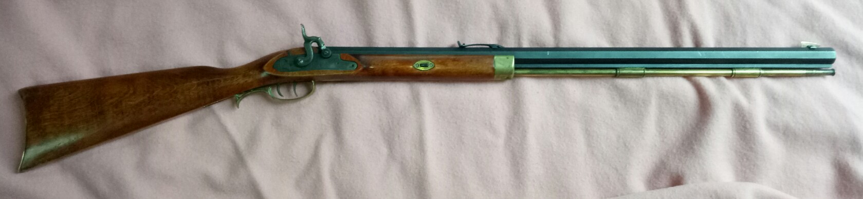

Here it is.

Very nice old bloke

Yeah, it has a few dings but otherwise looks in good nick.
I just need to buy some fff powder and a few bits and bobs. Then I can give it a crack, time permitting.

Dont know about any dings taking away from it mate. a very nice looking rifle. The oct barrel really makes it in the looks, some real body to it. nice :thumbsup:

Apart from the rear sight and lack of a patch box that's a dead ringer for my hawken

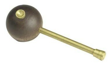

I do need one of these, but I might just make one. Seem a bit hard to get, admittedly I've only looked on eBay . If you buy from the US the mailing costs go through the roof.
