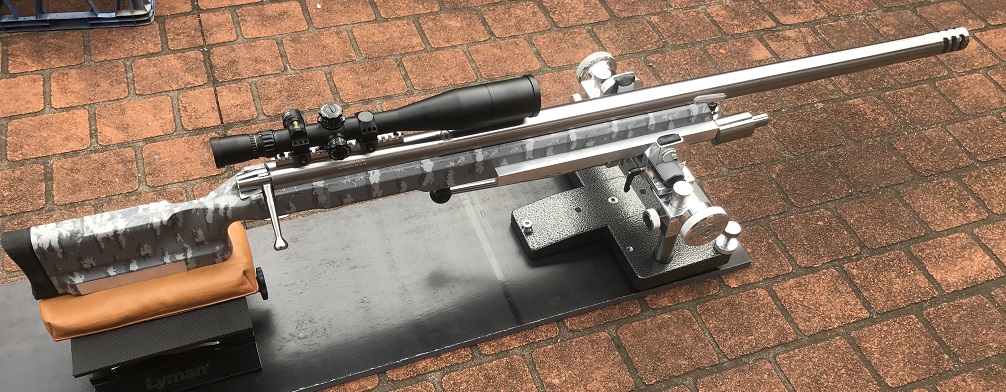

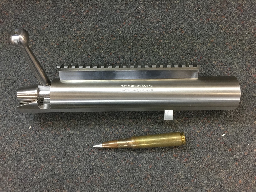

The slickest actions I have seen are made by BAT Machine, as others have suggested microslick may improve the feel of your Howa. Several factory's including Sako use this coating on some bolts. Also try a little grease behind each locking lug on your bolt before you go shooting. Some grease in the action raceway will also help.

Re: Lapping your Bolt??
Post by brett1868 » 09 May 2018, 10:18 pm
SCJ429 wrote:The slickest actions I have seen are made by BAT Machine, as others have suggested microslick may improve the feel of your Howa. Several factory's including Sako use this coating on some bolts.
New Zealand gunsmith Nathan Foster provides detailed information regarding bolt lapping and many other things. His web address is at Terminal Ballistics Research. I have found his publications enlightened and practical.
I'll 2nd that comment about BAT Machine actions....I'm yet to find anything close to how smooth this thing is.
Post by SCJ429 » 11 May 2018, 10:35 pm
Very nice Brett, one day I too will own one. What are you building with this one?
Post by brett1868 » 12 May 2018, 9:36 pm
SCJ429 wrote:Very nice Brett, one day I too will own one. What are you building with this one?
Already built and taking trophy's :)
Post by sungazer » 13 May 2018, 8:47 am
Is the break removable Brett?
Post by brett1868 » 13 May 2018, 12:12 pm
sungazer wrote:Is the break removable Brett?
The brake is screwed on and can be removed though I've no reason to do so. It's big enough that I can clean the insides without any grief :)
