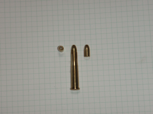

Post by Gaznazdiak » 12 Jun 2018, 12:45 pm
This is possibly another stupid question but WTF?
I was recently given a pile of .22WMR ammo for which I have no use, not owning a .22mag, I toyed with the idea of getting one but it would entail a new safe or getting rid of one of my current line up, neither of which I'm up for.
Yesterday I popped one of the projectiles out of one and measured it, it was .2225" and 39.9gn, which got me to wondering, can I load them into a .223 case and use them on rabbits?
I couldn't easily get one into a freshly washed, trimmed and sized .223 case by hand but my worry was, would they engage the lands enough to be accurate? They are only 1.4mm shorter than 35gn Vmax but the diameter worries me.
Has anyone tried this, I have 116 of them and thought it might be a way of putting them to use.

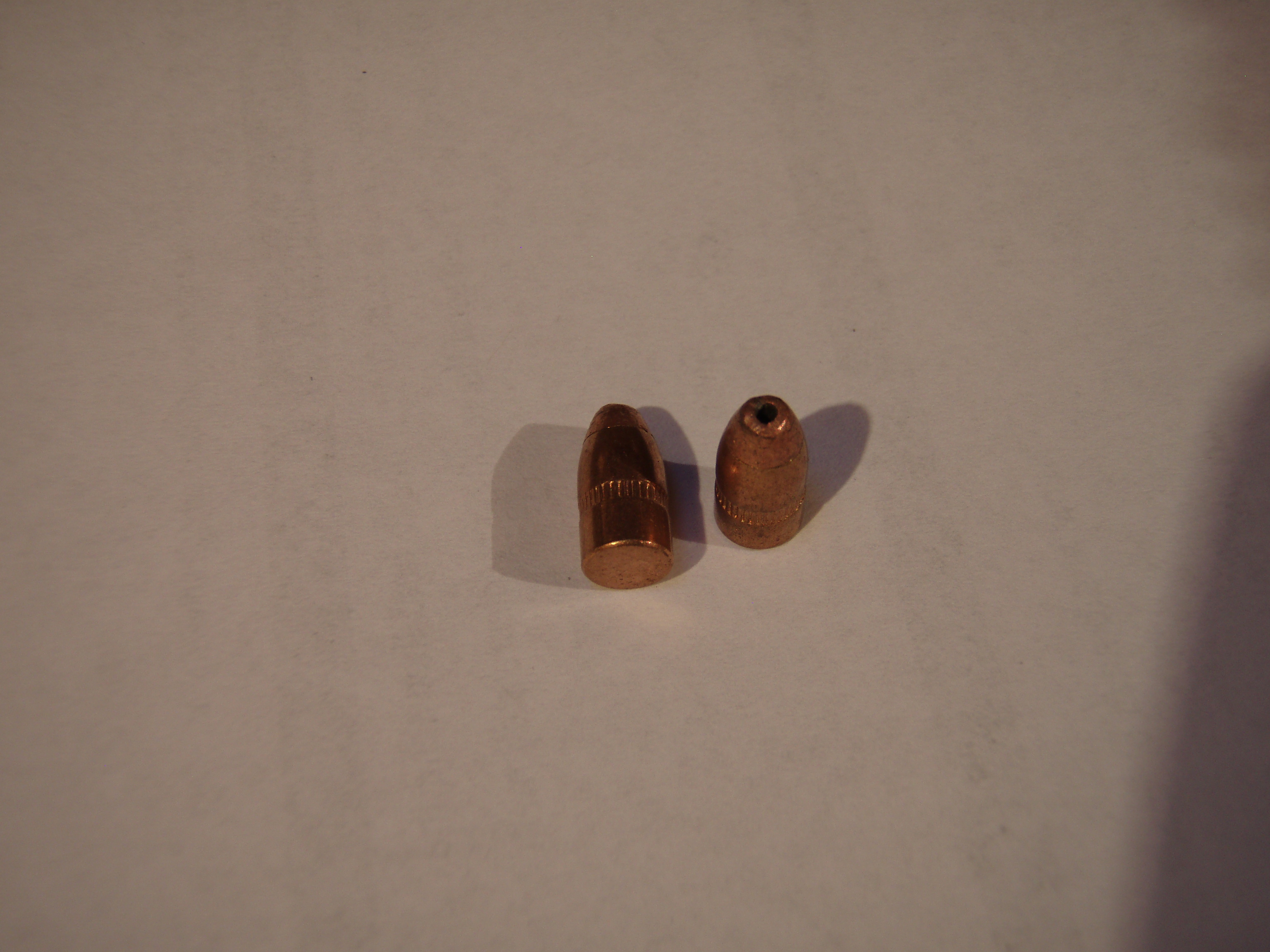

I think this is what you have. They are a soft point and the lead point seems to be "copper washed". They are a .224" projectile. I had several thousand of them and sold my last seven hundred to the LGS as he could not get them.
I build my own now as a HP. With a short jacket you can make an evil soft point.
I too would sell the WMR rounds complete. As far as I know the 22WMR has always had a .224" projectile. To have a hornet that has a .223" barrel it would need to be a pretty old rifle now.

Post by bladeracer » 13 Jun 2018, 9:40 pm
Yep, that's the bullet I'm talking about.
