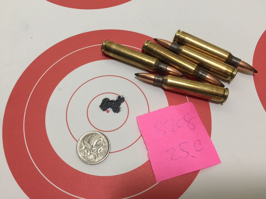

Post by SHV » 11 Jul 2018, 9:31 pm

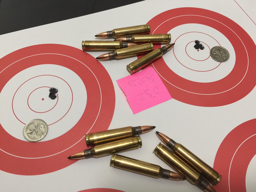

another 2 5 shot groups this evening, happy with the 25gr 8208 for now

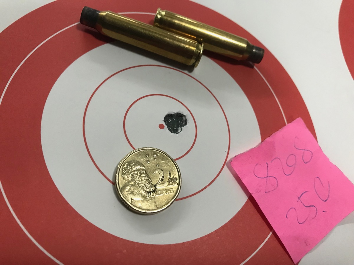

Post by SHV » 11 Jul 2018, 9:37 pm
another 5 shot group, shouldn't adjust the scope during the reload test, seems the first shot (far right one) didn't follow the adjustment

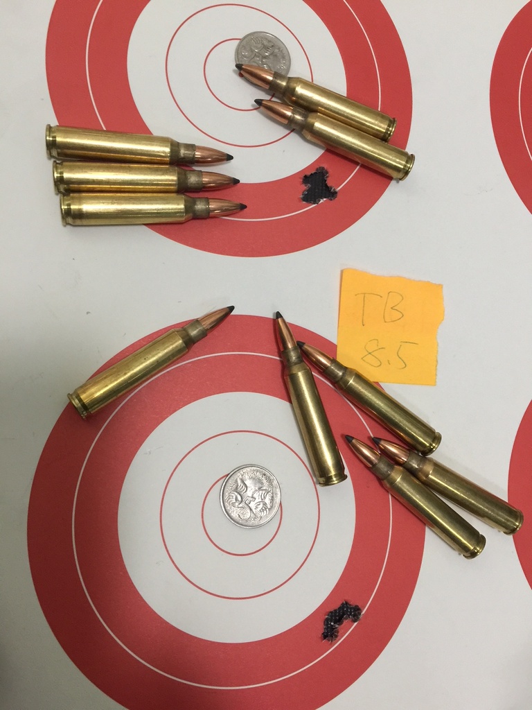

Post by SHV » 11 Jul 2018, 9:40 pm
2 5 shot groups of TB 8.5gr

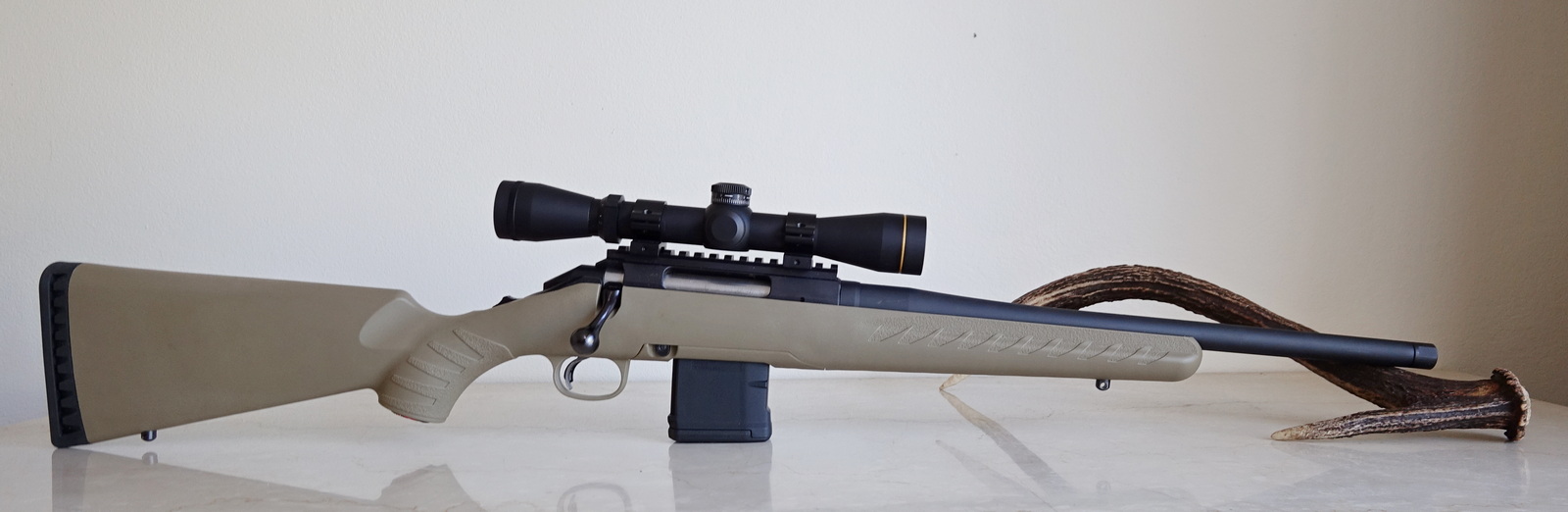

Post by SHV » 12 Jul 2018, 11:07 am

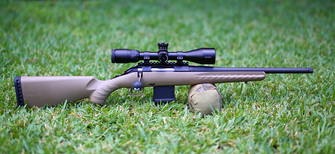

this time Ruger did a good job, free floating barrel, no stock sanding needed, kind of surprise :lol:

Post by SHV » 22 Jul 2018, 4:42 pm

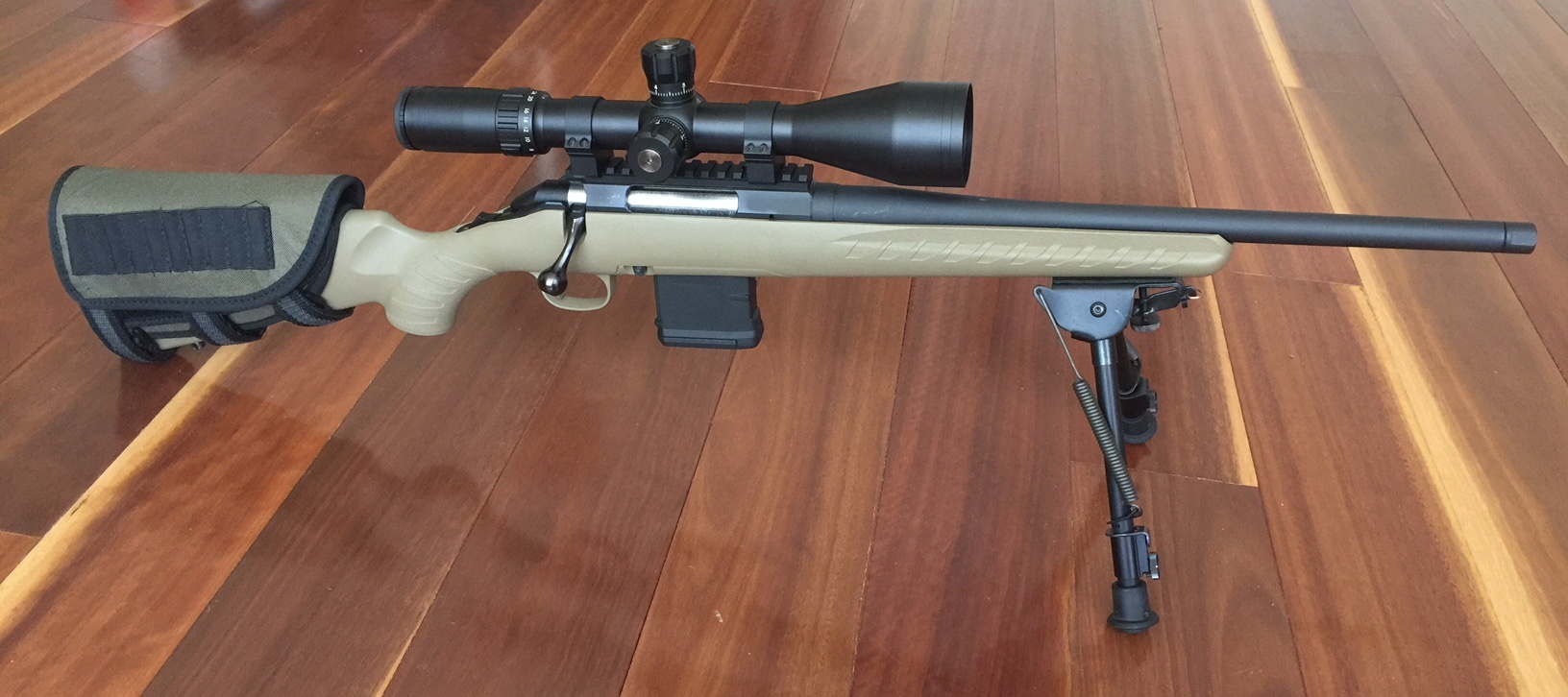

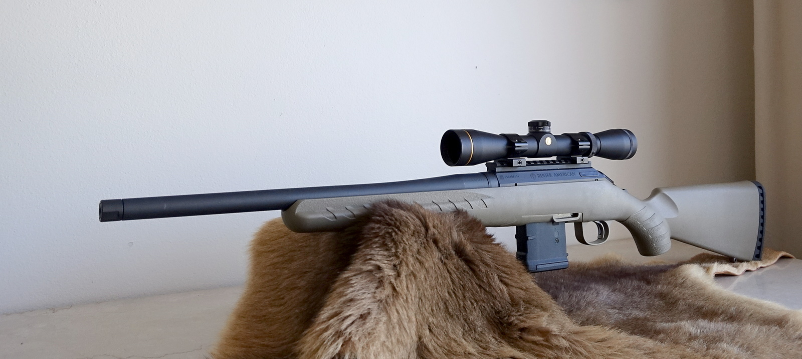

leupold VXII 2-7X33 with low rings

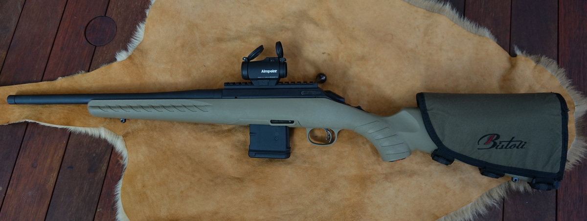

red dot

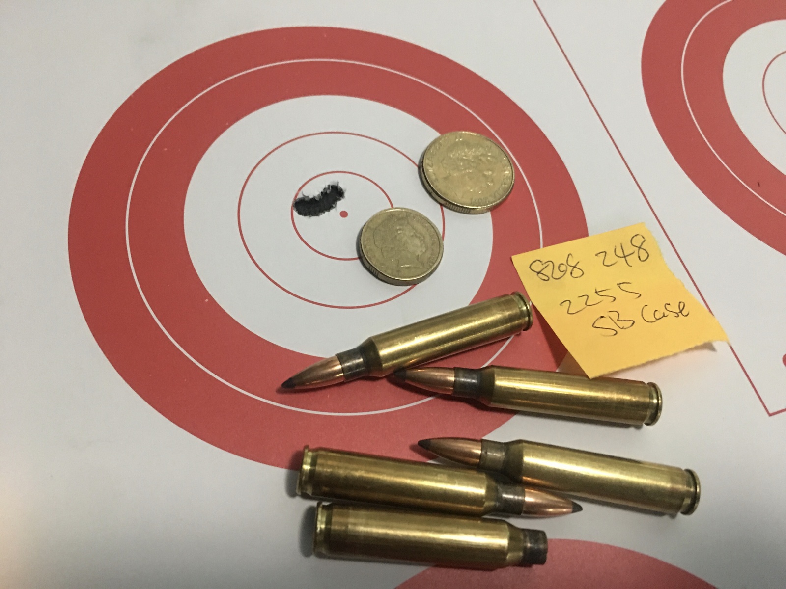

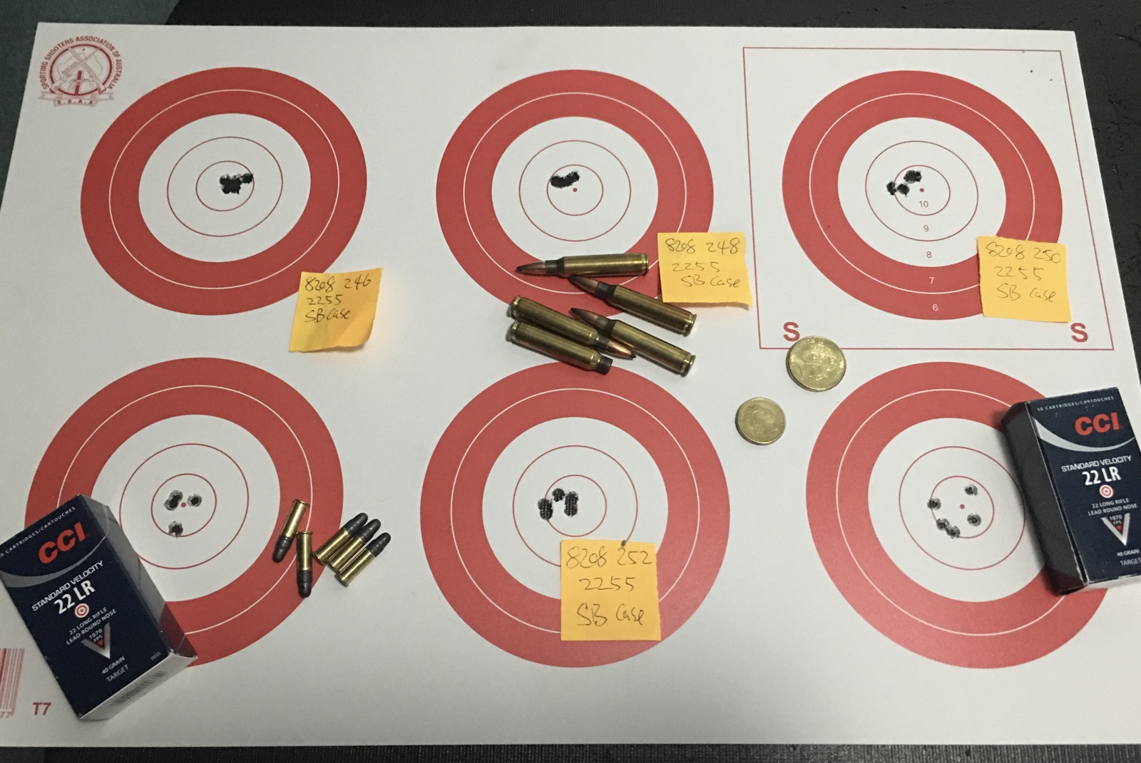

Post by SHV » 10 Oct 2019, 10:34 pm
after put the muzzle break I redid the reload test, it changed a little, 24.7-24.8 should be the best now(It was 25.0 before the MB)

Post by SHV » 10 Oct 2019, 10:38 pm
will load some 24.8gr to sight-in 200m and try some 300 and 400m at my friend's farm this sunday to see how it performs at longer distances

Post by Stix » 10 Oct 2019, 11:20 pm
Looks good SHV...!!: :thumbsup: ...cant be too disappointed with that...!!... :)
I have a (to potentially be perceived as silly), unrelated question though... :)
Why do you write the load data on a post it note & stick it to the target...?.../...Why not just write it on the target...?
What if someone switched the stickies around when you weren't looking... :?...how would that fair for the confirmation load test... :?: :x

Post by SHV » 10 Oct 2019, 11:49 pm
Stix wrote:Looks good SHV...!!: :thumbsup: ...cant be too disappointed with that...!!... :)
What if the glue on a pack of sticky's was dodgy & a gust of wind came & blew them off... :o ...and you had to go running down the range looking like a drunk version of Mr Bean with numb legs & side-show-bob feet trying to stomp on the targets to catch them... :lol:
And then, in your vein attempt to catch some stickys, & with your back turned, another target blew away, & when you got back to the bench, you saw that target blowing down the range & thought to yourself--i pity that bloke having to chase his target, a tleast i caught mine before it got that far...!... :lol: & then when you go to show someone that target & you cant find it, that person says "its not that one blowing down the range is it...? :lol: :lol: :P :unknown:
:huh:
:P
I made the notes/sticker before reload, put on the table as reference and after reload put the sticker and the ammo into zipper bags, so I know which bag is which ammo
at shooting range I always shoot from the low charge to high, so I remember the sequence,I guess I'm too lazy to write it again on the target, so just put the stickers next to each group to take photo, then throw them away :lol:
