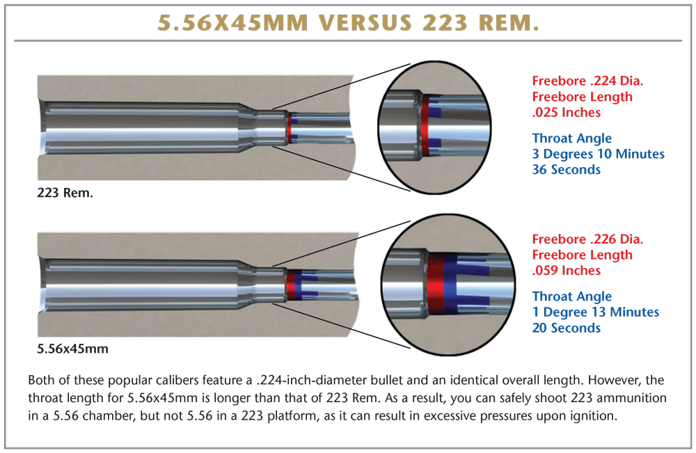

Post by No1_49er » 03 Aug 2018, 9:43 pm
You may need to look for mil-surp for 5.56
The difference between 223 & 5.56 may be better explained with the attachments.

No1_49er respectively that is a load of crap. It may have been the case at one time it certainly isn't the case now. I have loaded some of those SS109 steel insert high penetration rounds and when seated to the canular they are well over 100 thou off the lands. I seat them longer to get better accuracy. I also seat many other projectiles longer than what the COAL or OAL of that round in your picture.
Rather than a lot of people just regurgitate what has been posted on the internet. People should take the time to learn how their rifle is actually rated and what that rating is. They should find out what the chamber size is. Only then can you start to work out the facts from the fiction being pushed by herds of people all trying to be the big guy giving warnings.
Re: 5.56 in .223?
Post by No1_49er » 04 Aug 2018, 11:51 pm
The information that I posted is freely available from ammunition manufacturers and Tool-Makers i.e. the people who actually make the chamber reamers for 223Rem and 5.56 NATO. If you care to check their drawings you will find that there is a difference in the throat. I didn't make this stuff up - go and check out the chamber reamer dimensions for yourself.
The differences are probably what prompted the Go/No Go chart for 223 vs 5.56 ammo.

The Difference Between 223 Rem and 5.56 Military Cartridges
There is a general misperception by the shooting public that the 223 Rem and 5.56 Military cartridges are identical – just different designations for commercial and military – and can routinely be interchanged. The fact however is that, although somewhat similar, they are not the same.
• The cartridge casings of each have basically the same length and exterior dimensions.
• Mil Spec 5.56 ammo typically has higher velocity and chamber pressure than the 223 Rem.
• The 5.56 cartridge case may have a thicker sidewall and a thicker head - to better withstand the stresses generated by the higher chamber pressures. This, however, reduces the powder capacity of the case - which is of concern to the reloader.
• The 5.56mm and 223 Rem. chambers are similar but not identical. The difference is in the “Leade”. Leade is defined as a portion of the barrel directly in front of the chamber where the rifling has been conically removed to allow room for the seated bullet. This portion of the chamber is more commonly known as the throat. Leade in a 223 Rem. chamber is usually .085”. In a 5.56mm chamber the leade is typically .162”, or almost twice as much as in the 223 Rem. chamber.
• You can fire 223 Rem. cartridges in 5.56mm chambers with this longer leade, but you will generally have a slight loss in accuracy and velocity – compared to firing the 223 round in the chamber with the shorter leade it was designed for.
• Problems may occur when firing the higher pressure 5.56mm cartridge in a 223 chamber with its much shorter leade. It is generally known that shortening the leade can dramatically increase chamber pressure. In some cases, this higher pressure could result in primer pocket gas leaks, blown cartridge case heads, and gun functioning issues.
• The 5.56mm military cartridge fired in a 223 Rem. chamber is considered by SAAMI (Small Arms and Ammunition Manufacturers Institute) to be an unsafe ammunition combination and is listed in the “Unsafe Arms and Ammunition Combinations” Section of the SAAMI Technical Correspondent’s Handbook. It clearly states; “In firearms chambered for 223 Rem – do not use 5.56 Military cartridges.” Federal Cartridge is a member of SAAMI and supports this position.
• Federal’s XM193 packaging currently has a warning that states “For use in standard 5.56 Chambers. Do not use in non-standard 5.56 chambers.” This warning is also listed on the XM193 Product Specification Sheet. Winchester also has a similar warning on their USA brand 5.56 ammunition packaging: “Use only in firearms in good condition designed and chambered by firearm manufacturer specifically for this 5.56 ammunition and so marked on the firearm.”
• It is our understanding that commercially available AR15’s and M16’s – although some are stamped 5.56 Rem on the receiver – are manufactured with .223 chambers. Our advice however should be that it is the customer’s responsibility to know what their firearm is chambered for and choose their ammo accordingly.

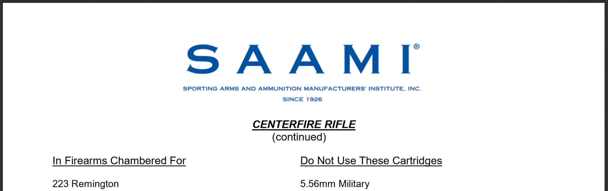

Re: 5.56 in .223?
Post by No1_49er » 28 Aug 2018, 6:29 pm
SAAMI warning_2018 May 07
SAAMI_as revised 07 May 2018.JPG (79.27 KiB) Viewed 19323 times
Contained within that article is this: -
SAAMI COAL Limits Ballistic Performance
It is a fact that the ballistic performance of modern ammunition is directly limited by the SAAMI COAL standards that are currently in place and that rifle manufacturers build to. Even when a shooter understands the implications of cartridge case volume and has a chamber that allows them to load the rounds out long, the rifle itself (having been built to feed SAAMI length cartridges) won’t allow the shooter to do so.
It goes on to say that that is the reason for building custom rifles, i.e. not to SAAMI spec.
And whilst the Berger article isn't related specifically to 223/5.56, the current SAAMI warning, as updated 07 May 2018 is quite clear in that regard.
Don't shoot the messenger - the SAAMI specs are an agreement between the manufacturers of firearms and ammo. I'm simply posting them as found.
