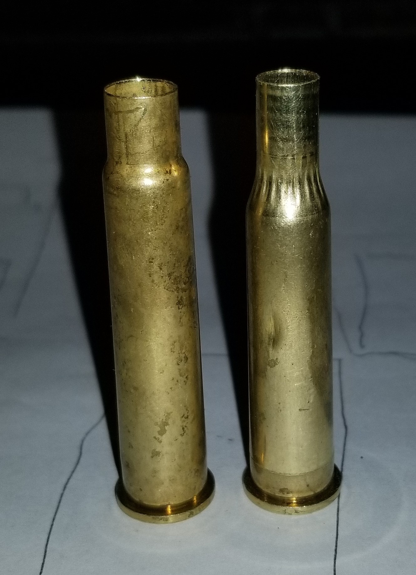

I made some 6.5x54R from .303 brass last night, just ran it into the 6.5x50mm die pushing the shoulder back until it chambered in the rifle.
Had hoped to shoot them today but didn't manage it.
The rifle came from a collector who caked everything in grease decades ago and never fired it. It took me a couple hours to strip it right down and scrub out the crud. The bolt was so packed with grease as to be virtually hydraulic. The muzzle is still tight at .266", but the throat is very long. These are light loads with 95gn VMax's at 2.820" for fireforming the brass - they would touch the lands at 3.487". Even with the 160gn RN just seating into the trimmed case, the longest would be 3.155" overall, but the blunt bullet should be getting very close to the lands at that point. The brass chambers just fine without trimming but I thought it better to trim it, at least until I cast the chamber, so it might be possible to single-feed (like the Carcano, by removing the bolt, fitting the round to the bolt face and reinstalling it) for more accuracy. Mag length though is only around 3.000".

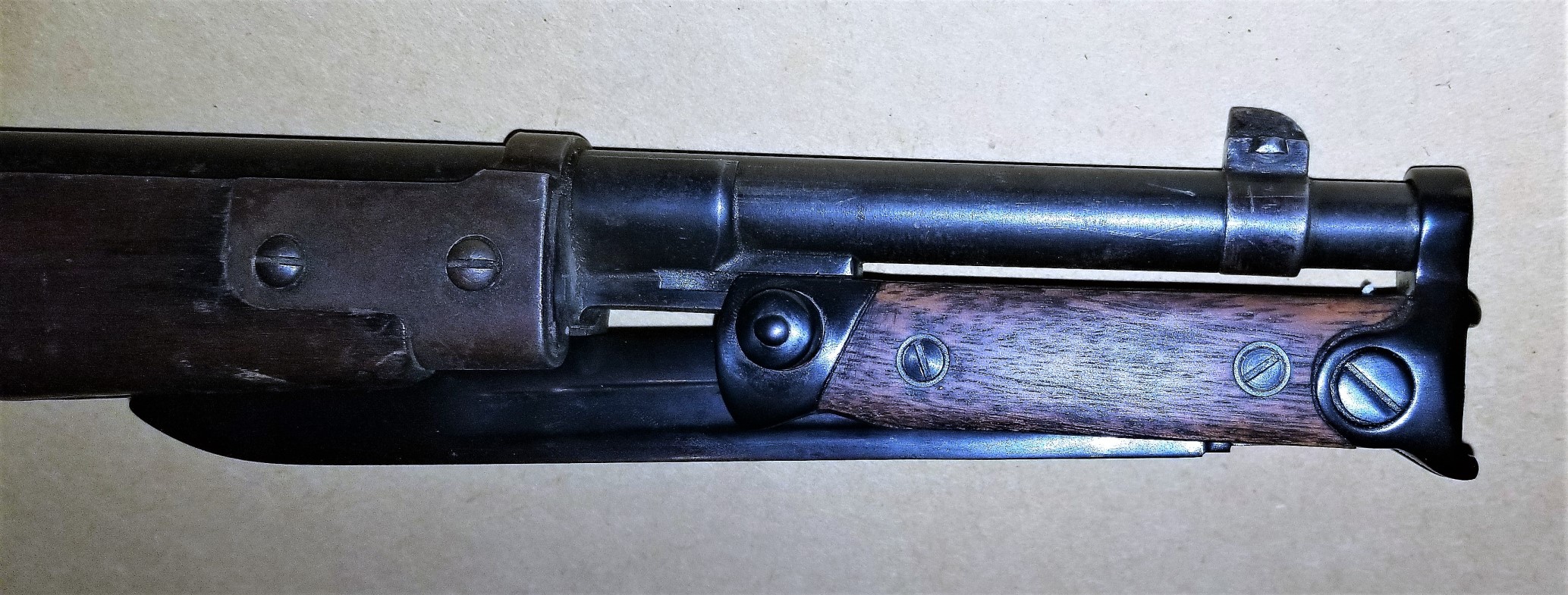

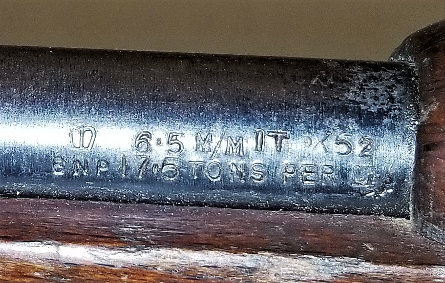

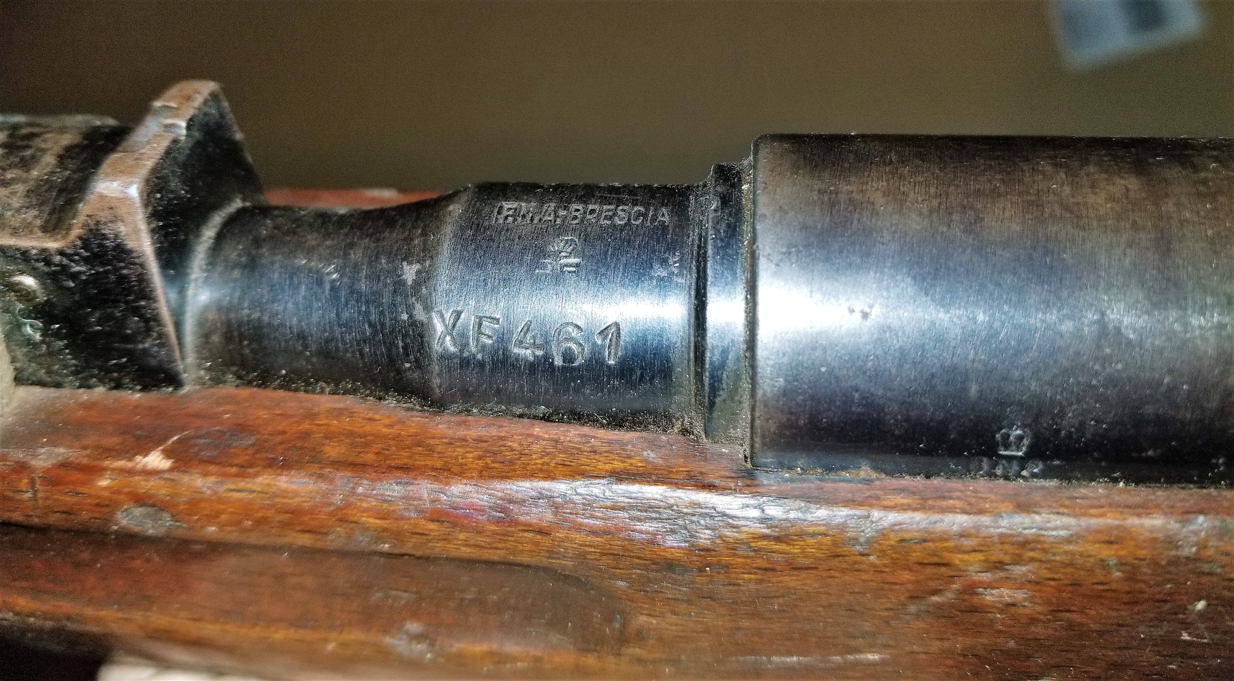

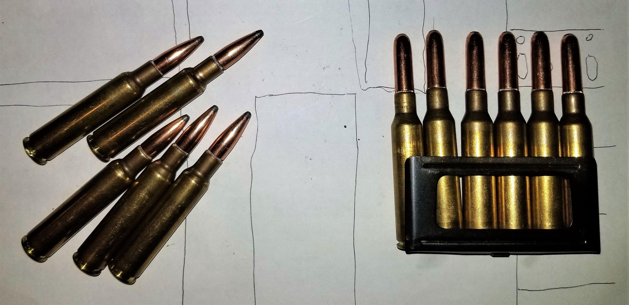

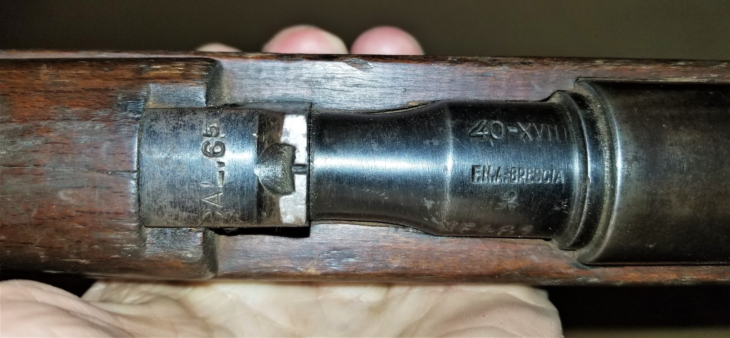

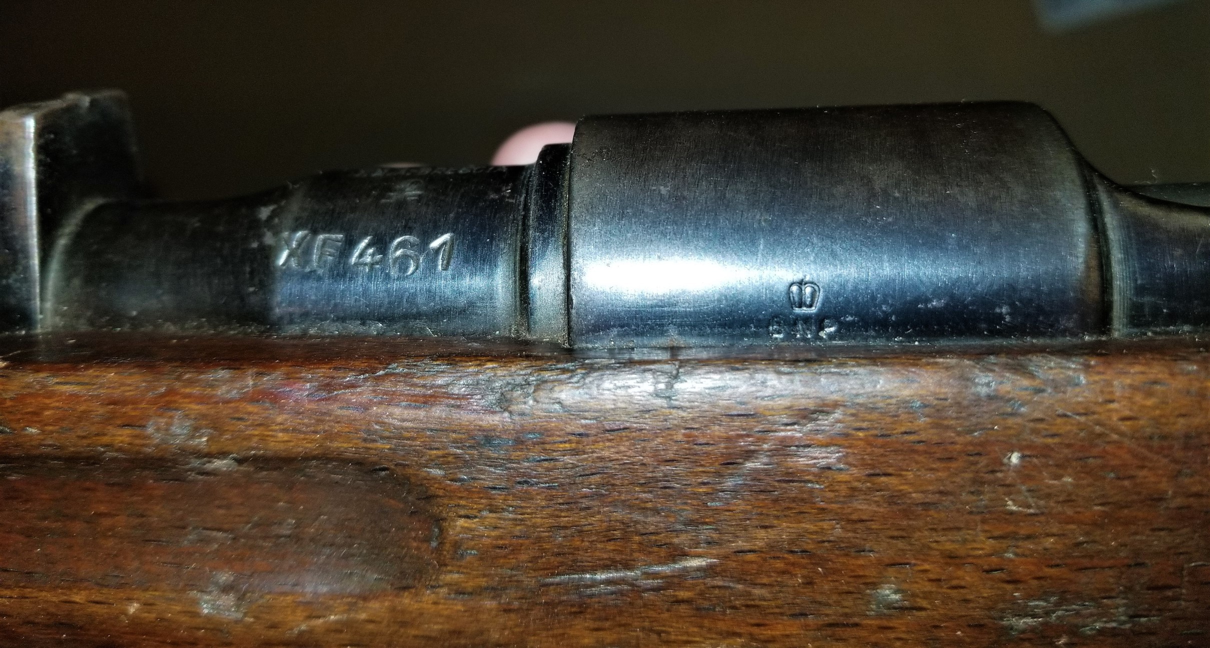

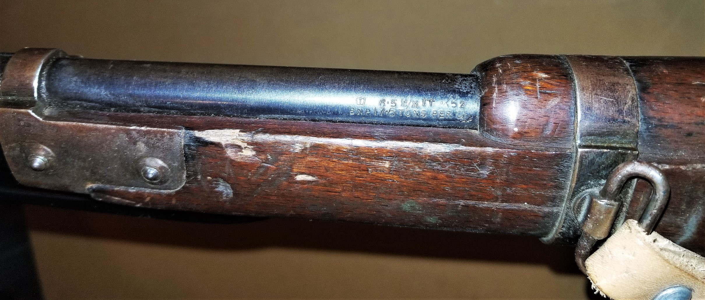

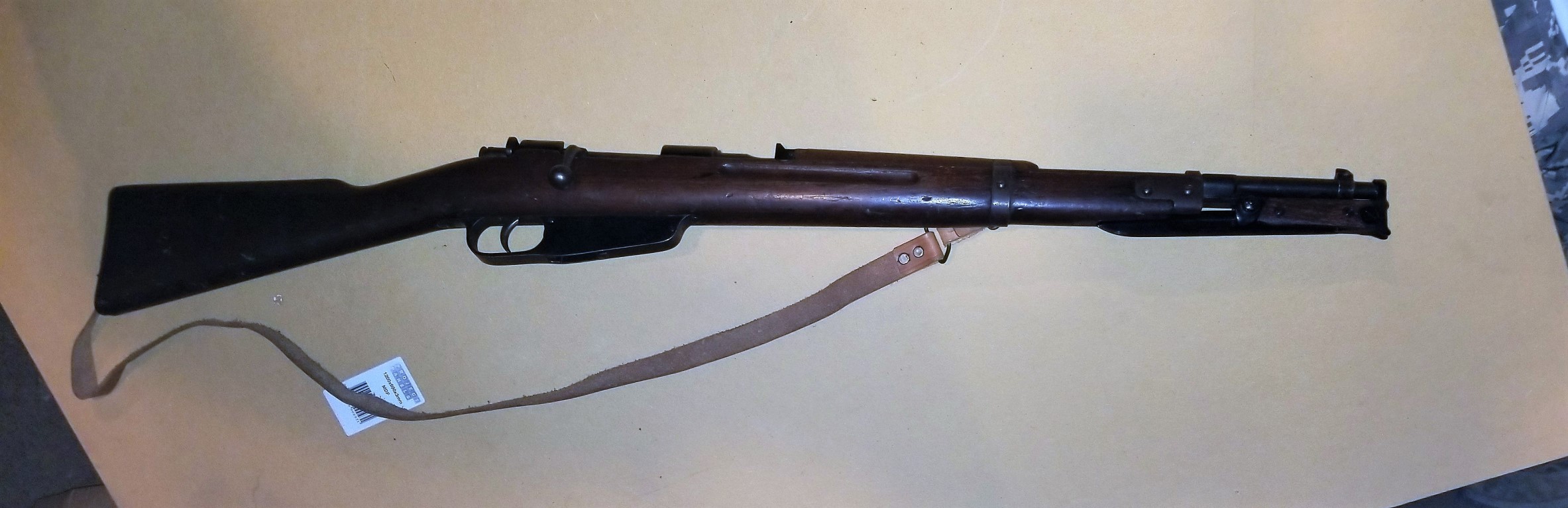

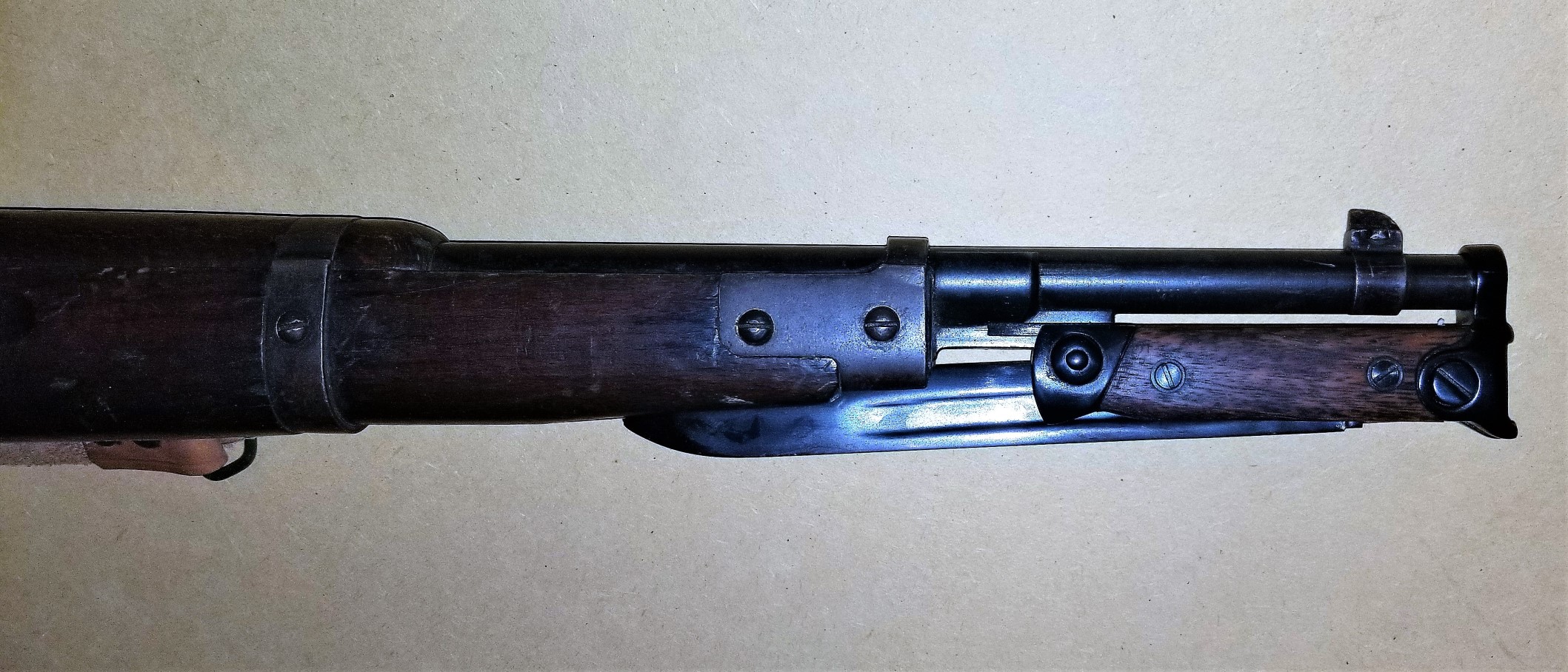

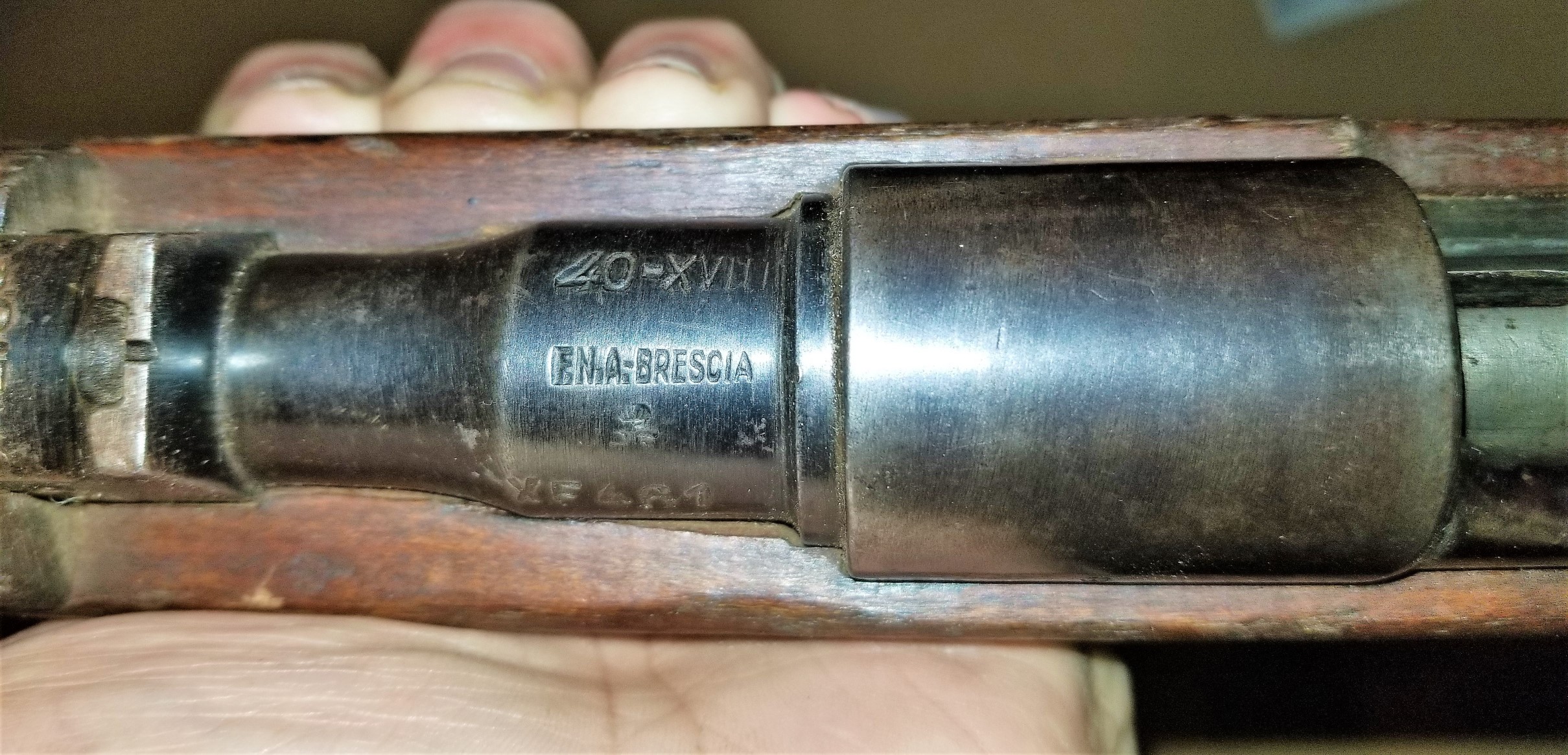

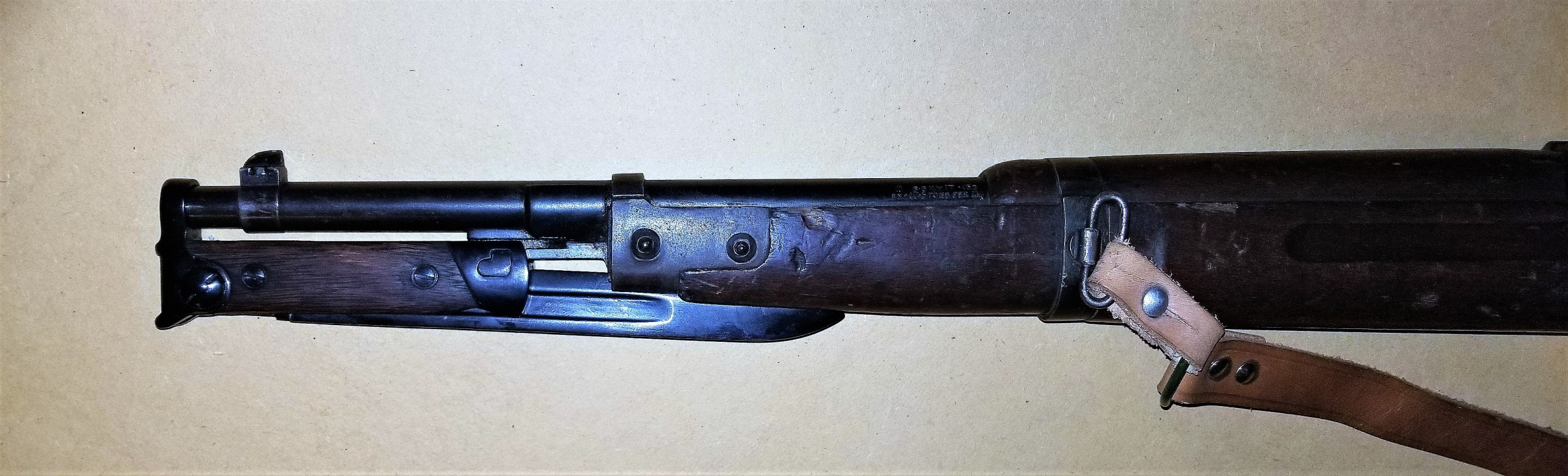

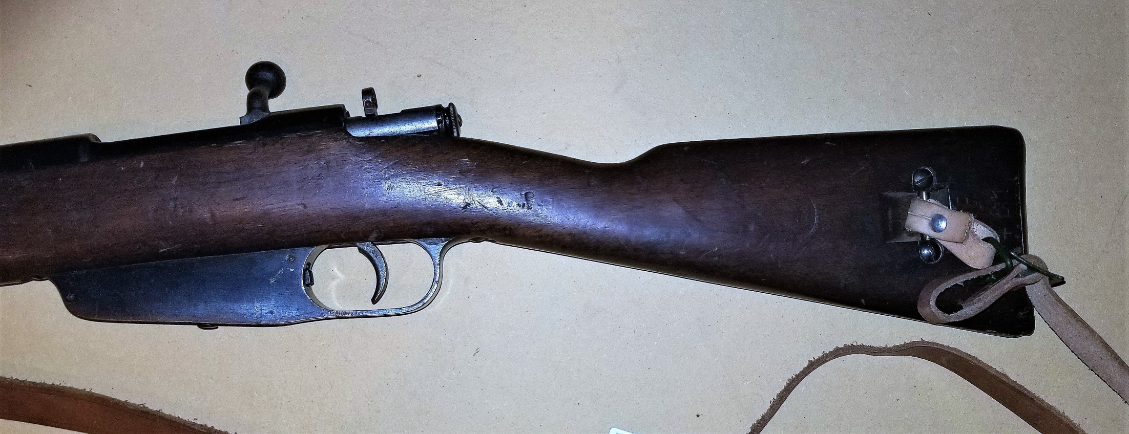

Post by bladeracer » 27 Sep 2018, 10:58 am

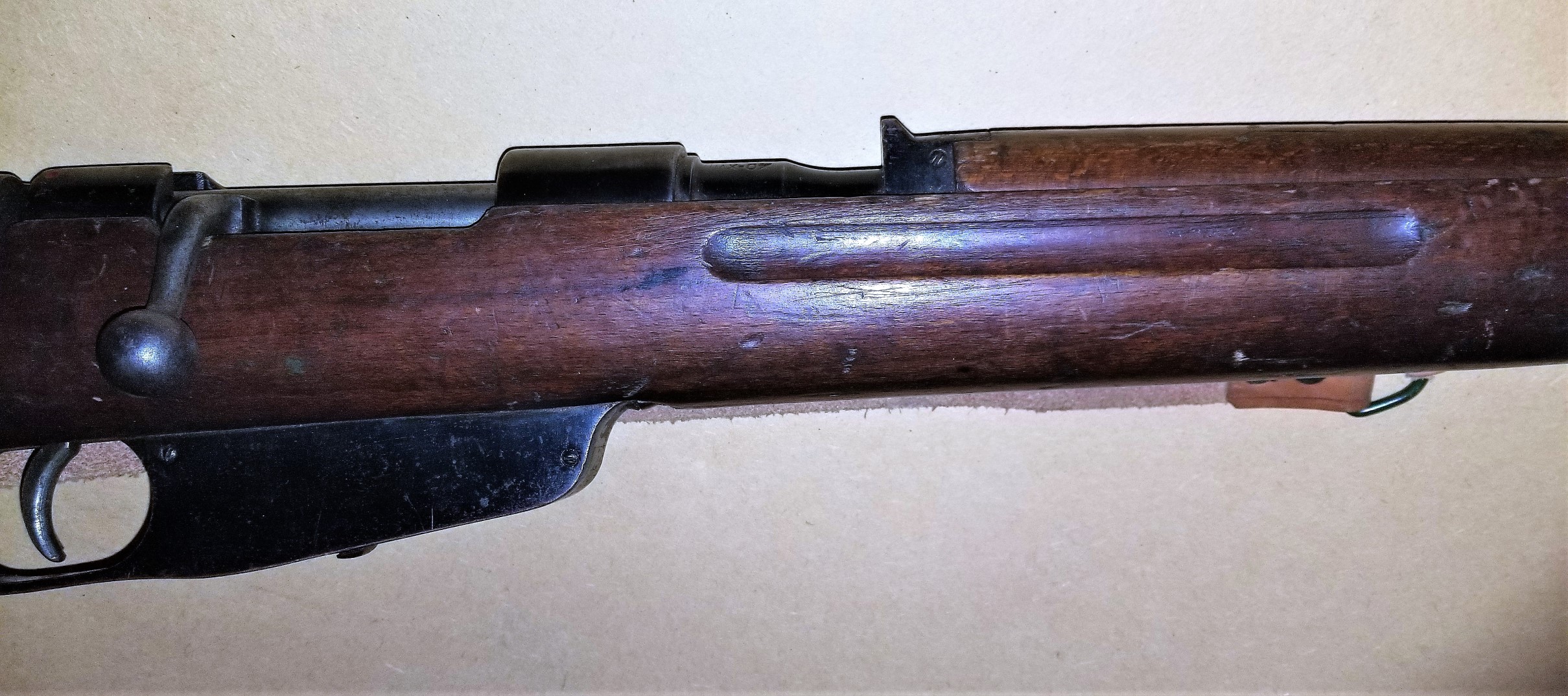

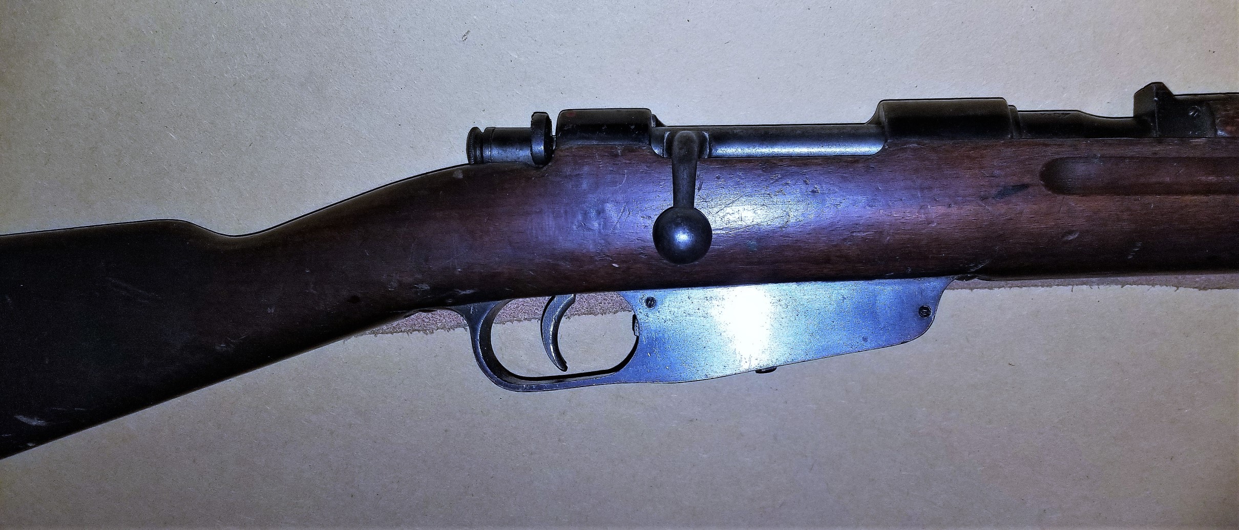

Finally took some pics of my 1940 M91/38 Short Rifle.

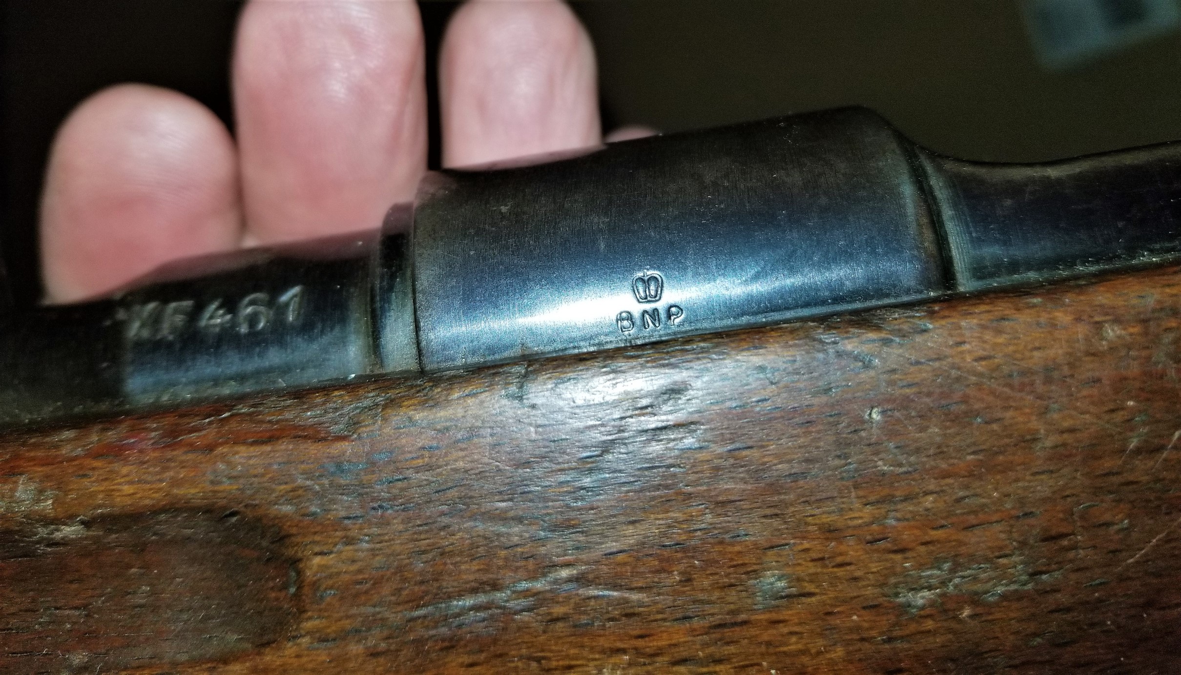

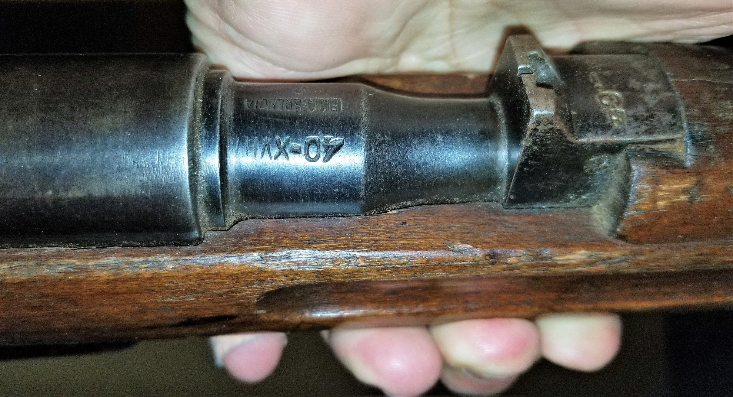

It's from FNA Brescia, but has a Birmingham BNP proof mark on the barrel and receiver - anybody know why that might be?
Can anybody tell me what the "40-XVIII" mark indicates? 1940 perhaps?
The folder is an unsharpened Atlanta Cutlery replica, the sling is a Chinese AK item.
20180926_005533 (4).jpg (273.08 KiB) Viewed 15181 times

Mint, I think I've got it mostly identified, just strange that it has Birmingham proofs. I'd like to know if those are original or if they indicate it went into British stores at some point.
And I can't work out the XVIII after the 1940 date.

Post by yumastepside » 29 Sep 2018, 7:12 am
The 40-x whatever is the Fascist year date, still waiting to hear about the British proof. You might want to look at joining Milsurps.com, Lots of information on ex-military rifles, sporterised or not.
Roger
