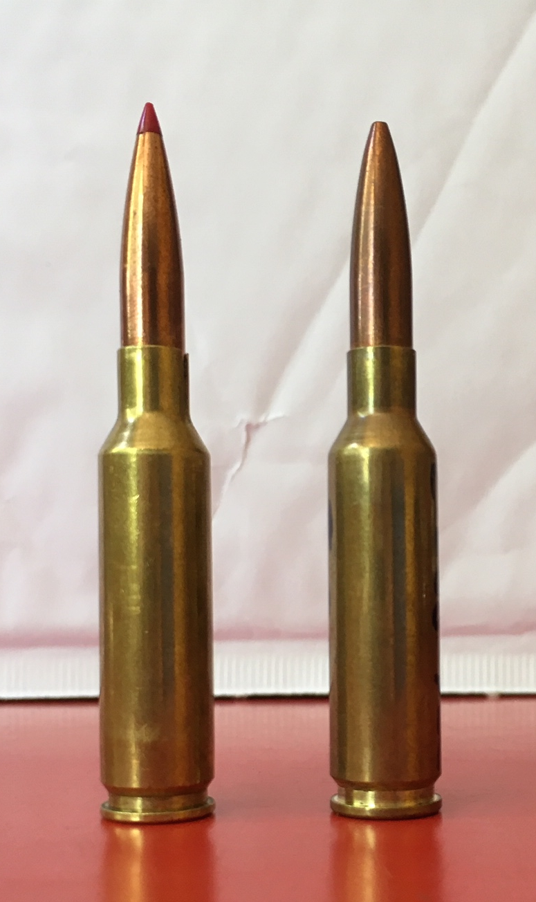

The Creedmoor was supposed to be designed for long bullets - partly why it's shorter than an 08 case. I haven't been able to seat the 143gr ELD-X near the lands, but it's a long bullet with a secant ogive and I can still get them within 0.050". They don't mind the jump. I can reach the lands easily on 123gr Lapua Scenars with mag length.
Starline small rifle primer brass has an almost identical case capacity to Lapua SRP brass, but for half the price or less. The Lapua brass is better quality and has a smaller flash hole (0.059" vs 0.080") that needs a thinner de-primer (standard on Forster dies). Starline flash holes are punched (vs drilled), and a bit rough, but can be cleaned up.
6.5CM is an efficient cartridge and with small primer brass can handle higher pressures. I've loaded above book values without any pressure signs and no loose primer pockets. The 6.5CM can get near the 260 with less powder at higher pressures. It's inherently accurate.

I just looked up my load data and we chronoed the 143 ELD-X with 42.5gr of 2209 at 2710fps.
At the ADI/Hornady max recommended 41.5gr - which is Jim Tom's load - it was going 2650fps.
I haven't finished load development yet, so I still have 42.8 and 43.0 to go - maybe a little higher if I find a node - so there's potential for over 2750fps and the Lappy brass seems to handle it easily. That's in a new 24" barrel, so it might also get a little quicker as the barrel seasons.
OAL for the 143 ELD-X in my Sako is 2.932" and maximum mag length is 2.900", so I've been loading 2.890" or 0.042" off the lands.
The 143 ELD-X is 1.430" long - about as long as you're going to load in a Creedmoor, and longer than a Berger 140gr VLD (1.420"). That's plenty long enough for mag loading just about any bullet on the market. Anyone who's serious about bench rest or F-Class is going to single load anyway.

Flyer wrote:I just looked up my load data and we chronoed the 143 ELD-X with 42.5gr of 2209 at 2710fps.
I'm curious why you're chasing velocity - for what purpose?
Re: Howa 6.5creed
Post by Flyer » 12 Jan 2019, 6:05 pm
I'm not really. My target load is 43.2gr of 2209 behind a 123gr Lapua Scenar for 2815fps. I have found good accuracy at 44.2gr of 2209 for 2880fps and have chronoed 45.2gr at 2960fps, but the reduced load is more accurate and plenty fast enough for shooting offhand out to 200m, which is what I mainly use it for.
With the 143gr ELD-X, I have found best accuracy at 41.8gr and good accuracy at 42.6gr, but nothing has really jumped out at me yet. I started at 41gr and loaded to 43gr, but haven't tried the 42.8 and 43.0gr loads yet. The book data seems to be pretty conservative compared to lots of other load data online, and I'm finding that's true with the small primer Lapua brass.
