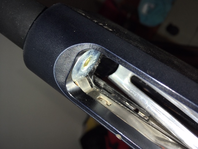

I put a couple of boxes through this recently acquired but second hand adler - without any issues what so ever.
Today, I loaded it up and said to a friend who knows firearms intermittently - try this and cycle it pretty hard to ensure it works.
He fired once and then "click" - nothing.
From this point onwards - the shotty will not load another cartridge into the chamber.
Ive had a bit of a look and i think the small ramp that holds the cartridge in place, is refusing to let go whilst being actioned.
The small lever on the side - is that meant to slide over the little indent to lift the ramp ?
Anyone encountered anything similar ?
I know there is a 5 year warranty on these but if its something simple....then id like to have a go at it myself.

Do you mean the cartridge stop is not releasing a round from the magazine? The lifter moves up and down okay?

Yes. The cartridge stop is not releasing.

Can you reach the cartridge stop with a probe and move it manually?
I think you'll have to go inside and see if something has come adrift.

Yes - If you can get a finger into the mechanism, it’s easy to release the stop and activate it - but I think from the look of it, there is a slide that activates this during cycling...and that’s not happening.
Now you mention it - I’m not sure you can cycle the Adler without firing...I’ve only had this a couple weeks.
There meant to have a 5 year warranty on the Adler - I might email same pics to NIOA - might be a known thing.

Thanks - I watched that a few times but it doesn’t address the part that is failing which is in the side of the receiver.
I sent video to NIOA they declared its warranty issue and to send it up...bugger, but at least it will be fixed.

Yep - came back from NIOA good as new and hadn’t faulted since (prob 1000 shots).
