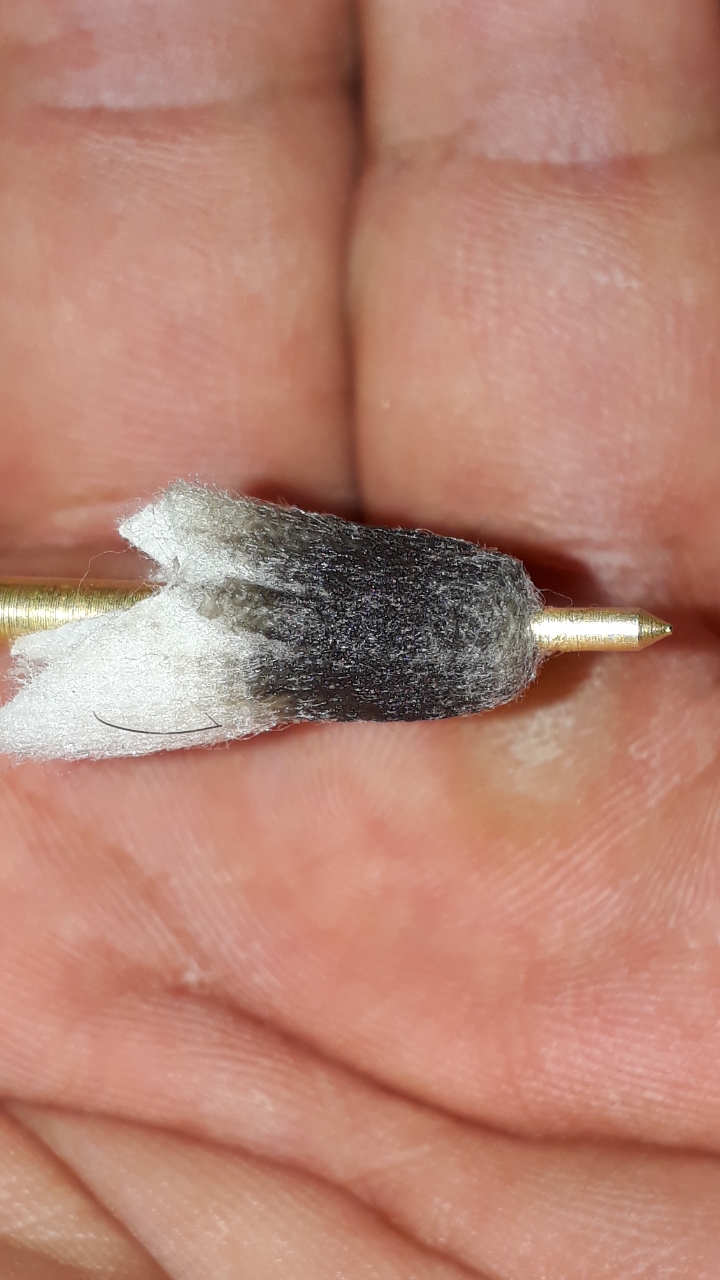

Post by Harrynsw » 13 Oct 2019, 9:54 pm
In the time I have been a regular shooter, I've been in the pursuit of the correct method of cleaning a barrel. I've come to the conclusion the answer varies depending on who you ask/what you read.
I'll start with bore brushes. Nylon brushes I personally believe, are a waste of time. Bought some to try, I ran solvent down a barrel, let it sit, scrubbed with a nylon brush. In no time it was clean. Couldnt believe it. It was a new rifle, but Sceptical, I ordered some bronze brushes online, this evening, went through the same process, first patch out is the image below.
Which leads me to my next point. When the heck do you stop? I can push patches through for an hour straight and will always get carbon coming out with the patch, and if you ask a hunter, a 200m comp shooter or a long range shooter you will probably get a different answer for each. So I've come up with my own answer which is somewhere in between clean it OCD style and give it the odd scrub with a nylon brush and whatever, and if seen evidence to support both.
From now on I'm just going to solvent/scrub/dry patch 5-6 times, then solvent/dry patch until it comes out clean.

The patches are cotton, or so they say, yes, using a possum bore guide, no solvent port, but I have a towel over the stock to protect it from the solvent. Probably around 100 rounds is when I clean it with solvent. I use hoppes 9 benchrest, and some where in between throw in a patch of hoppes copper fouling solvent.
The thing is, if i push a patch of solvent through and then a dry patch, without scrubbing, it comes out clean, but if I scrub I'll always get something.

I take it your barrel is chrome moly :unknown:
if I am correct this is common because of the pores in the steel that get filled with carbon ect ... :drinks:
nothing to really worry about :thumbsup:
IMHO the only way to tell if your bore is clean is to spy down the muzzle with a small torch and look for copper traces, like in the photo
you can feel carbon buildup by pulling a nylon brush back toward the action slowly, you will feel smooth then a rough sort of resistance, this is carbon and needs to be polished out with autosol or JB paste
I dont think it is the right thing to just keep pumping patches through too messy, I use a nylon or bronze brush dipped into the bottle of solvent to wet down the bore, let it soak for whatever time I feel is adequate then push a patch through and check the muzzle
I do not like rifles that take all day to clean, most of mine after 50 or more shots will take 20-30 minutes
if I use a bronze brush I never bring it back over the crown and match barrels will never have a nylon brush pulled back either
just a tip, I get my better half to cut up our old cotton bed sheets for patches, it only costs a bottle of baileys :thumbsup: :lol: :lol:
