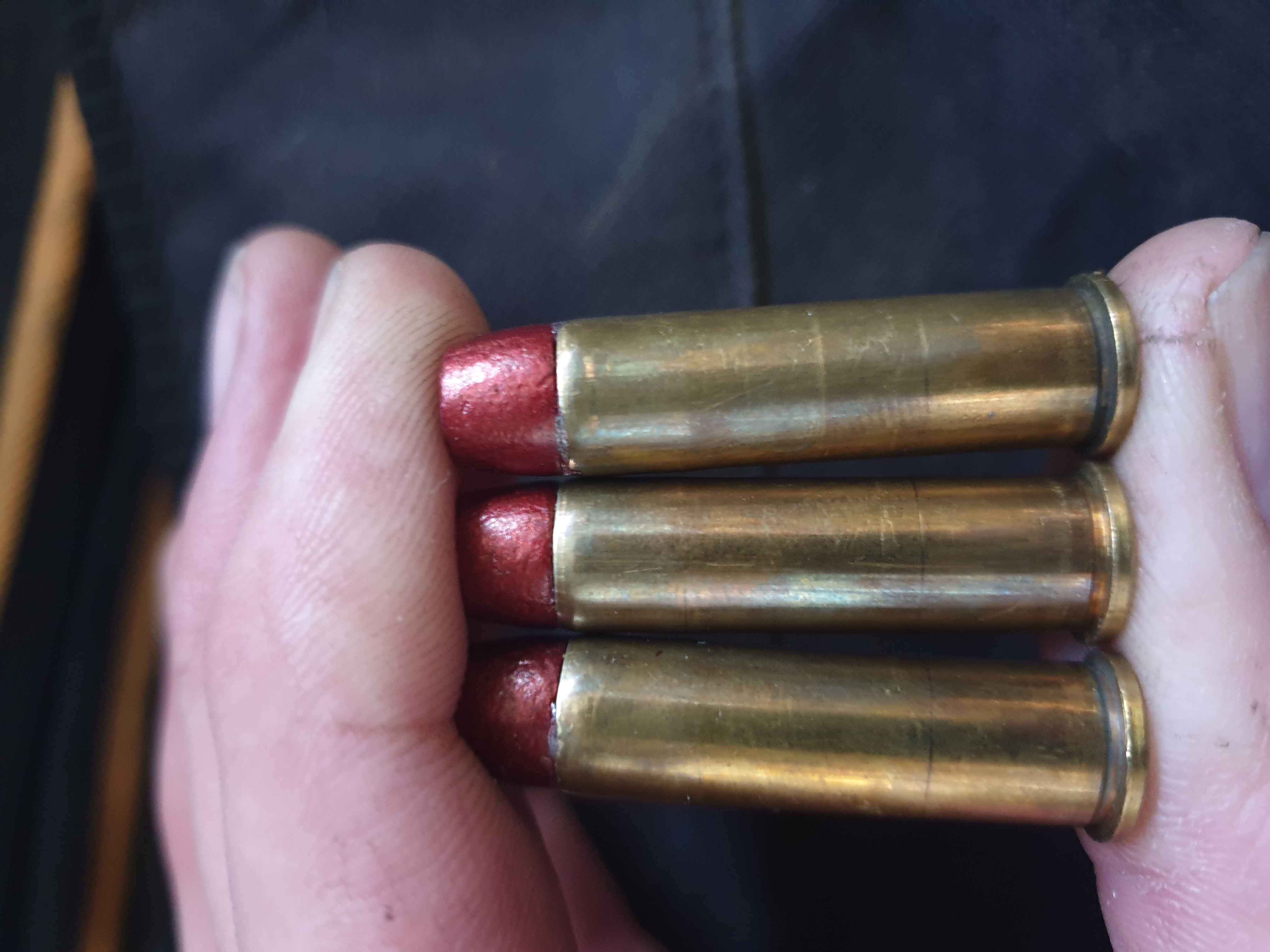

Straight off the bat I am a newby to loading, but have had some fun working up a load for my 357 mag rossi 92. I bought this gun with idea of having a fun accurate centre fire rifle that I could also plink with. I have had lots off issues getting a good factory round that works well in my rifle.
Long story short, with lock down, and not much to do, I decided to start reloading and see if I could get a good cheap round happening. And to make it even more cheaper started casting my own projectiles.
I have cast Lee 358-158-RF with wheel weight lead and they have come out 164 grain. I have also coated these with Hi-Tek super coat. I have worked up some loads from AR2205 10.5grain at half grain intervals up to 17.5 grain. At 15 grain they started to not tumble and started to group better. By 16.5 they were grouping the best but still the odd flyer. Heading up to 17.5 grain and they were spraying all over the joint so I backed down to 16.5 grain and found this shoots well. Fired maybe 50 rounds with no issues but still having problems with this Weaver 4 MOA red dot I bought and try to sight the mongrel thing in.
I have fired maybe 50 rounds at 16.5 grain and its been fine. Last night I decided to use some once fired brass B & S which I have loaded in this brand previously and had no issues. I started getting case separation as per the attached photo. I also can notice a fine line on the loaded cases not sure if this is a bad batch or if I have stuffed up. I am using digital scales and am 99% sure my gun powder measure is spot on.
I had some issues with the rounds cycling through my lever action so I I seated the boolit ever so slightly deeper so the case neck would fit in the cannelure better, and an ever so slightly firmer crimp. You could hardly notice the difference, but they now cycled very well through the lever action.
As you can see in the photo some cases separated in half. I could feel when it happened after firing because they did not kick as much. Maybe every second case did this. I cleaned the rifle and shot three more with no issues but decide to call it a day and try and figure out whats happened.
I don't have all the equipment I want yet including a tumbler hence the non shiny brass, I have been using NRA recipe for cleaning. I also need a debburing tool which is in the post. Hence the rough looking edges on the case necks. I borrowed a debburing tool for the first batch of rounds surly this wouldnt be the issue?
Any thoughts would be much appreciated.
