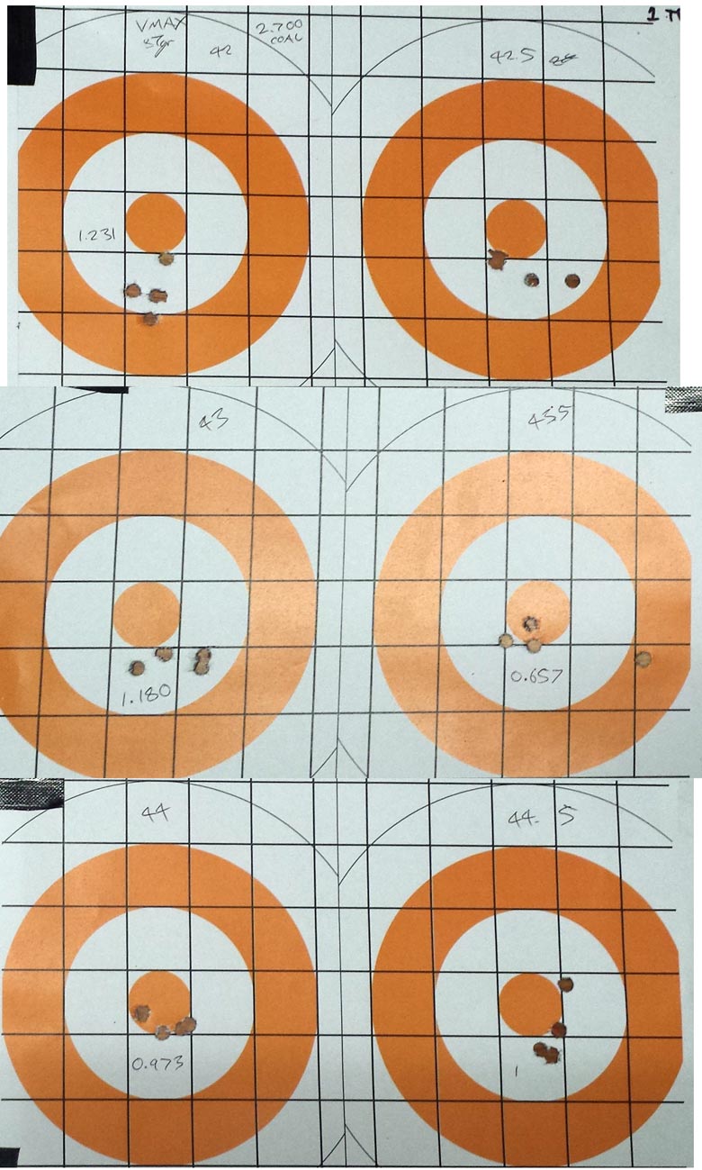

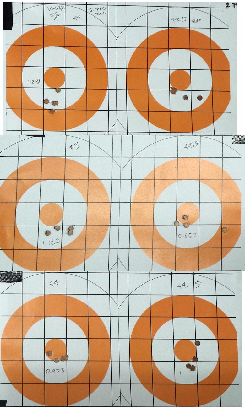

Just sharing some results for anyone working up a hunting load for their .243.
Hornady V-Max using ADI 2209 in 42, 42.5, 43, 43.5, 44 & 44.5 loads and you go down the sheets.
Didn't bother measuring the worse groups, but there are a few promising ones in the middle.
Nothing too exciting to start, but if you ignore the flyer of 43.5gr it's a 0.657" group.
4 shot group of 0.9" for 44 grain as well.
Haven't testing .1gr increments in between these two loads yet, but somewhere in the 43.5 - 44 grain range seems to be the sweet spot.
Shot out of stock Ruger Hawkeye.
Hopefully usefull for other .243 shooters. Cya.

Confirm that that outlying shot from the 0.657 inch group is a flyer and you've got yourself a winning load there.

Great varmint bullet too the V-Max.
Do a couple of loads .1gr either side of that group to fine tune and you've got yourself a winner indeed.
.6" group... Good for a stock sporter.

Yep, nothing wrong with that at all.

43.5gns of 2209 works best for me too with the 87gn VMax.

I got hold a few boxes of 87gr vmax a little while back but was yet to try them in my Remington 700. I did a bit of a naughty thing and with out working up I tried 4 with 44gr's of 2209 and this was the result, the first two went through the same hole. I haven't been able to get anymore at the moment but if anybody knows of some let us know.

Silver87 wrote:I did a bit of a naughty thing and with out working up I tried 4 with 44gr's of 2209 and this was the result, the first two went through the same hole.
I'd say that's working for ya.
A bit of fine tuning and it can only get better.

Post by Lorgar » 02 Jul 2014, 4:00 pm
Not sure if you're talking to me or Silver87?
For me... It would have been 30 - 40 seconds between shots? Roughly.

Hmm, I'd say it kept things manageable for a short run.
I was only changing powder charges in the initial photos so it was only 24 shots, not exactly a barrel burning quantity of ammo.
If you were shooting more shots per group, shooting a load with a wider range of powder charges, testing different bullets, primers etc. you could be looking at 100 - 150 shots or more.
I'd be leaving it a lot longer for that much shooting.

well call me crazy but i like 42 gn 1st photo as well , top hole maybe a flyer of sorts? why 4 shots by the way? just mag capacity? i use 5 shots but it opens the groups up a bit . bloody good groups by the way yours as well silver :thumbsup: hate you both :lol: :lol: :lol:
