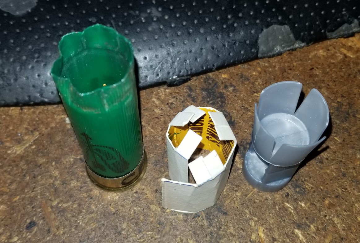

Edit: pic below. This is just paper but basic design seems to work. Just needs some refinement to get a reasonable cardboard cup.
Wad pressure is important. If its low the powder will not burn well. Solution is to add wads under the shot wad. In your case trial and error till u get a good crimp.
Edit. Your trying to duplicate a factory crimp. If it is not firm you need more wads under the shot.
The paper cup is pretty much what I was originally planning so I'll work more on that.

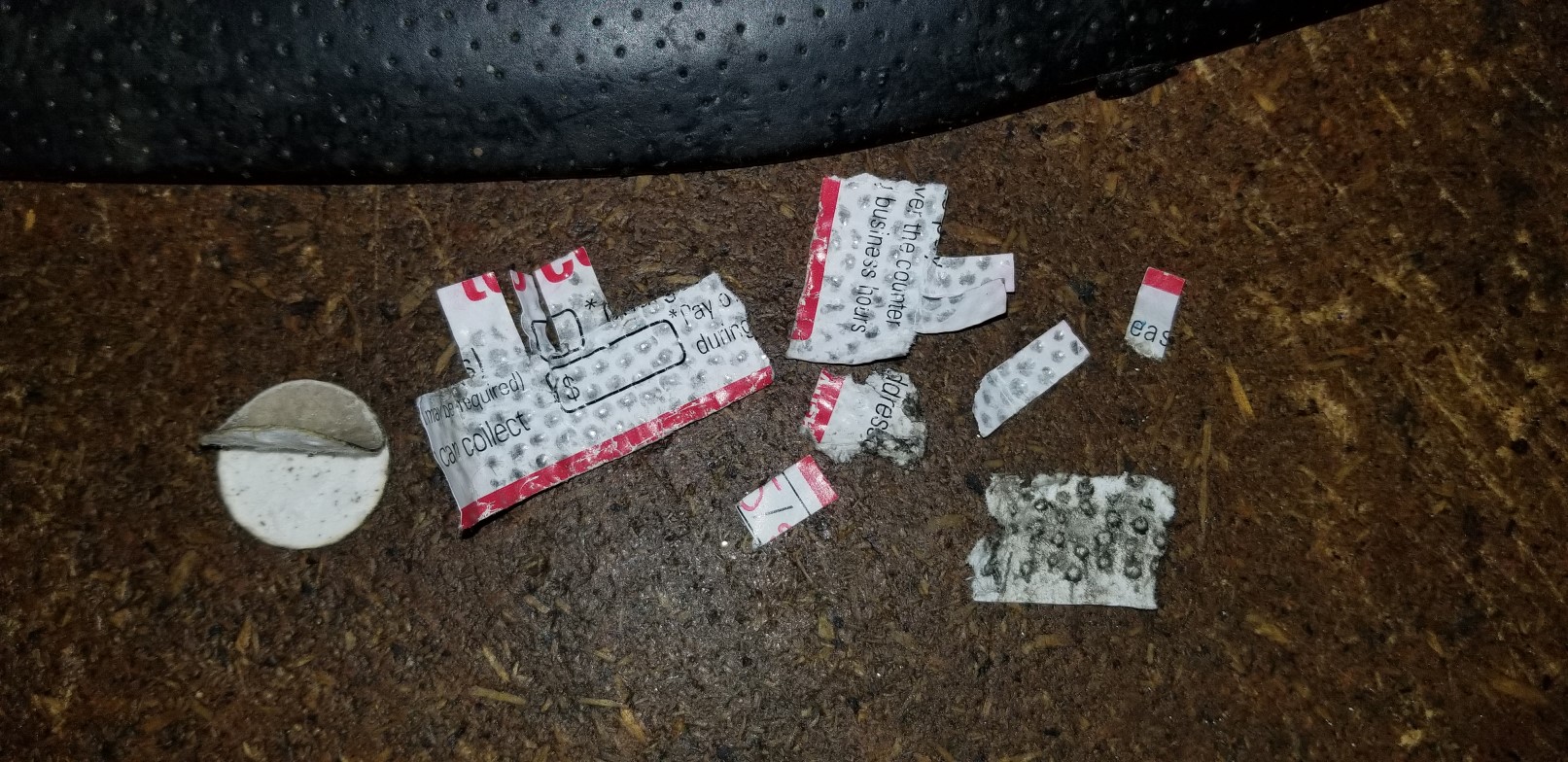

I dashed out just now while the rain had mostly stopped.
This one is 25gn of Trailboss, over-shot card, seven 2mm .750" cork wads, and a "cup" I banged together out of an OzPost parcel collection card that was on my desk. I put a roll of the card in the shell, poured the 330gn of #7-1/2 into it and measured the height - .600" roughly of shot column. So I used the full 140mm width of the OzPost card, cut that in half, marked it .600" and ruled a line. I trimmed it 8mm wider than that line, then I cut slits into the lower part about every 4mm with a gap of about 20mm every 20mm along the edge, and folded those down 90-degrees. I rolled it up under-size, folded the "petals under the bottom, put it in the hull, and teased it out to fill it. Then I put the second one inside the first, sort of like a sabot to ensure it blows apart. Poured the payload into that, and crimped it.
Chrono said 560fps (I think) but it felt like it had more punch than that. The "cup" blew apart right over the chrono (a meter from the muzzle) so it probably messed up the reading. It was very windy and I recovered most of the cup just to the left side of the chrono tripod, and the over-powder card about four-meters forward of that. No sign of the cork at all.
The wind makes any analysis of the pattern moot I think, so I fired this one in the 20" full-choke T1000 barrel as I was really just after velocity for the Trailboss charge. The pattern is high-left, due primarily to the wind I'd say. Of the 275 pellets, I count 126 (46%) inside the 30" circle at 30m, and another 28 on the paper (56%). I suspect much of the remainder went off with the wind to the left. The inner 15" circle has only 10% though. I don't know how much the wind blows the pattern out but I'd be interested to see how this patterns without wind from the Condor 30", and get an accurate velocity. My shoulder says it was in the 1200fps region :-)
The 25gn of Trailboss fills the hull to nearly three-times the level of 21gn of AP70N, greatly reducing the wad column, so I don't think it's viable with conventional plastic wads. I'm planning to swap to the AP50N and AS50N/APS450 for further testing at this point. The only ADI powder faster than these is the APS350/AS30N which I don't have yet.

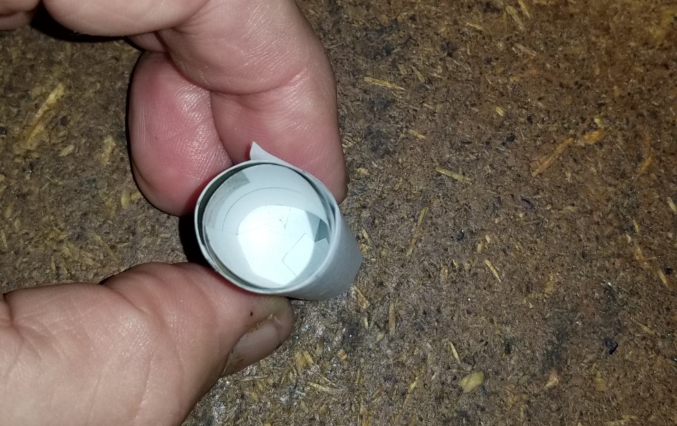

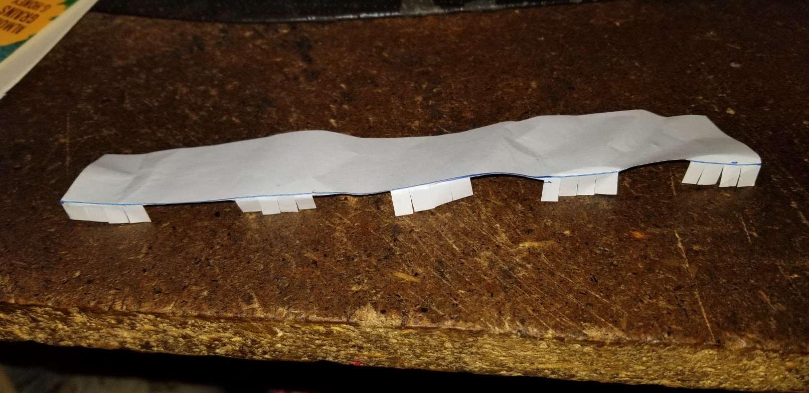

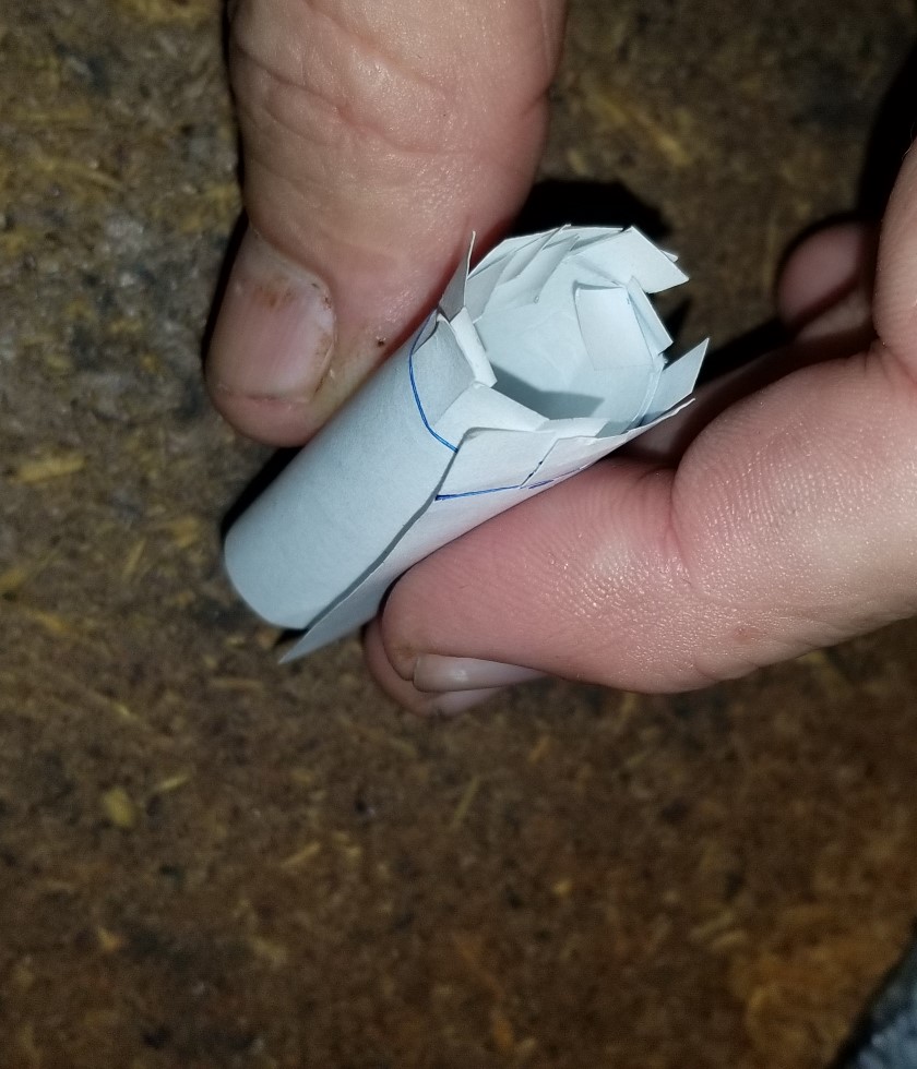

Post by bladeracer » 09 Oct 2020, 6:14 pm
Oldbloke wrote:Hi Blade racer
I'm struggling to understand the design of the Shot "cup". Any chance of a before use and assembly pic?
BTW. That pattern looks nice and uniform except for the hole in the centre. I was told in the past if you get that effect to reduce the powder. But no experience.
Some pics of a paper one.
The tabs all folded together make it quite difficult to tease the sides out to the sides of the hull, so removing half of them helps that. The thickness of the pile of tabs underneath is not significant with .005" paper, but I'm doing one from .018" cereal box card so I've removed a larger portion of the tabs - that will require some finessing to find the optimal number and size of tabs. The tabs didn't tear off the paper cup so cardboard will probably be fine with just a couple of tabs in total.
Put the cup in the hull, then pour in the shot to determine the height required, and cut the cup to that height. The wall thickness determines the height of the cup required to contain the shot. I'm curious whether increasing the wall thickness (to reduce the diameter of the shot column) will help to tighten the pattern, so I'm doing one with three cardboard cups nested. Three cups of .018" card will take about .120" off the diameter of the hull. The hull is about .725" ID and the petals of the wad are .025", so the normal column is about .675" diameter. Three card cups should bring the column down to about .605", and getting close to a 20ga. column (which is about .565"). This also reduces the thickness of cork wad required.

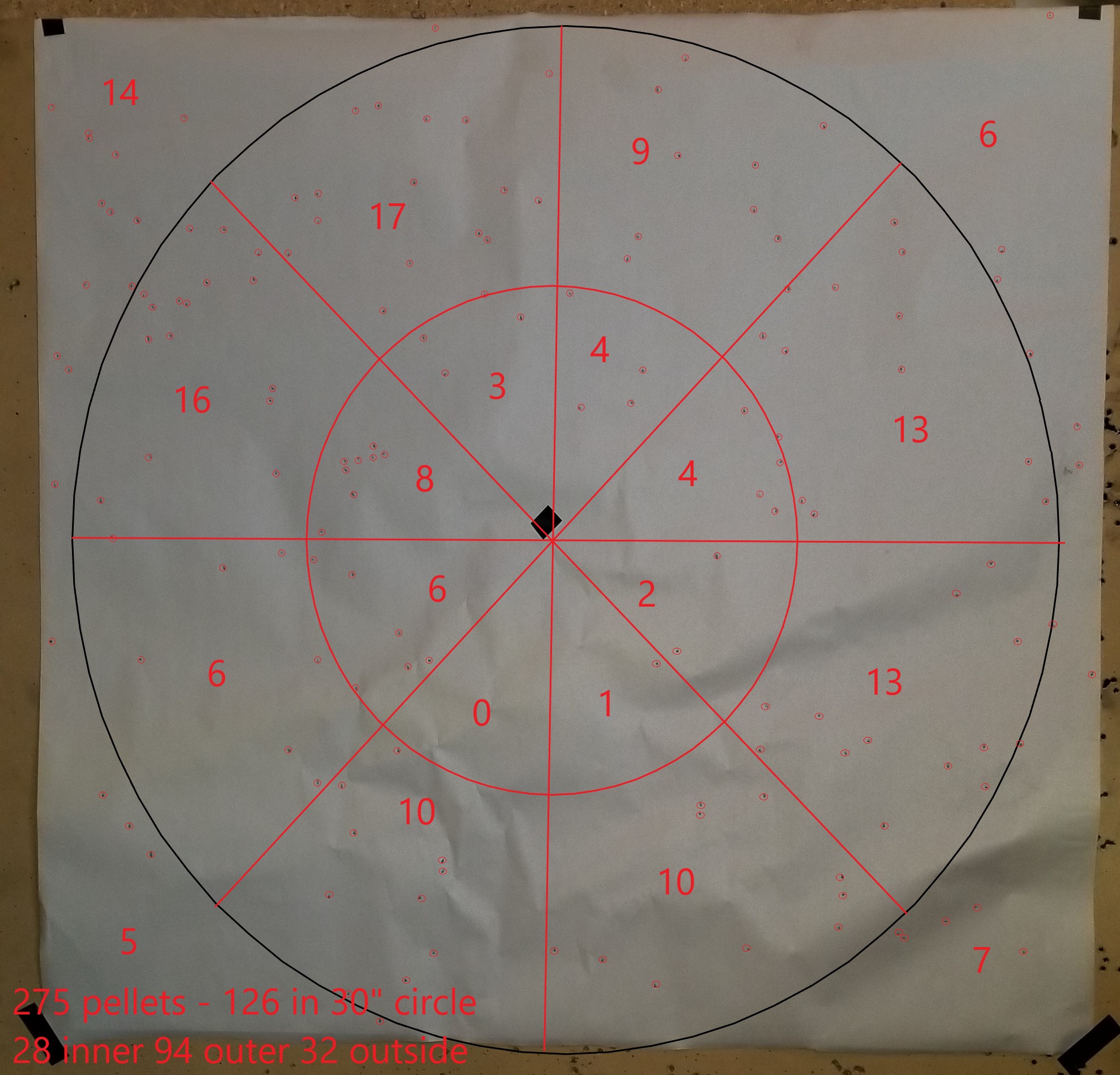

Post by bladeracer » 11 Oct 2020, 4:35 pm
This one is 20gn of Trailboss behind 330gn of #7-1/2 in a .018"-thick card "cup" on seven 2mm cork wads, with an over-powder card and an over-shot card. Again with the T1000 20" full.
Chrono read 517fps this time. I moved back three-meters from it but the cup still blew out over the chrono. I really can't be sure if these measurements are accurate or not, I'll have to try at 5m, without putting pellets through the chronograph. It may be that Trailboss is hitting a pressure wall already in this configuration. The pellets are embedding in the 3mm MDF with the odd one going through. I'll quit with the Trailboss for now I think.
The clay was just below the aiming mark, where the "7" and "12" are, was not knocked off its stick, and doesn't appear to have any marks on it, so I think it was simply missed completely this time.
The pattern is not awful, with 72% within the 30" circle at 30m, and 33% of them within a 15" circle, yet the clay made it through :-)
My calculation says that's roughly one pellet per square-inch in the inner circle, but only one per 3.6-square-inches over the entire circle.
I was going to shoot this one with a double-thickness cup, but the shot column was very tall and I would've had to remove some of the cork wads, so I went with a single cup, and I didn't cut slits down it either. It's rolled but is not fixed in any way, just has about 20mm lap. Removing it from the hull it expands to about 25mm diameter and easily tears away from the shot column. I might try four separate "quadrants" for the cup next, to see if the pattern is being pushed to one side by the lap in the cup as it opens up in flight.

You can make and use paper cups for shot. Muzzleloaders use thrm.
For wads i use basically compressed grass.
Referred to as vegie wads.

Marlin44 wrote:Eley have a loaded round with a bio degradeable wad, its steel shot also. Not cheap but either is a vet bill to extract plastic wads from a cows gut, especially the price of cattle currently
No good to me if they don't sell the wads separately.
Posts: 14003
Re: Bio-Deg wads/shotcups?
Post by bladeracer » 07 Mar 2022, 11:59 am
LawrenceA wrote:You can make and use paper cups for shot. Muzzleloaders use thrm.
Yep, paper works fine for the shotcup. For the wad I've been using cork and corrugated cardboard.
Never heard of veggie wads but they sound good.
