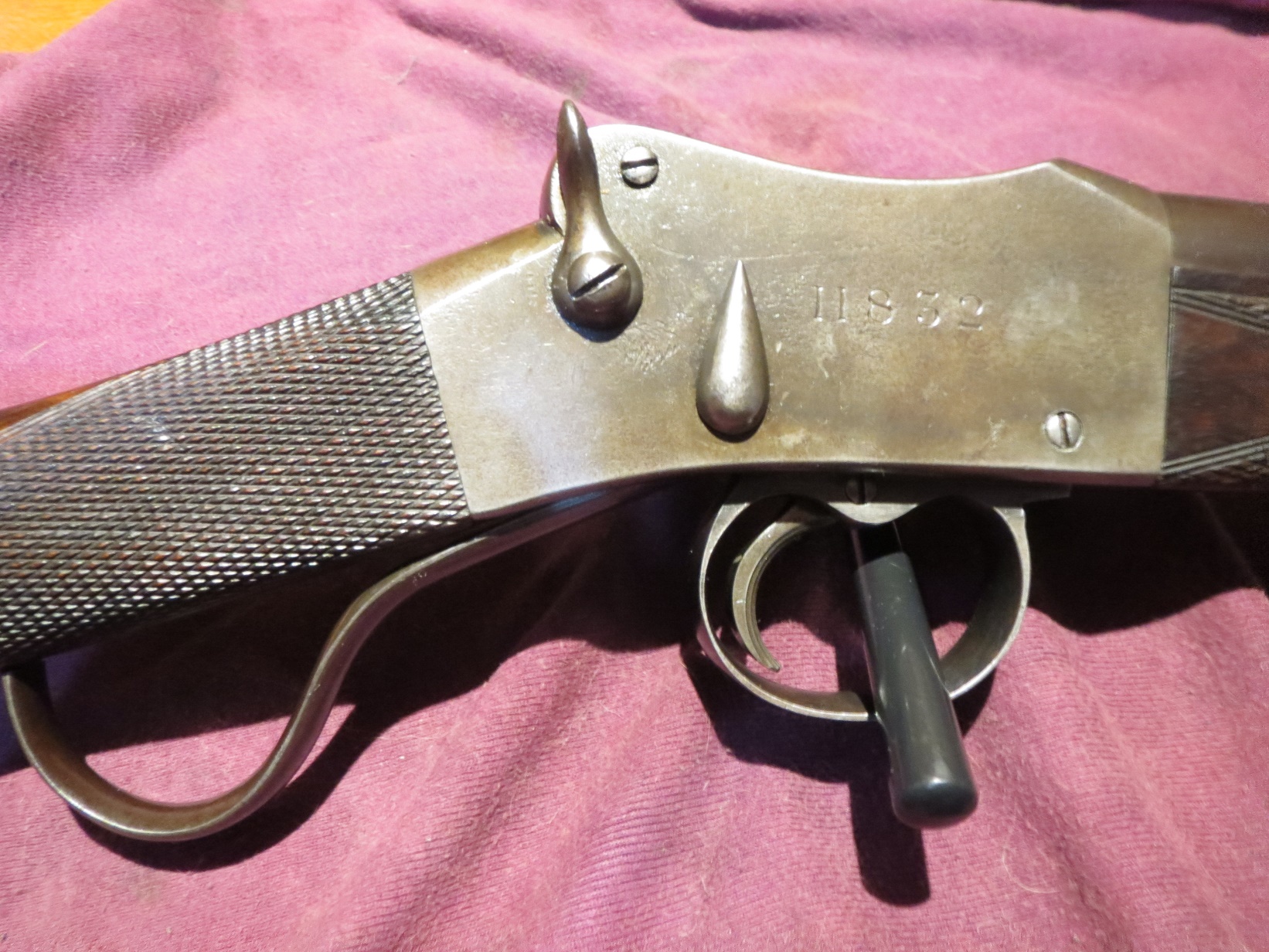

If worst comes to worst a safety can be found and fitted like this Francotte action rifle I own made by Thomas Bland & Co, The same safety was fitted to BSA Martini actions also. By the way, it is not a requirement for Victoria, perhaps other States may offer what their own Regs are on this issue? Cheers

No1Mk3 wrote:f worst comes to worst a safety can be found and fitted like this Francotte action rifle I own made by Thomas Bland & Co, The same safety was fitted to BSA Martini actions also. By the way, it is not a requirement for Victoria, perhaps other States may offer what their own Regs are on this issue? Cheers
I suspect it's a WA only requirement.
The Sportco Cadet conversions (.22, .22 Hornet, etc) had a trigger block safety fitted which a local gunsmith says he can replicate.
