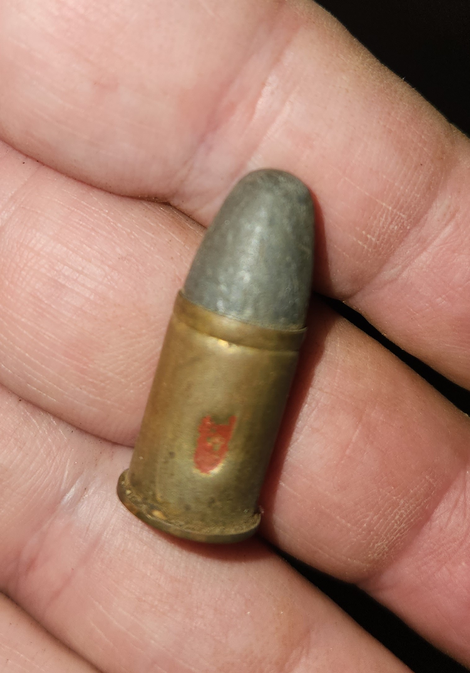

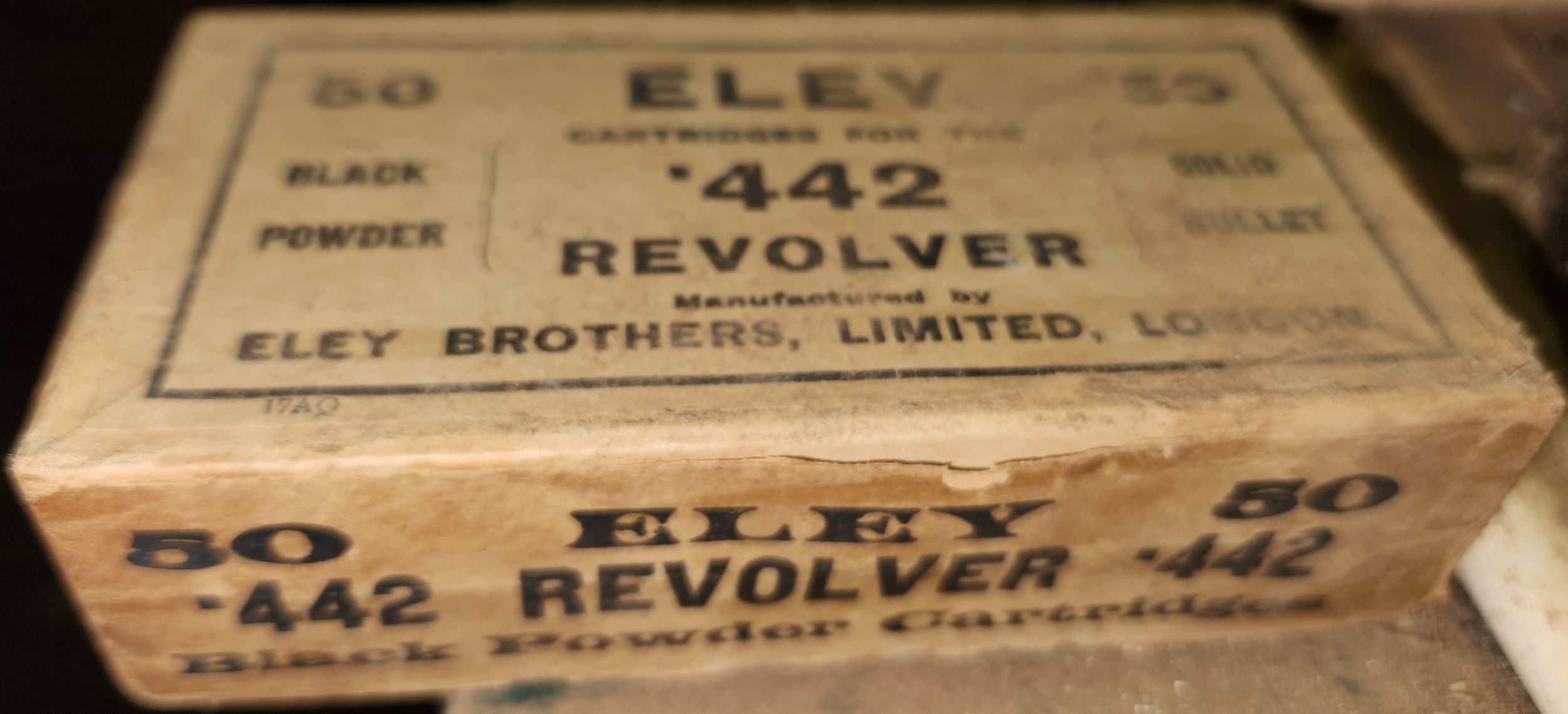

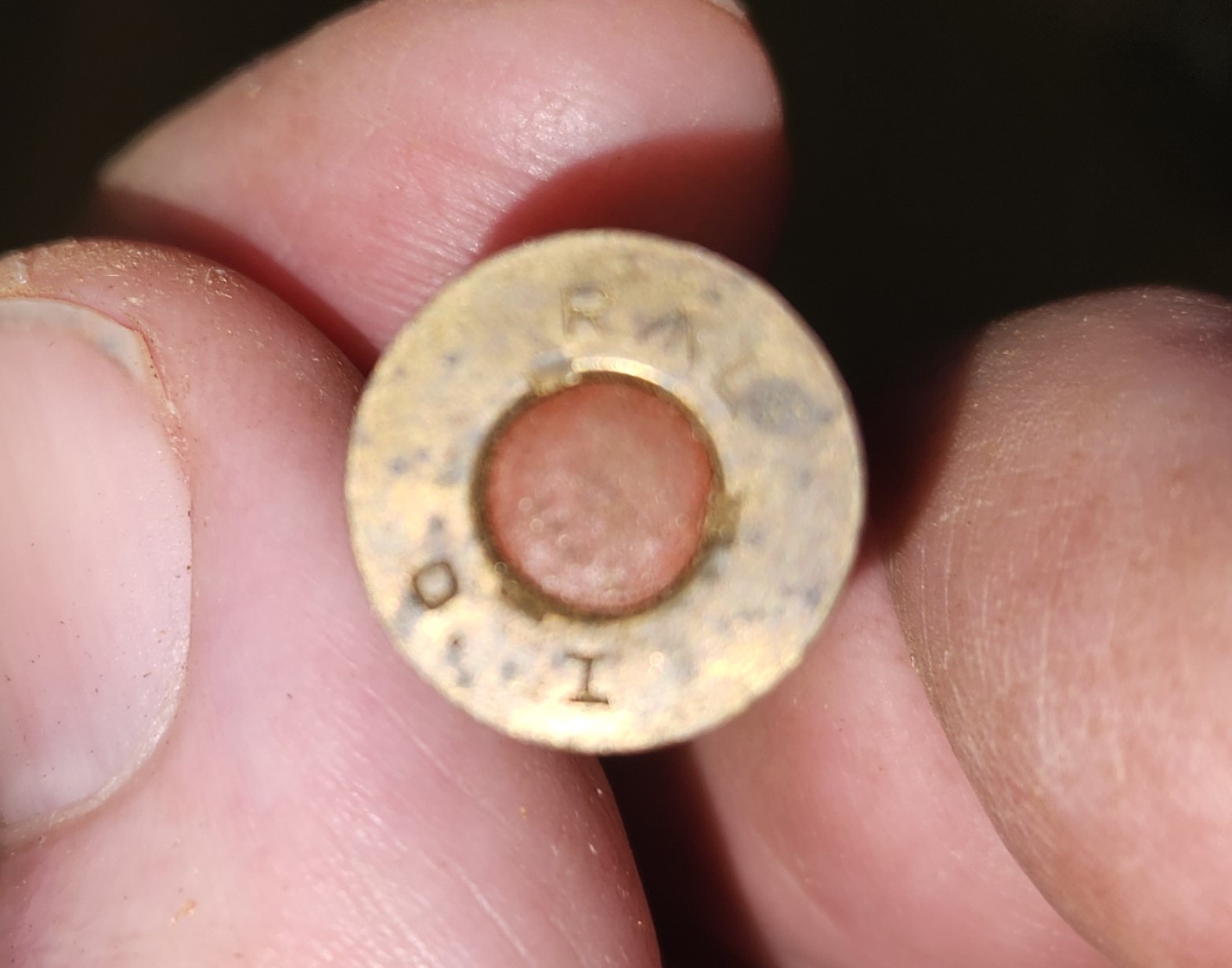

Post by Jorlcrin » 04 May 2024, 8:06 am
So,
Question for people interested in this cartridge...
It seems I might have quantity of them; still in the 50-round Eley boxes(see attached).
Cant remember how many boxes remain, but likely a few.
As far as I can remember(Took these late August last year), the other 2 attached pics are dummies for same?
Anyone interested?
Is there any safe way to pull BP cartridges?
Is there any way to safely inert primers?
Would I likely be looking at Berdan primers?
Given I live in Outback QLD, not going to be shipping anyone live ammo, but if I can get some input on how to safely pull these rounds and harvest cases and projectiles, is this of interest to anyone?
Send me a PM if so.

Post by bladeracer » 04 May 2024, 9:28 am
You can try an inertia hammer to pull the bullets.
Look like Berdan to me.
I wouldn't pull them apart though, they'd definitely be of value to collectors intact as live ammo.
