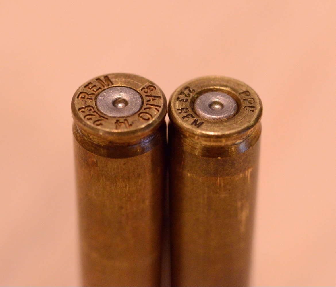

Same load, same match, one piece of sako mixed in with ppu. Don’t mix brass.

I did some reloading for old bloke who'd lost confidence but wanted to keep shooting his custom 25-303 with his grandson, mixed Riverland, some Canadian stuff and Super branded. A mate who gave me his safe loads told me to weigh the cases as the old 25-303 was prone to being a poor shooter and most of the time it was down to mixed brass being used.
Well I was quite shocked to find up to 35gr weight difference, after sorting and sizing brass I managed to cobble together 40 reloads for the old fella, he was happy as, still waiting on a range report :thumbsup:

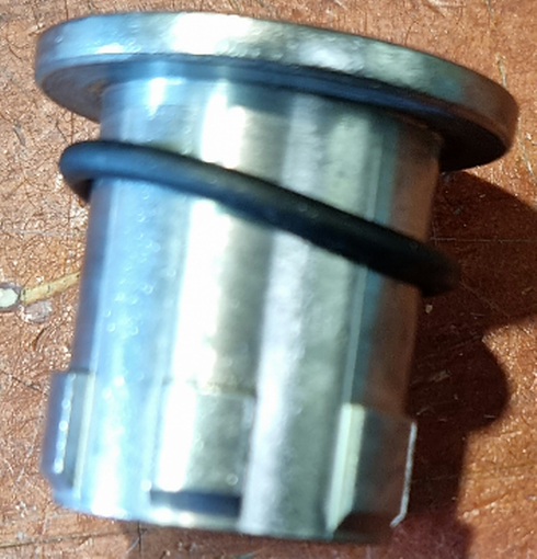

Discovered that my Lock n Load attachments have a rubber ring....rubber compresses...remove the rubber and you get a far better, consistent, everything

100% that hornady quick change thingymebob system yields flex; it's frankly not good enough. The best thing I ever did, was order a part from brownells that went into the Hornady press, replacing the female part of that stoopid "lock n load" interface. The fitting was called
Code: Select all
100040903 Lee Hex Bushing For Classic Cast Press 7/8-14
i.e. this:
I 263loctited that bad boy permantly in place in my hornady press, so now it just acts like a basic 7/8”-14 and I've never looked back. Seating is as precise as the projectile provides, i.e. how much you wanna spend on pills?? :D
