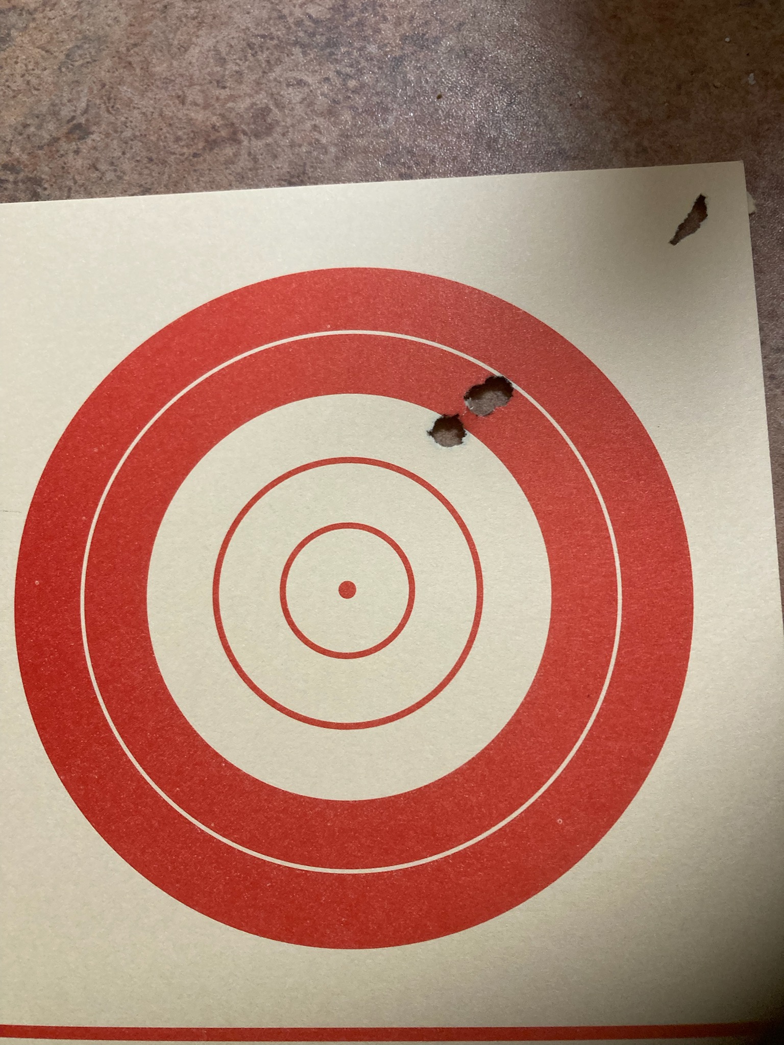

Well fellas, here’s an update from today’s load testing. In general 2206H is NOT the best powder for 10 twist barrels. It’s a go-to powder in 14 twist savage 99 lever guns in the past. My accurate fire forming loads weren’t good, could be I tried different PPU brass for these instead of the Hornady’s I used previously. One thing I will say about 2206H is it doesn’t generate barrel heat. However nosler 85’s seemed to like near max loads with it . Best group was with 34.5 gn 40 thou off the lands, probably a shade over 3000fps. Primers don’t look stressed at all. 35gn is noslers max listed loads for 100 gn bt’s and best accuracy apparently at approximately 2950fps. I’ll move on to 2208 next weekend which is supposedly a better powder for 10 twist barrels
34.5 gn 2206h , 85bt load . A little over 3000fps by ADI data. this group @ 100 yards.

What's wrong with that group?
Re: 250 savage
Post by bigrich » 03 Aug 2024, 5:06 pm
Oldbloke wrote:What's wrong with that group?
not a damn thing :D equivalent 2208 loads that will also shoot 100's are desired as 100's are the most flexible bullet weight for the little savage . also means i need less powder variety's . 2208 works great in my 308 and 303 , so it makes sense to see if my 250 likes it also . besides that , i do love to tinker..... :lol:

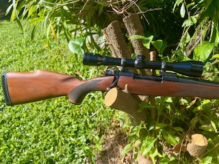

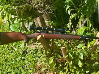

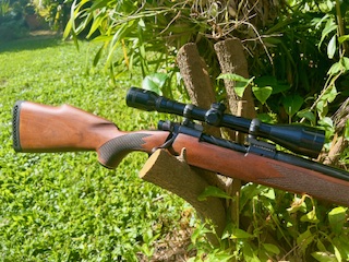

Got my little 250 made from Model 70 win that had a shot out barrel, Tony from TSE here in Brisbane was the man in charge of making the barrel and fitting it and all the bluing work, Im over the mood with how it turned out a real sweet shooter ! Mainly be used with 87gn projectiles for dogs and the odd pig.I tracked down some brass and some factory Remington 100gn corelokt bullets, Nearly done running i the barrel so i will really start honing in on some hand loads.
Once I find out how to post some pics Ill put some up.

Post by Mr.x » 17 Aug 2024, 3:03 pm
Hopefully this works
250sav
250sav
Mr.x
Posts: 52
Re: 250 savage
Post by bigrich » 17 Aug 2024, 7:35 pm
Mr.x wrote:Hopefully this works
that's a real nice ole xtr . i've had a few of those , and they can be a really accurate rifle . got a real nice style about them too . my local shop had a mint one in 243. i probably would've done a build on it if a nice old rem 700 hadn't come my way first . look forward to hearing on your load development . mine likes 85 bt's near max loads of 2206h and 2208 . 100's haven't been that inspiring . i'm going to go closer to max with the 06 and 08 and try some 2209 for the 100's. these 250's run with a wide range of powder, but working out their preference can be a bit of work . cheers
