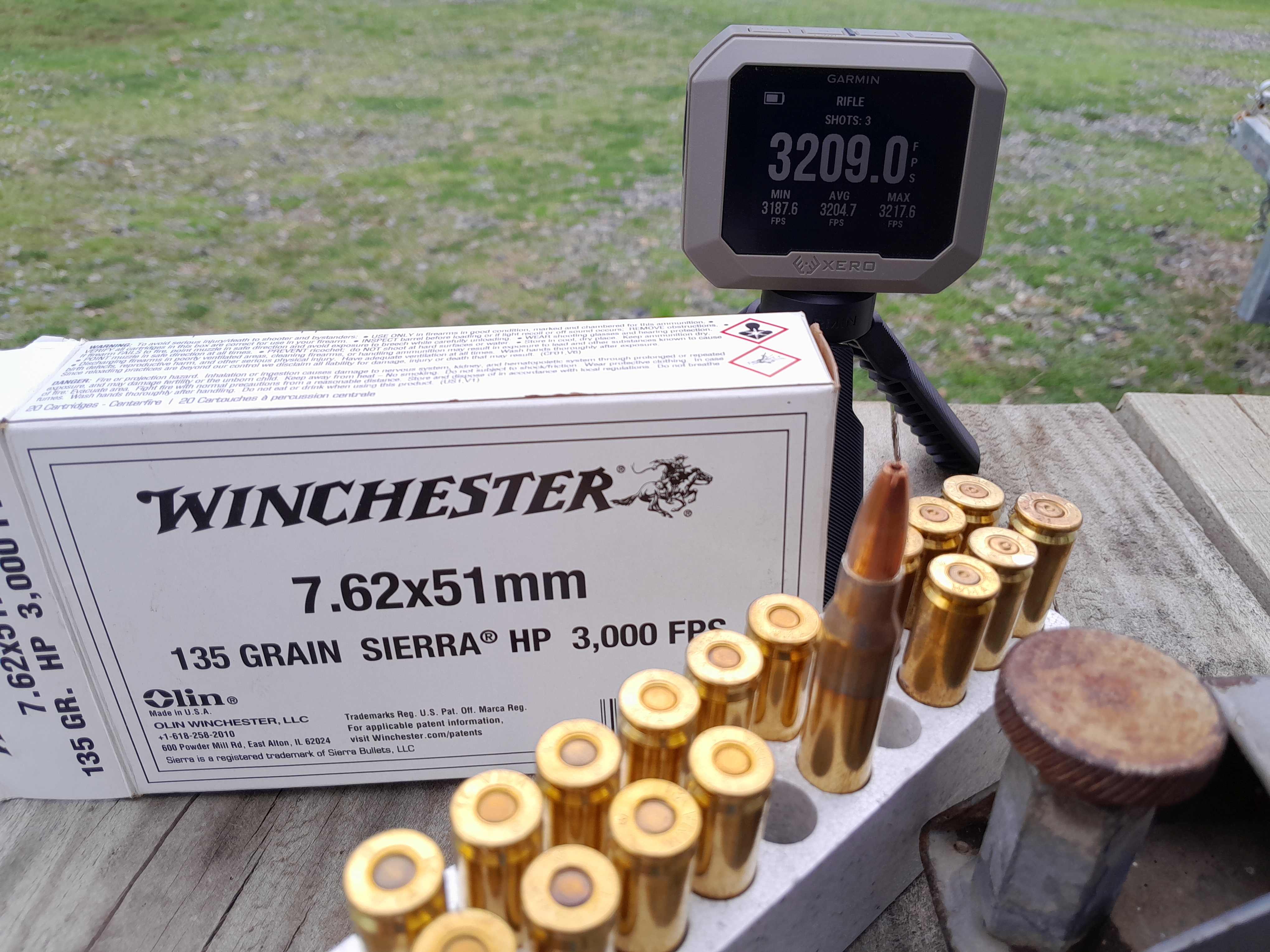

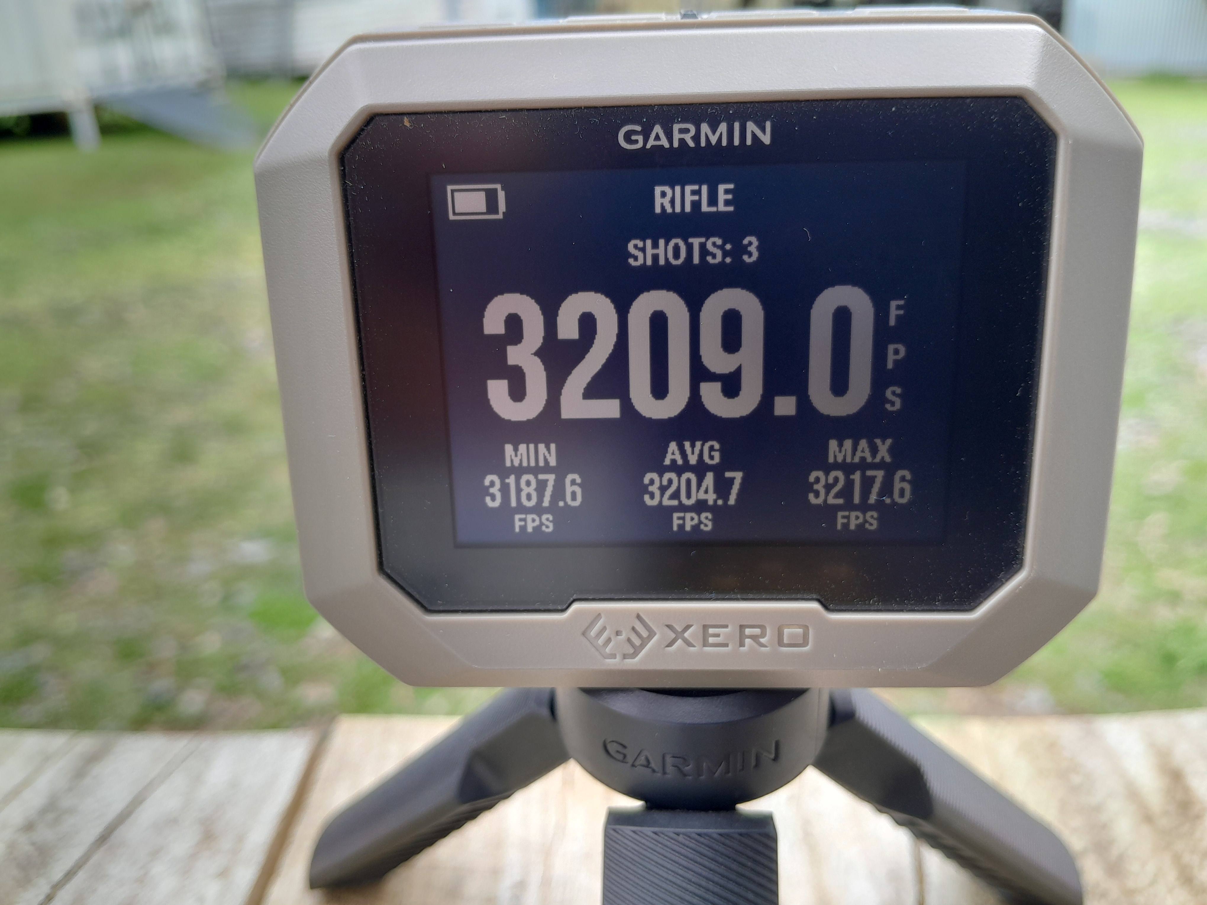

Was checking the sight-in on the paddock rifle I do runs with the new roo/pig/deer pro shooter. He likes me to take a rifle to take the opportunities on the far left of his 'Cruiser.
I wanted to use some ammo and get some more empties for my pet loads for other rifles so fired 3-shots to check zero but I set up the Chrony to see how truthful Winchester is on their stated speed.
People who use Chrony's a bit will know that nearly in all instances, ammo makers BS royally and their ammo very rarely gets near their quoted speed i.e. they lie and use long-for-calibre barrels, so they get higher speeds.
But what's amazing here is that this rifle has a 20" barrel, nice and handy especially for ute shooting. man, that's quick! You will also see the consistency of the measured speeds.

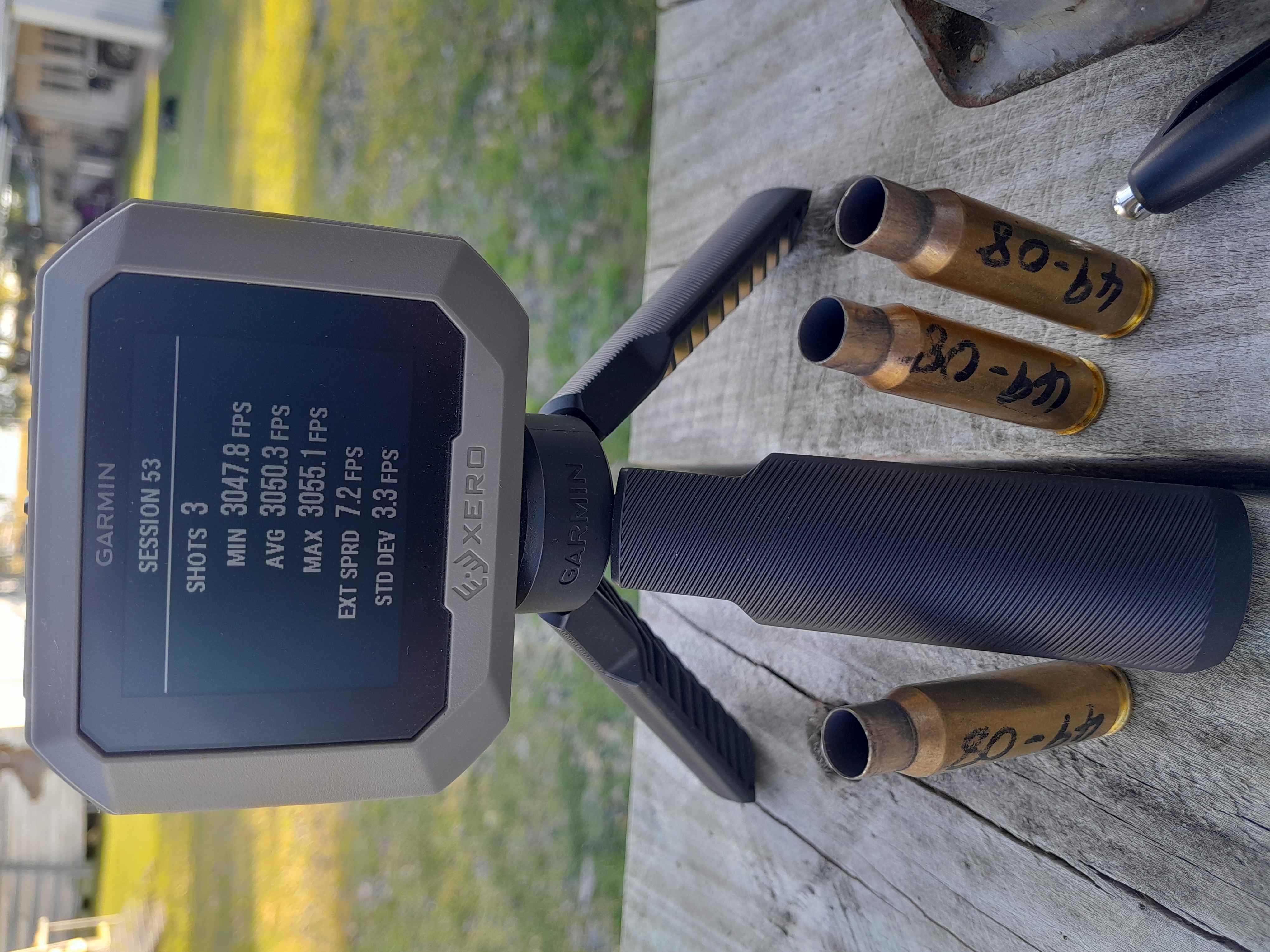

Post by Wapiti » 28 Nov 2025, 7:53 pm
Adding to that crazy speed in those factory loads, I thought I'd compare the same rifle, chrony and projectiles using ADI powders, 2206H and 2208.
Some members here might get something out of it too.

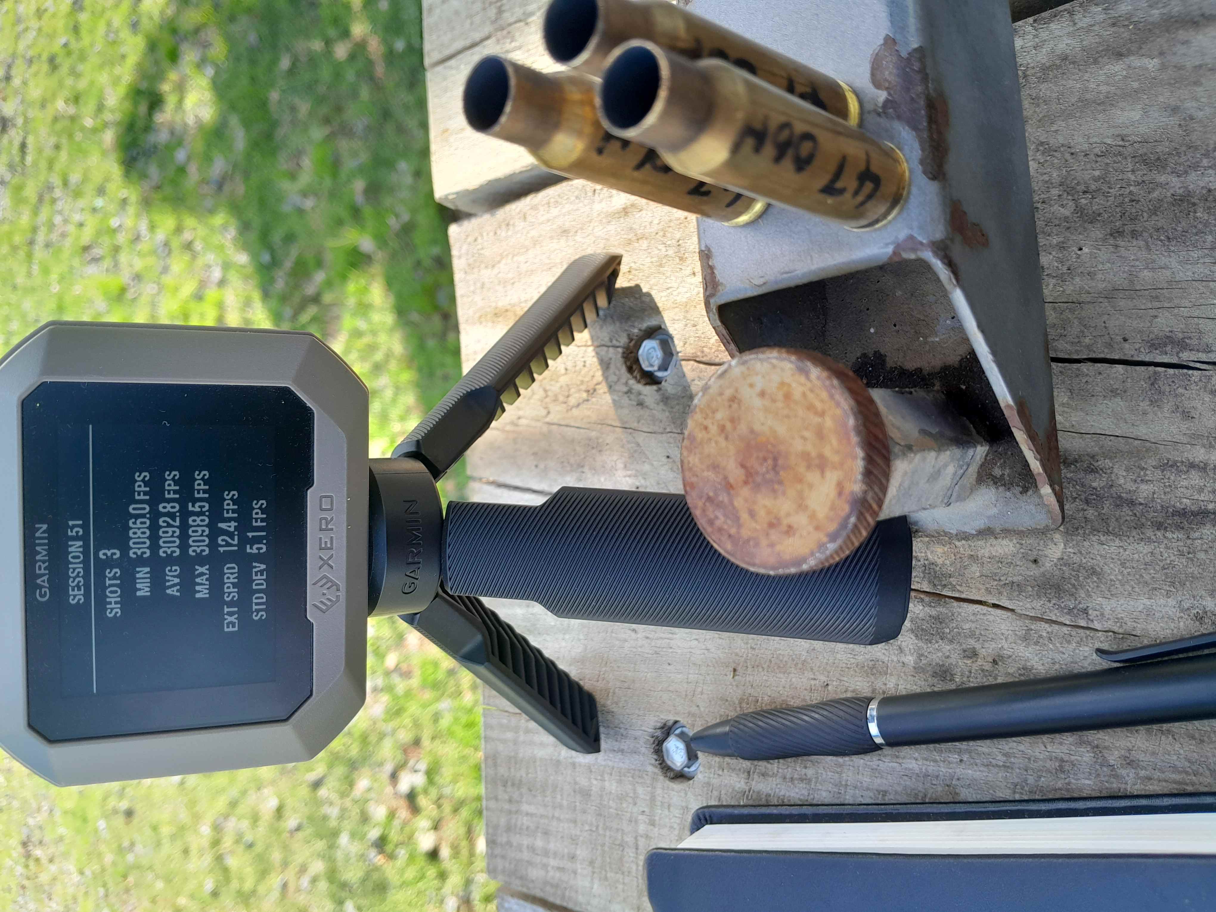

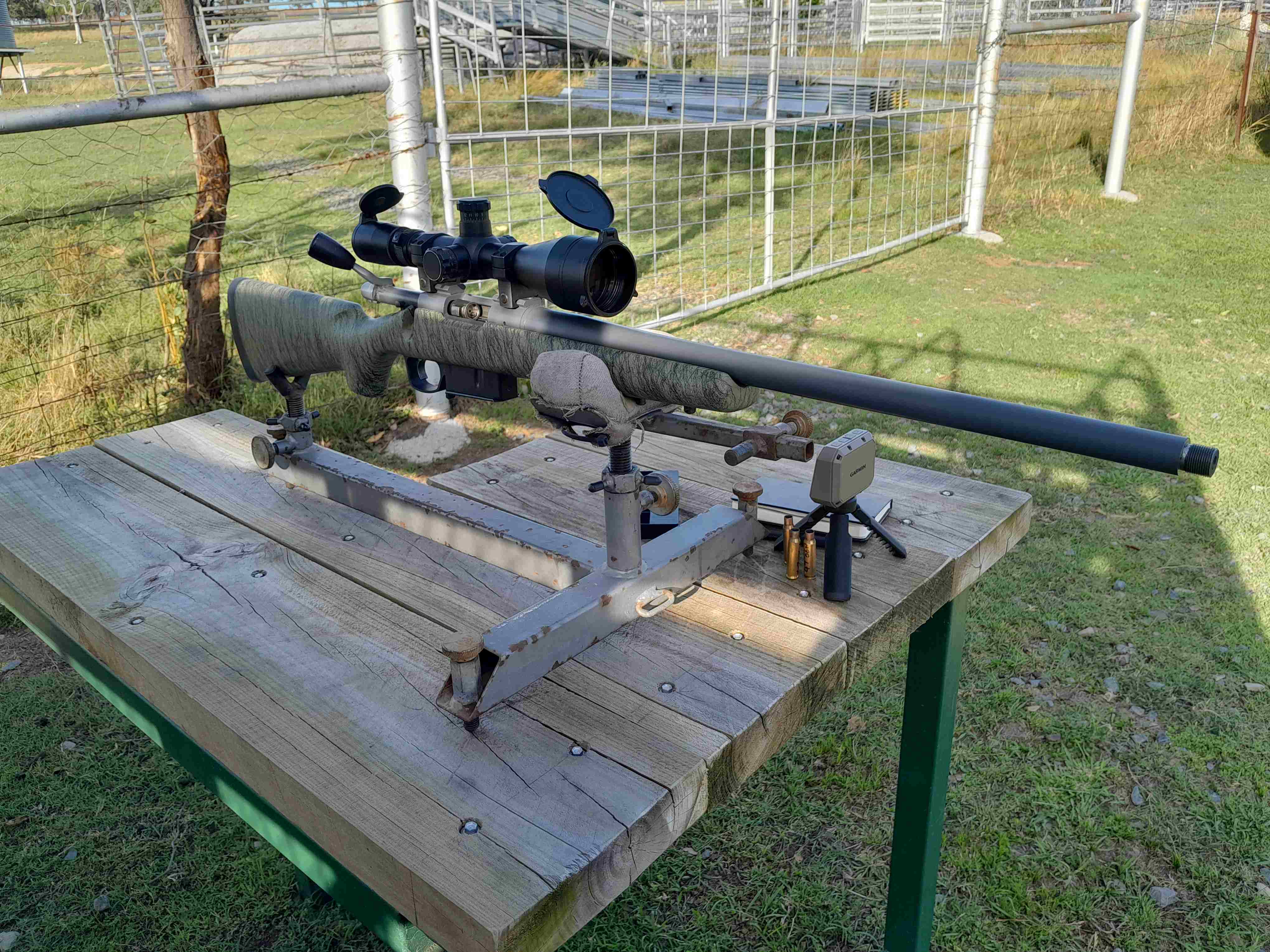

First. the old rifle. Shortened tight chamber done by me, barrel is a TSE 1-10" No.5 profile. Range to the target was 110m. Barrel hasn't been cleaned for about 300 rounds.

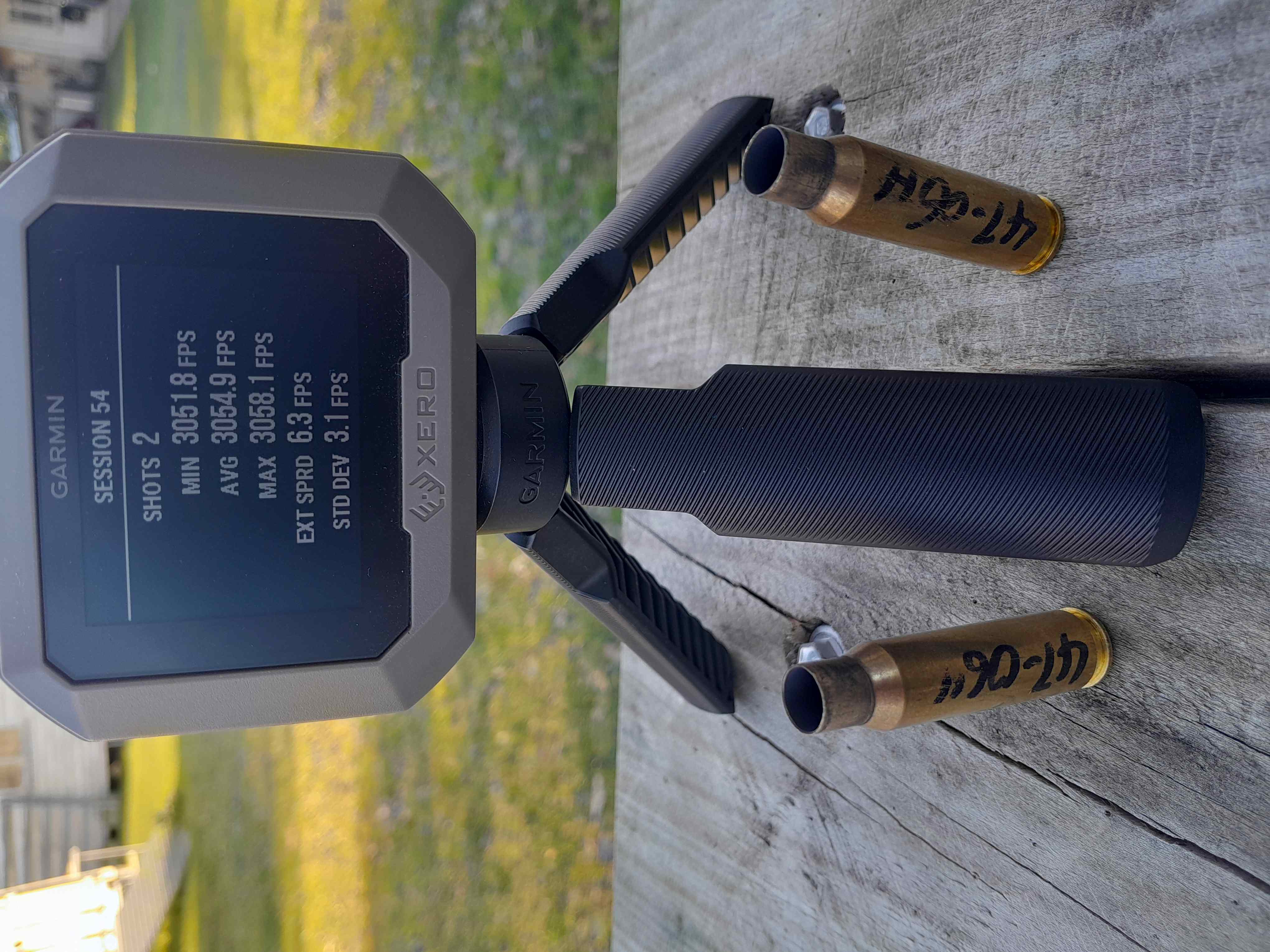

First load was 47gn/06H, which was in this rifle, pretty close to max and any hotter would be not a great idea for an every-temperature all-year round load.
The spread and standard deviation is excellent, showing a very good point in the load development (A reason why a Chrony is a great tool).
Very good velocity for thios weight projy in a 308 with a 20" barrel, but way behind that factory load!

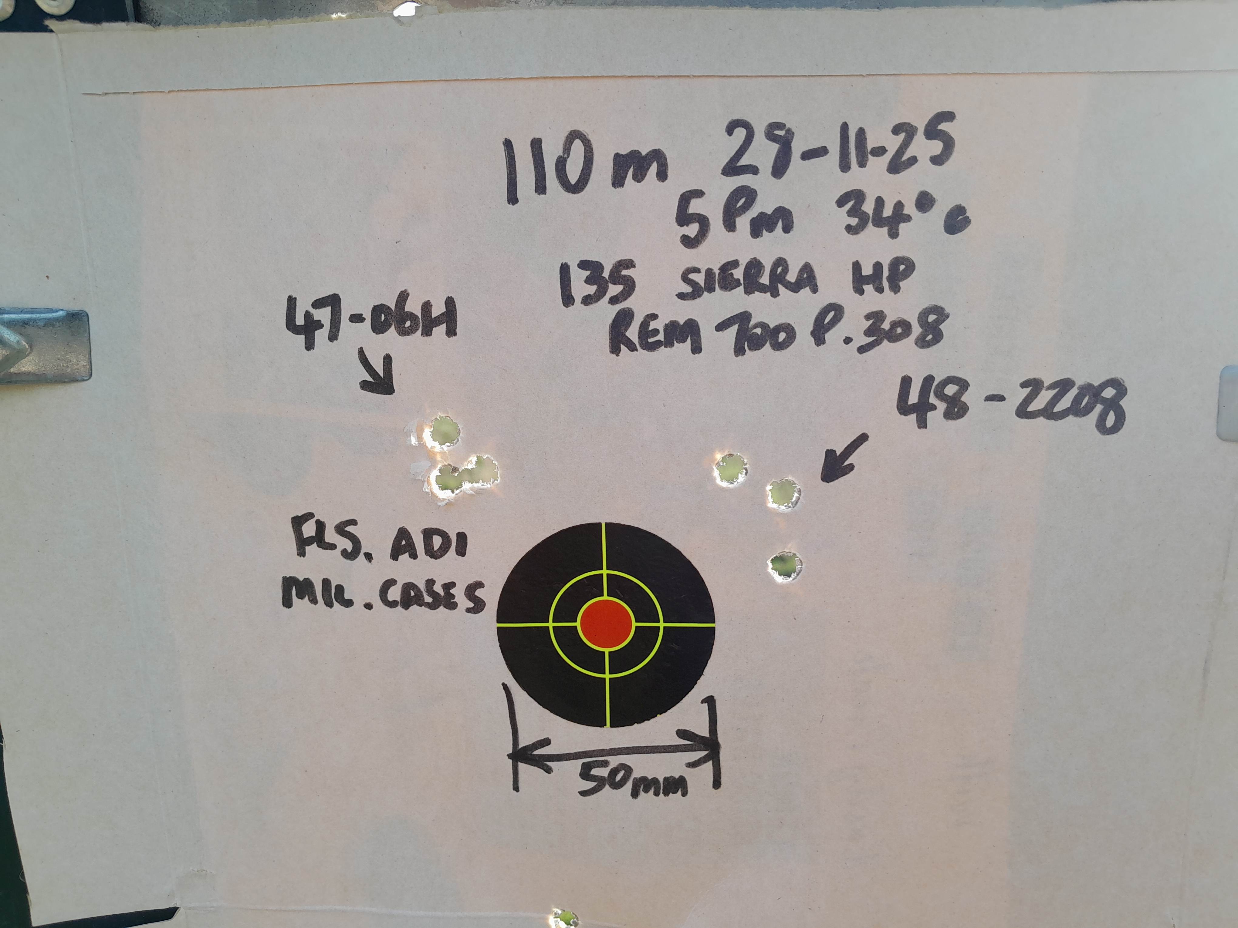

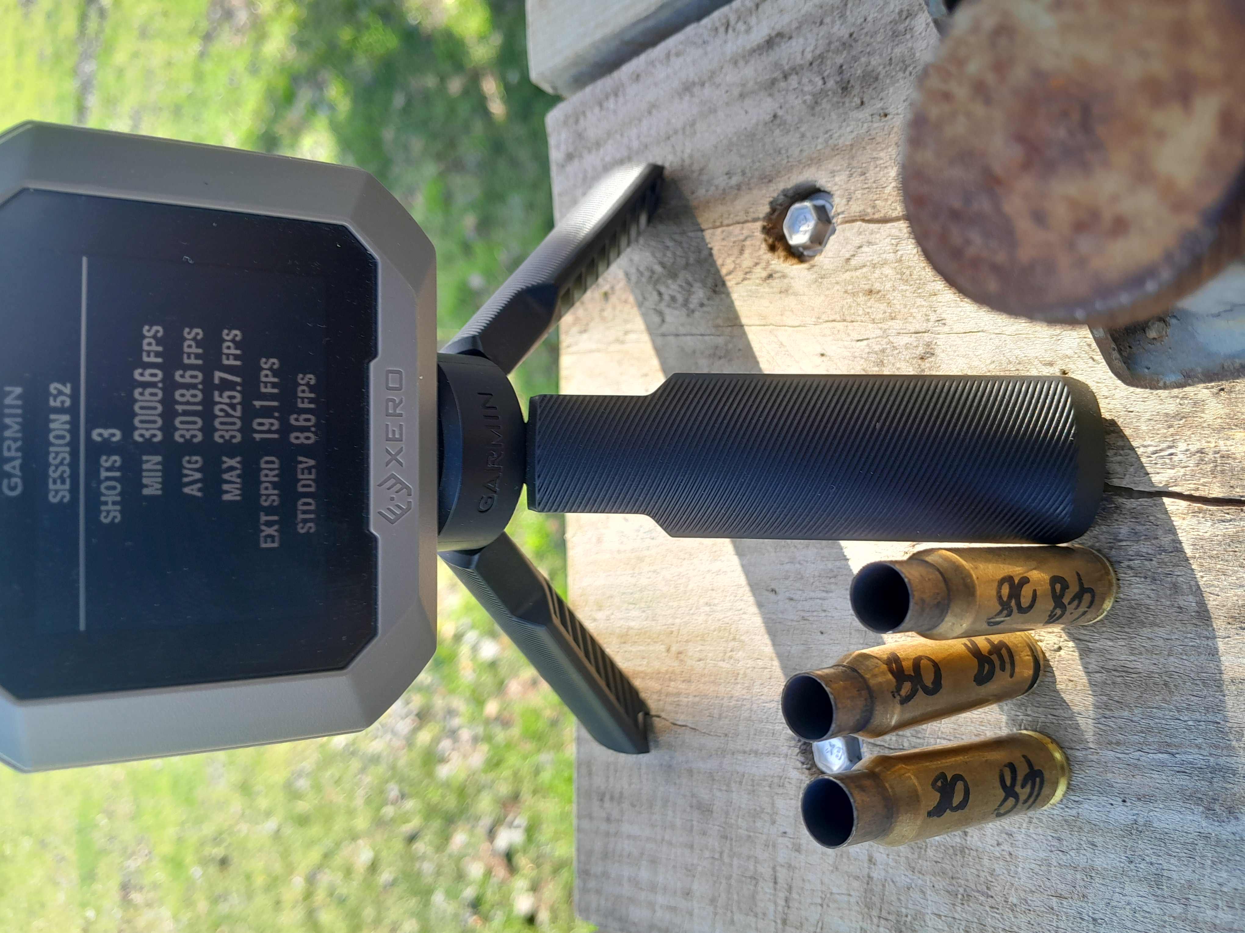

Next was the 2208. 48 grains is 2 grains under max, but in these thick ADI cases, 48gns fills the case to the top of the neck so I didn't want to go higher until I tried this first. Pressure signs are good, but I will need a LONG drop tube to get any more powder in.
And here's the target at 110m. You definitely can see how the super tight std. dev. and velocity spread in the 2206 load shows as a better group.
The chrony results proven on the target.
But still WAY under the Winchester factory load, but as I mentioned in an earlier post, speed is not the number one factor.

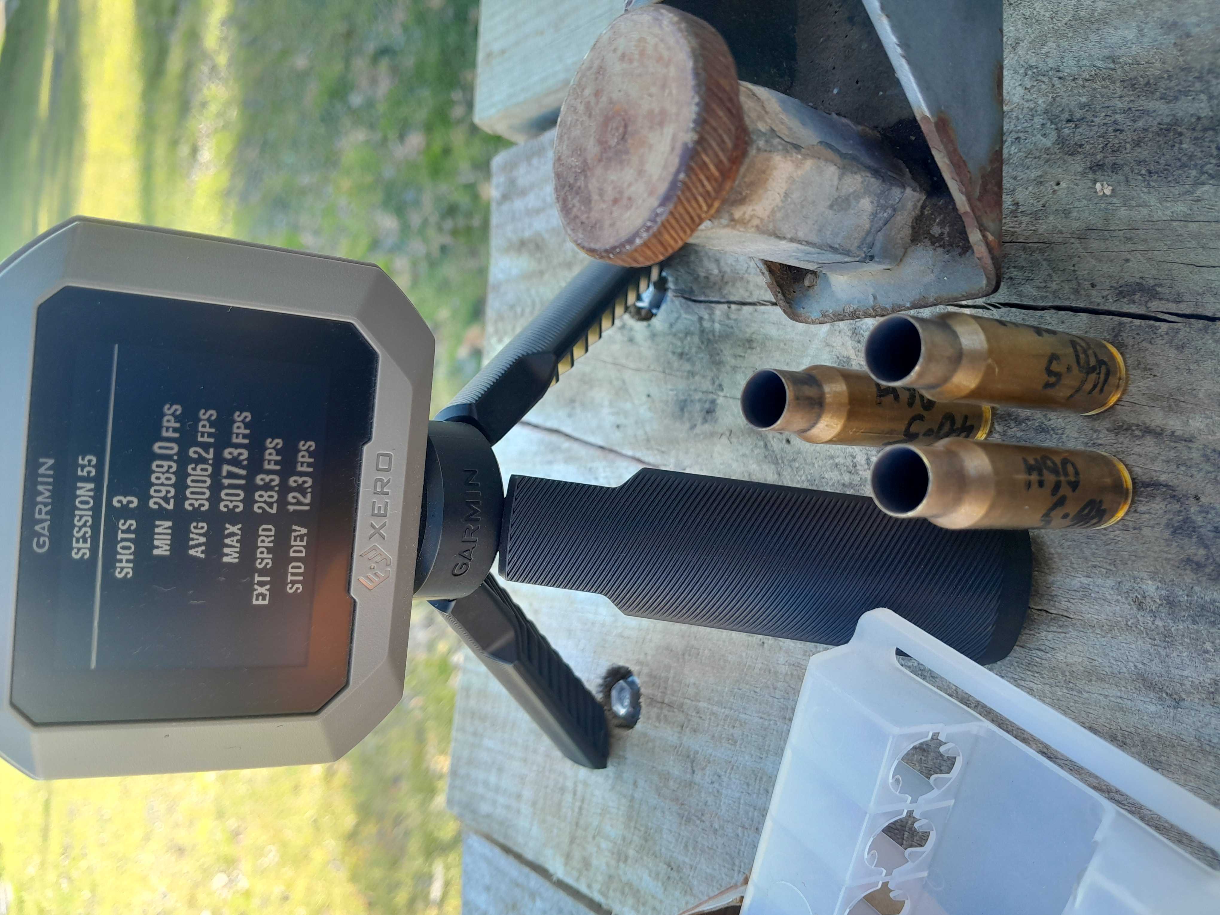

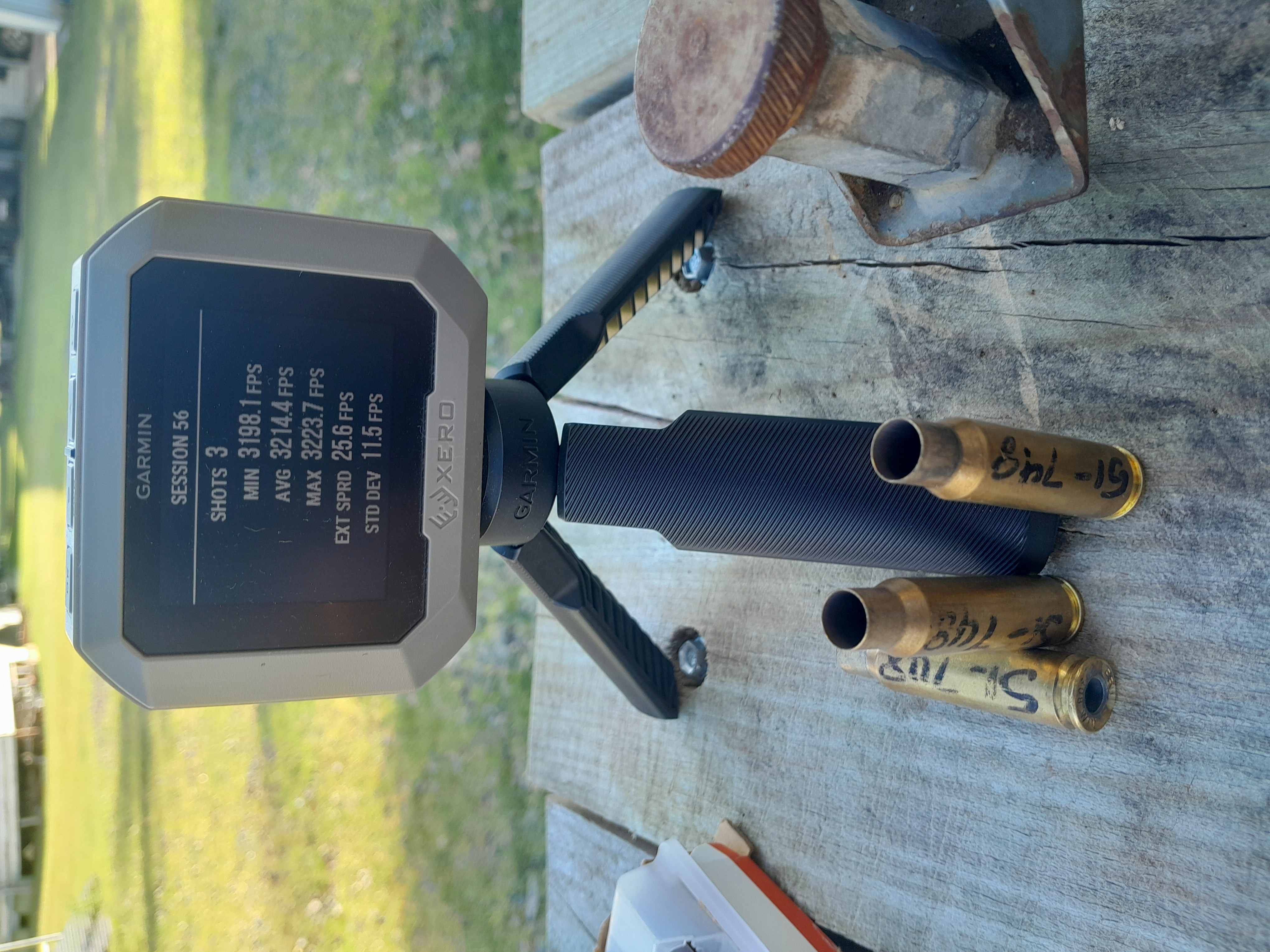

Post by Wapiti » 04 Dec 2025, 6:22 pm
So, it looks like Winchester 748 powder could easily be what's in those factory 135gn loads.
Using 51gns (1gn under Uncle Nick's max listed) we have over 3200fps, although the load is way too hot to use.
This was at 5.45pm, temp was 28'C.
First I tried 46.5gns 2206H, which cracked the 3000fps mark which is supposed to be the realm of the 125 and 130gn 308 loads, if you're lucky. This is using the Sierra 135gn hollowpoint Gameking varmint, as are all these loads.
Next, came the 51gns of 748. Again, supposedly 1gn below max but as they say, every gun is different, approach max loads carefully.

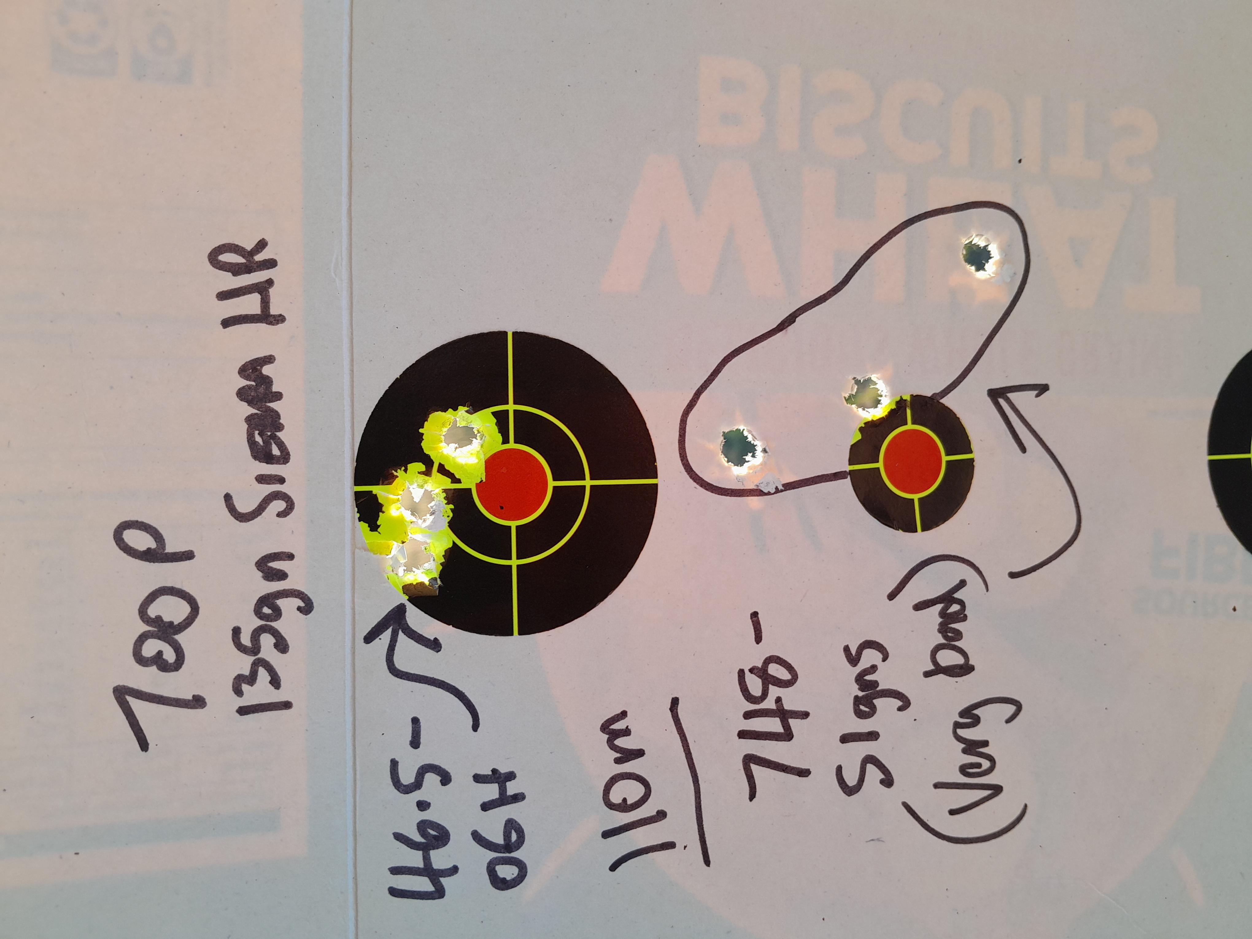

Now the target. Experienced reloaders who study chronograph data relating to spread and std. dev. will see, there are spots earlier in the test above somewhere where these numbers are excellent and within a few fps. These should be the best loads for consistency and in theory, "accuracy".
Other previous loads using these projectiles with ADI powder gave better results. The sample size needs to be larger though.
Have fun.
I wonder how 49 or 50gns of 748 would shoot.
