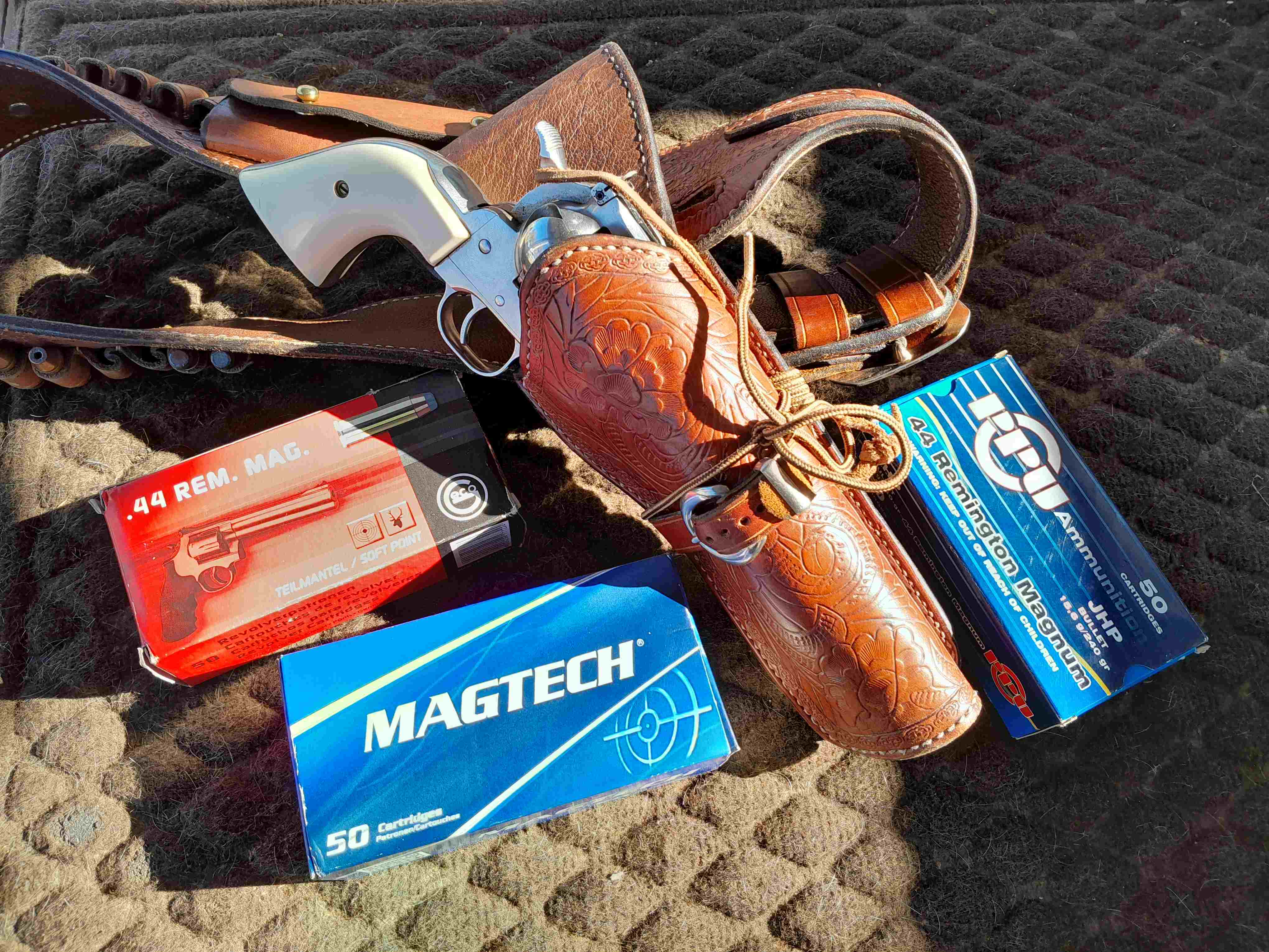

Not sure if I ever posted this here, have put it up in a few sites.
Test gun was 20" barrel Rossi 1892 lever action in 44 mag.
Chrony was a prochrono- 5 yards from the barrel and then a Garmin C-1
Ranked in order of Kinetic Energy, weakest to strongest.

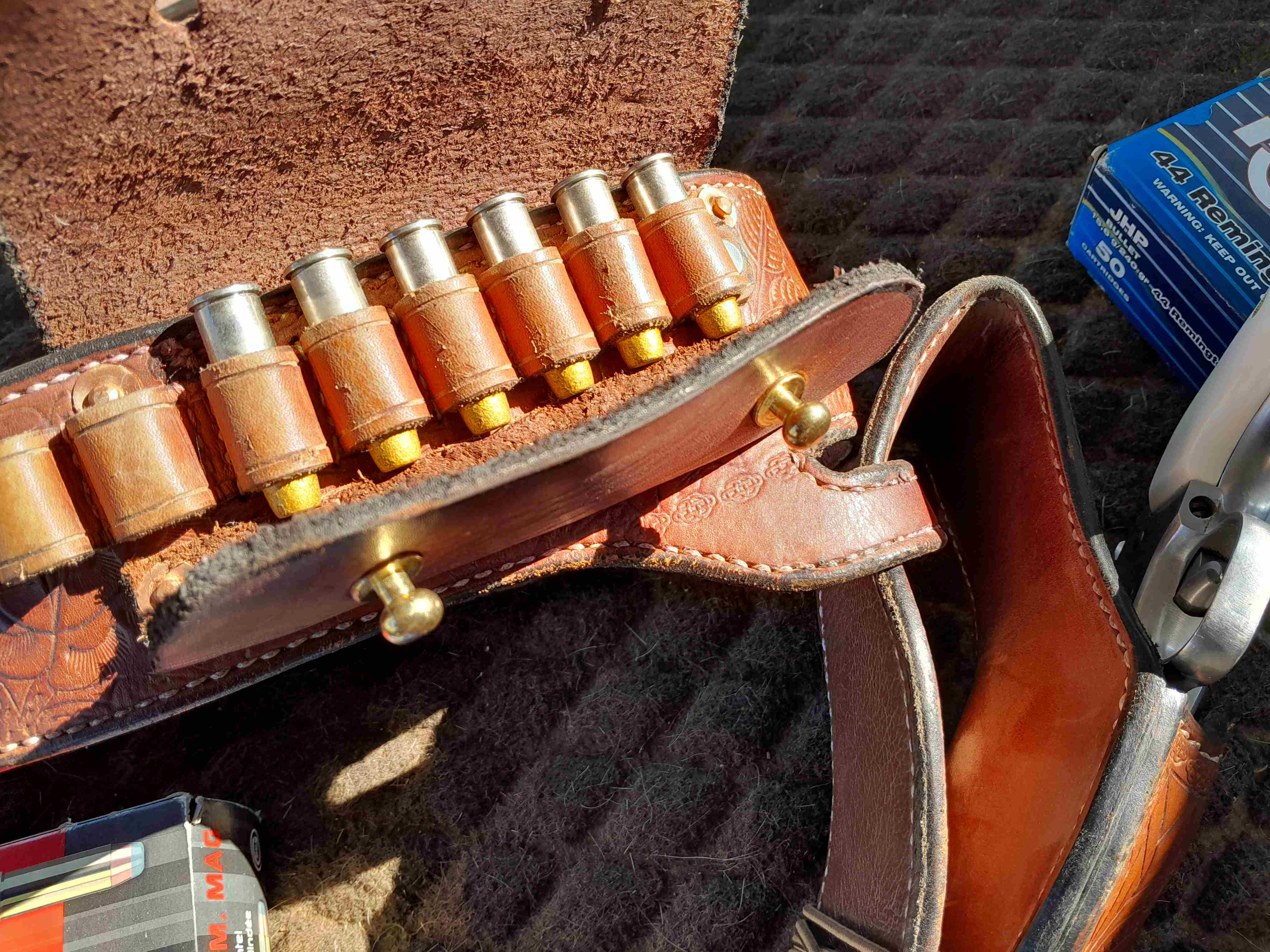

To add to Mick's great effort and add a bit of colour, here's the ammo we've used for the last few years in a pistol.
Just a 5-1/2" barrel, so I would imagine way under Mick's velocities.
BUT... they work very well, with quite different projectiles between them, but for what I've used them for, pigs mainly trying headshots or just behind the shoulder. Sometimes they go where intended, sometimes a little off. The short sight radius isn't friendly for speed, which is why I put a peep on the rear.
Geco, Magtech and PPU.
All I suppose, one would say is el-cheapo ammo, no flashy projectiles or big names, or big prices either.
All absolutely shatter a big boars skull, just break it up, and will punch right through a big boar and scatter stuff all over the grass the other side. But, I'm talking close here.
In the past I've used a 357 before ditching it for a 9mm semi, and it was VERY markedly lower powered and got me into big trouble once. 357 might be OK in a longer barrel rifle, but too anaemic in a 6" revolver, which I used it in.

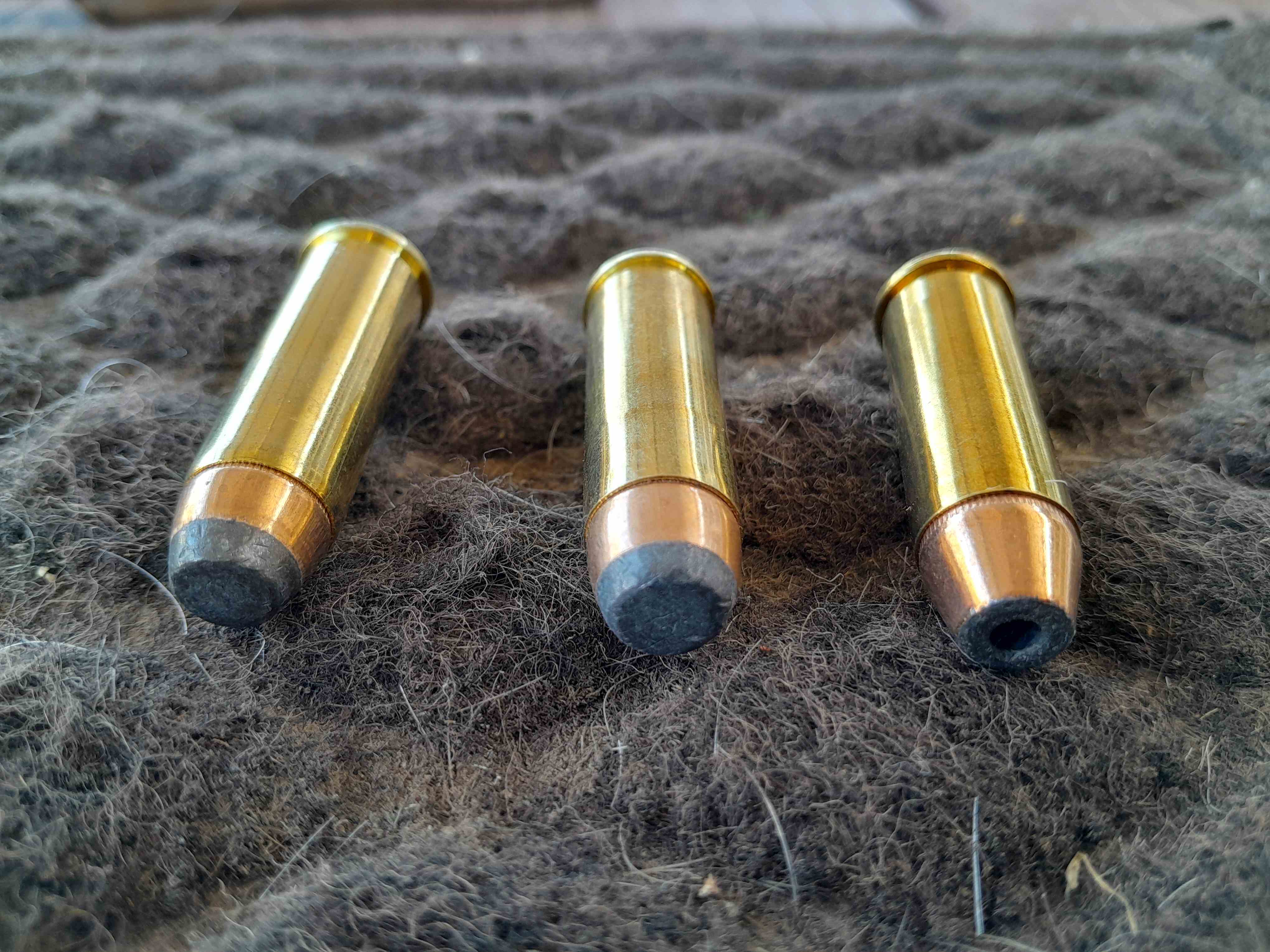

The projectiles are quite different.
Magtech left, Geco centre, PPU hollow-point right.
The Geco in the centre has a massive flat lead tip. Works great. The PPU seems to mushroom better, because on a few occasions It's slowed down by expanding and stayed inside a pigs chest.
The others from memory, smash right through and eject matter out the far side and a big hole.
