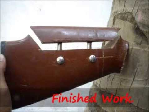

When you say " a propper one " do you mean done like this ?
im bussy researching adjustable comb hardware now, I'm confident I can do a neat job of it myself.
I have pulled out the kids play dough and molded a bit to bring it up to the right height, I will need 20 mm of added height to get where I need to be wich as suggested above will be a problem when removing the bolt so what ever I do it needs to be easly removed or adjustable preferably with indexing marks so it can be returned to the correct position without fuss.
I found a good explanation of the process of fitting adjustable comb hardware.
http://www.bkwebstergunsmith.com/adjust ... rsion.html
and some examples of rough as hessian underpants jobs.

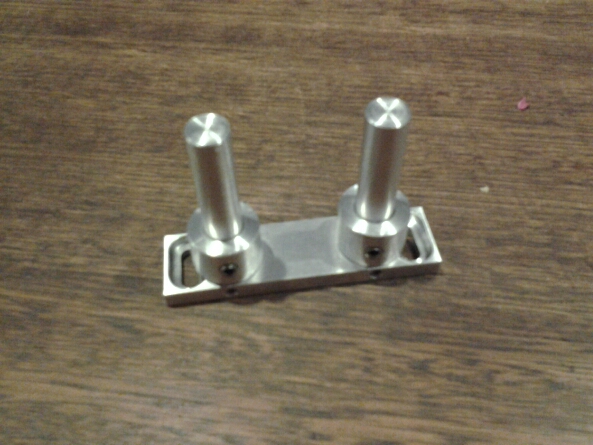

So my hardware has arrived for the comb modification, I found one on ebay. Yet another project when i said to myself i should have bought a mini lathe.
I would have preferred one with adjustable posts rather than one with slotted fastening holes but I think it will be fine.

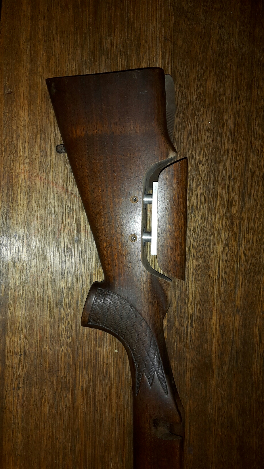

Project update
I've found a Remington rifle stock at the NESSCI swap meet that was held yesterday, it's perfect for me to finally try my hand at fitting my adjustable comb hardware to.... and I don't need to ruin my BDL stock trying.
I've started by cutting a card template and sticking it to the centre line of the comb with tape on both sides making a hynge so I could trace an accurate line to cut along.
I've then cut the first two angled cuts with a hacksaw because it cuts straight and thin.
Then I used a hand scroll saw to cut the radius corners and switched back to the hacksaw for the straight horizontal cut.
A little carefull sanding and it's shaping up well.
2015-09-14 21.27.03.jpg (1.33 MiB) Viewed 13610 times
I've still got some work ahead of me because this stock is from a adl ? with no provisions for a floor plate so I'm going to have to cut and shape that area to.
Re: Rifle fit and adjustable cheek rest
Post by Arth » 15 Sep 2015, 2:58 pm
Looks pro so far mate.
Arth
Posts: 173
Post by on_one_wheel » 15 Sep 2015, 6:29 pm
Almost there, just some cleaning up stain and polish and I'm done .
Like they say, rough enough for out bush. :thumbsup:

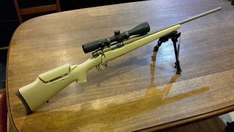

Got the floor plate fitted , finished the adjustable comb, fitted a rubber recoil pad to replace the hard plastic Remington one and painted the stock :o because the paint stripper I used to remove the dark varnish was too strong for the wood and turned it grey :violin:
Now I need a new pair of action screws as mine are a fraction too short for this stock.
