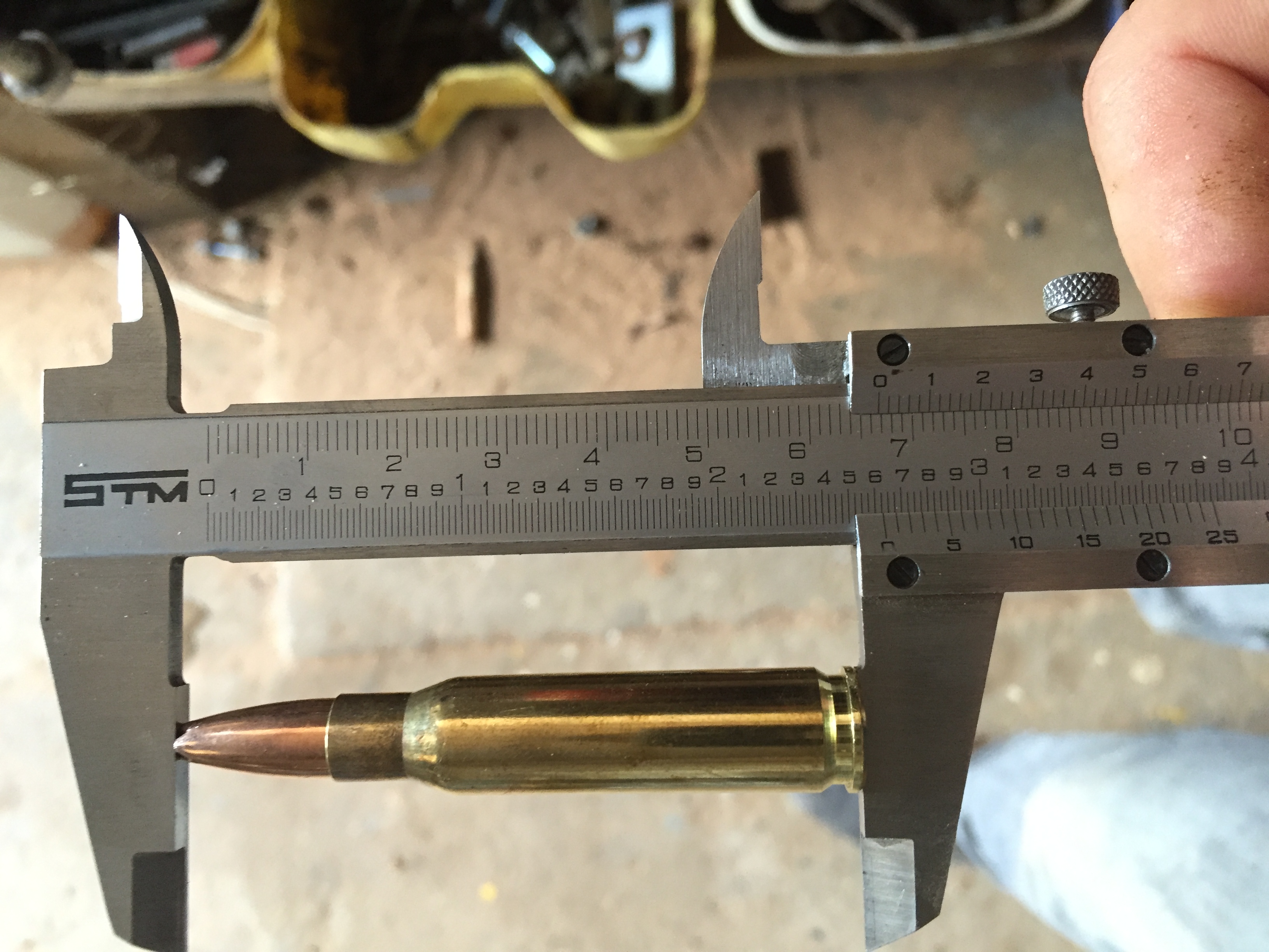

Post by MalleeFarmer » 30 Apr 2016, 3:24 pm
Scotty, here is a picture of a round in calipers total OAL of 2.628"
Another thing you could do is load a dummy round with a very lightly seated bullet to get a seating depth on the lands for your rifle.

MalleeFarmer wrote:Scotty, here is a picture of a round in calipers total OAL of 2.628"
Cheers mallee, at the moment I have 20rnds loaded starting at 46.5gr working up to 47.5 of AR2208, haven't got data for this projectile so used data for Speer 130gr HP and backed it off a bit, loaded rounds are seated at 2.710", which was from a load I found for the Sierra 135gr matchking HP online.

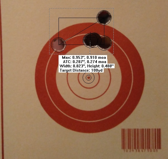

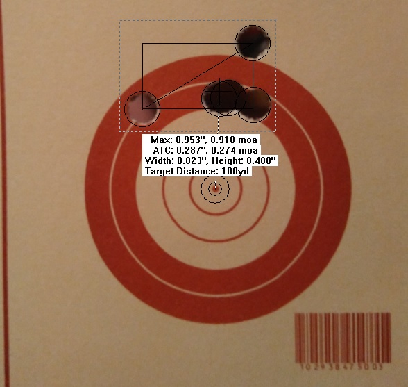

Post by scotty87 » 10 May 2016, 6:01 pm
tested my first lot of reloads with the 135gr Sierra 2124 projectiles over the weekend, shows alot of promise, charges were well and truly around the minimum with no signs of high pressure in any of the loads I shot, I'm using data from adi for the speer 130gr HP as a guide.
My HOWA sporter much preffered these hollow points over the 165gr spitzers I have been trying to develop a load for.
has a promise of being a good projectile for this rifle if I do my part, which is something i need to work on as evidenced by these targets :lol: with the "fliers" pulling to the right, i'm thinking I need a bit more practice on the trigger as i've likely got a bit of a flinch to work out.

probably gonna pick up a box of the factory ammo to shoot with my next lot of reloads to see how they compare.

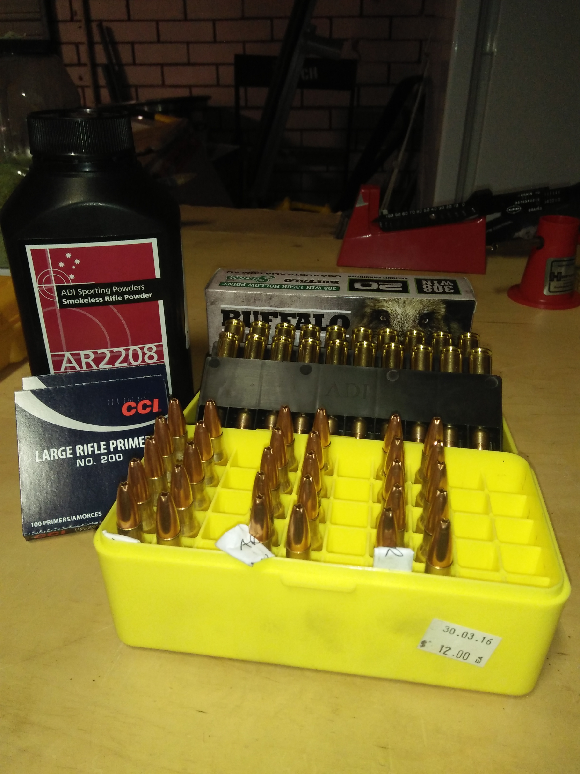

Got my weekend sorted, next batch of loads to test, 47.5, 48, 48.5gr AR2208 COAL 2.635" picked up 20 of the factory loads to compare.
Pulled a bullet from a factory load, charge weighed just under 48gr, not sure what the powder is, grains were quite long.

Post by MalleeFarmer » 15 May 2016, 8:32 am
I'd assume ADI would use their own powders in factory loads. Does it look like AR2208? Post a pic just curious.

this is my best group with my last batch of reloads, 48.5GR AR2208, 2.635 OAL, this group was alot better than anything else I shot that day, I held the foreend in front of the rest for this group and it tightened up nicely.
I'm pretty stoked to get this from a sporter barrel, I reckon I'll reload the next batch using the once fired OSA brass and load 48.5GR varying the seating depth from 2.635 out to 2.710ish moving up in 20 thou increments and looking for pressure signs.
best group I shot with the OSA 135gr factory load was 1.2-1.5 inch @ 100m but I didnt have good control over the fore end, I was trying to let it free recoil, which it didn't seem to like. I reckon i'll be either buying more of this factory ammo or in the least a batch of OSA brass as my once fired cases look like they'll make great reloads.
