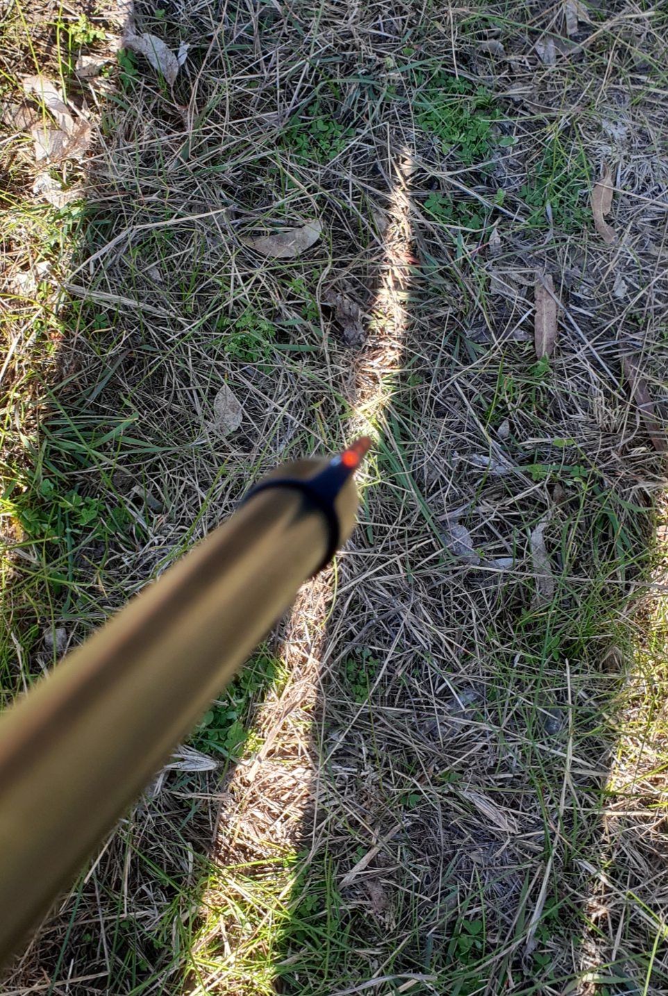

Ok,so I've had a hankering for a combination gun for years,in 410/22,but it seemed like most of the ones for sale were butt ugly tacticool plastic crap. Then I found out about the double badger. Don't know how it slipped under my radar but it did. So a call to my lgs a month ago,and a lot of stuffing around with Raytrade ( amazing how quickly they can send something when you contact them direct ) and my gun arrived Thursday.
First impressions.
It's a neat little thing. Really short but the stock is made for an adult. The lever that opens it,which is formed by the trigger guard and gives it a ruger no.1 look,is kinda floppy but actually needs a bit of oomph at the last bit of travel to actually open it.
It's kinda heavy for its size,they say its 5.8lb,and I'd believe them. It balances nearly on the hinge pin which is nice. Handles nicely too.
The front trigger that operates the lower 410 barrel is actually very good and breaks cleanly and fairly light. The rear trigger fires the upper 22 barrel and has a mile of creep and breaks a bit heavier which is disappointing.

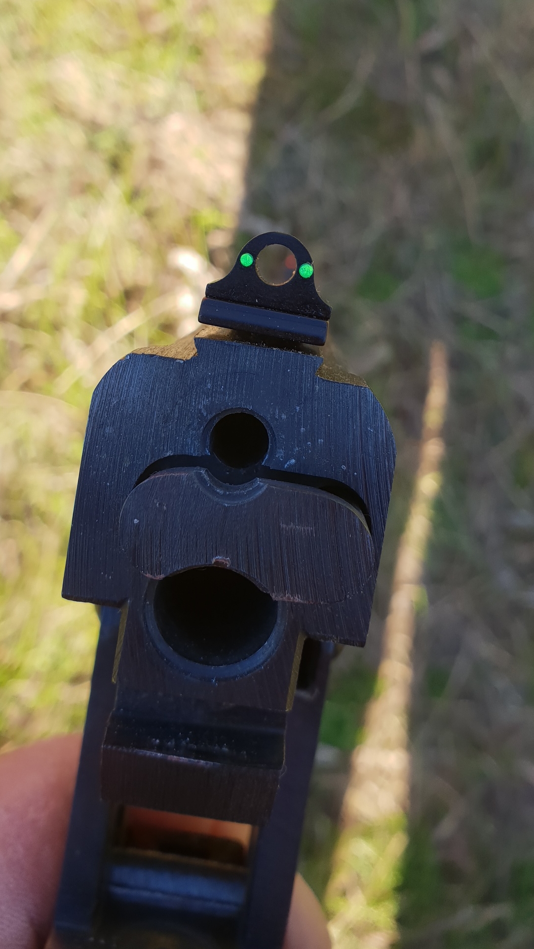

The sights are fibre optic ghost ring style and are far too coarse imo for accurate shooting of the 22 barrel. You can remove the rear sight and use the tiny rail provided to mount a scope, which is what I will do. I did mount my Leopold vx3 1.5-5x20 on it briefly but I need different rings to make it work,a d it added weight.
I have shot it a little bit. Not enough to form much of an opinion other than I'd not use the shotgun past 25m. Its claimed a couple of starlings and I put down a sheep at work with a 410 slug.
It folds in half,which is very handy.
More pictures and reviews to come today.....

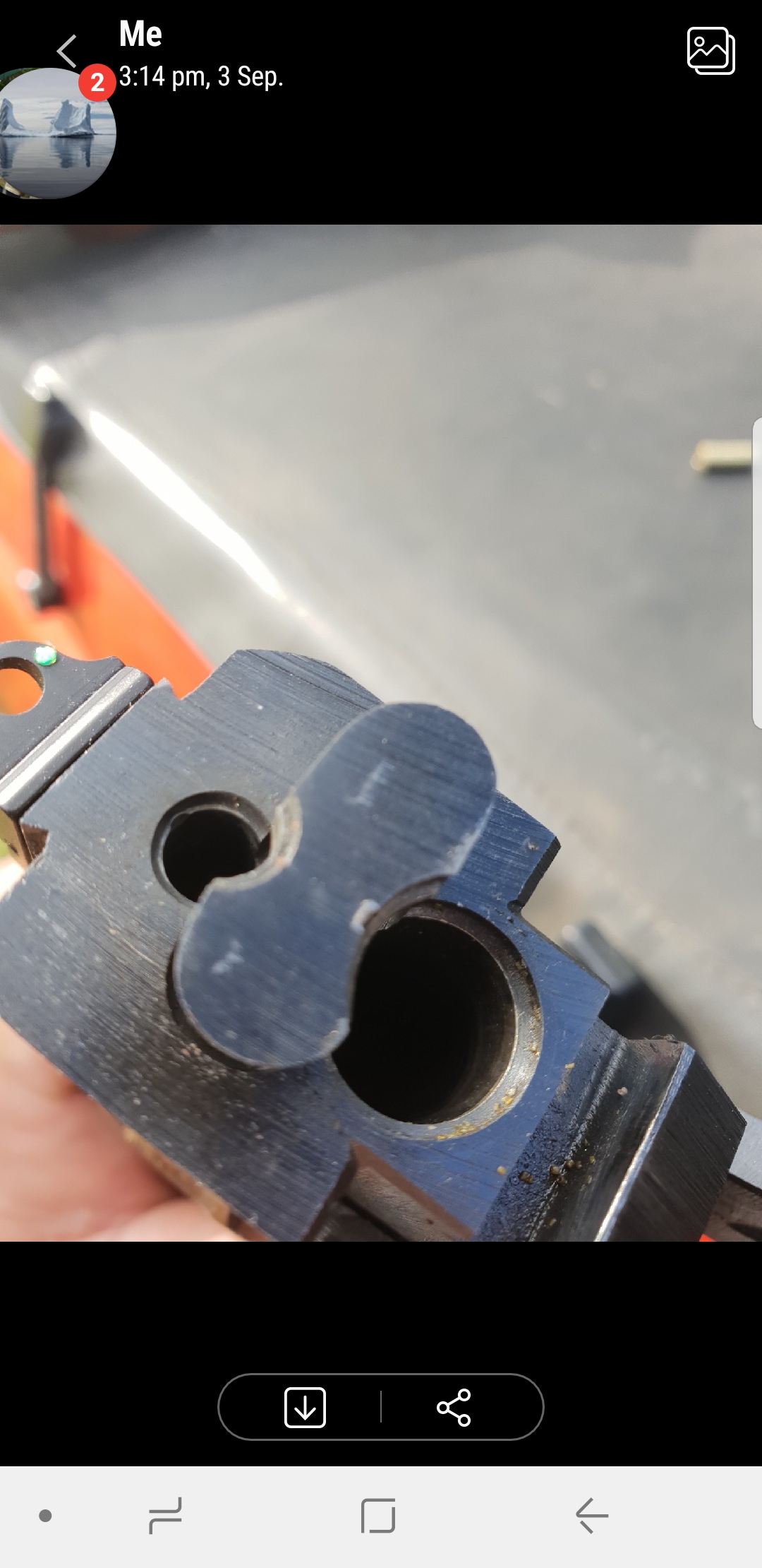

For starters,the chamber of the 410 barrel was offset to the barrel by a considerable amount,a fact that was confirmed by 2 independent sources in 2 different states,and by the rep,to be normal for the 410....very poor.
Secondly,a week after buying it the front optic fibre fell out....

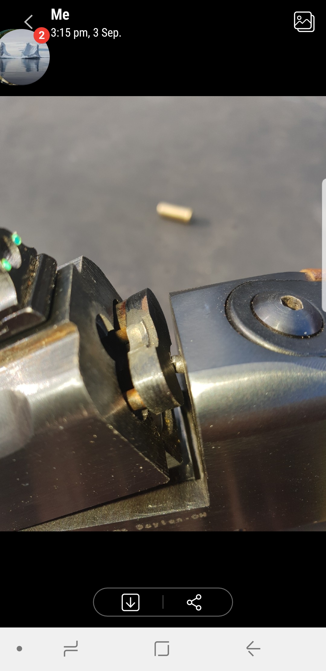

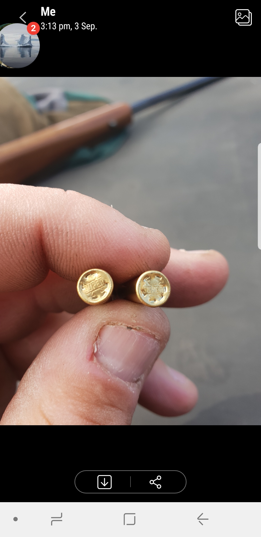

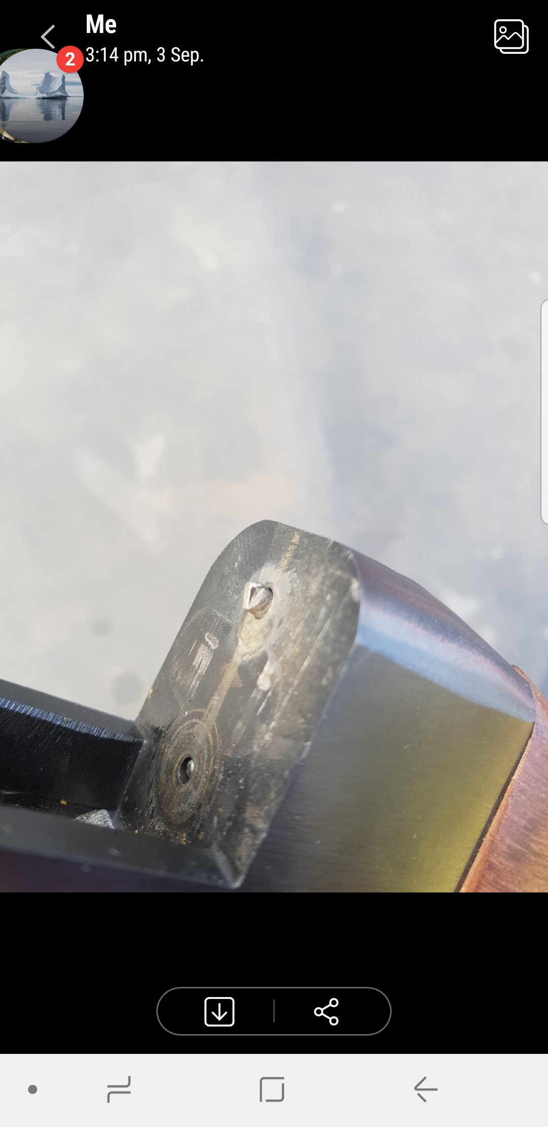

Thirdly, and the worst thing,within a month of owning it,the top of the 22 barrel firing pin had been chewed off because it sometimes wouldn't retract properly and the extractor would hit it as you closed the gun. It got to the point it wouldn't fire 22 rounds coz the firing pin hit to far inside the rim. When I took it back not only was I told I wasn't operating it properly ( load of horse s**t ) but I was also told that they could fix it,or replace it,but if it happened again they wouldn't honour the warranty. And the only way I could ensure it not happening again was to modify the extractor...voiding the warranty anyway. And a quick search of the net showed that the problem wasn't unknown....so when I got the chance to get my money back I leaped at it !
