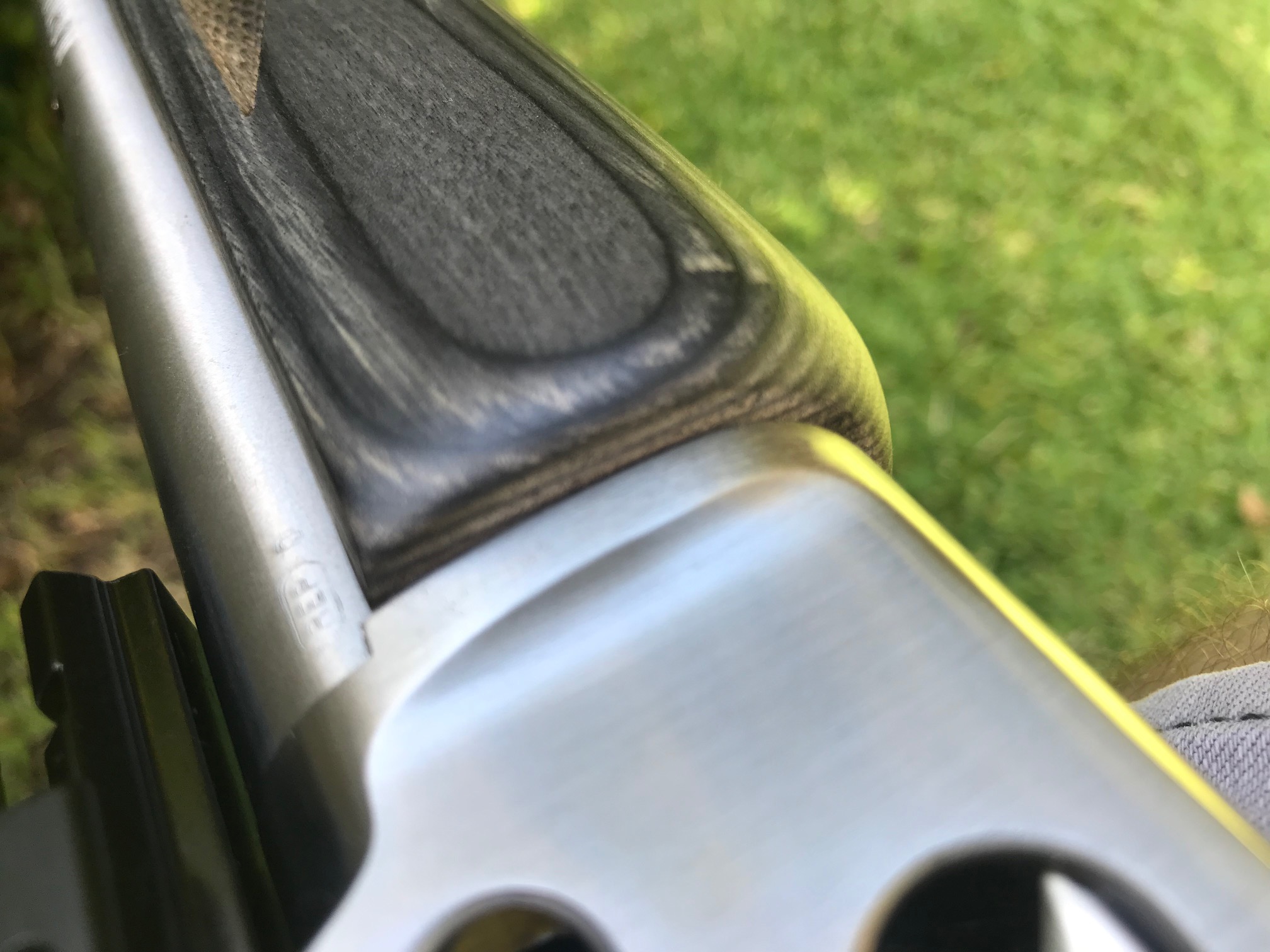

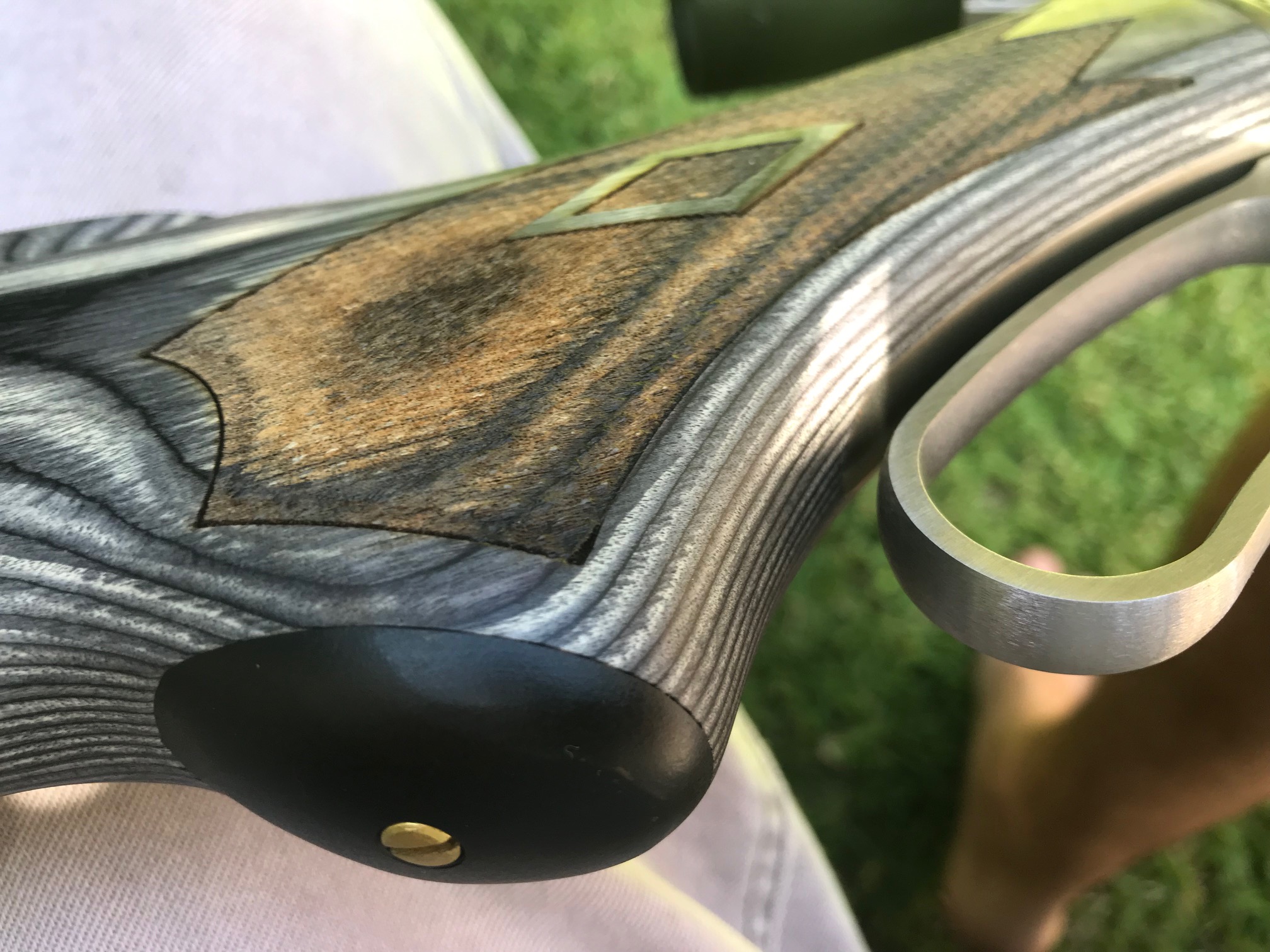

The squishy, recoil absorbing buttplate is finished perfectly, and does a superb job at soaking up any recoil of even the hottest factory loads. It’s on-par, if not better than the aftermarket limbsaver pad I had to add to my 336w:
recoil pad
Even though it’s a laminated timber stock, the colouring and checkering is well finished. A small polymercap underneath the grip I discovered is also a nice touch and oozes quality:

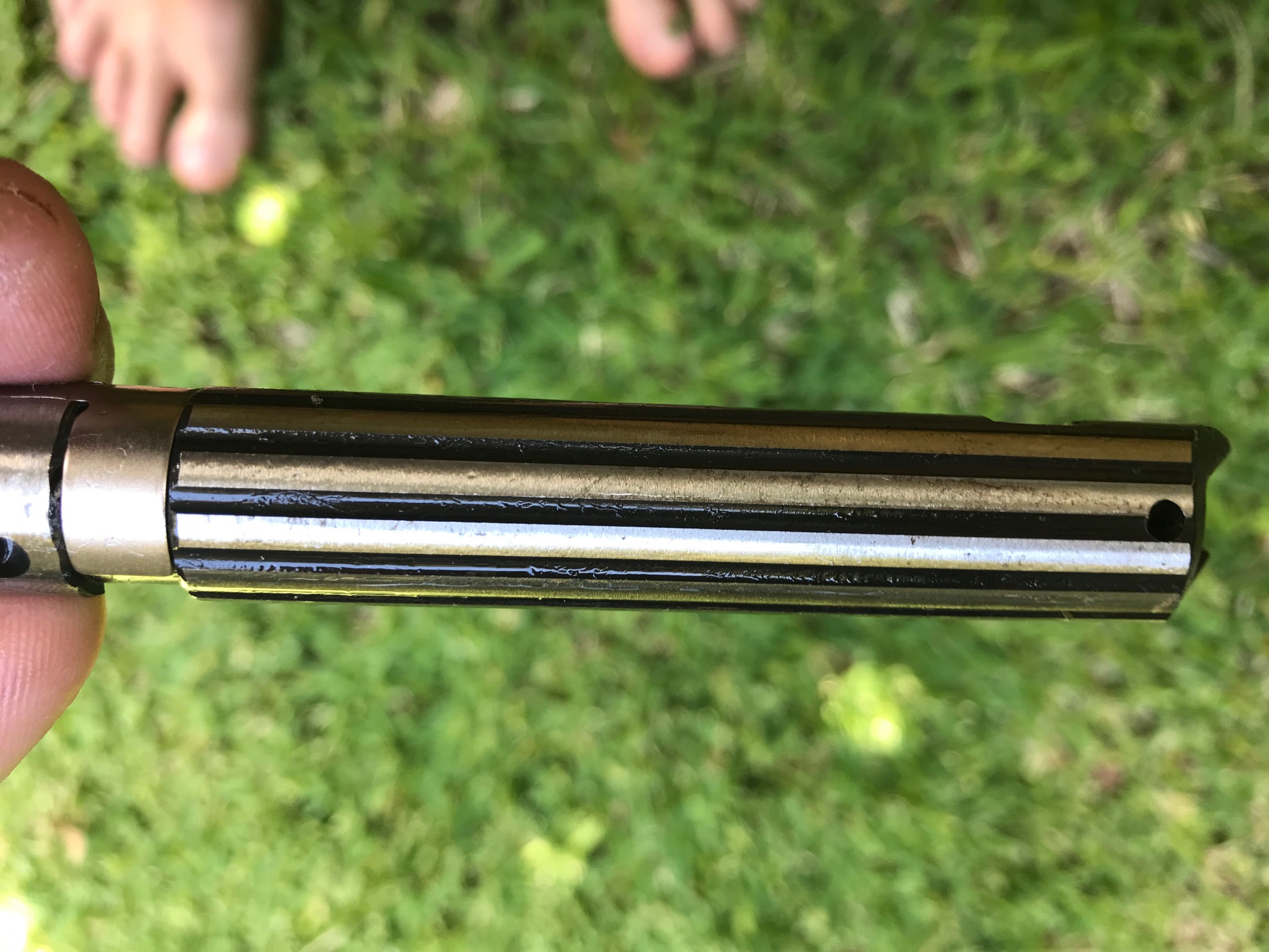

The bolt is fluted, reducing the bearing surfaces and thus helping with an overall smoother action:
fluted bolt

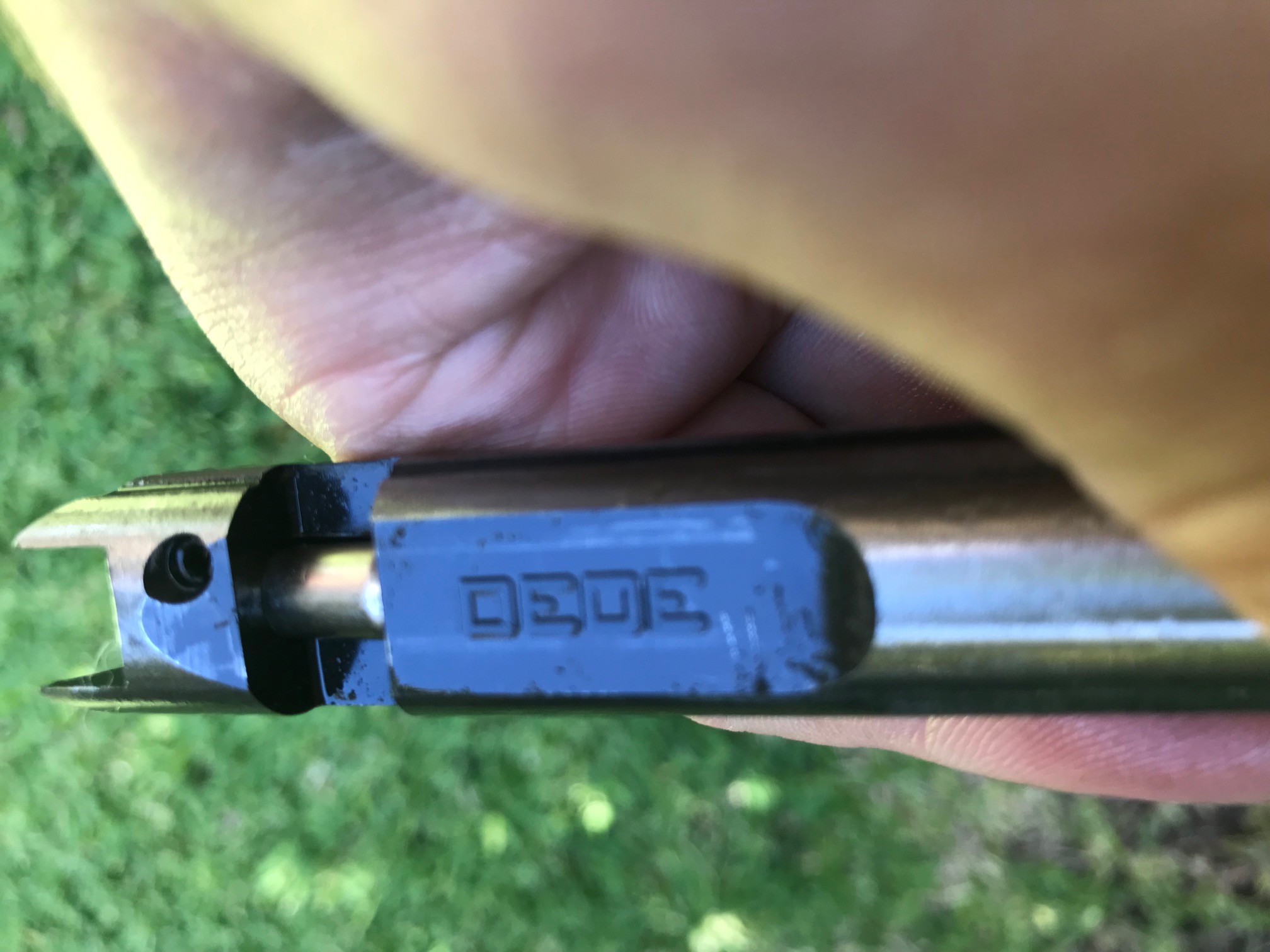

The underside of the bolt showed an embossed “3030” insignia another touch of quality:
emboss

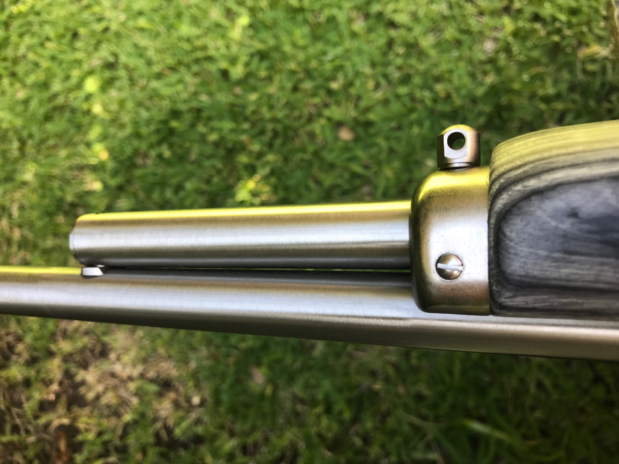

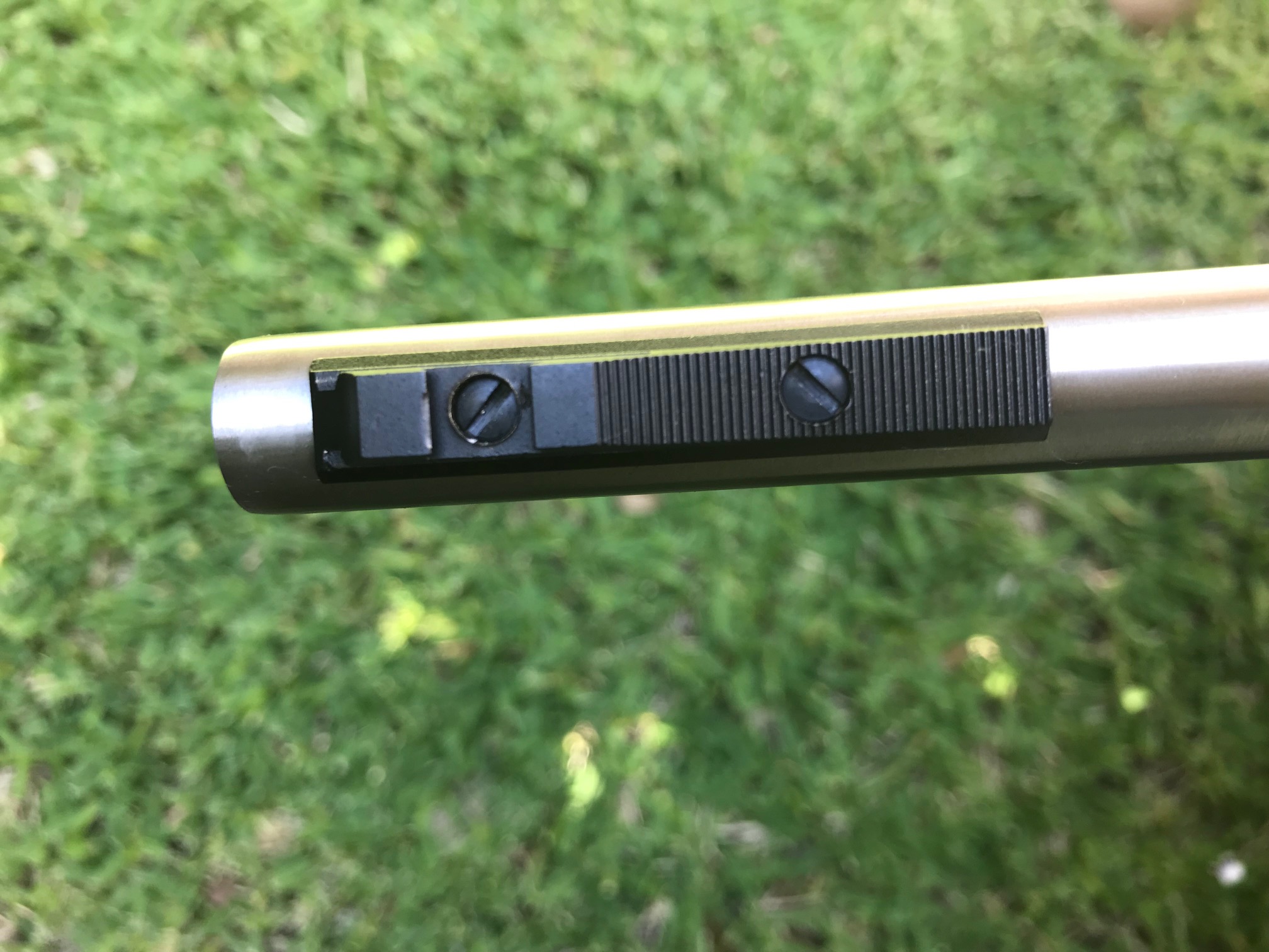

The screw-on front ramp that is dovetailed to take the front sight has two screws (instead of just the one) meaning I was comfortable changing the front sight without worrying about damaging any screws, this was a real bug-bear for me in the past:
two screws FTW!

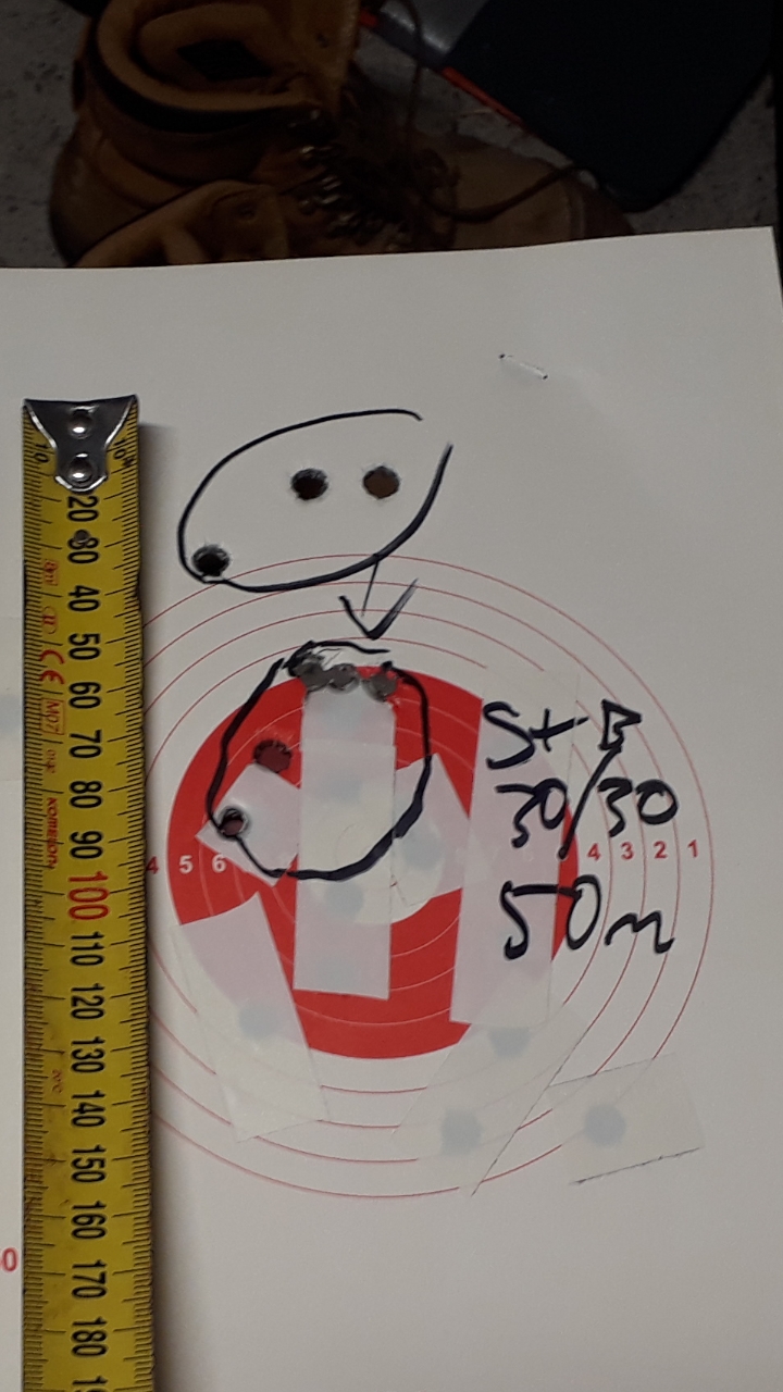

I managed a quick visit to the local indoor range. As a sort of control I purchased a box of Hornady Leverevolution factory ammo, and the XLR absolutely sung. With a little 1-4x24 scope at 50m the first three shots stacked on top of each other, then the fourth and fifth opened up to just under 2moa, probably as the barrel properties changed due to the heat from the full power loads (after all it’s no free floating barrel):
50m group
Still a lot of load development to do, especially reduced loads with lead pills yet I’m confident I’ll get her singing with a good variety of bullets.

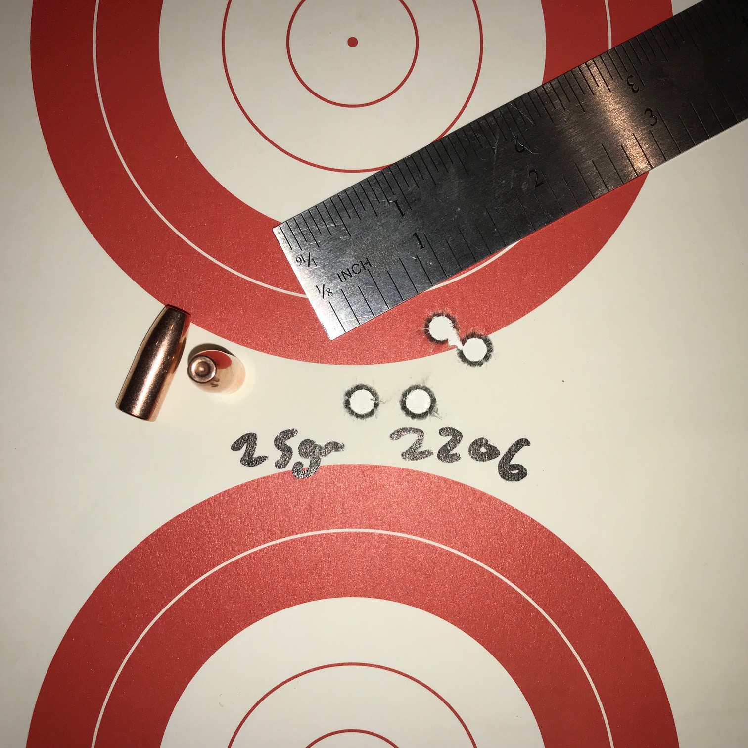

Post by in2anity » 07 Jan 2019, 1:52 pm

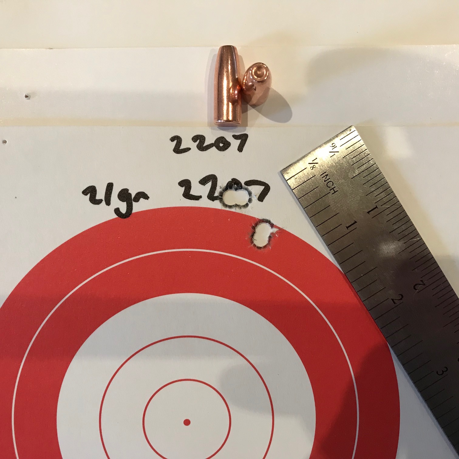

It also likes 2207 on the hotter side exiting at 1780fps:
21gr AR2207 @50m
And the 1800fps 25gr 2206H load grouped well again, even with a piping-hot barrel:
25gr AR2206H @50m
Interestingly the XLR does not seem to like mild loads of TB and AP70N - it only seems to tighten up when encroaching on 2000fps.

Post by Stoney » 08 Jan 2019, 7:30 pm
in2anity wrote:It also likes 2207 on the hotter side exiting at 1780fps:
2207 looks the goods mate
