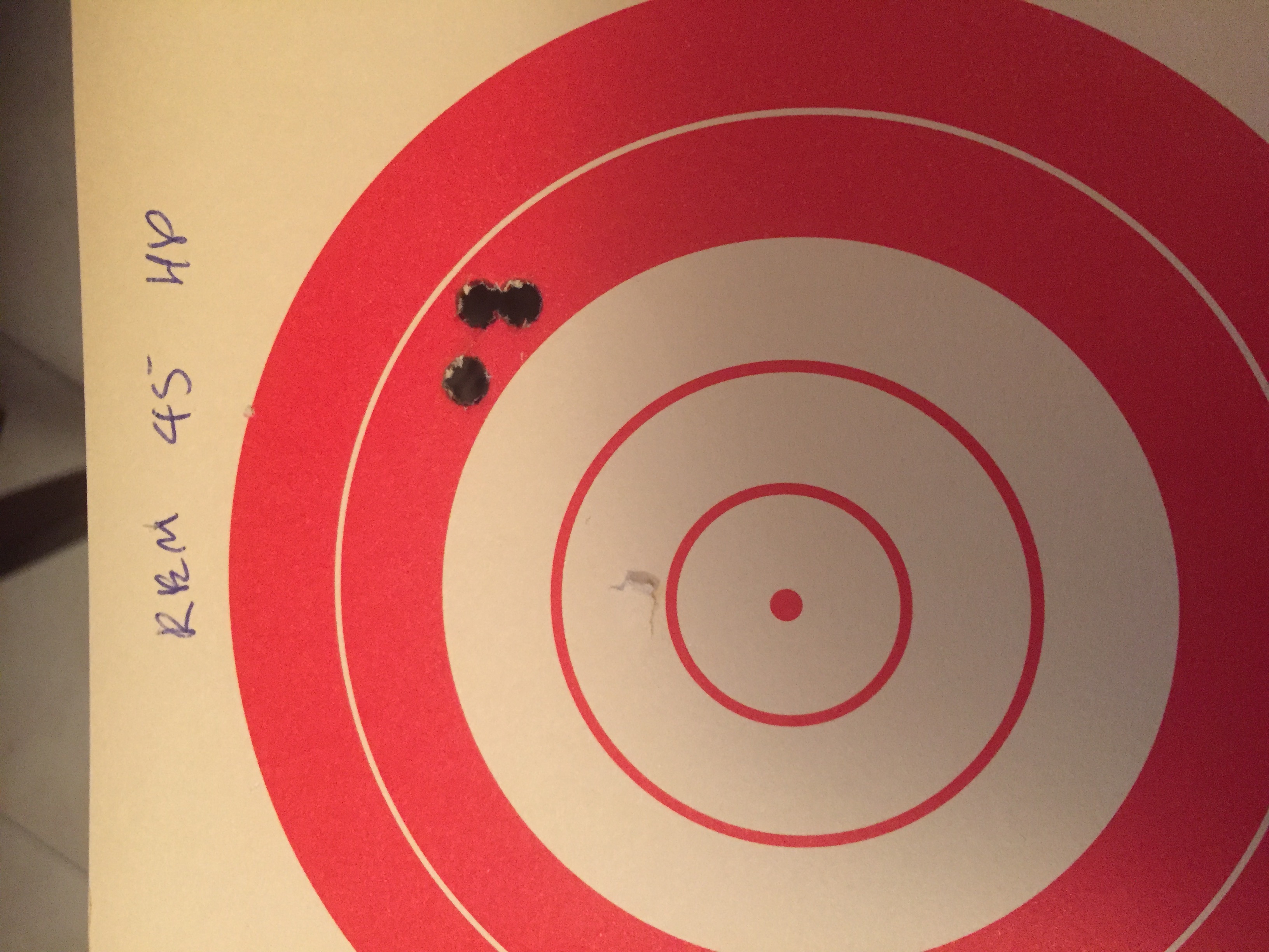

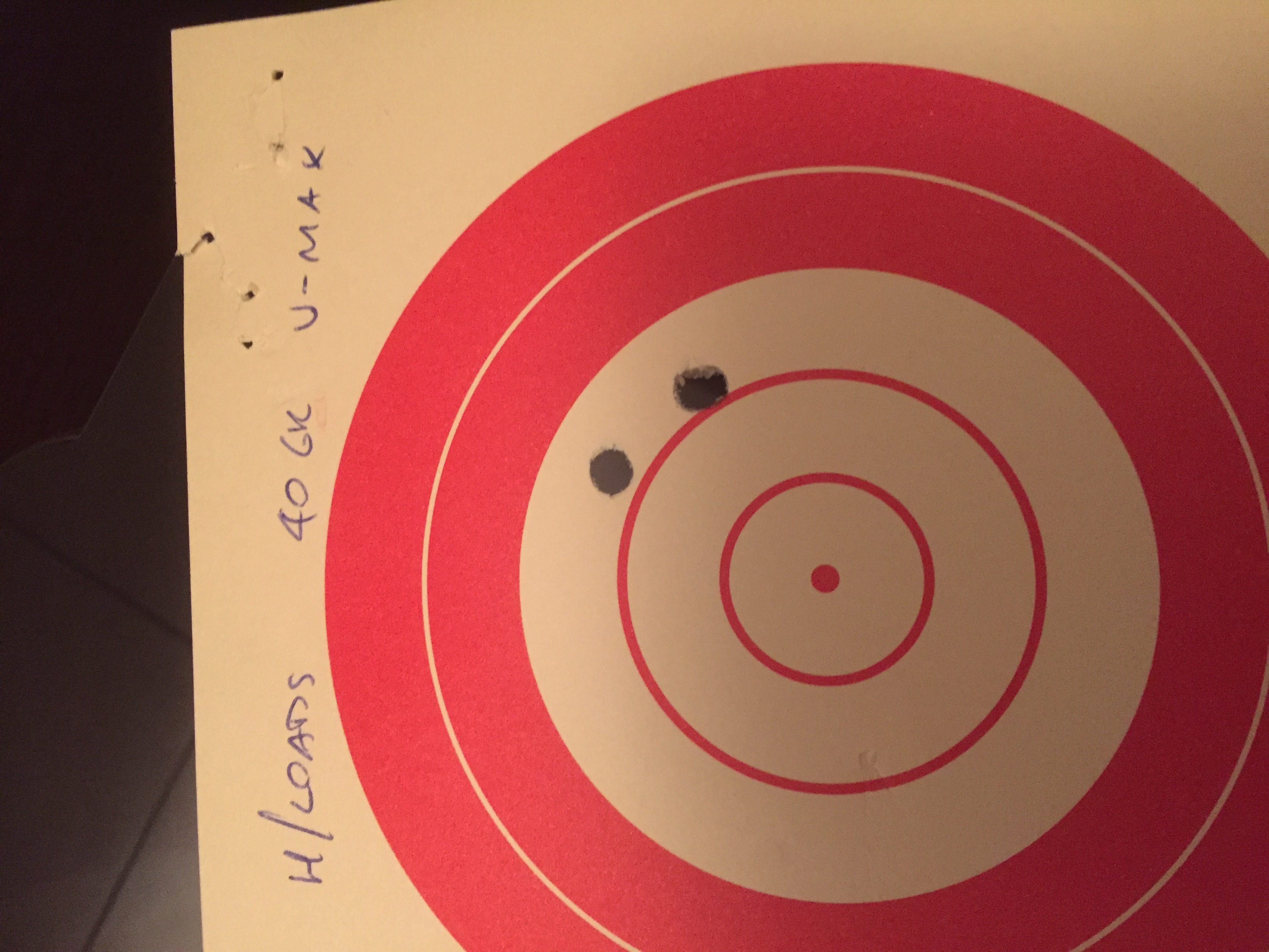

Post by bigrich » 16 Jun 2018, 8:19 pm
any one got any advice on loads for 22 hornet ? loading 12.7 gr of lil gun, 40 gr v-max (seating 20 thou off the rifle lands, too long for magazine but, single loading ) WAS trying fed br4 small rifle primers, but my firing pin isn't setting them off. no problem with any factory ammo. reloaded to same specs but trying cci standard small rifle primers. fired off three shots at 100 with rem 45gr hp's at 100 as a benchmark, grouped almost three shots touching. so the guns got it in it :thumbsup:

bigrich wrote:fired off three shots at 100 with rem 45gr hp's at 100 as a benchmark, grouped almost three shots touching
Doesn’t sound like you need much advice to me. :lol:
Re: .22 Hornet loads
Post by bigrich » 16 Jun 2018, 8:42 pm
don't like paying $78 for a box of rems OB. i got that really good group, then my next group was 1 1/2" thanks to a flyer. reckon if i can do that with factory ammo , what's the potential with hand loads.besides that it's fun :D

Post by bigrich » 16 Jun 2018, 8:51 pm
here's some pic's , 22 hornet at 100. any advice would be appreciated on hand loading :thumbsup:
my lil gun 40 gr v-max, off three that fired. two went through one hole
first shots of the day, 45 gr rem hp
Posts: 6621

Post by Apollo » 16 Jun 2018, 8:53 pm
The potential with a .22 Hornet is about 1/2 MOA or better. Using a CZ 527 here but much lighter bullets.
The biggest trick I found to consistent accuracy is go with the very old tradition of using Small Pistol Primers to save on the double ignition syndrome. Best dies I have used are Lee Collet and I add a Lee Factory Crimp to increase initial pressure release.
