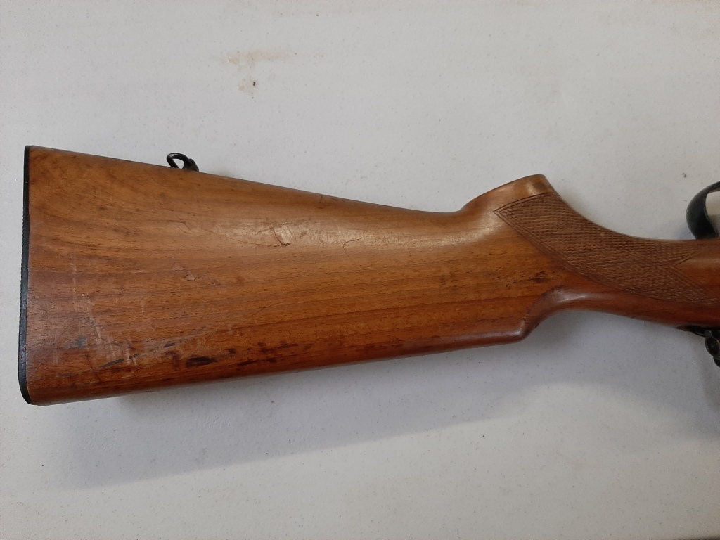

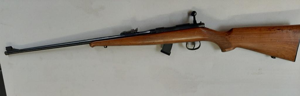

The other day I picked up a 1966 Brno in what I would describe as poor to fair condition. Price seemed fair. The seller seemed to think it had been in storage a long time and not used much. There has been a few delays due to corona virus and logistics. I got it as a project to give to my grandson when he turns 18. So, a labour of love. For a year or so now he has been tagging along on a few trips and seems keen. I'm way ahead of myself here as he is only 14. :D
Indications are that not a huge amount of ammo has been through it. The magazine is an after market plastic one. But I have a 10 shot original I have never used. Most of the work required isn't very difficult mainly just a lot of time. The stock is just time sanding and oiling. (BLO) The barrel however is very rusty and pitted on one section. I will clean up the stock first than see what can be done with the barrel. In the mean time I stripped the bolt yesterday and was pretty dirty inside. Cleaned and oiled now. I'm yet to test fire it, so will do that when I get around to it.
20200606_143002 Stock.jpg (220.08 KiB) Viewed 16952 times
Barrel Rust.jpg (287.24 KiB) Viewed 16952 times
When the stock is well advanced or completed I will up load some more pics.

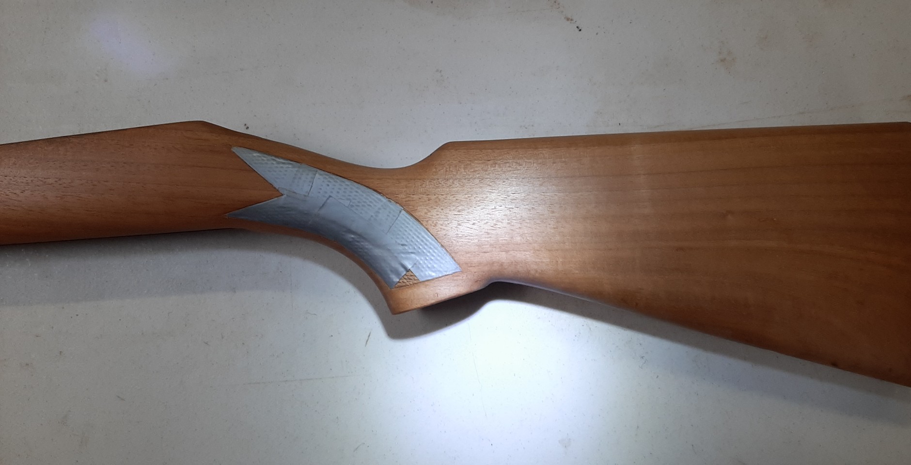

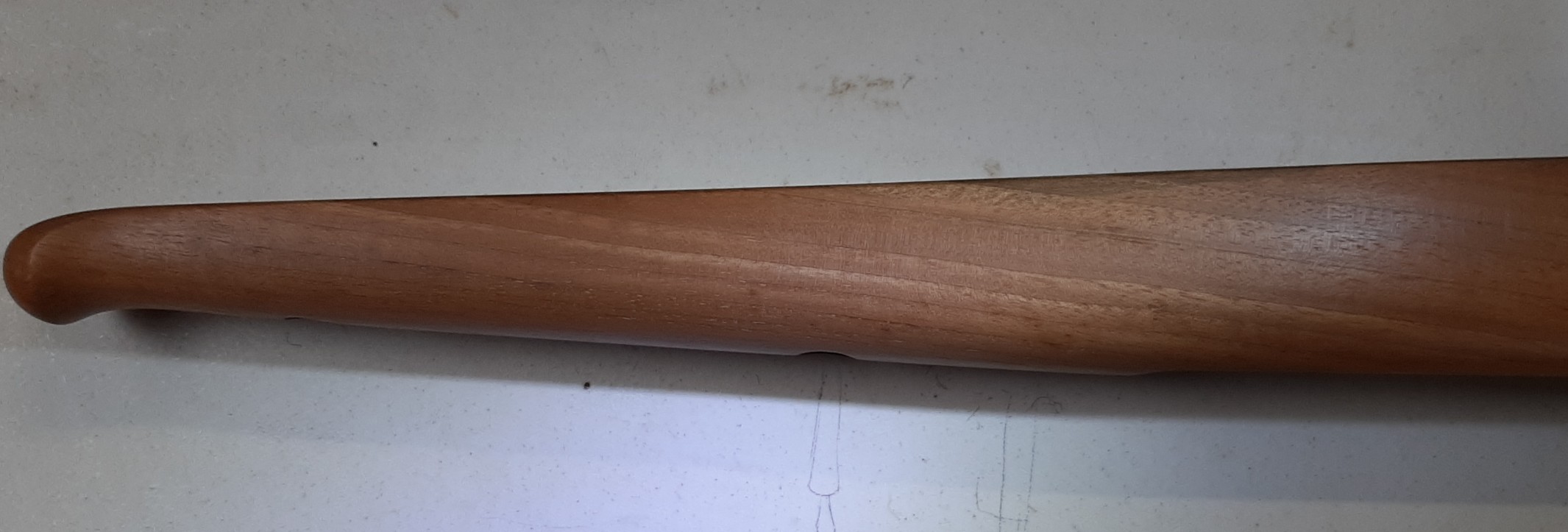

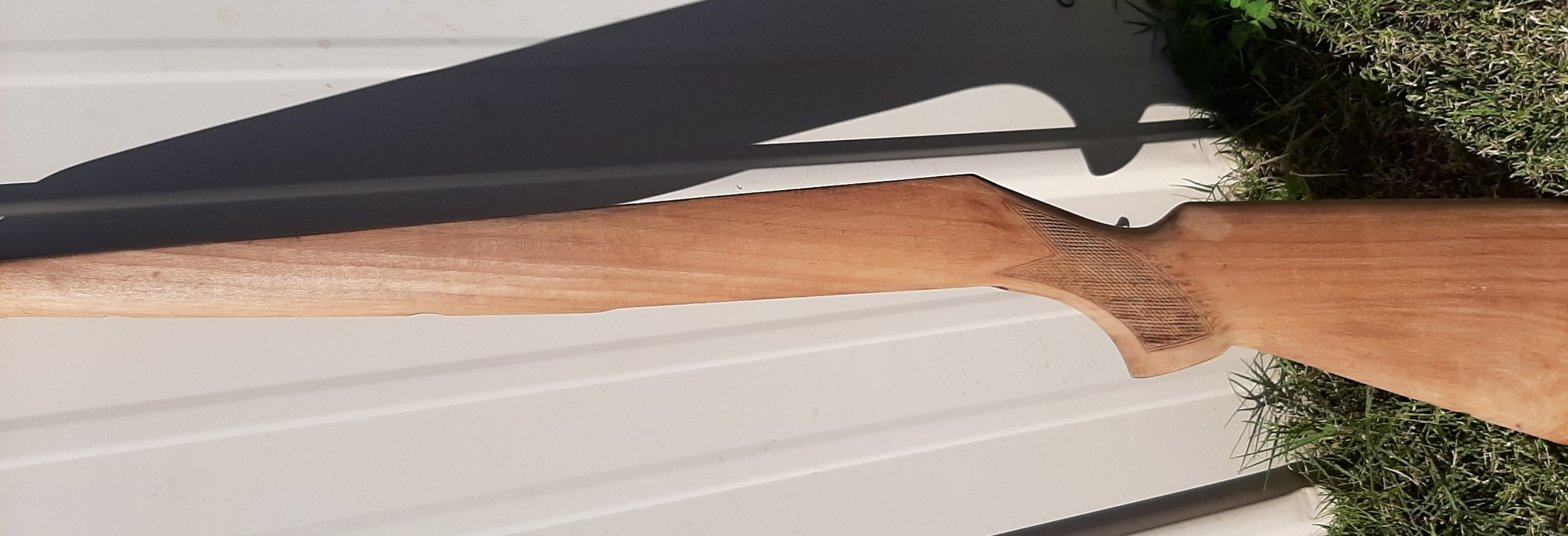

Post by Oldbloke » 12 Jun 2020, 12:53 pm
Quick up date pic.
I scraped the old laquer off with an old knife.
Steamed out 2 dings and the larger about half way. Still visible if you look closely.
Sanding is on the way but still a fair bit to go.
Cleaned out the checkering with metho and a fine bronze brush. Doesnt look too bad and will try to retain.

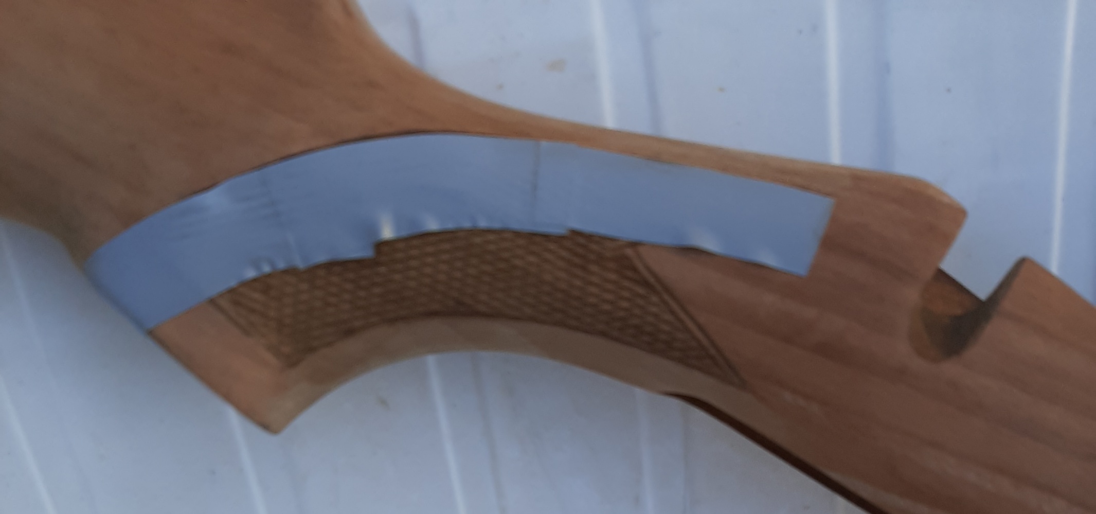

Post by Oldbloke » 12 Jun 2020, 3:02 pm
Using tape in short sections to protect the checkering.
Seems to work ok.

Post by marksman » 12 Jun 2020, 5:40 pm
l get the checkering to stand up a bit by steaming and brushing lightly with a wire brush
l steam the whole stock when l do it and drench the stock so it swells up then sand with steel wool to get the fibres smooth again
that's a nice piece of stick there Olbloke it should come up nicely

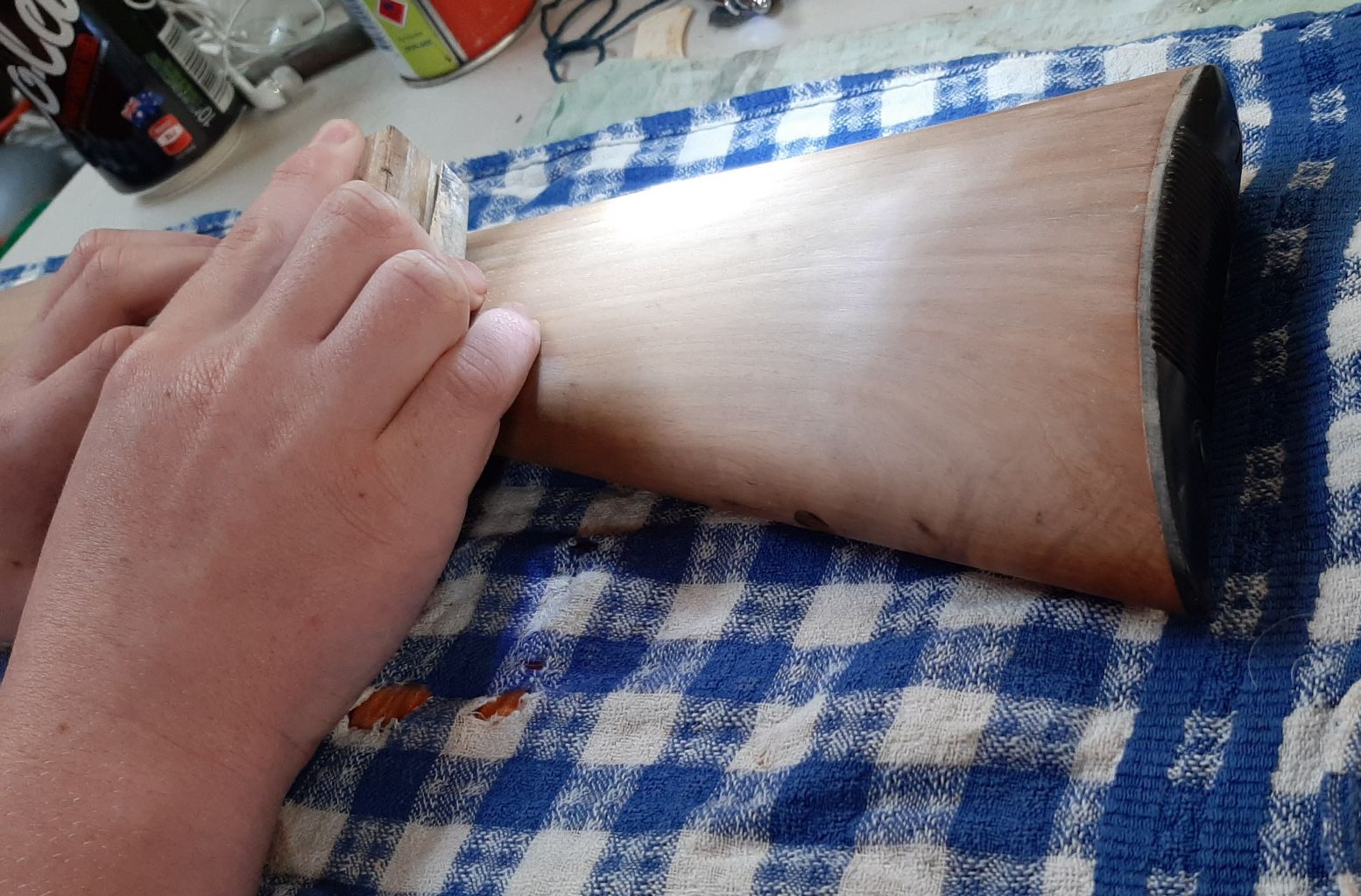

Post by Oldbloke » 14 Jun 2020, 7:07 pm
So, mum and I decided to get the grandsons hands dirty and get him involved in the restoration.
He come around today and did some 400 grit sanding and we also gave it the first dose of BLO. (about 6 drops for the complete stock) After that a bit more 400 grit sanding.
Next week a repeat of today, more oil and sanding. Then another 2 or 3 doses of BLO then perhaps some DIY stock wax.
Very happy at this stage.

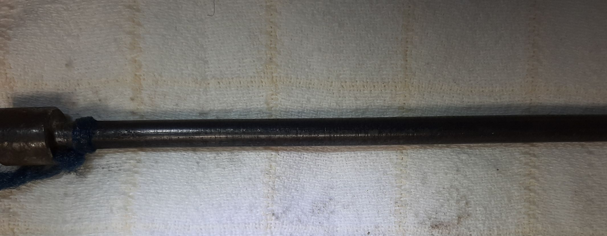

So, while waiting for the BLO to dry I have been investigating "rust bluing".
The process is.
1. apply the rust initiator. (usually twice)
2. keep in a humid environment. A few hours depending on conditions.
3. once it is rusty steam or boil for 20 to 40 minutes. The rust turns into Magnetite. (bluing)
4. Card off loose magnetite using steel wool or a very fine steel brush
5. repeat 1 to 4 a few times (5 to 7) to get a nice finish.
I couldn't work out why there are so many "secret recipes" to make a piece of steel rust so it can be steamed. I mean rust is rust, right. Hydrochloride acid gets a mention, (so does a salt and vinegar and hydrogen peroxide mixture, along with a few others) and guess what. Spirits of Salts is 33% Hydrochloride acid. (yep good old solder flux) So, as I have some why not give it a try. I piece of 5mm mild steel that was roughly machined was what I had so it got the treatment. (gloves and safety glasses advised)
I gave it a good sand of coarse, perhaps 100 grit then 400 grit. Was still showing machining marks but I figure as a bit of a test I will give it a go.
I very lightly swabbed it with about 16% acid solution and left for a couple of hours hanging in the man cave. (shed, Im in Sth Victoria) Result was very little rust. So did again but this time 33% and checked in the morning.(about 12 hours) And it had obvious rust.
So placed I it in mums vegi steamer and steamed for about 25 minutes.(she was out. LOL) As expected it turned black and had a layer of loose material. Gave it a light rub with some steel wool and this is the result.

Looks very promising. Old machining is obvious but that can be ignored for the testing process.
Ill do it 3 or 4 more times and report back.

Post by Wm.Traynor » 17 Jun 2020, 2:56 pm
Looks nice and dark Oldbloke :thumbsup:
Posts: 1849
Re: Brno Model 2 Restoration
Post by Oldbloke » 17 Jun 2020, 4:55 pm
Yeh, looks ok. I'll do it a couple more times to this bit of ms and see how it looks. Not hard. Heaps of potential.
