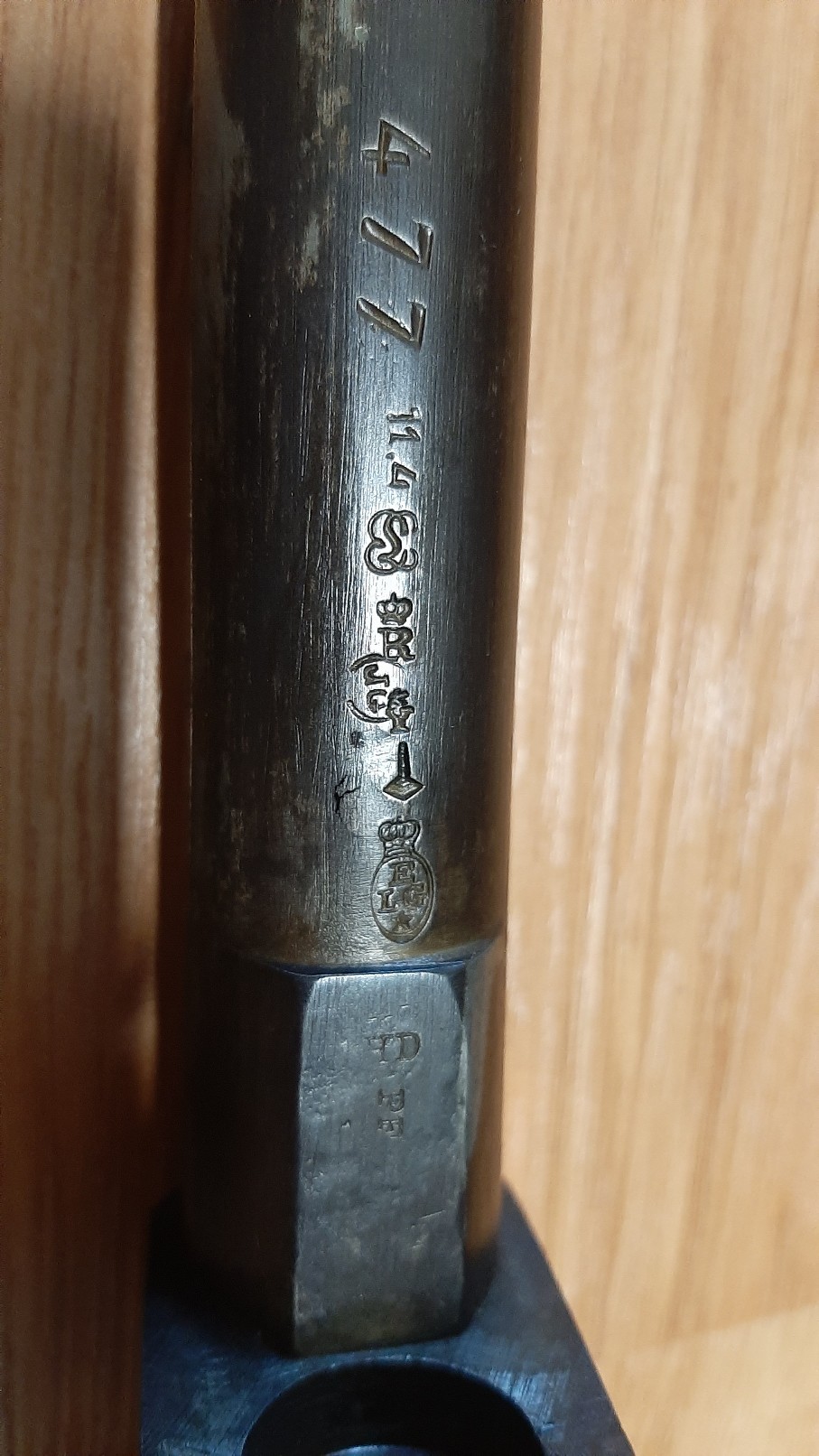

Hey guys I got this martini henry home this week, and I'm wondering if anyone can tell me anything about it.
The only stamps visable without removing the timber are the stamps on top of the breech block and top of the barrel.
On the barrel is MARTINI DF1901, would it have been common for a Liege gunmaker to be chambering a Martini in 577-450 in 1901?
Under the forend timber the receiver, barrel, the metal that hooks into the receiver and the nose cap are all stamped 477 HD
The forend timber has been replaced at some point, it doesn't match the stock and fits fairly poorly.
Looking around on the net I found this info on Belgium proof stamps.
I also info a small amount of info talking about Liege Martinis and the Muscat markets.
So what do you blokes think of this old girl?

Post by Kelsey Cooter » 05 Aug 2021, 8:44 pm
Proof marks
Kelsey Cooter

As you have already discovered you have an example of the "Muscat Martini" made by various Liege gunmakers for the Sultanate of Oman as well as for Persia, which all shipped via Oman. These are not common here, and were made in several variants of carbine and short rifle having elements of Garrison, Cavalry & Artillery carbine form, most had a makers name but some did not and are also to be found in 303. They seem to date from about 1897 through to 1914 when Belgium fell to German forces and are still seen and used around Oman even today, Cheers

First off the decorative brass sleeve around the grip is very common to these Oman carbines, the main use of which was for mounted troops so rifles were almost non-existant in these contracts. Then the fact it is Belgian made and late date fits the guns shipped to the Sultanate and Persia, as well as a large number that went to Afghanistan, add to that the very unique front sling swivel common to nearly all of these carbines. There is no actual type, with each maker free to supply a carbine in the form, so yours has elements of a Cavalry type in the front band having bo bayonet lug, but Artillery action not having the Cavalry shoulders. Where you looked for markings is most common for Belgian guns, where yours is marked "Martini, DP 1901" on the Nocks form they are commonly marked "Martini Muscat". Some of these can be very decorative as this Persian model shows, Cheers
