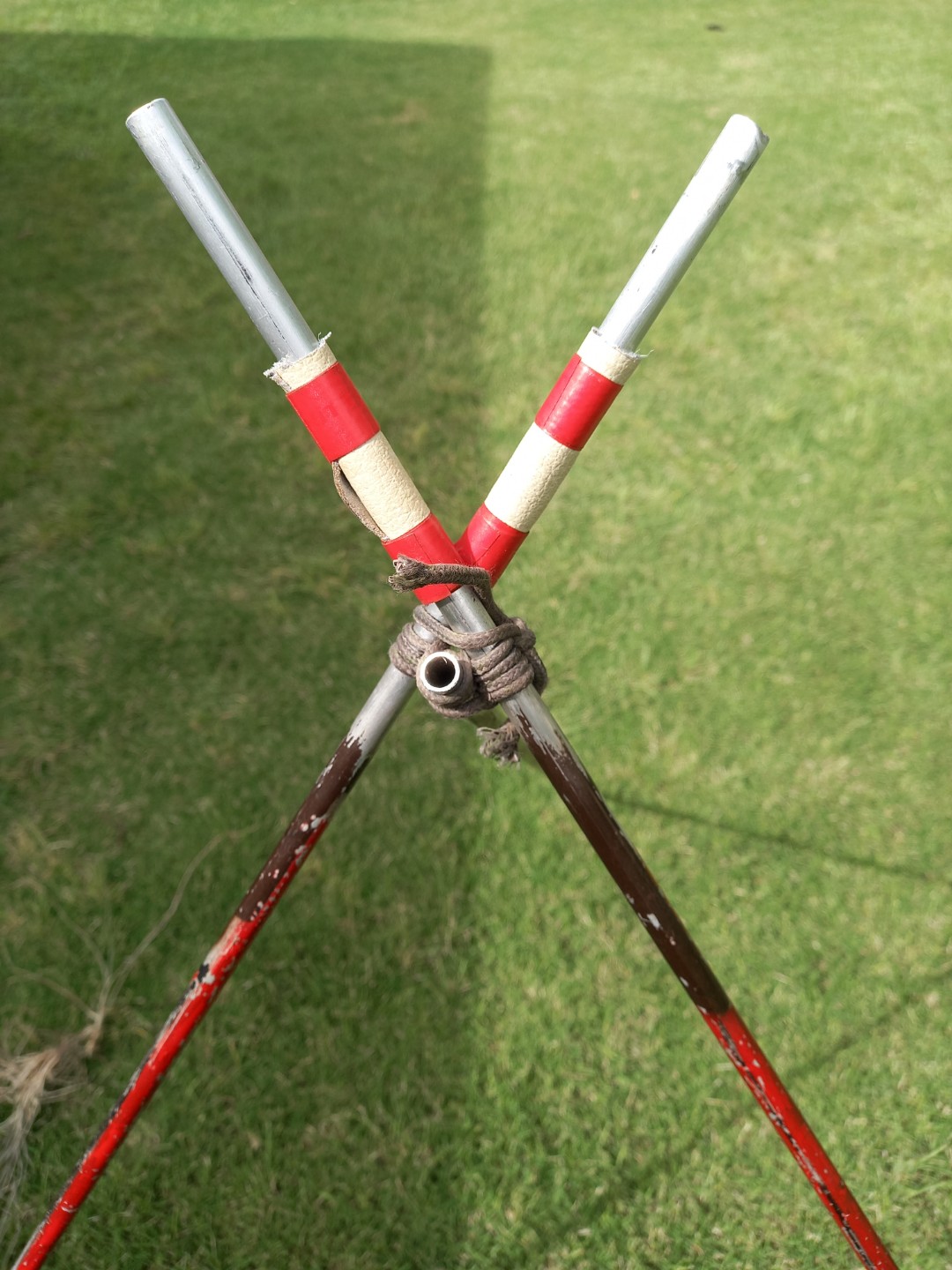

I'm an avid shooting sticks user. But when sitting for long periods on a small seat they just don't cut the mustard. They can fall over and not as good as a tripod. And you cant really put the rifle down. So, tried a trigger stick, heavy, would not go low enough. Tried three sticks tied together with string or elastic, again not flash.
So, this is my third go i think, and
made out of old TV arial alluminium tube and will give it a real test in a week or so. I have noticed they are not as quick to adjust as traditional shooting sticks. But, rock solid. So more suited to ambushing than fox whistling where you moving a fair bit from place to place.

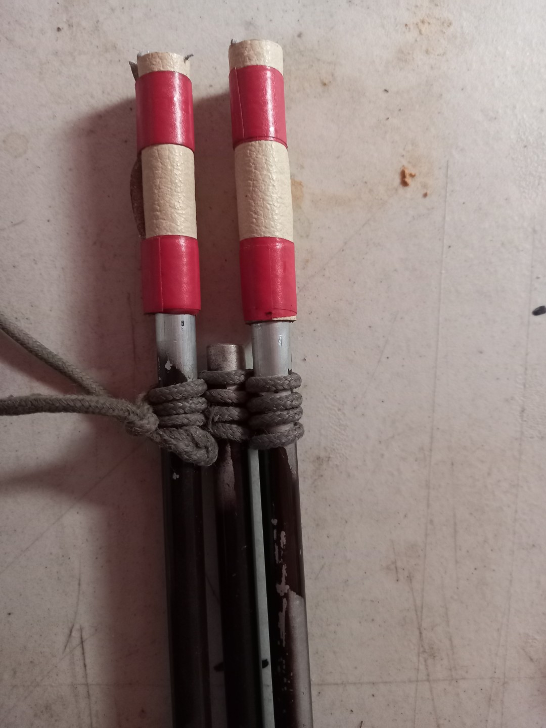

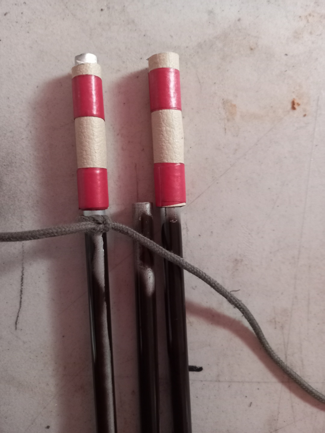

One of the three sticks needs to be about 3"-4" shorter than the other two. If all three are same length it just doesnt work well. The longer two are about 1100mm long. I just used a shoe lace for the knot.
They have a point to give better grip and it's just a pointed bolt araldited in the bottom end.

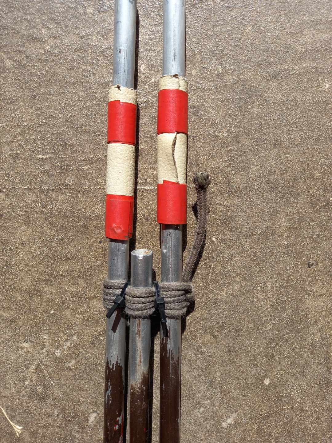

I have since found that a couple of cable ties stop the string from slipping over the end of the short stick.
(Could use string I guess)
