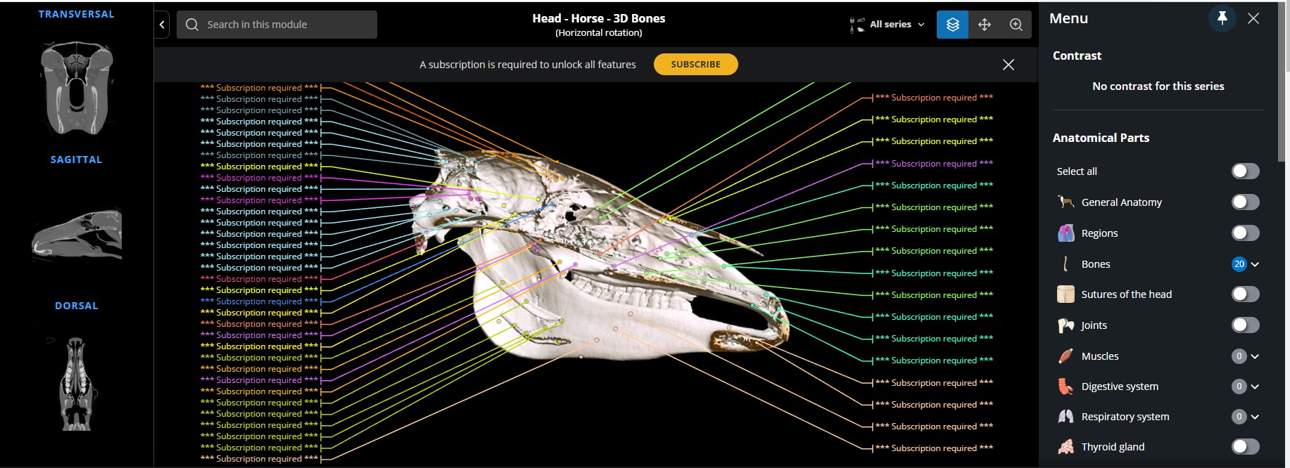

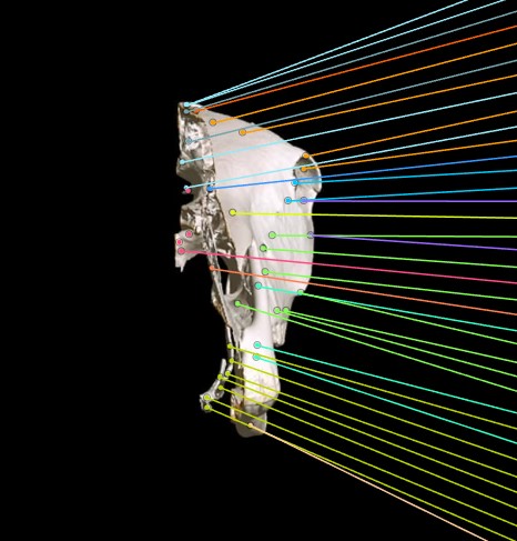

No idea as I avoid being around horses. But I Googled and found an interesting page of CT analysis of a horse's head.
https://www.imaios.com/en/vet-anatomy/horse/horse-head
It has similarities to cows with the brain very high. Unfortunately, it doesn't show the position of the ears. With cows I was told to make the cross between eyes and ears and aim an inch above and to one side of the intersection, and it works fine, but you have to understand it in 3D and make allowances if the animal is looking up or down. And the cow has a reinforcing bar of bone down the centre of the skull, which the horse doesn't have, so the horse brain looks very close to the skin to me.

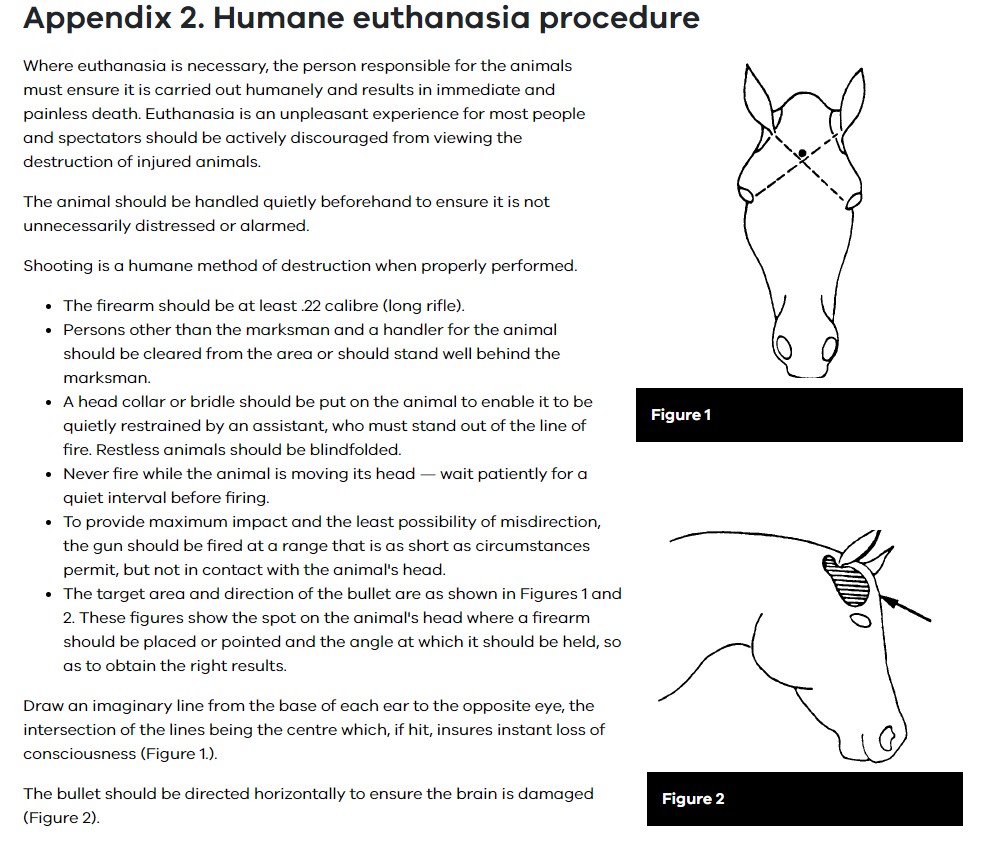

I also found a shooting diagram in a code of practice - https://agriculture.vic.gov.au/livestock-and-animals/animal-welfare-victoria/pocta-act-1986/victorian-codes-of-practice-for-animal-welfare/code-of-practice-for-the-welfare-of-horses-at-horse-hire-establishments#h2-14
Screenshot 2024-10-24 105340.jpg (213.73 KiB) Viewed 5619 times

Post by Jorlcrin » 24 Oct 2024, 10:37 am
Bladeracer,
Many thanks; the shot placement (roughly) matches with my memories of what I was told some decades ago.
That 'Appendix 2' is the go, from the looks.

Ahh so having shot plenty, you need to hit the spot that is between the base of the ears and the eye. Form a cross between both sides and hit there.
For cattle the aim point is between the base of the horn and the eye.

animalpest wrote:Ahh so having shot plenty, you need to hit the spot that is between the base of the ears and the eye. Form a cross between both sides and hit there.
Yep; Thanks for this.
Pretty much aligns with what I remember being told.
