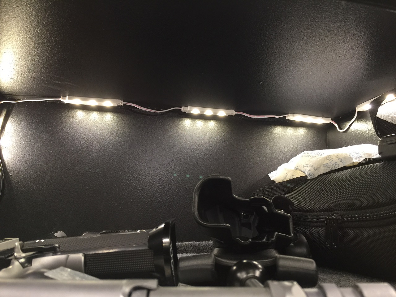

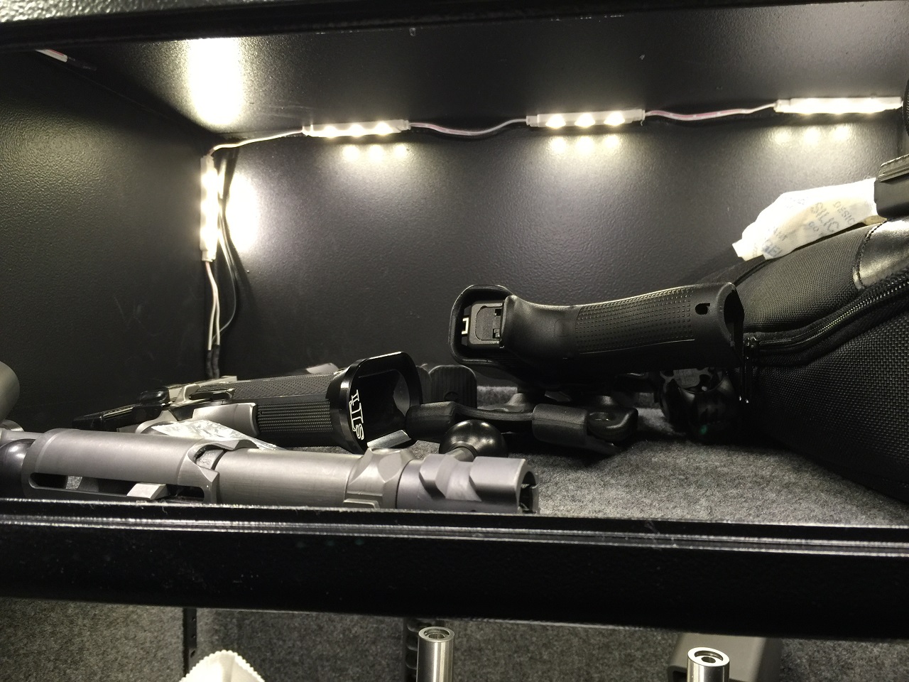

I bought a couple sets of LED lights from Jaycar, little blocks of 3 with 3" of wire between them. I drilled a small hole out through the top left hand corner of the ammo box then another down through the ammo box into the main cavity. De-burred the holes and used a small rubber grommet to protect the wires, a little soldering and heat shrink completes the wiring. A 12v 3A plug pack with an inline switch powers it nicely. The lights originally had double sided tape but this had issues sticking to the paint of the safe so I removed it and used hot glue. I've pointed the camera up to see the lights but ordinarily when standing in front you can't see them or the wiring.
If I get a bit more enthusiastic I will wire up a reed switch so the lights turn on when the doors opened. Presently I'm consumed by bullet tipping, trimming and measuring.
Looks like another 2 need the hot glue.

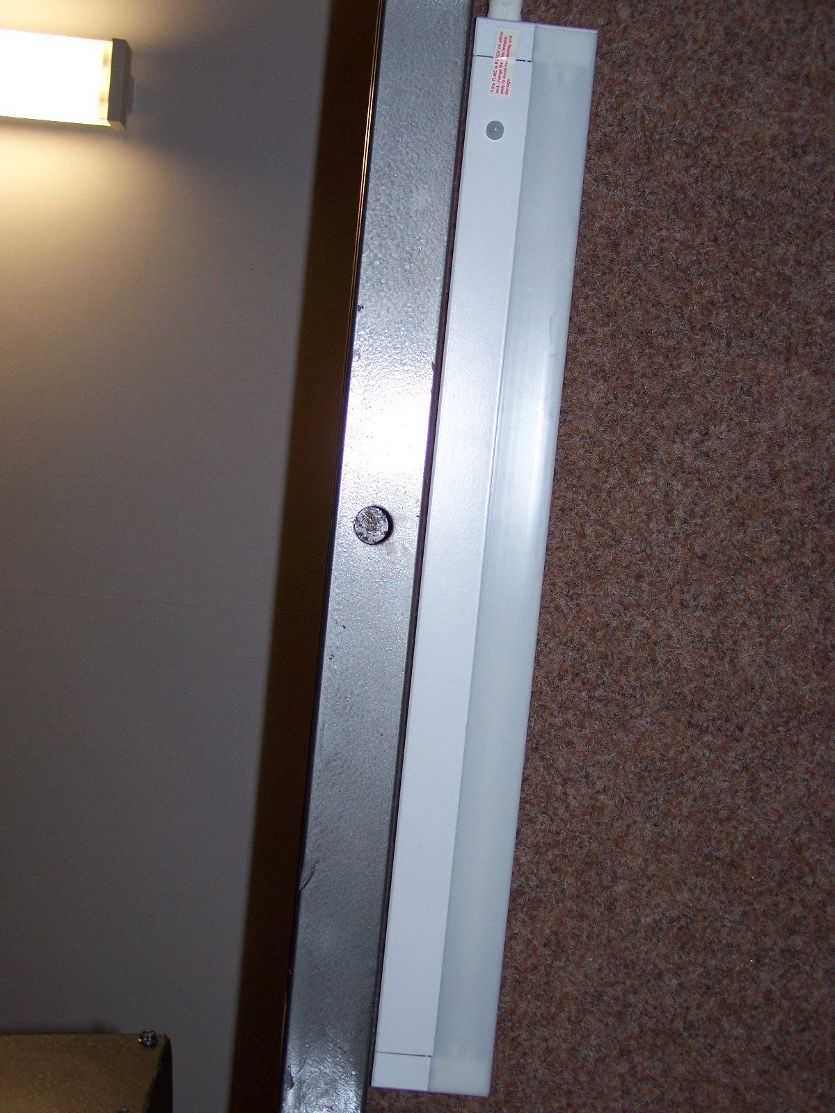

About five years ago I bought a 240 volt fluoro with a built in motion sensor switch.
This was from Bunnings, and was called an "Under Sink Cupboard" light.
Mounted with PK screws up the top of the cabinet so that it is not seen at all unless you lay on the floor on your back and look up.
The pic shows the light (after I lay on the floor and waited for it to turn off) the part fluoro visible that is on, is the normal room fluoro up on the ceiling.
All the wiring is inserted behind the inner wall carpeting of the cabinet, and exits via grommets at the rear of the cabinet.
Its just like having a little man inside that turns the light on and off for me. :lol: :lol: :clap:

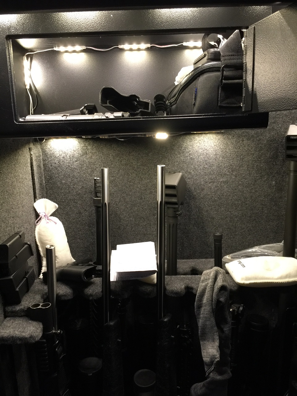

I know I'm digging up an old thread, but thought I'd share my lighting setup since others have shown their methods.
Much like AusTac I have a Lockaway (Hyskor) and it's as dark as a dogs guts. Where it is set up in the room no light gets inside. That's a photo, no flash of what I was dealing with.
So I got a roll of 5050 White LEDs, some insulated 2 core wire, a 2.1mm surface mount power jack, a small 12v PIR sensor and the usual selection of solder and heat shrink you'd need for something like this.
First step was to drill a hole for the power jack. Not surprisingly, a pain in the ass.
Inside
And with the carpet down, it's pretty unobtrusive.
All the rest of the wiring is hidden under the carpet.
This is the PIR sensor. It just sits under the pistol compartment, you can't even see it when standing in front of the open safe.
Other than that, just cut and soldered 3 strips for the main area and one small one for the pistol compartment. Ran the wires, stuck the LED strips into position and this is the end result.
Realistically, less than $30 in parts, and a few hours. Pretty happy with the results. Turns itself on when you open the door, and is on a 3 min timer. You can see it switch off with the door closed.
