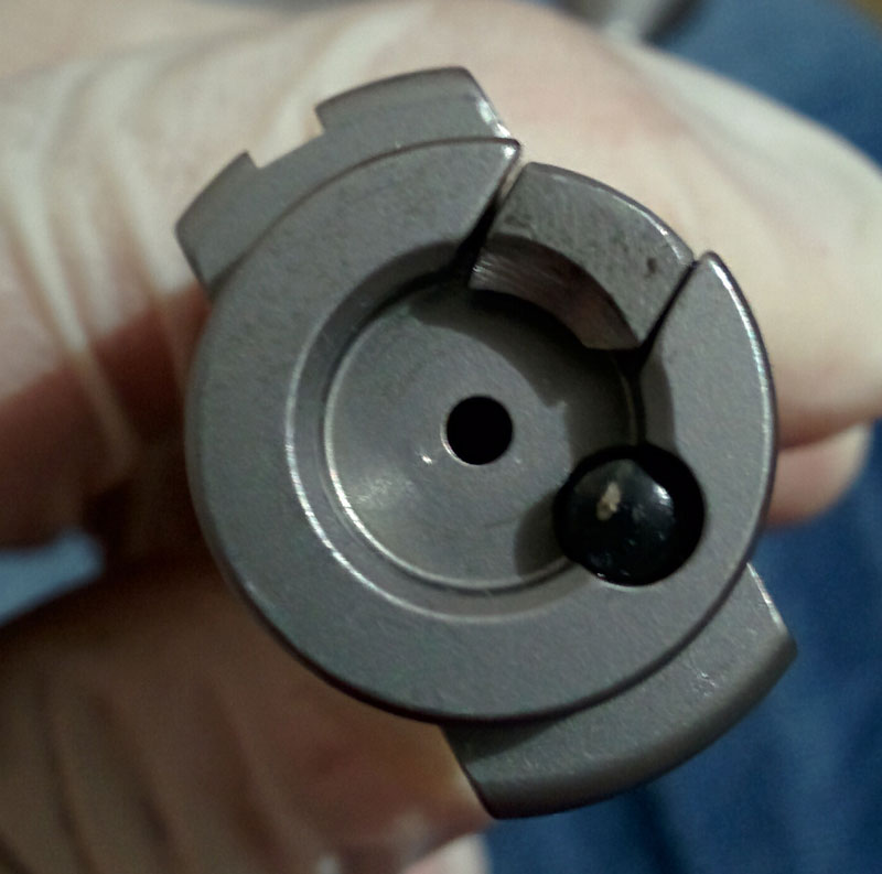

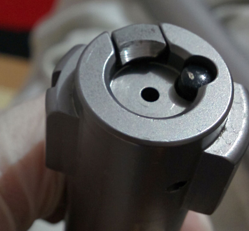

This is really looking like an extractor issue more and more. Any chance of a pic showing the bolt face up close?
Had another thought during dinner....how clean is the actual chamber? possibly a small jag or sharp edge grabbing the case after being fired....just thinking out loud.

Post by zobster » 07 Jan 2016, 8:20 pm
Here's the close up if the bolt face, I've also cleaned the chamber again, and close up inspection of the chamber reveal clean, shiny surface with no dirt/rust to speak of.
I've email osa about this issue and the call back from them this afternoon was to try another brand of ammunition and see if it happens again.
