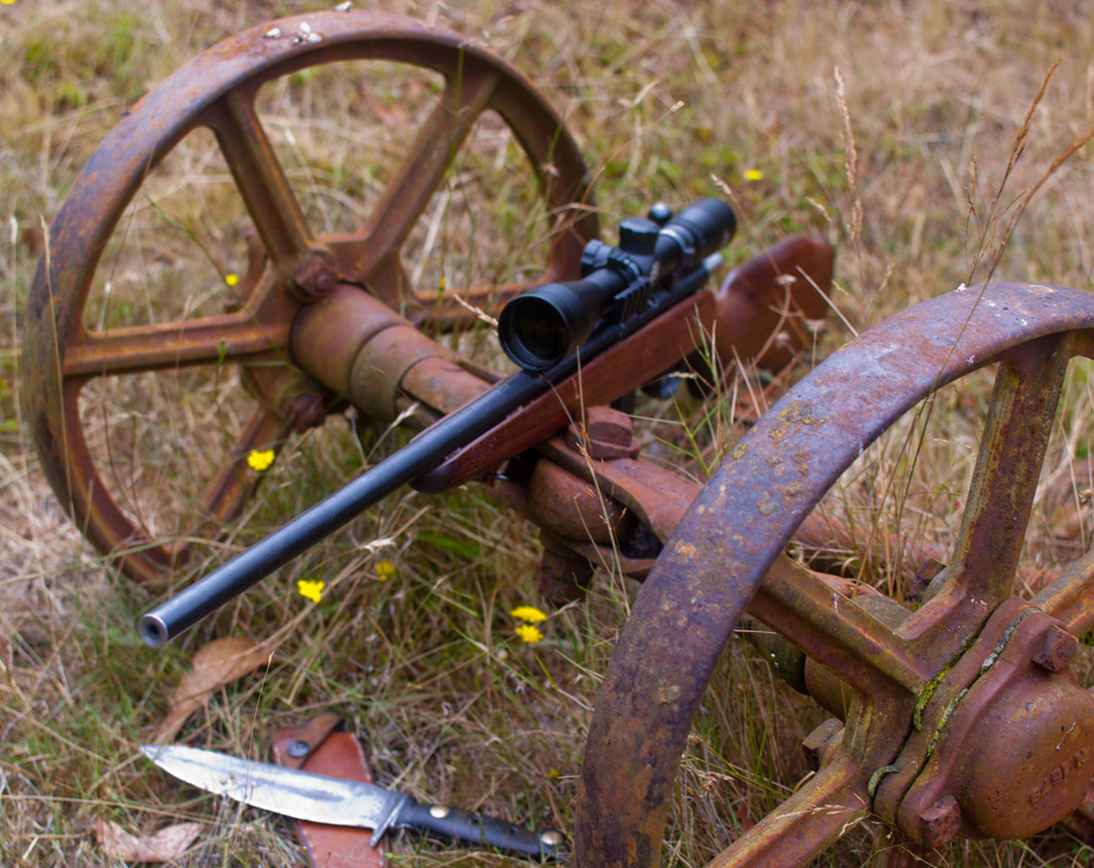

Sporti with scope mounted...
Sportco 62A 22LR 01.jpg (372.16 KiB) Viewed 9511 times

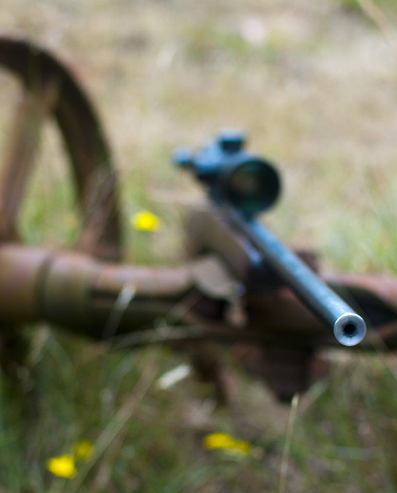

Rolf Hey crown job...
Sportco 62A 22LR 04.jpg (135.83 KiB) Viewed 9511 times

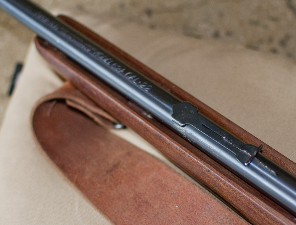

Well. As this is technically my wife's rifle and she can never get comfortable behind a scope, i decided that the rifle would be best with some iron sights so she can shoot it more comfortably; she'll never be taking longer shots than about 30m. Besides, i wanted a rifle with open sights to muck around with as well as take those bloody vegie thieves inside 10m, which a scope is just crap for.
Off it went back to Rolf..... he did the work that day with some sights he had lying around. Also re-crowned it again due to a unfortunate incident with a concrete floor. Photos below.
One QUESTION for you all. I am only familiar with open sights that have rear windage and elevation adjustment. This old leaf system has me a bit perplexed. I see how the elevation is adjusted but what do i do to correct windage for the rifle's preferred ammo???
Also, i'm interested to get an idea of year of production. I've looked up serial numbers and such but info on even a rough period of production is hard to come by. Anyone got some idea???

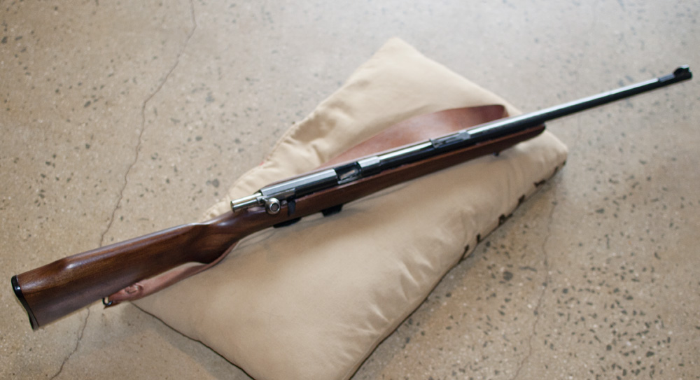

Iron sights fitted... now it looks somewhat more like it originally would have.
Sportco 01.jpg (155.76 KiB) Viewed 9511 times

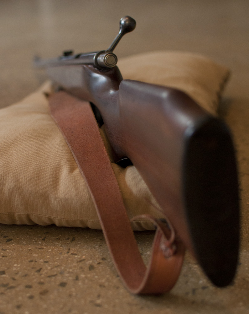

The old girl... nice and simple.
Spotco 03.jpg (195.88 KiB) Viewed 9511 times
Leaf sights... how do i adjust for windage???
Spotco 04.jpg (233.05 KiB) Viewed 9511 times

Nice job on the old Sportco, Gwion, to adjust windage you will need to tap the rear sight either left or right to get to your zero, I take that it is in a dovetail on the barrel, don't hit it too hard as it won't need to move too far

Post by deanp100 » 18 Sep 2016, 10:28 pm
That looks suspiciously like a lithgow mod 12 rear sight. but looks like the correct front sight.

Post by Gwion » 19 Sep 2016, 7:57 am
Hey Dean.... My thoughts exactly. I just asked Rolf to fit whatever he had lying around that would work. If the rifle was in more original condition I might have made more effort to source the correct sights.

The way I remembered for adjusting windage was to imagine the sights aimed directly at the target and the rifle moving. So if you are shooting to the right the rifle needs to move left. Hence the front sight goes right.
Or you move the sights towards the bullet hole relative to the target. Shooting right, drift it right.
Funny one of those simple things that can take a little bit to initially get your head around.
