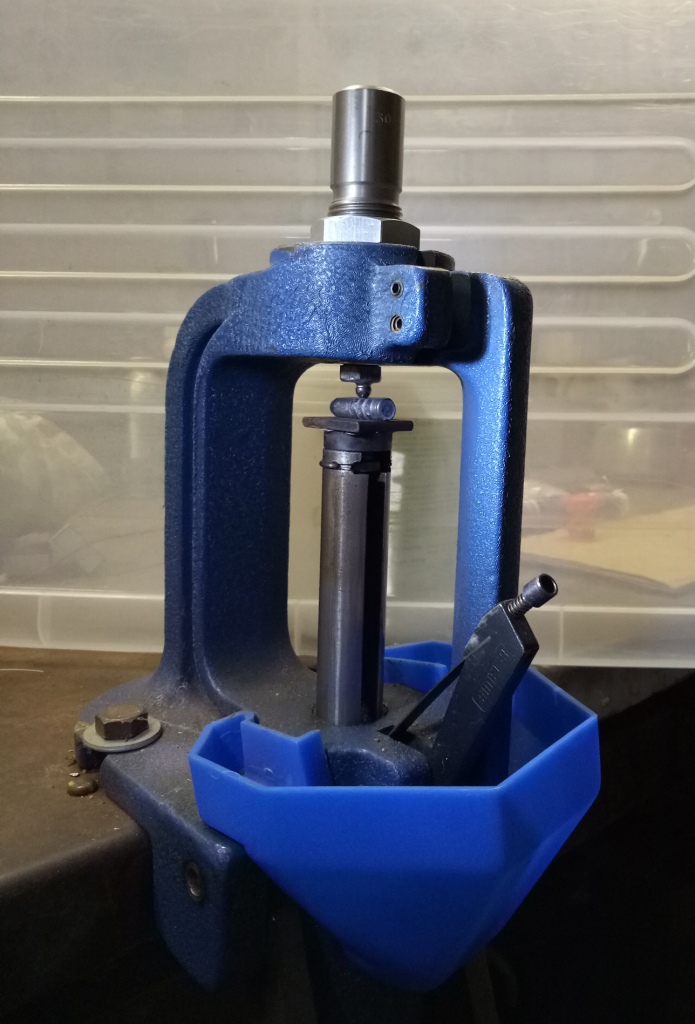

Post by Oldbloke » 19 Mar 2017, 7:30 pm
I tested my Brinell tester again today and I'm very happy with it. Should be accurate to with about 5% or 10% provided I do my job well.
Using this idea. http://mountainmolds.com/bhn.htm I came up with this.
Brinell in use.jpg (201.73 KiB) Viewed 12399 times
Here it is in use. You cannot see the 5 kg weight hanging off the press handle. After 30 seconds I take it out & I then measure the dent using a vernier with a magnifying glass and punch the number in to a spread sheet I was sent from the other web site. (if anyone wants a copy PM me with an email address & I will send it.) The cells in red will need to be changed to suit your press.)

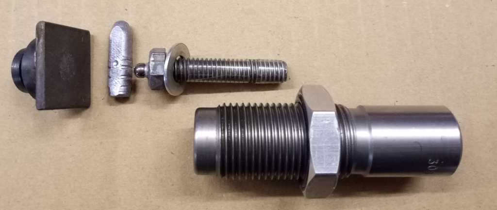

The parts are simple a 3/16 ball bearing soldered to a bolt. When in use the bolt is slid into a lee 308 bullet sizing die to hold it in place and give me some adjust ability. And a piece of 3mm steel cut to size and soldered to an old case holder, this acts as a seat/table for the projectile or material being tested.. see below.
Brinell parts.jpg (143.95 KiB) Viewed 12399 times
A few notes:
You can change the ball bearing size if you with one a little larger or smaller. (Lee use a 5/32")
You will need to work out the ratio of the press handle. The web site above describes an easy way to work it out. I have copied it below for your convenience.
