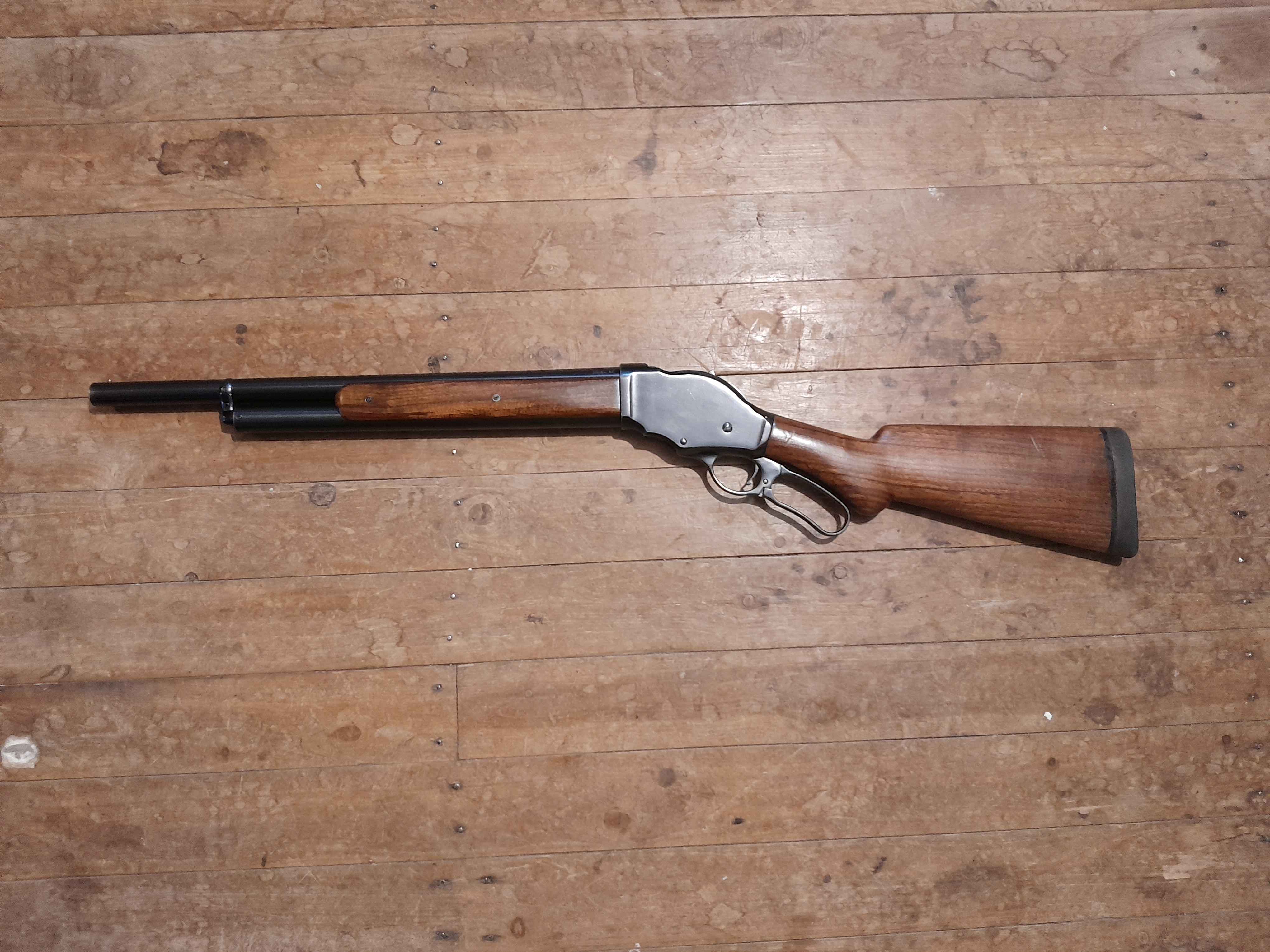

Before the tactical craze that shotguns have had now applied to them, there were a few of this type available.
This one here is the IAC lever gun, modelled after the 1887/1902 Winchester.
I also have a Chiappa the same, with a full choke set. If you like a shotgun with a beautiful piece of walnut, the Chiappa's certainly show up the Beretta boys at out community shotgun clay events.
The standard models carry 7 shells, with one in the chamber.
You definitely can carry one in the chamber safety at half cock with one of these. In fact, I prefer these things to the Rem 870 I have because of this.
You can sneak up on something, then completely silently thumb the hammer to full cock.
Unfortunately, these models suffered from some terrible myths about their reliability to eject some shells, mainly long cases, which I found to be complete bullsh*t. Some people couldn't drive an automatic car.

Post by Wapiti » 21 Aug 2025, 7:07 am
Gun at half cock.
Completely safe to run around with on the ute dash, or in a rack on a quad or SxS.
This one has an open choke, so best for scrub and creek beds with your favourite buckshot size, or slugs.
