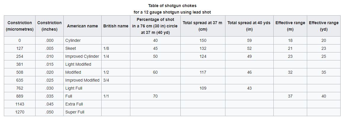

Post by bladeracer » 09 Aug 2019, 5:08 pm
CAVEMAN wrote:Yeah got a nice 308, I'm just intrigued by shotguns and there place in the world and there capabilities. Far more complex than squeezing the bang button and having 150gn of multipurpose projectile going roughly where you intended.
Fairy-nuff.
I don't hold shotguns in much regard for hunting, their entire premise is about increasing your ability to hit (not necessarily kill) a moving target, but doing so by greatly compromising your ability to cleanly kill that target. For me it's like "hunting" with handgrenades :-)
If you want to shoot at moving targets you just need lots of practice with a rifle.
A one-ounce load of shot (438gn) sounds devastating, until you realise that a one-ounce eight-pellet load of "00" buck consists of eight 55gn balls doing about 1300fps, with little more energy than a .22LR bullet. If all eight hit the target somewhere around vital organs you'll do decent damage (as you would peppering the target with .22LR bullets), but getting all the pellets to hit is unlikely at any decent range. An ounce of BB's is basically a handful of pellets, half the weight of .177" air-rifle pellets.
Also, a shot column is several meters long at extended ranges, and your target is moving sideways, so only a part of the shot column will intersect the target's course, most of the shot will pass ahead of, and behind the target, plus that which passes above and below due to the height of the pattern.
https://en.wikipedia.org/wiki/Shotgun#Pattern_and_choke
The chart shows how they label the different chokes, but the numbers are nominal only. Even a full choke should only put 70% of its pellets into a 30" circle at 40yds (my full-choked T1000 20" barrel is around 14" at 18yds with BB and 7-1/2), 38" circle at 50yds, 55" circle at 60yds, and so on, although the pattern will open up further, it doesn't follow a true cone - but at 50m you're probably looking at a "pattern" of well over a meter diameter, making an effective hit with even one 00 pellet unlikely. Consider that a cylinder choke puts less than half its load into the same circle, and that only applies to stationary targets or head-on/tail-on targets. You can fill in the gaps in the pattern by using much heavier shot loads, like 2oz loads, but you generally have either a lot less velocity (and energy), or a lot more recoil. And it is possible to keep the pattern tighter using different wads to extend the range.
Basically, with a shotgun, the closer you can get before pulling the trigger, the more effective your shot will be.

That definitely give's validity to a 50m range for a shotgun with the right ammo and choke setup.
CAVEMAN
Posts: 251
Re: Shotgun barrel length and chokes.
Post by bladeracer » 18 Aug 2019, 3:37 pm
CAVEMAN wrote:That definitely give's validity to a 50m range for a shotgun with the right ammo and choke setup.
I agree, the choke is crucial for range, but you still need to find or develop a load that works with the choke. Paul Harrell has also done some videos looking at distances possible for hunting deer with buckshot that would be worth a look.
I would order the tightest choke you can find, and start patterning.
But I still think any number of rifles are going to do a far better job at any distance.
In Victoria it is illegal to hunt deer with buckshot, you can only use slugs in a shotgun.

A lot of very clever people have done a lot of work into barrel length and there was a bit of a craze in the 1930's (?) where they shortened barrels to (gasp) 25 inches. That was chosen as the length where optimum efficiancy (i.e. all the powder was burned) and and acceptable pattern could be achieved. The idea was to achieve a quick handling gun but most found it unsuitable. Churchill XXV's are highly sought after collectors items but not many gunmakers offer a 25 inch option now. Try and find a 25" on the clay circuit now except for novelty value - they have all gone back to 30 or 32" barrels.
20 inch barrels are popular on coach guns and in Cowboy Action and are often cylinder/IC bored. Fine as a scrub gun at 20-25m but pushing it past that. Chokes would extend that but likely still unburnt powder so not developing full velocity. I can't imagine why someone would opt for 18" or 16" unless they were masochists and enjoyed getting beaten up.
