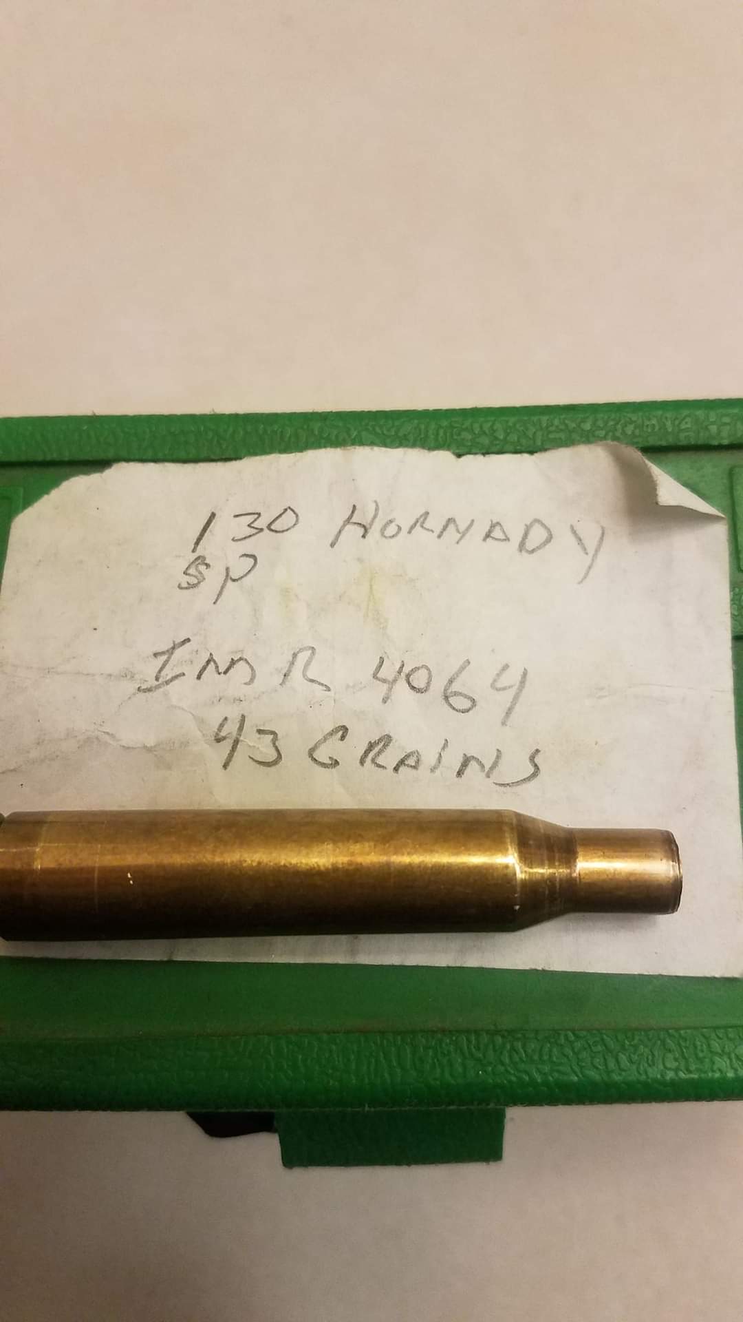

This is my load right now and I have had good luck on white tail deer imr 4831 is more popular then imr 4064 but my gun likes it
