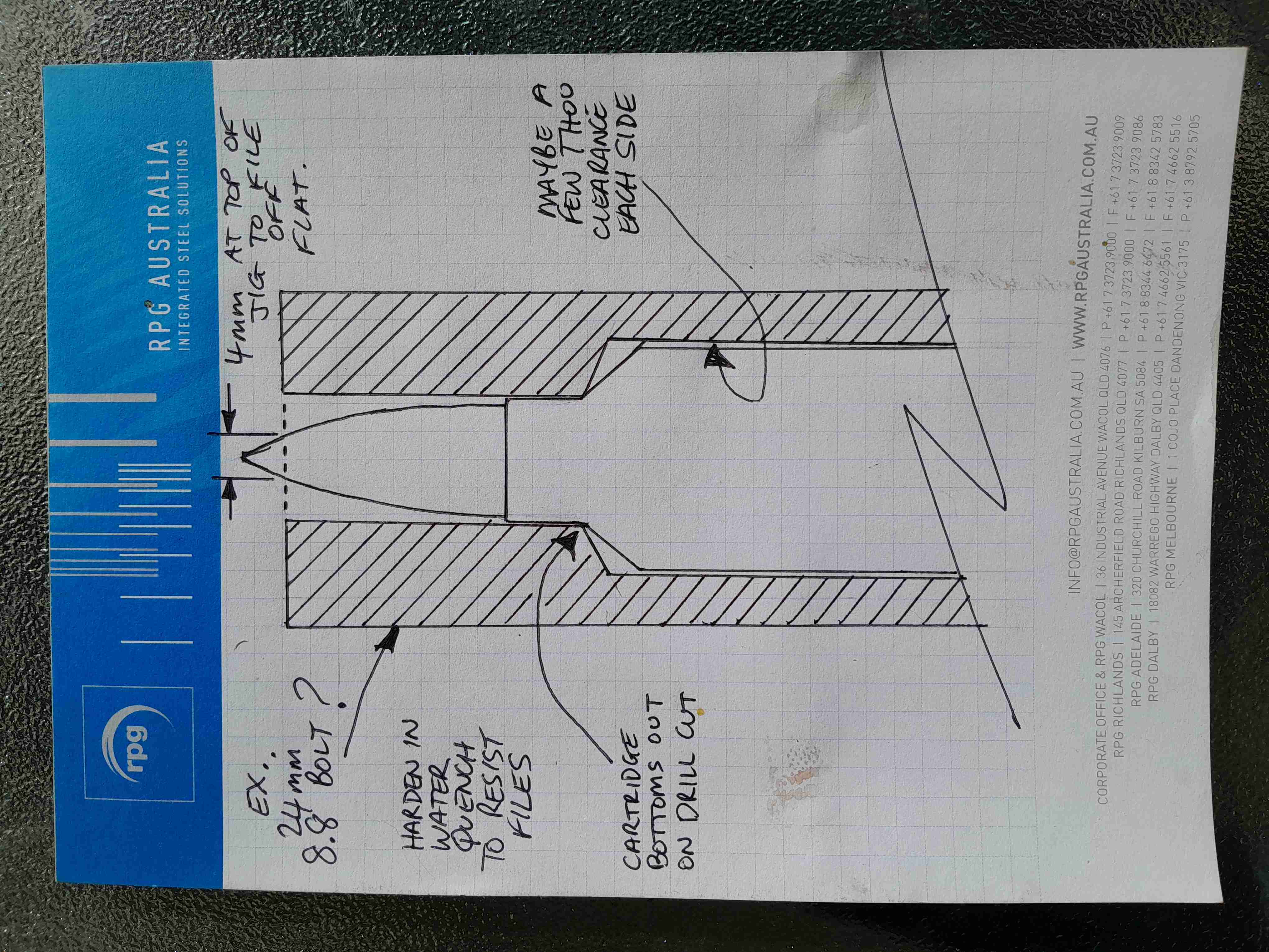

Hy DJ, if you are still interested in all that sub ammo you bought and being able to use it humanely, as this is important to you as it is to me too.
Have you thought about making two tools on the lathe to give these things a proper hollow point (open up and deepen the tiny match hollow point tip) to force the projectiles to open up somewhat?
You could drill out say, an M24 structural bolt to fit the cartridge in to, that has the tip sticking out the end to be filed off for a fairly large 4mm diameter flat.
You could heat it up with the oxy and water-quench, so you could file the tip down on each cartridge, so they are all the same length.
Hardening the "jig" would avoid the file cutting it when you brought the tips down to the height required.

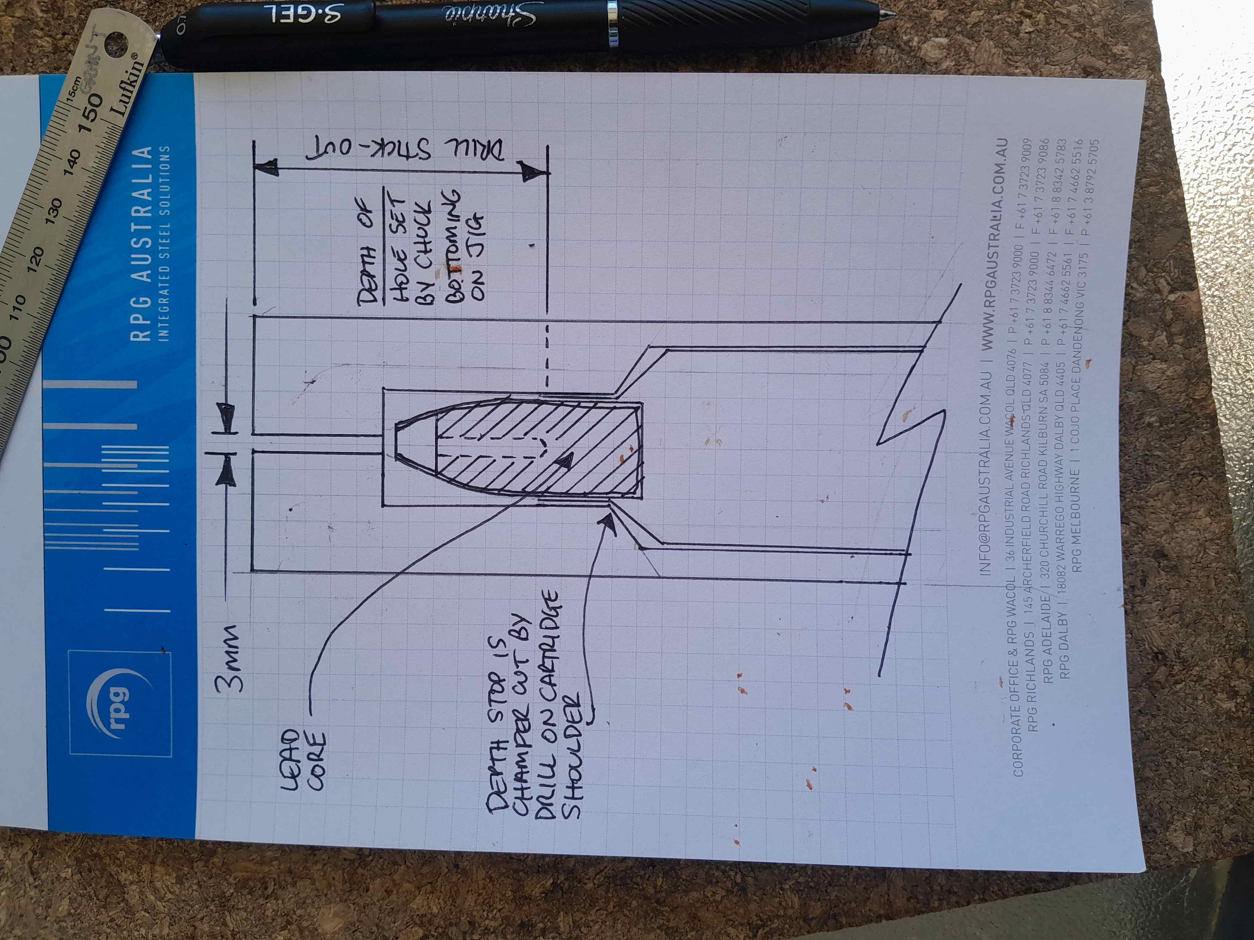

Then you'd drill out another bolt in the lathe for this now-modified cartridge, but with a 3mm hole through it to guide the 3mm drill down centrally into the projectile, down well into the lead core to a reasonable depth, to see if you can get expansion going in the subsonic rounds.
You would harden this jig too, so the 3mm drill wouldn't eventually open up the hole you made. This would ensure all projectiles were drilled central and will still spin reliably along their axis when fired.
You could set the depth of the hole by seating the drill bit into the chuck deeper, and use the chuck bottoming out on the hardened jig to make each one exactly the same. Maybe start by dropping the hole in about 10mm, well into the lead core.
The loaded rounds will then look like one of the ones loaded with those Speer 130gn hollow points, except with a larger opening perhaps.
Yes, the projectiles will be a bit lighter, maybe 10 grains or so. But they'll all be the same.
As you've made the projectiles lighter for the given powder charge, you will have actually made the load a little lighter for that charge. Because everything else remains the same except the projectile.
I'd be willing to bet that these rounds will still then, stay under the speed of sound but will have the shape to open up somewhat on pigs, definately. Maybe even on foxes and probably, dogs.
Then you can use them up, might be worth it.
Because I know you are not a paper puncher, and doing that with this ammo would feel like a terrible waste for you.
I did a doodle during a break from the damn exclusion fencing I am doing again.
The blood on the sketch is from a band aid leak, ignore that.

Post by Wapiti » 12 Nov 2025, 9:21 am
And the drill jig.
Completely safe to do, as these match projectiles designed for paper punching are all solid base, so there is no risk of shooting the cores from the jackets as there is with grinding the tips of FMJ military ammo projectiles.
I reckon this would work great, and DJ you are pretty good on the lathe mate.

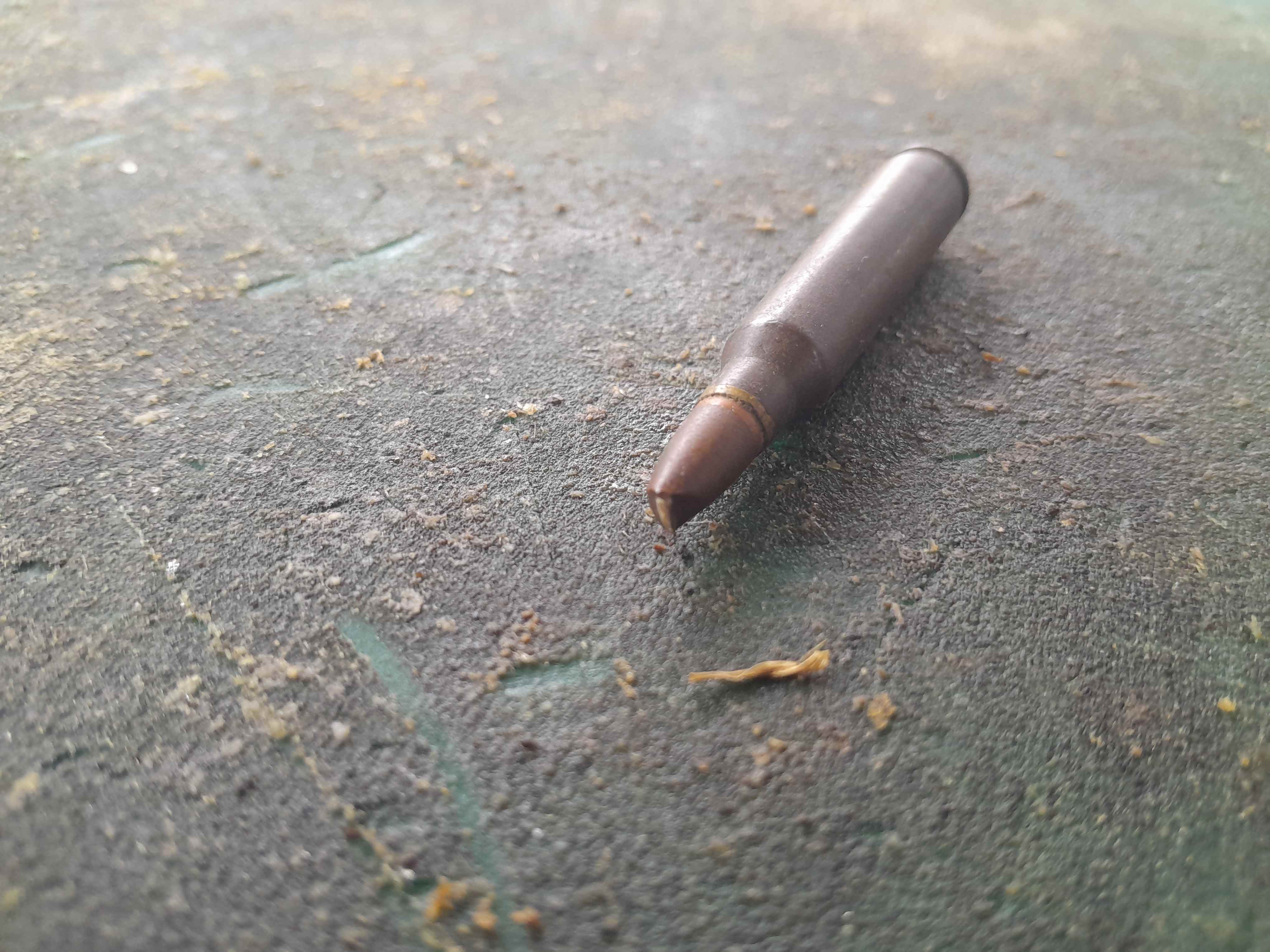

Years ago I found this 223 bullet in the yard when digging up the ground for a path, it is the typical 223 FMJ that we saw everywhere in the '80's when the only 223's a country person saw were the Mini-14's everywhere. Usually ending up traded in at the gunshops because they were pathetically inadequate in hitting power and accuracy expectations.
People just clipped their FMJ ammo with sidecutters, knowing that the tip of the ammo has bugger all influence on the zero of a rifle at normal culling shot ranges, usually within 200m if people are actually honest with themselves.
And I used to do it too, with 30-06 ammo in a Garand, and European strange FMJ 308 in an original M14. It bloody well worked too.
My sketches are a bit complicated, but you could make a big difference doing this. The hollow pointed drill hole has to be deep enough to make these super-slow low-energy rounds work. But at least they can be used up.

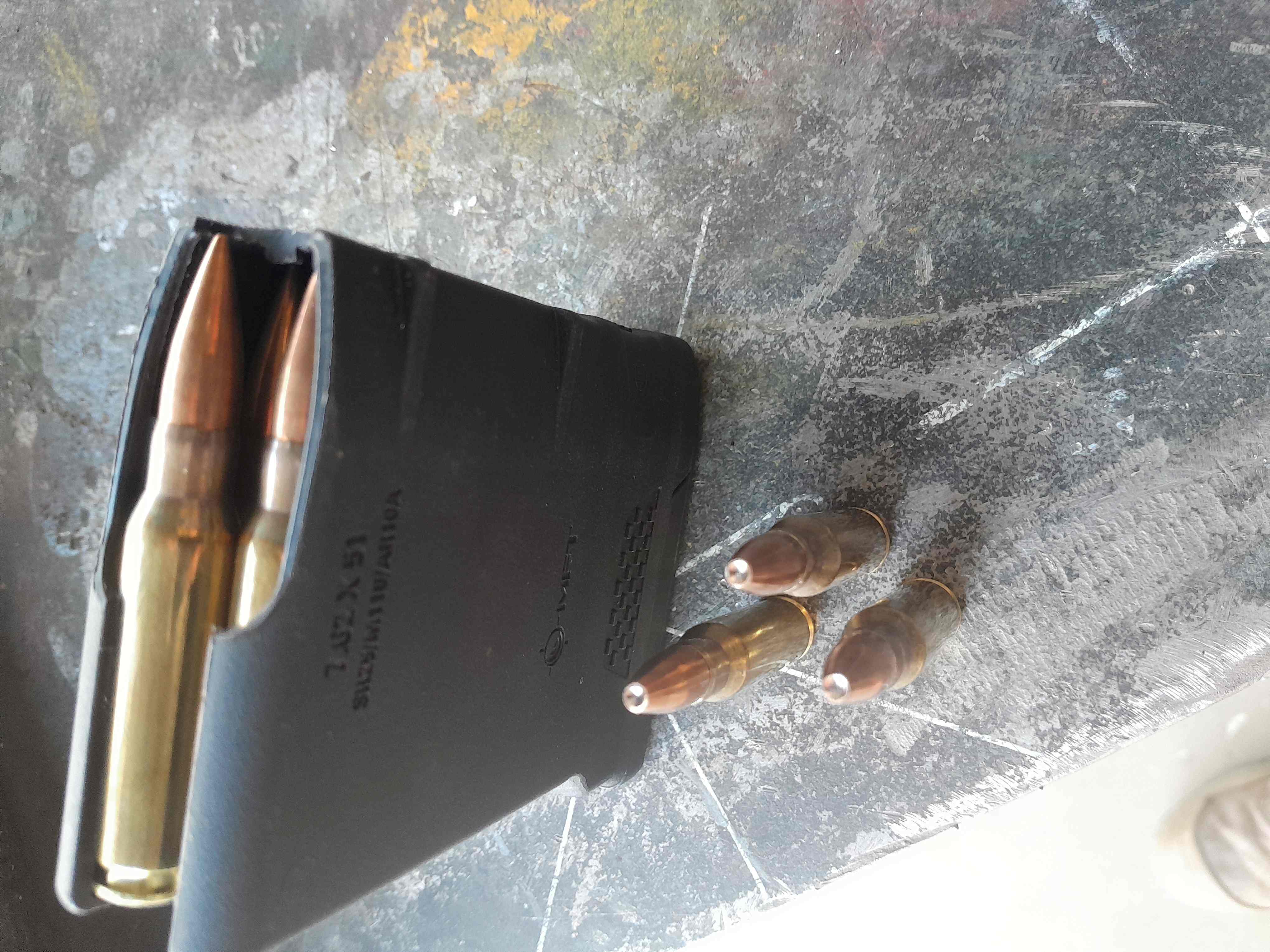

Had a play with a spare 10 mins this arvo, have all this ADI 147gn FMJ that I got from Cleavers for around $1/round. Good thick boxer cases so rather than waste the bullets and powder I did a simple mod.
They shot smack bang in the middle of a steel gong at 100m, hit mega hard, so I will try them on the next run around in a gelblaster, hopefully tomorrow.

Post by Wapiti » 23 Nov 2025, 8:25 am
Mate I just did these by hand, I didn't bother making a jig as I just wanted to prove this as a concept.
In that they cycled, and were consistent in point of impact, initially.
Not sure about using gel blocks... that they are truly indicative of certain game or ferals you'd be shooting. Haven't done it myself, but I've known of blokes who shoot a certain species because that's what they were doing anyway, then used the carcass to test a second rifle and its ammo for bullet performance. Of course in that case, they aren't risking losing an animal that may run off with a mortal wound yet not instant death.
Other thing I was looking at was the fact that, unlike your ammo where the jacket is open only at the tip, FMJ bullets are open at the base and the jacket is crimped around the heel of the bullet.
I have heard that in my case, if someone opens the tip up too much, the core can shoot out of the rifle barrel leaving the jacket, or bits of it, in the bore. Because it's open at the base, exposing the lead. Wouldn't be a great outcome shooting another projectile over that.
Now, that could be typical internet BS, but in theory it's possible so I wanted to try it. 3 shots isn't a big sample size though.
But in your instance, with the match bullets, that can't happen because the jacket is one piece all the way to the tip.
And as your bullets are going under 1100 fps, rather than these ones at nearly 2900, you will need a reasonably deep core hole drilled well into the lead to get expansion happening.
