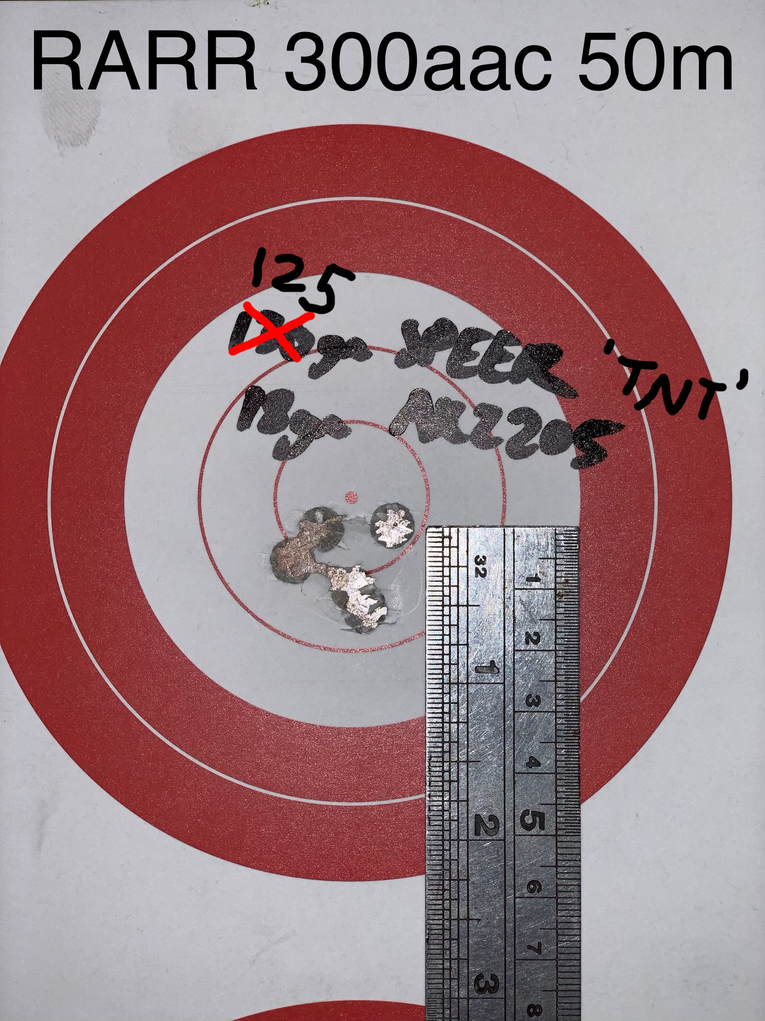

Re: 300 AAC Blackout fad over?
Post by in2anity » 19 Jul 2019, 8:44 am
Considering the forecast for Winchester powders in the Australian is looking bleak, I went back to revisit adi's AR2205 under the budget Speer 125gr TNT bullet. Sadly we cannot bank on Hogdons lilgun supplies in the foreseeable future :thumbsdown:
In the interim I've been learning more about differences between extruded "stick" powder vs double-base ball type powder. Lilgun is a type of ball powder. What does this mean? Well compared with extruded powders, ball powders are generally harder to ignite, and often give poorer standard deviations. Therefore lilgun really demands a magnum primer. And the harder magnum primers do not gel with with the (at least early model) RARRs (like mine). So in many ways, in my RARR 300aac it's actually more suited to an extruded powder like AR2205 (with a regular SR primer such as the cci400).
AR2205 was definitely a little finickier to get to group (at least compared with the lilgun loads), but thankfully I found a node with this powder+projectile+rifle combo last night:
18gr AR2205 under Speer 125gr "TNT", light crimp. 4x scope.
For the record I went up to a compressed 19gn AR2205 load without any pressure signs (AR disclaimer in a bolt gun I might add!!). The 18gr load is yet to be chronoed, but from my previous findings, std-dev should be more than adequate with AR2205. I take comfort in knowing it's not the very hottest of loads as I was seeing primer pockets opening up with hot lilgun loads.
This journey has also brought into light the potential need for a crimp; not from an accuracy perspective, but rather the RARR seems to be fairly rough on the projectile as it feeds from the rotary magazine. I feel sometimes the gun would set-back the pill, leading to flyers and pressure spikes. I'll be crimping from now on just to relieve my anxiety about any set-back, which really makes a bullet with a cannelure (like the Hornady SST) a little more desirable... still a light crimp on the cannelureless Speer bullet certainly does not seem to do any measurable harm to group sizes.

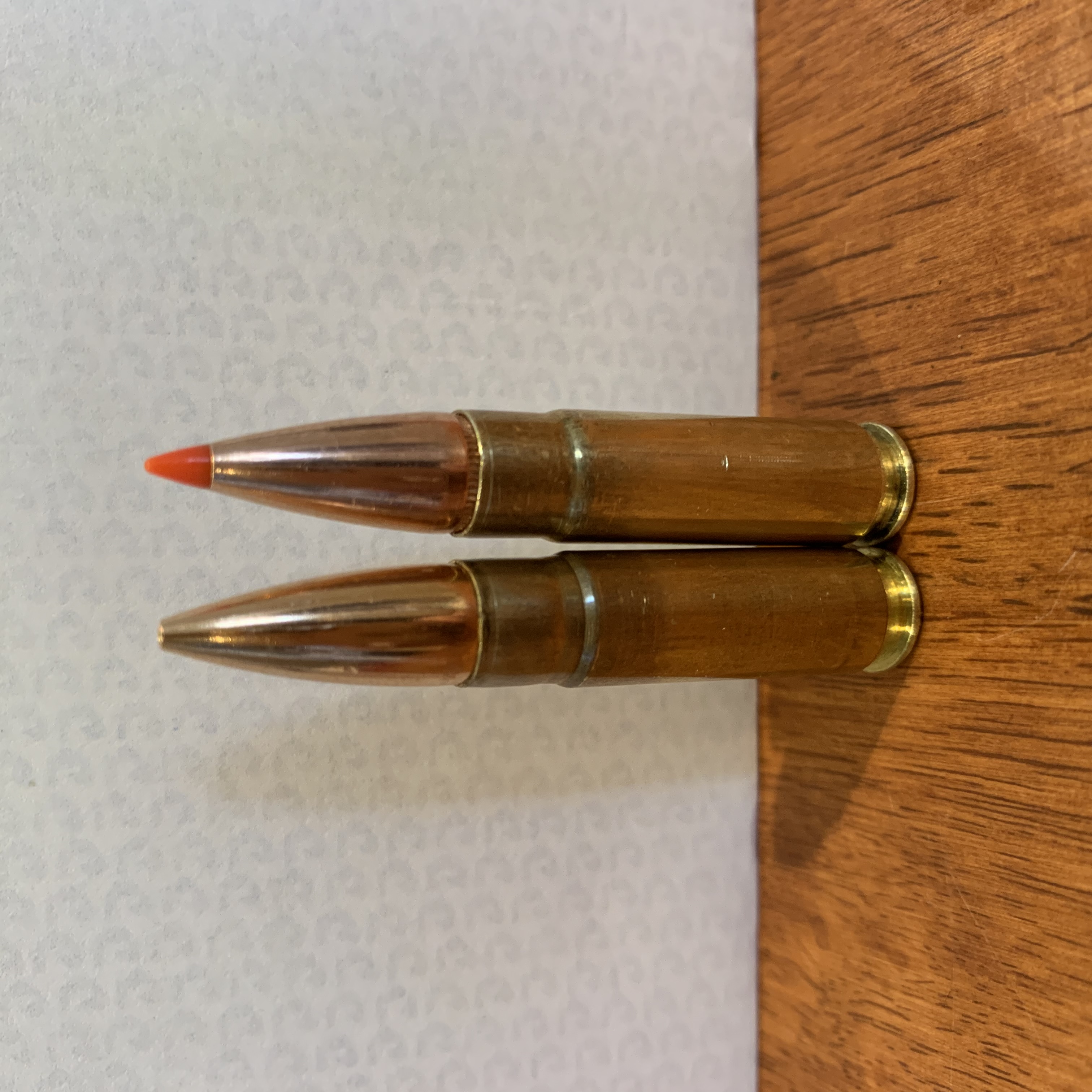

Post by gunnnie » 20 Jul 2019, 12:46 pm
JimTom wrote:Yep the 125 SST feed faultlessly out of mine too mate. Fortunately they are accurate and perform well on the hogs too. Seems the magazines just don’t like feeding hollow points.
Seems odd as when you look at the two projectiles, they look almost identical in dimensions, location of ogive etc. You'd think that both would feed without issue.
gunnnie
Posts: 284
Post by JimTom » 20 Jul 2019, 1:17 pm
Yes mate I agree. It is perplexing. The last round out of the magazine seems to drive straight up and jam.

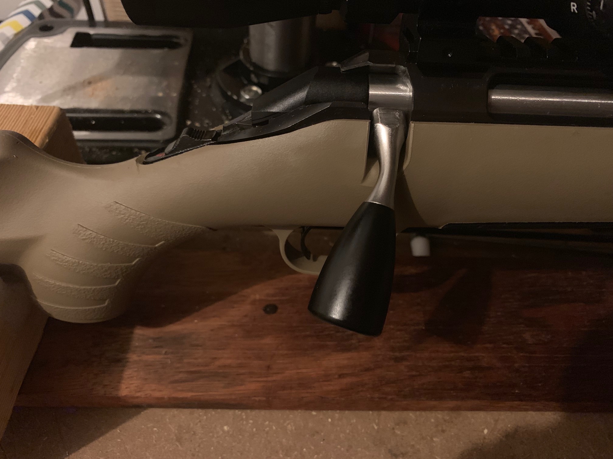

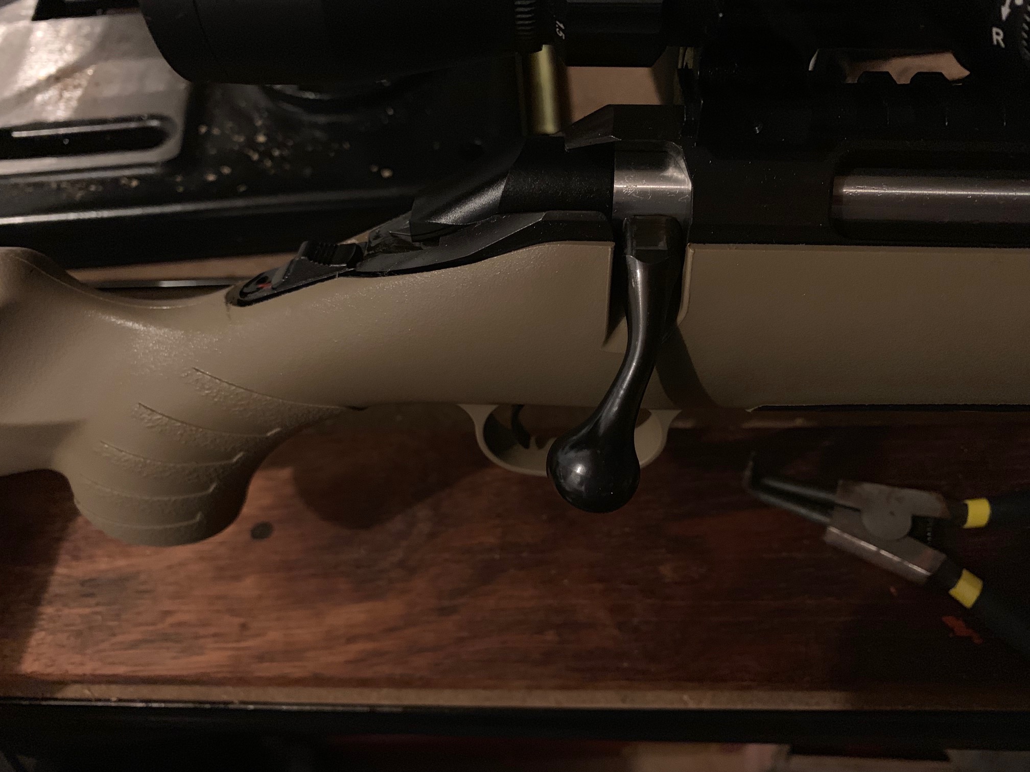

Post by in2anity » 22 Jul 2019, 3:48 pm
For those of you sporting the RARR - when slung-up, I noticed the factory bolt handle was uncomfortably small, to the point it was leaving the palm of my hand tender after a long session. So I swapped it for a Glades Armory version:
this:
factory bolt handle for tiny hands
became:
no more sore hand after a long slung-up session
No dramas coming through AUS customs. Much easier to cycle the bolt now :drinks:

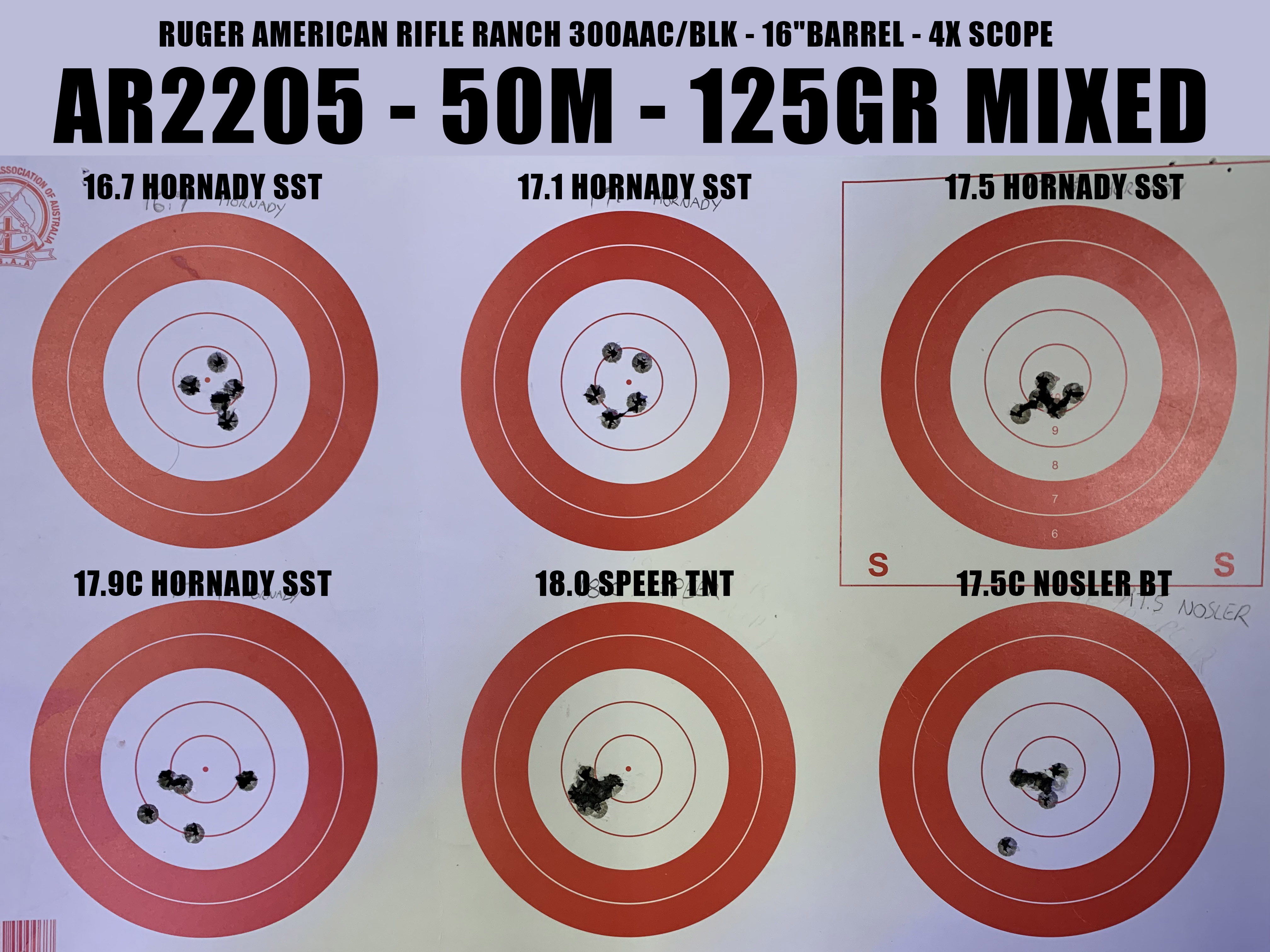

Post by in2anity » 28 Jul 2019, 9:42 pm
SCJ429 wrote:My experience with the Speer TNT is that they are very effective, at least as good as the SST. The TNT has accuracy potential way beyond its price point. I am betting the TNT works well for you too.
Now that I found my node, the Speers indeed do group pretty consistently. They just don’t feed well in that Ruger. In contrast they feed faultlessly in the Tikka 308 - but I prefer the little blackout for a stack of other reasons.
Post by in2anity » 30 Jul 2019, 8:41 am
mixed bag of 125gr pills at 50m over AR2205
JimTom you were on the money with your suggested 17.5gr load under the Hornady SST!
And SCJ429, I think you are onto something with your observations that the Speer Bullet shoots way above its price-point. Given my overall experiences with the 300aac, I think the Speer bullet does group fractionally better than the Hornady. Nevertheless, the Hornady bullet feeds very reliably, so I guess I'll stick to the Hornadys when reliability really matters (like during a comp or when hunting).
I've only shot that one (arbitrary) Nosler load. I'm sure it would also have some sweet spots, but compared to the others it's just so darned expensive, so I'll doubt I'll pursue that line of enquiry. I'll back-burner that one for a rainy day.
At this point, I'm going to say the little RARR-300aac is a true one-minute gun. The cartridge is certainly a lot finickier than say a 223, but using the collet die, it's a superb handloader's cartridge. Neck tension with this cartridge seems particularly pertinent. The 300aac is economical, low recoiling, has excellent case life and runs cool.
