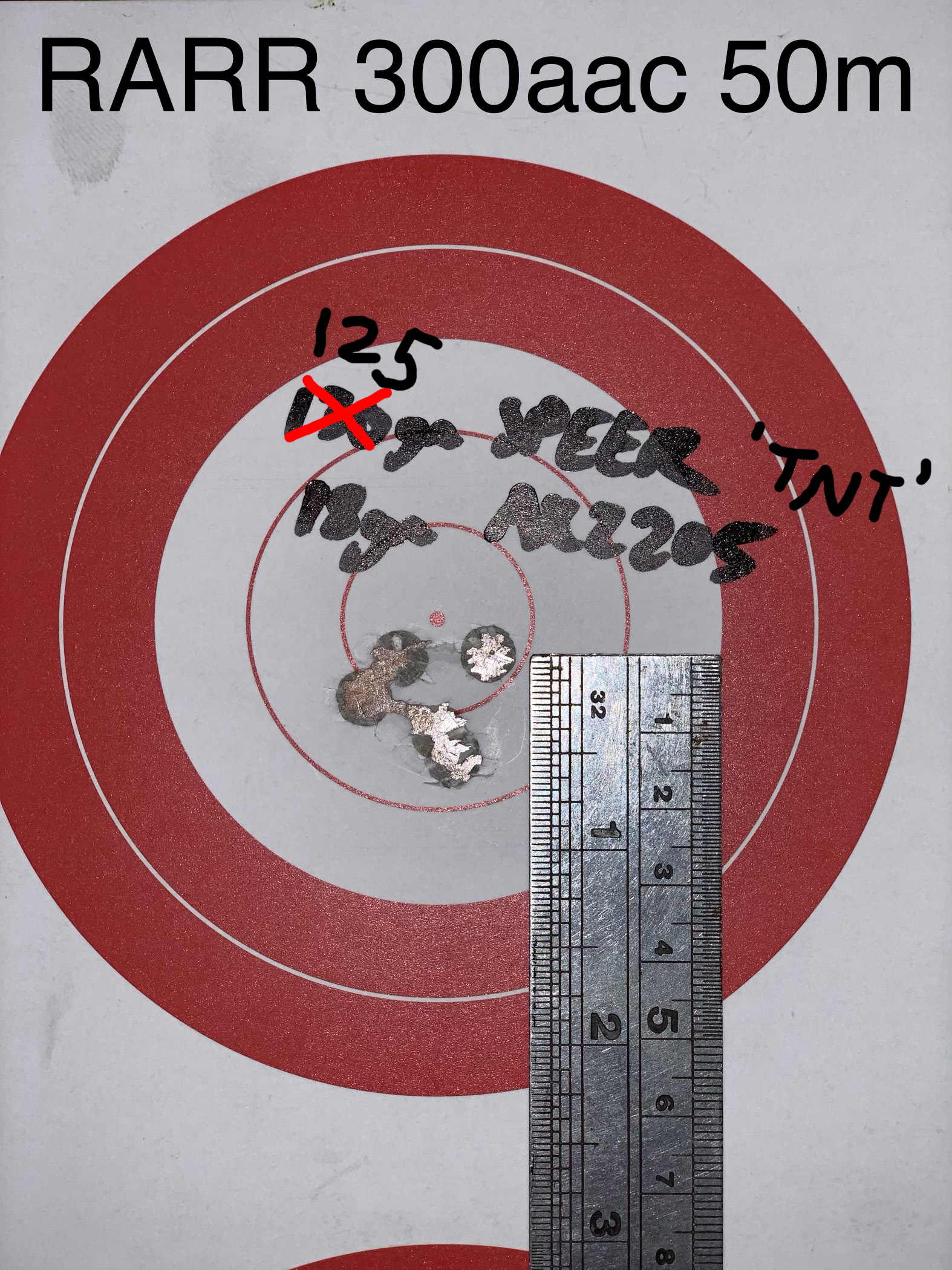

AR2205 was definitely a little finickier to get to group (at least compared with the lilgun loads), but thankfully I found a node with this powder+projectile+rifle combo last night:
- 18gr AR2205 under Speer 125gr "TNT", light crimp. 4x scope.
- speer.jpg (1013.76 KiB) Viewed 12550 times
For the record I went up to a compressed 19gn AR2205 load without any pressure signs (
AR disclaimer in a bolt gun I might add!!). The 18gr load is yet to be chronoed, but from my previous findings, std-dev should be more than adequate with AR2205. I take comfort in knowing it's not the very hottest of loads as I was seeing primer pockets opening up with hot lilgun loads.
This journey has also brought into light the potential need for a crimp; not from an accuracy perspective, but rather the RARR seems to be fairly rough on the projectile as it feeds from the rotary magazine. I feel sometimes the gun would set-back the pill, leading to flyers and pressure spikes. I'll be crimping from now on just to relieve my anxiety about any set-back, which really makes a bullet with a cannelure (like the Hornady SST) a little more desirable... still a light crimp on the cannelureless Speer bullet certainly does not seem to do any measurable harm to group sizes.
