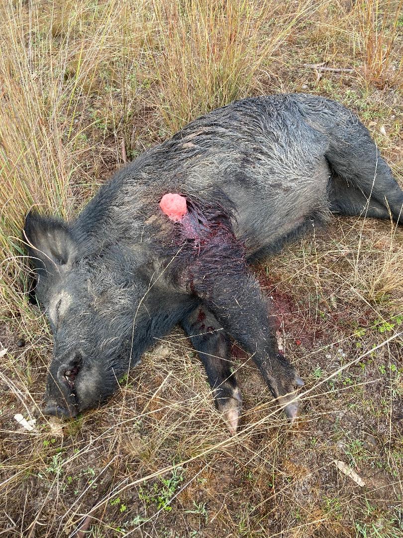

Shot a Pig at 180 meters with an instant kill. Entered through shoulder and into the lungs.
Why such varied results at almost exactly the same meters range ?
With the same ammo and rifle I've shot other pigs (also chest shots) and had the projectile explode on the surface and Mr Porky just kept running.
I would expect that,,,,,,,, being HP's,,,,,,, but this last one (pic) it went straight in through the lot.
There seems to be no rhyme nor reason.

Post by Oldbloke » 17 Jul 2024, 7:56 pm
How fast are they going?
Looks to me that are thin cupped, soft.
They are designed to expand/explode pretty fast.
Small variations in resistance, e.g. bone, no bone, can give variable results. Hit a rib/shoulder, explode, miss the rib, more or less normal result or whistle through.
Personally, I don't think you can go far wrong with a basic cup and core SP., something like interlock sp or hotcore sp.
I use interlocks in my 30.06, I get variable results too if I miss bone.
When you pull the trigger the variables are huge.
Hit bone.
Miss bone.
Close.
Far
Big animal.
Small animal.
Muddy shoulder
No mud
What Bullet will do it all??
Perhaps use a 150gr sp bloody popular.
