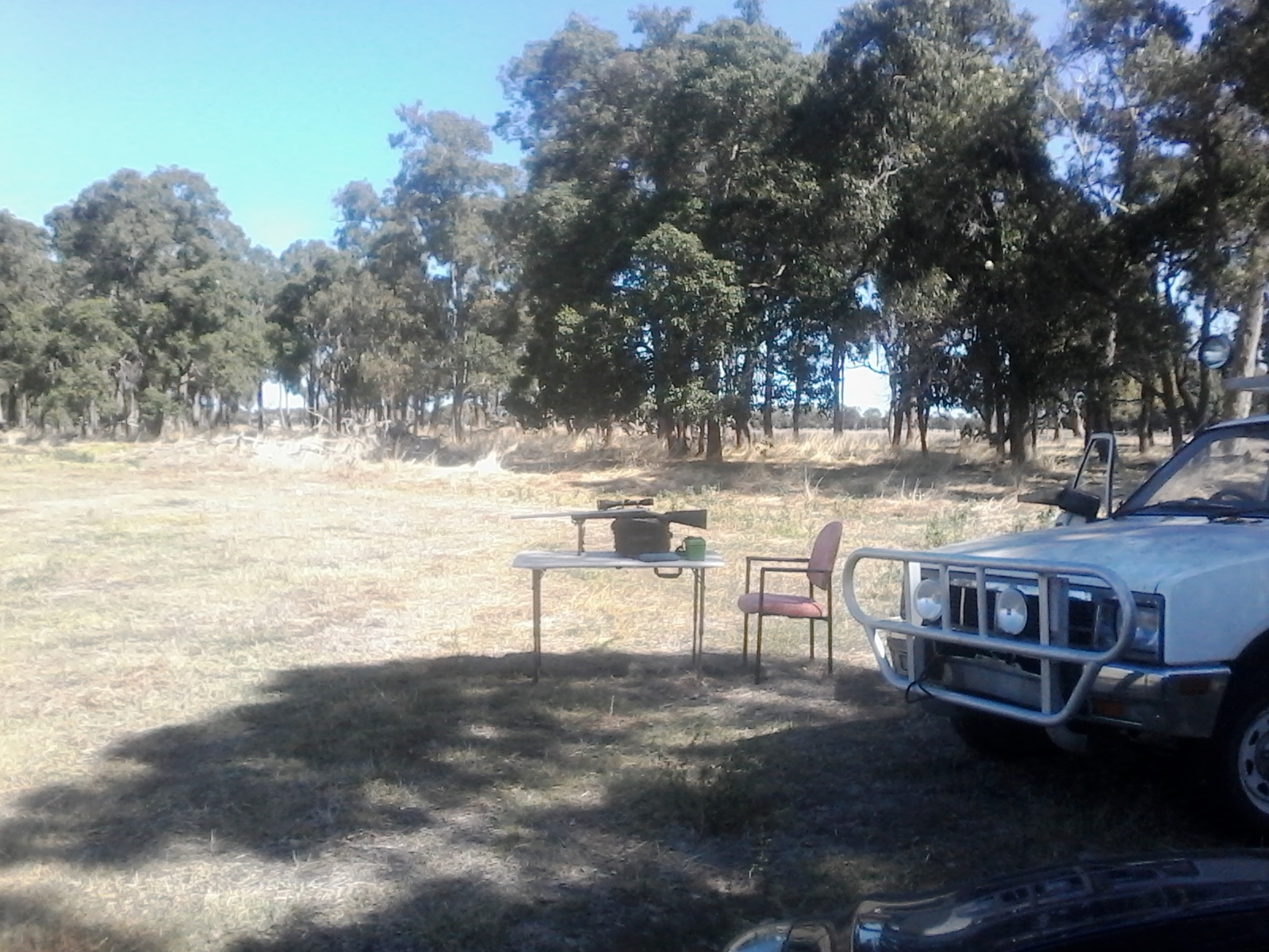

Post by duncan61 » 16 Apr 2017, 9:53 pm
the 100 range.jpg (638.8 KiB) Viewed 3618 times
farm shooting.jpg (770.25 KiB) Viewed 3618 times
Had the best time ever shooting today.I remember now why I stopped using the 7mm for F/Class.The 168gn Matchkings hurt after 10 shots.The best group I managed was prone on the back of the ute at 275 metres where I put 3 in a fox head target.Uncomfortable as hell but stable.I miss my plastic benchrest that had adjustable feet and could use over the bonnet.The plastic table is O.K. at 100 but not stable.2 things will be done.
.Make a new benchrest
.Develop an F/Class round based on .473 inch base or 308/243 as I have an Howa action in this size and I am learning that this is the same size as 8/57 mauser from the turn of the century.Any help will be appreciated in choosing a chambering like 6mm/284 or 6mm remington.I am going to buy a 30-32 inch barrel locally and get one of them whiss bang adjustable stocks in bright colours
