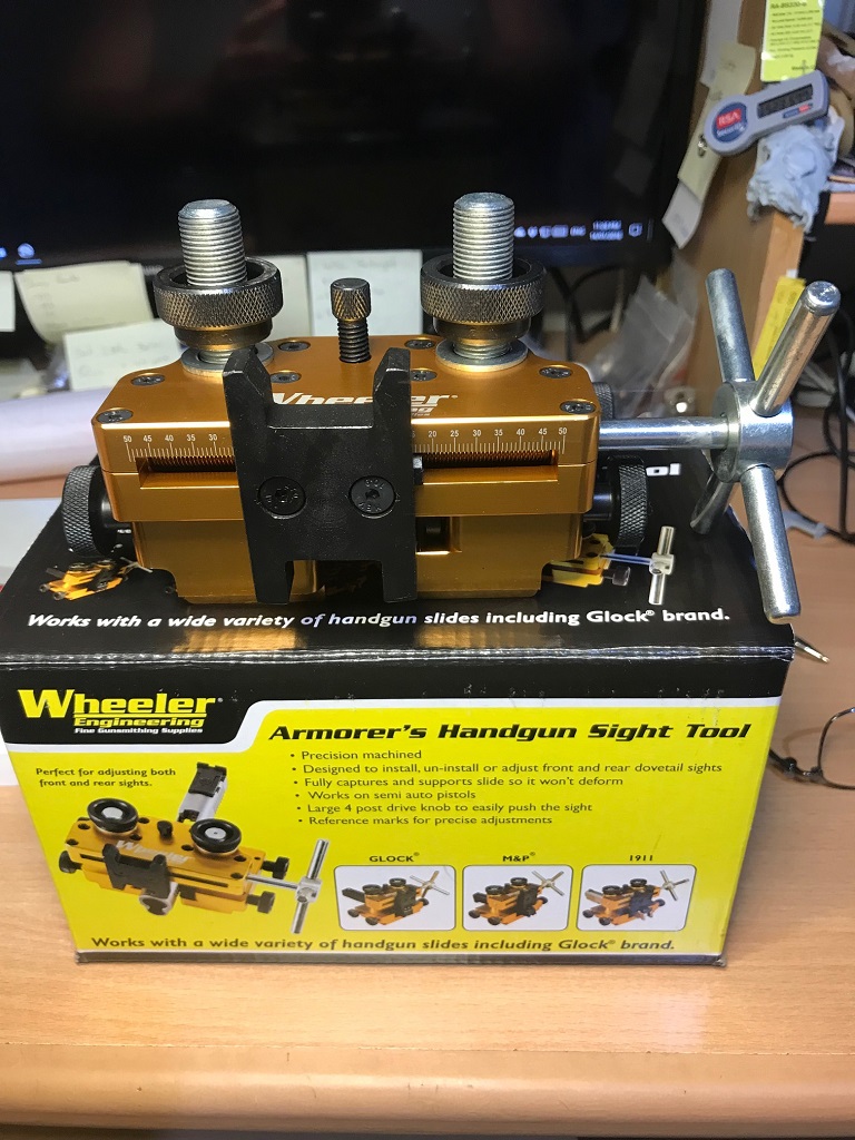

Post by brett1868 » 14 Jan 2018, 10:42 pm
I've got quite a good collection of tools but this is the most recent...
Finally I can set windage properly on some pistols and not have to worry about holding left or right. Tool purchased from my good mate Zhen at Midway Australia and already saved a lot of bad language when swapping a rear sight on a Beretta 92FS :)
https://www.youtube.com/watch?v=R5phKttc8cM
