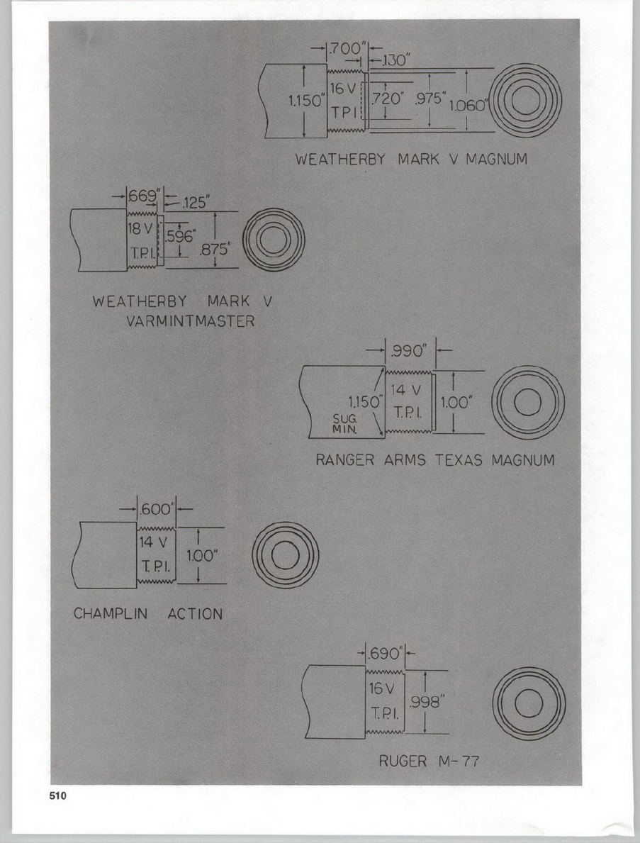

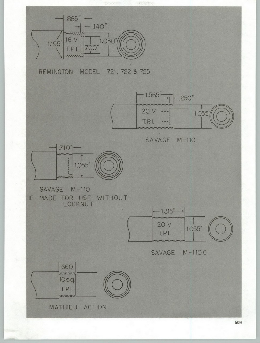

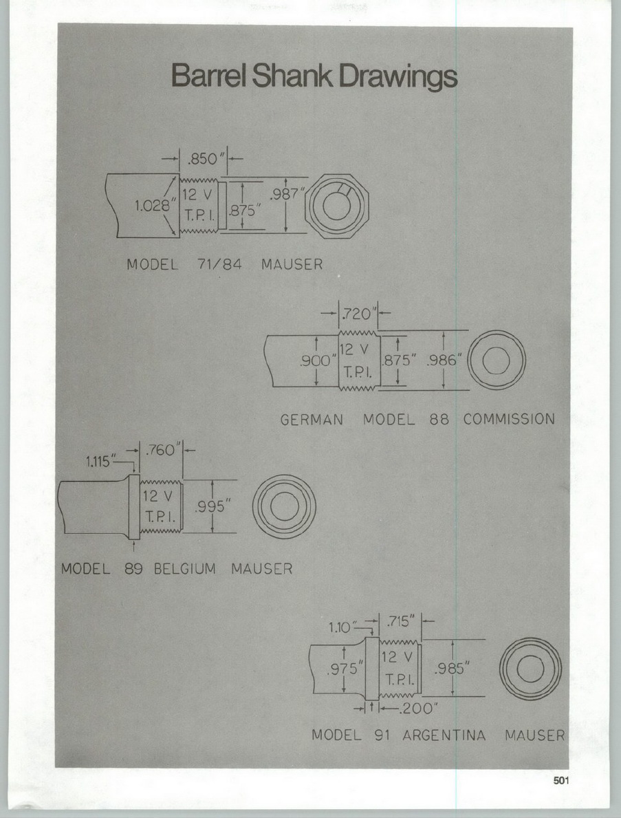

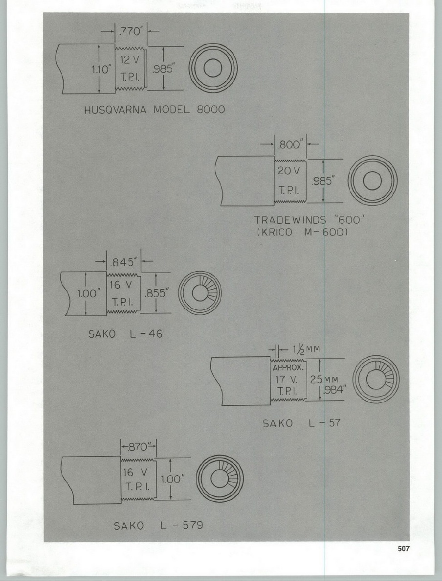

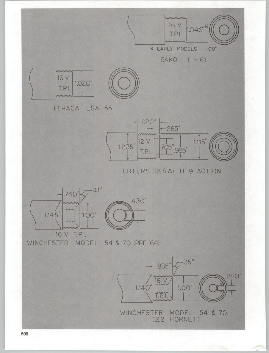

I bought a barrel and had to identify it.
It occurred to me that it might be useful to have the information online somewhere.
From Frank DeHaas' Bolt-Action Rifles.

The barrel shank drawings were the main reason I wanted it as I couldn't find them online - I have now though so I thought I'd share them.
