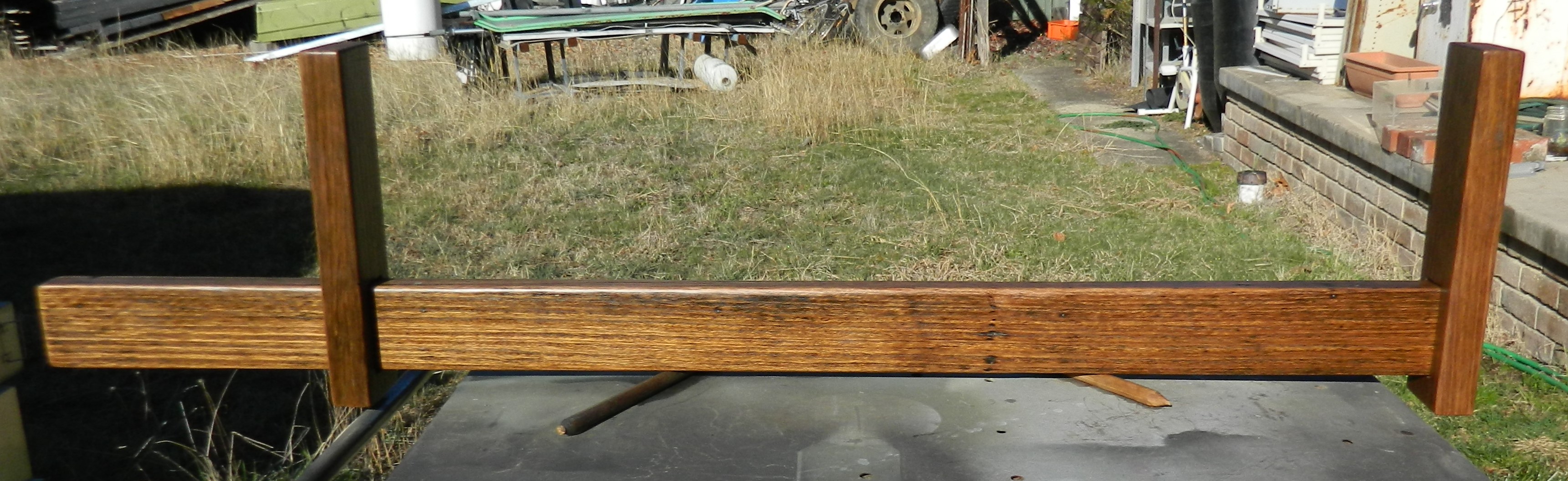

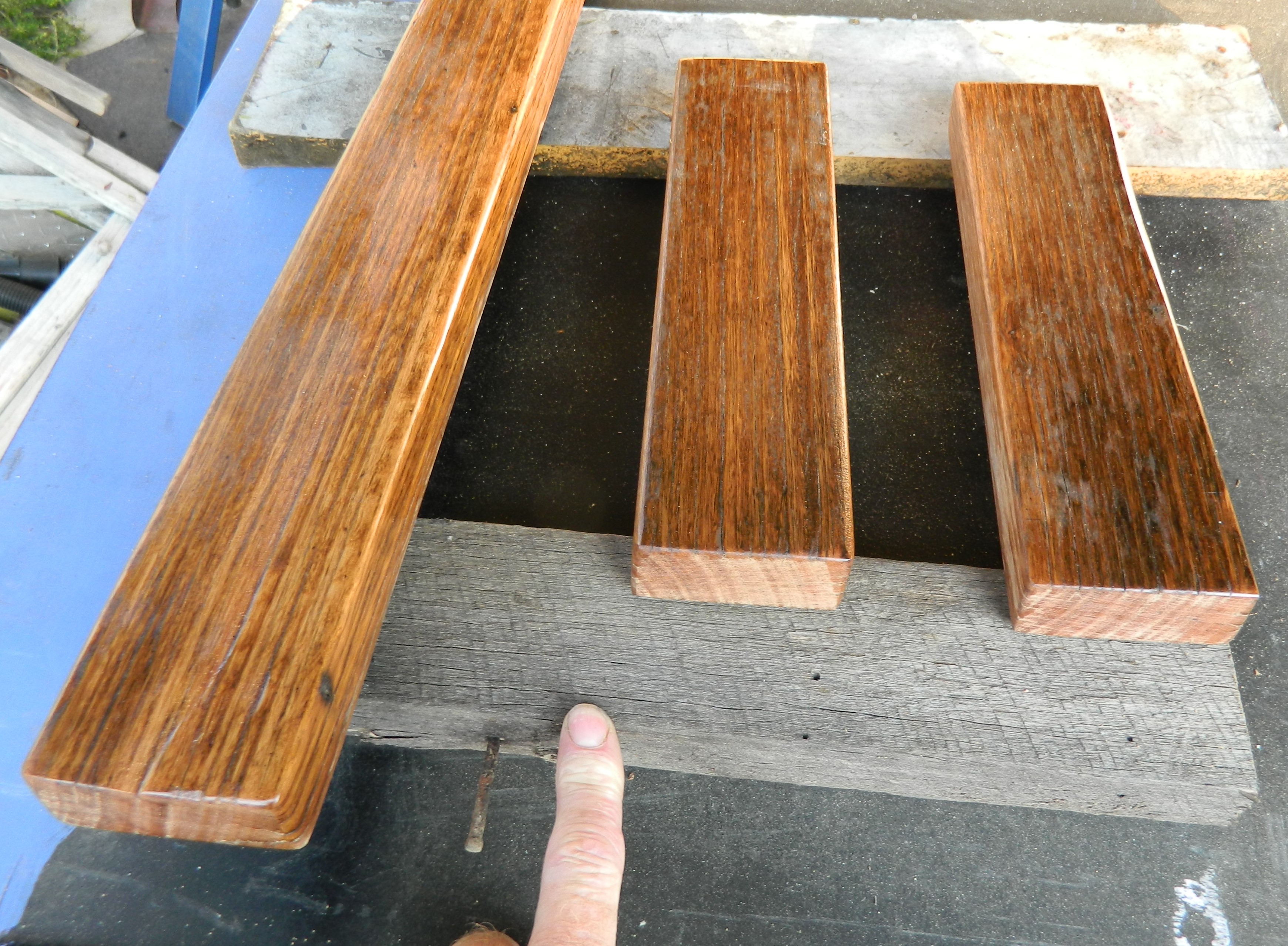

As some may be aware, I have been refurbishing an old rifle (BSA Hunter), and this includes fitting a new stock.
So with the stock as finished as I can, for the present, I figured I would have go at cutting the checkering on this new stock.
This isn't just a thing I know I can do, with a padded bench vice, so I figured I need myself a cradle, that holds the stock, whilst undetaking this work.
I've seen a couple of these over the years, and I had a look on Goggle recently, so I now have a better idea of whats required.
I decided to go with one made from wood, so I had a look around the backyard, and found a length of 3" x 1 1/2" Eucalyptus of some description. It used to be the bit of wood, that fence pailings are nailed onto.
I cut it into 3 lengths, and then sanded all the old and aged grey exterior wood off it, to reveal the real colour of the wood underneath.
You can see here, where my finger is resting on the old grey wood off cut (with Borer Holes and a Nail in it), and the three pieces of wood after, with a coat of timber oil on them.

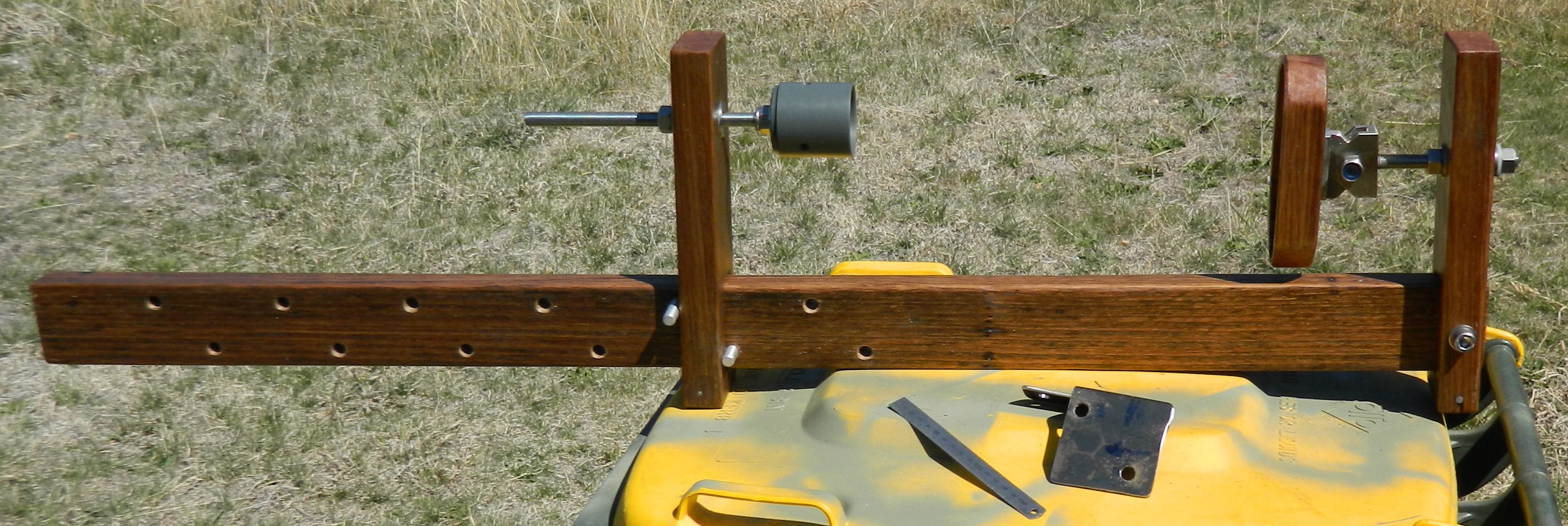

I then cut a few rectangular holes in the two short pieces, a slid them onto the long piece of wood.

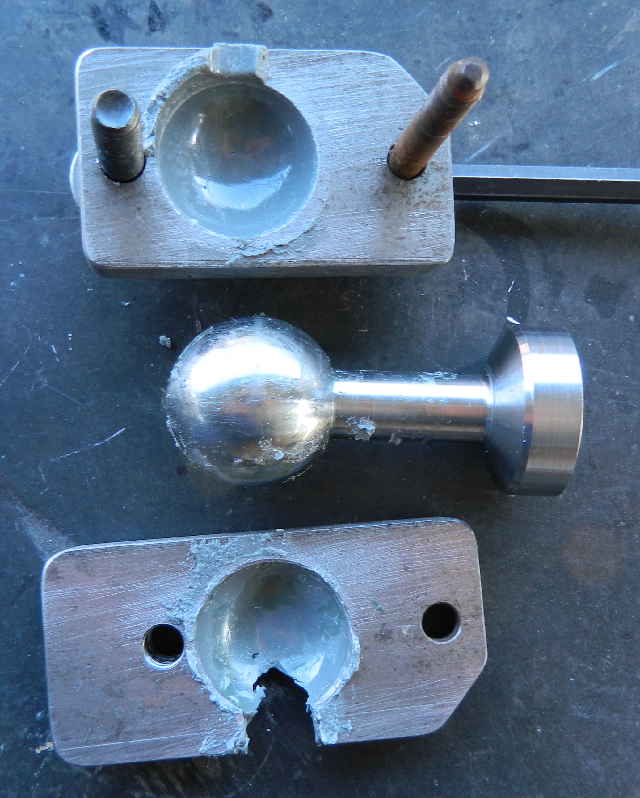

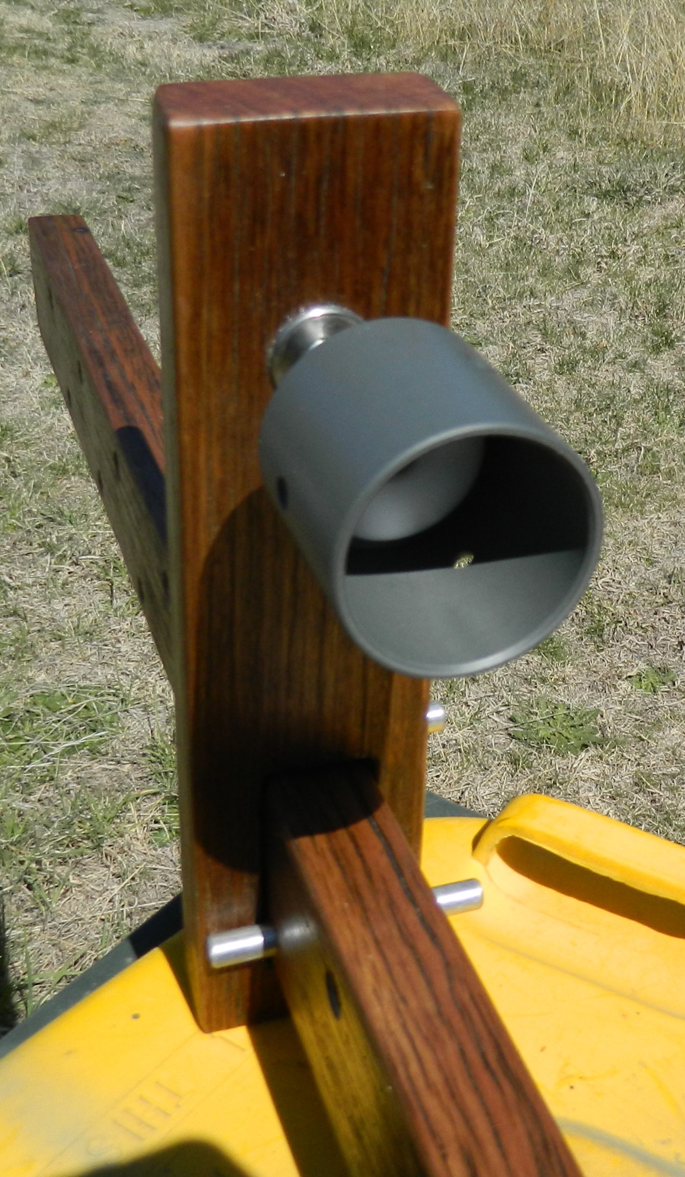

I wanted to be able to both swing, and swivel the cradle, so I could change it's position.

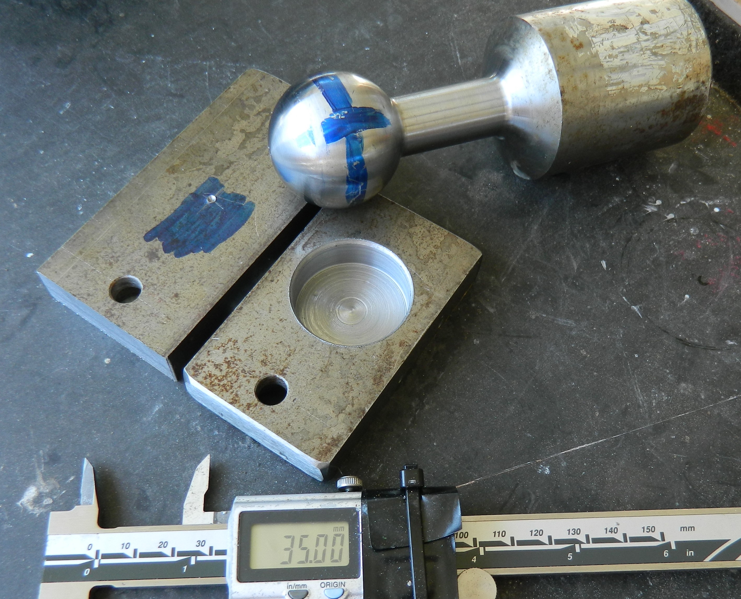

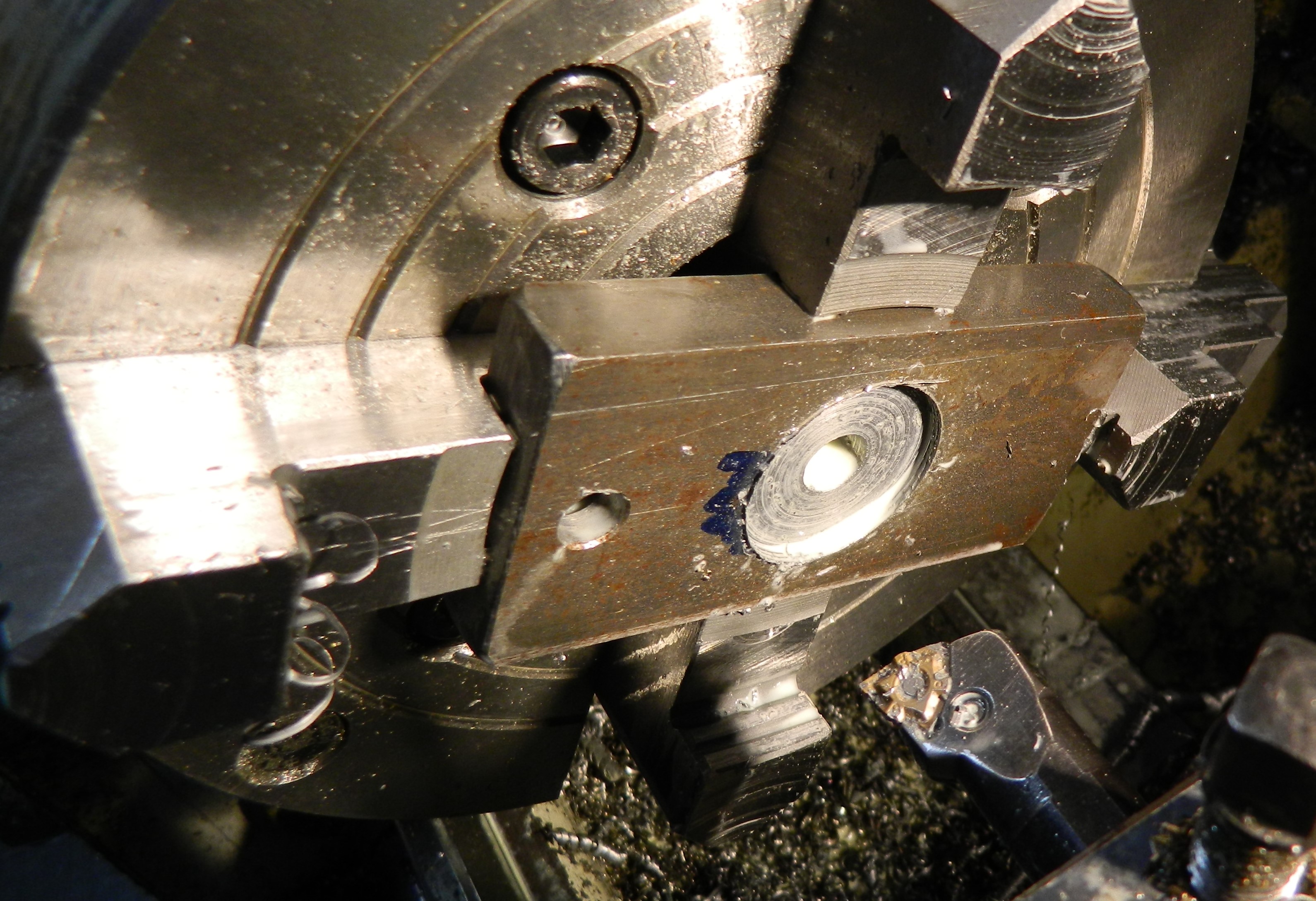

I found a 40mm Diameter ball, in the Bits & Pieces bin and made up two "Halve Cups", to go on either side of the ball.
You could do a similar thing, with an automotive/car 51mm / 2" round tow ball.
Once that was finished and a couple of extra holes were drilled, I then mixed up a batch of Epoxy resin with atomised Aluminium, and completed this part of the job.

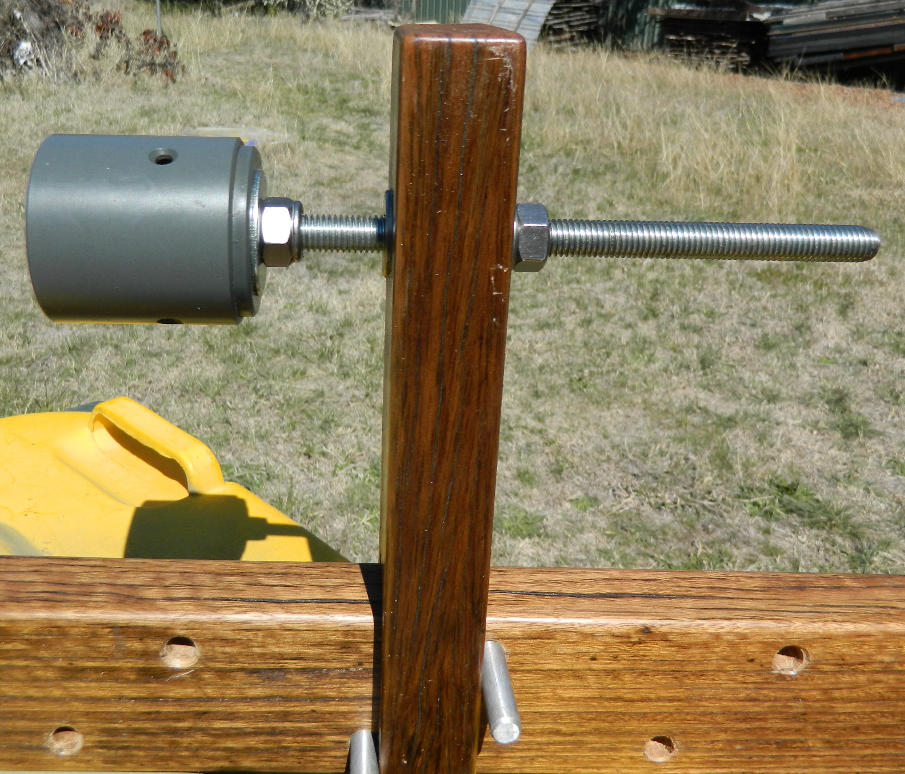

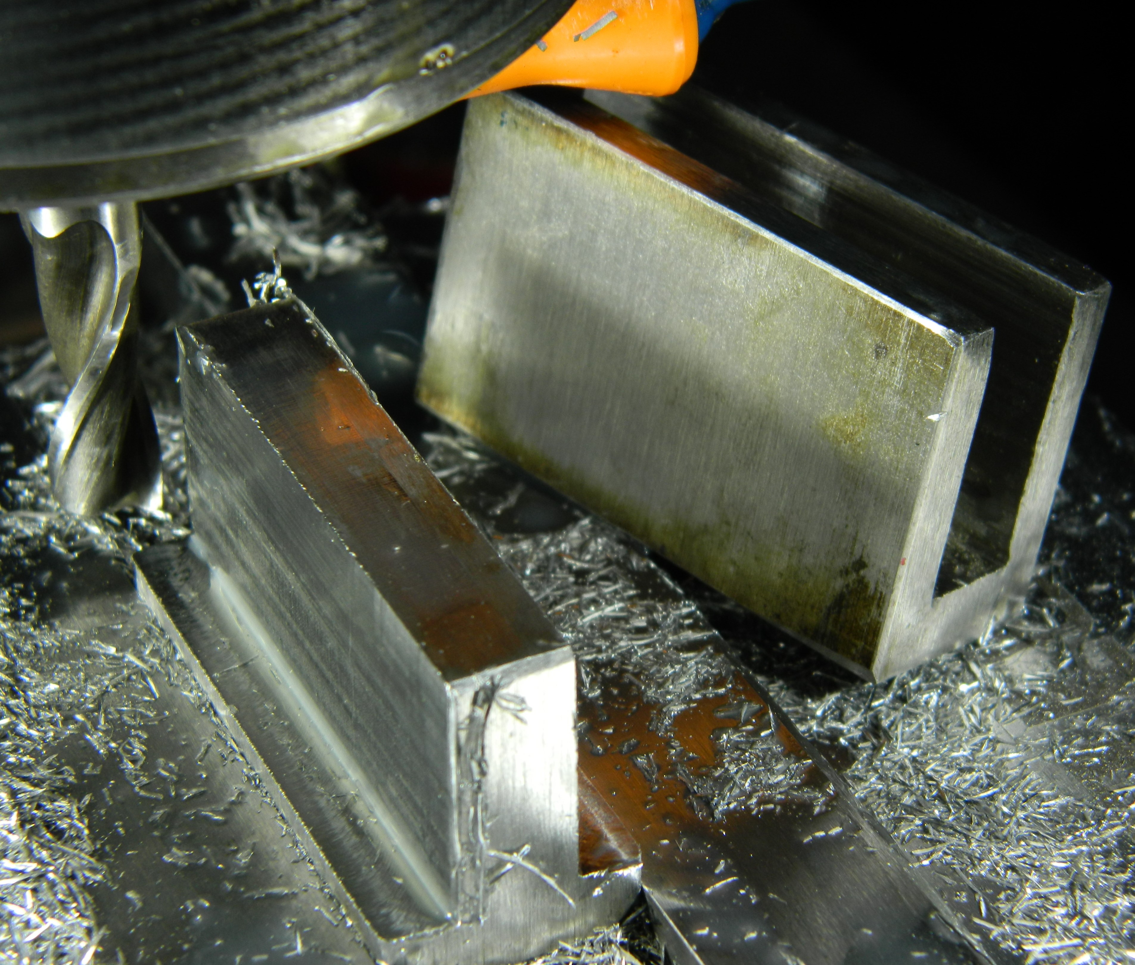

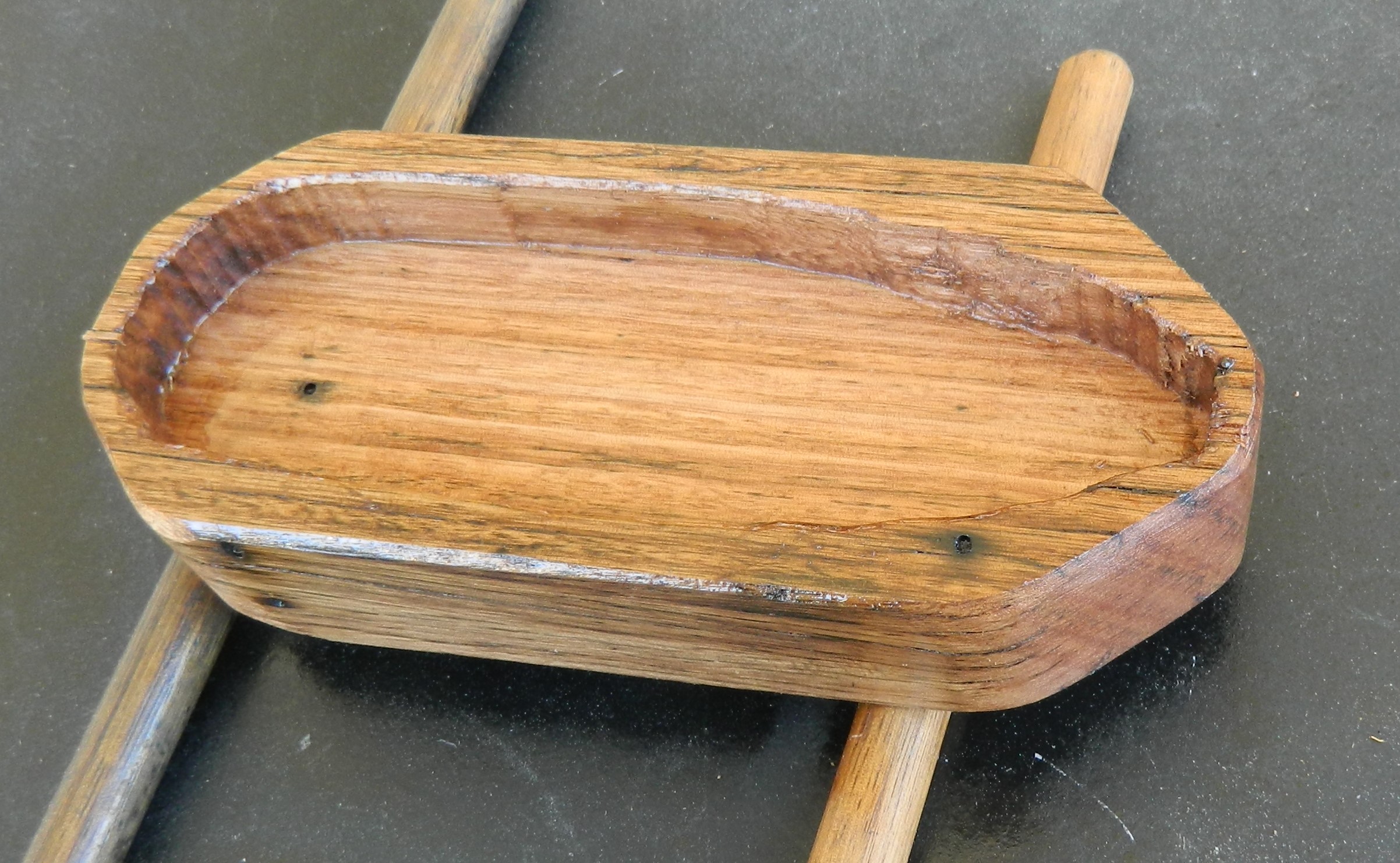

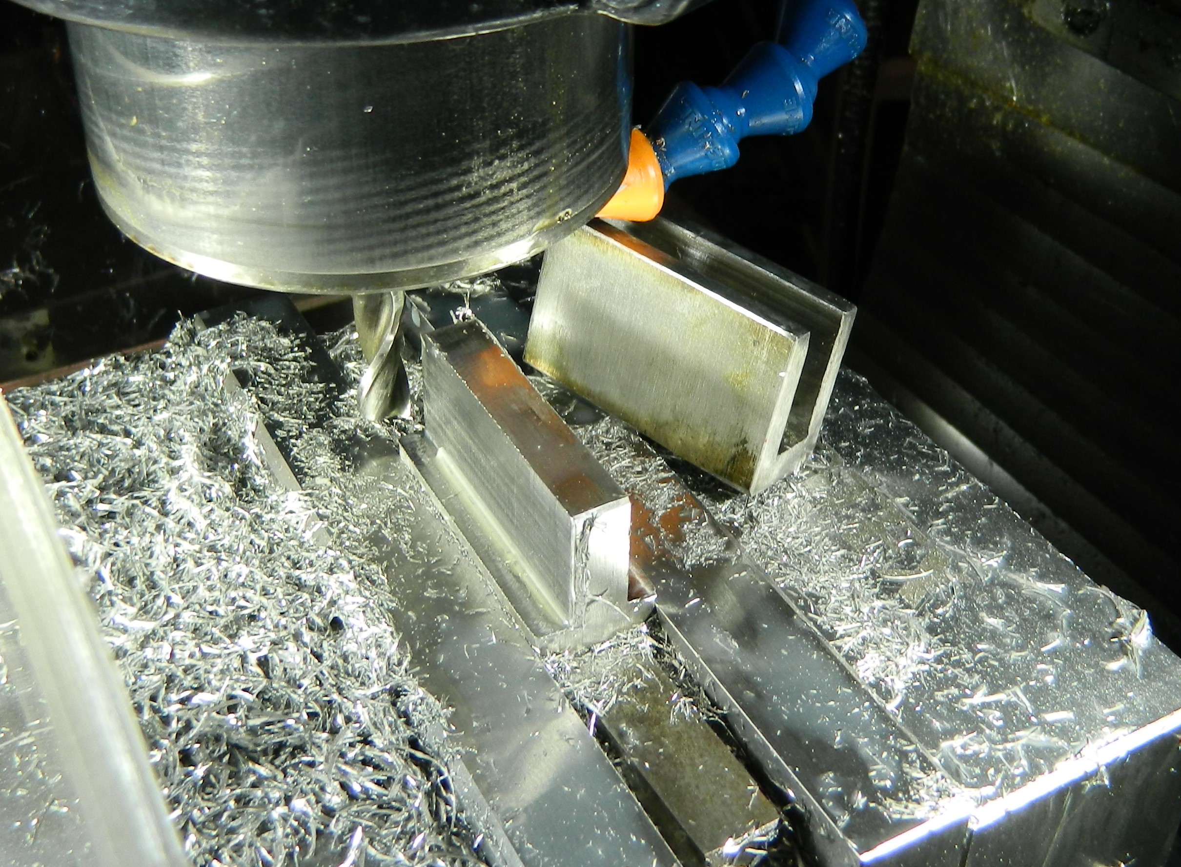

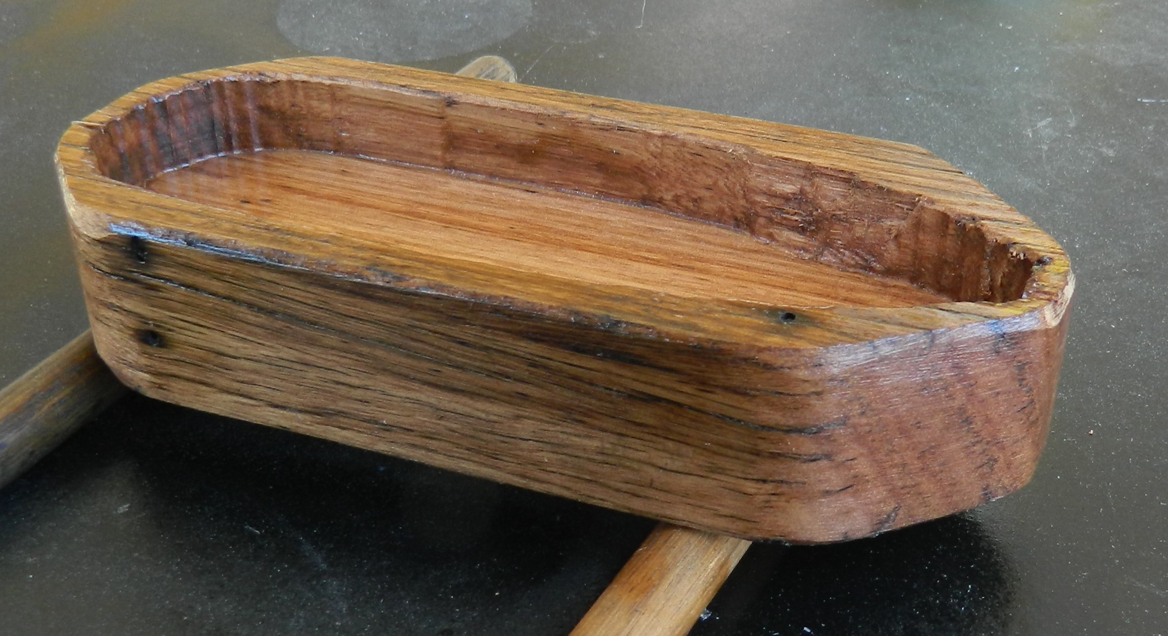

I made up some of the furniture for the cradle, including the pivoting parts and wooden "cup" (name?) that holds the butt of the stock.
I made this, from the remaining off cut of this same piece of wood.
The pivoting furniture (2 x parts) for this, was machined out of some 20 x 50mm stainless bar.

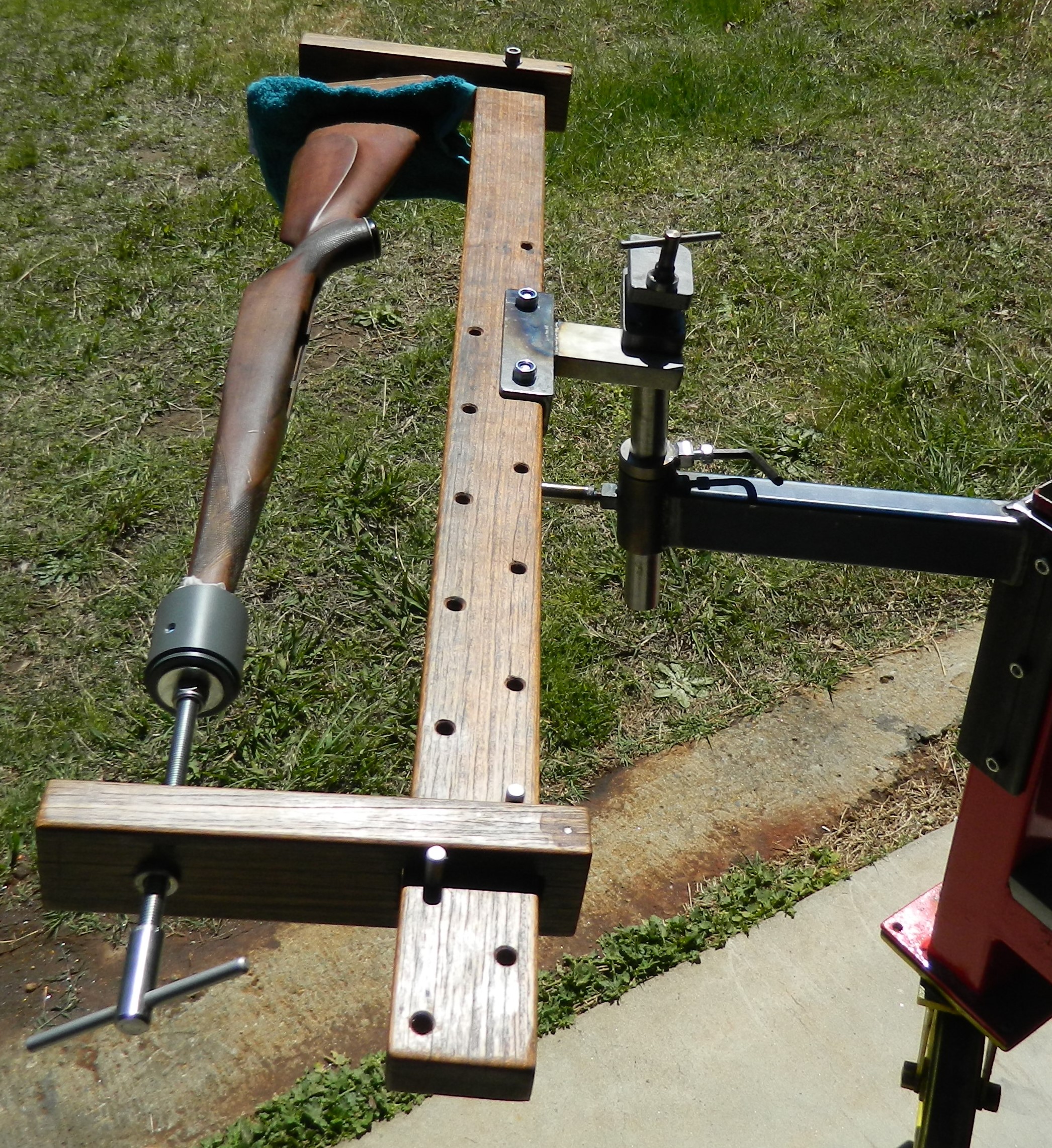

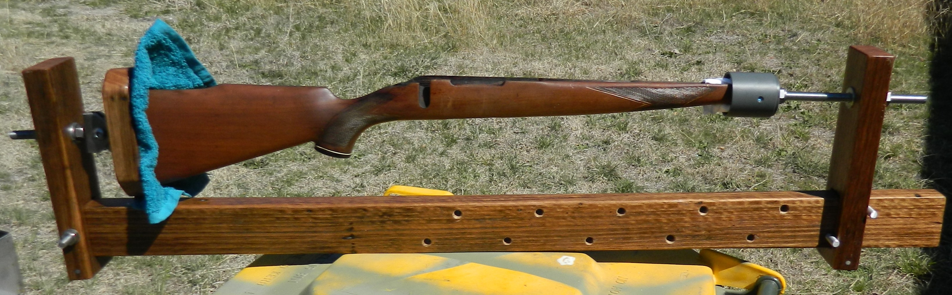

It's getting close to being finished.
Here are some additional images of this cradle.

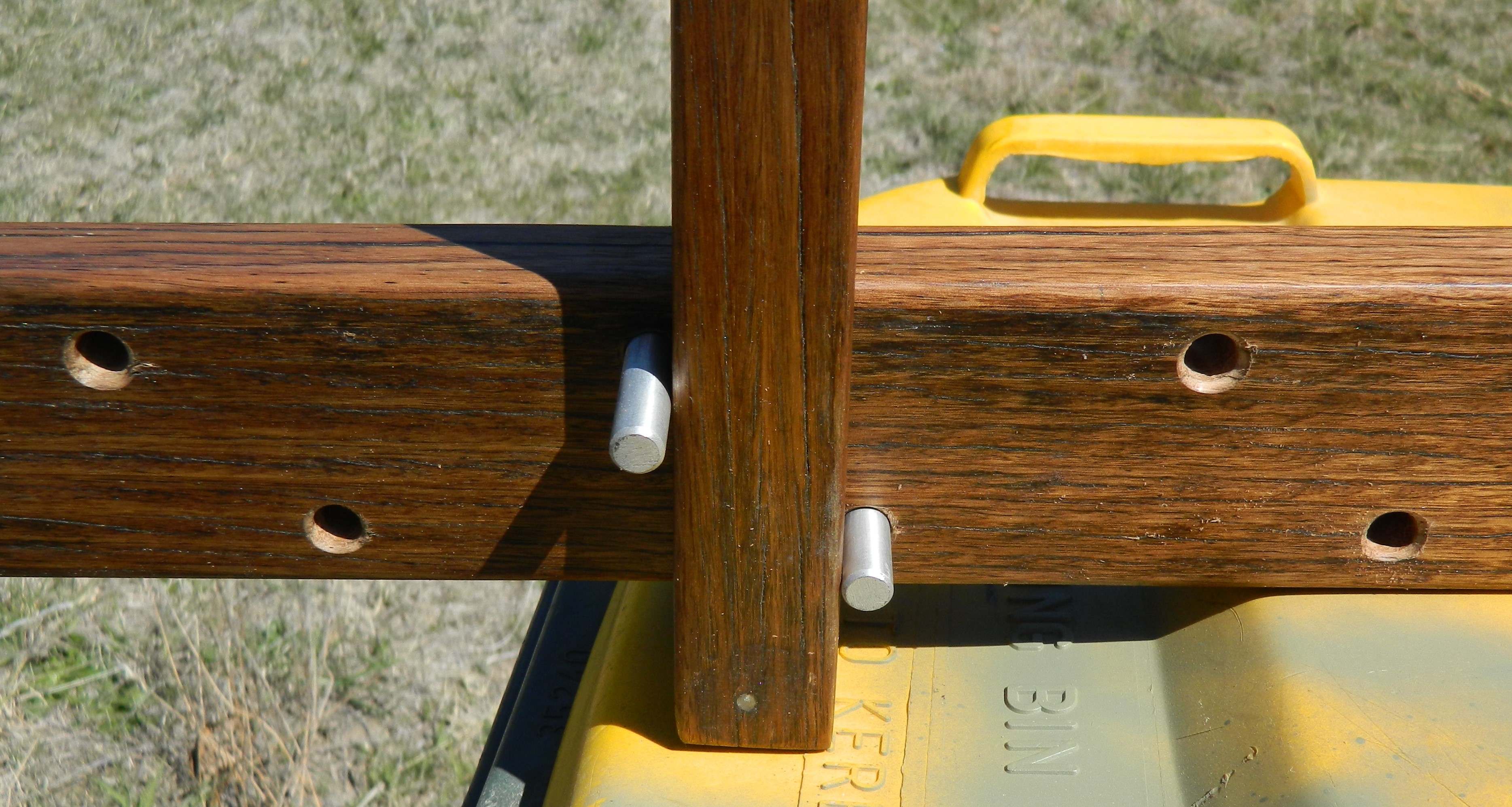

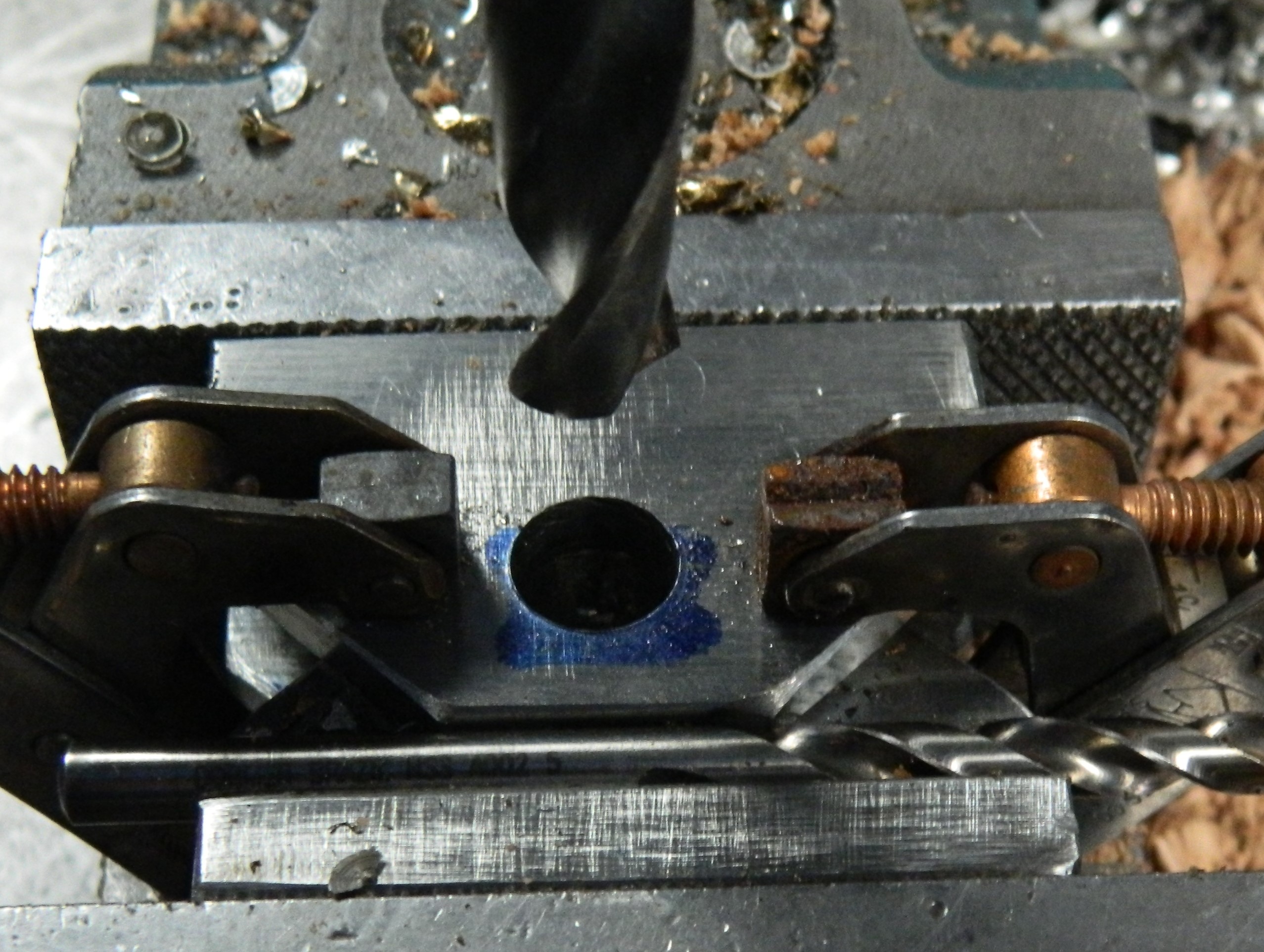

You can see the hole drilling jig and 6"/150mm rule, sitting in front of the cradle.
I used this to drill the two offset holes, to hold the Forend upright in place.
Here are the two cross pins, in place, to lock the moveable Forend upright in place.
Here's the pivoting Butt end of the cradle.
Here the original Bessa stock is in place, in the cradle.
I'll recut the recently Butchered./sanded flat factory checkering first, as a trial/practice/test, before I attempt to cut the checkering, on it's replacment stock.

Here are some additional images of the cradle parts.
I welded some 1/4" x 50mm long stainless rod, to the lock nuts on the uprights.
So this part of the cradle, is completed..............?

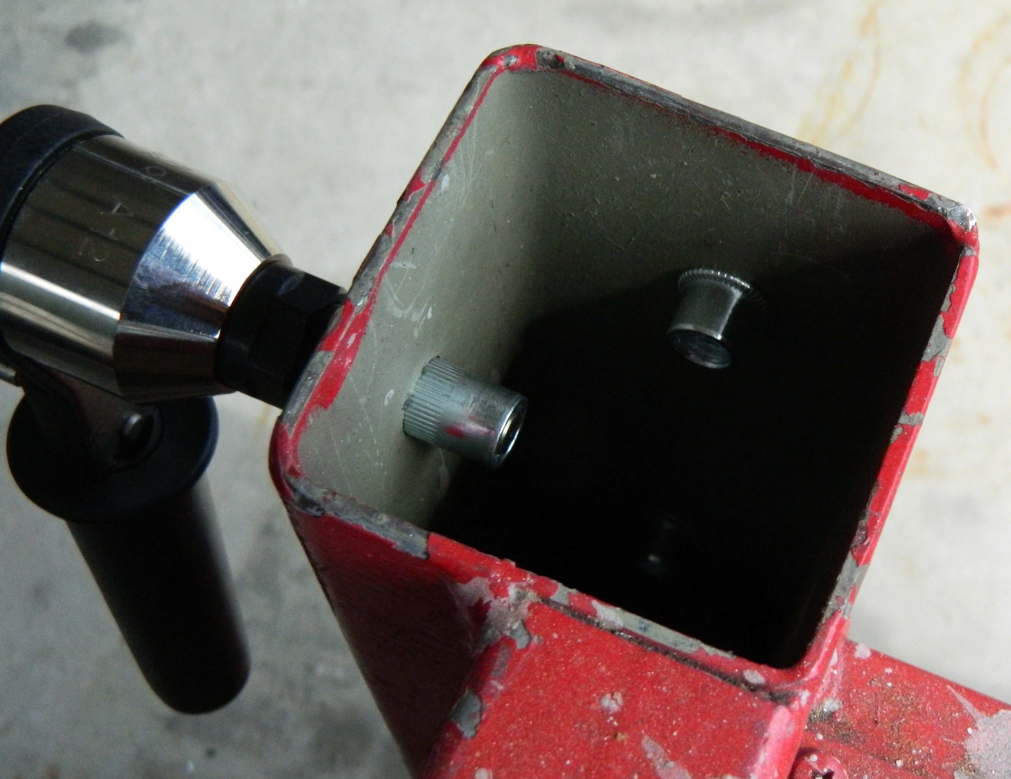

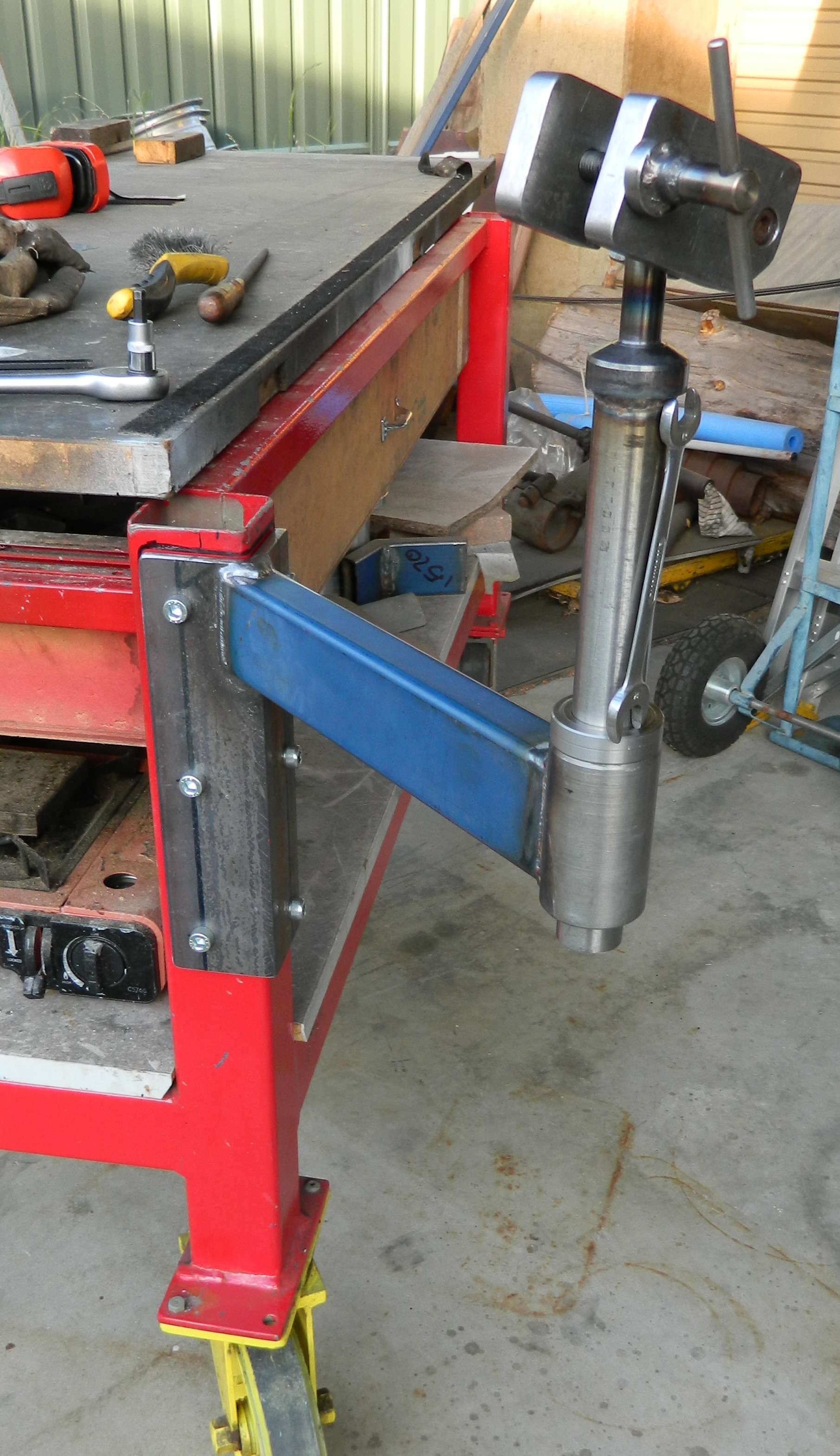

I then started to make the mounting bracket and interface, between the cradle and it's outside mounting location (my Welding Bench.
This is made from some 75 x 75 x 8mm x 300mm long, angle iron.
Here I am, drilling the 6 x holes, in the leg of the welding bench, to bolt it onto.
I then installed 6 x M10 Nutserts, into the leg of the bench, to give the M10 bolts, a better purchase.
Here is a Before (Left) and After installation (Right), of what Nutserts look like.
Here is the bush (50mm O-Dia x 85mm Long and 31.76mm I-Dia, Mild Steel), and lock ring, that the main upright pivot, fits into (and some Tig welds, worth showing).
And here is a couple of images of the mount and pivot interface, bolted in place.
The open ended spanner, is there to show/hold the pivoting part, in it's elevated position.

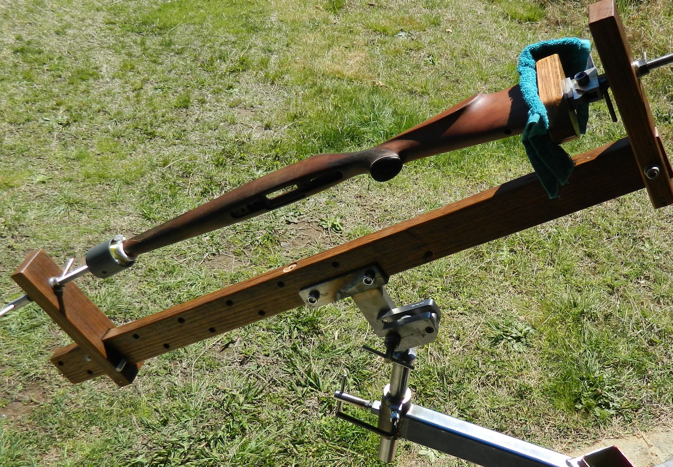

Well apart from a coat of paint on the mild steel parts, I think this project is completed.
Heres a few images of the cradle, at various angles and positions.
I hope all of the above, has been of some assistance or interest to you.
Avagreatlooongweekendeh!
Homer
