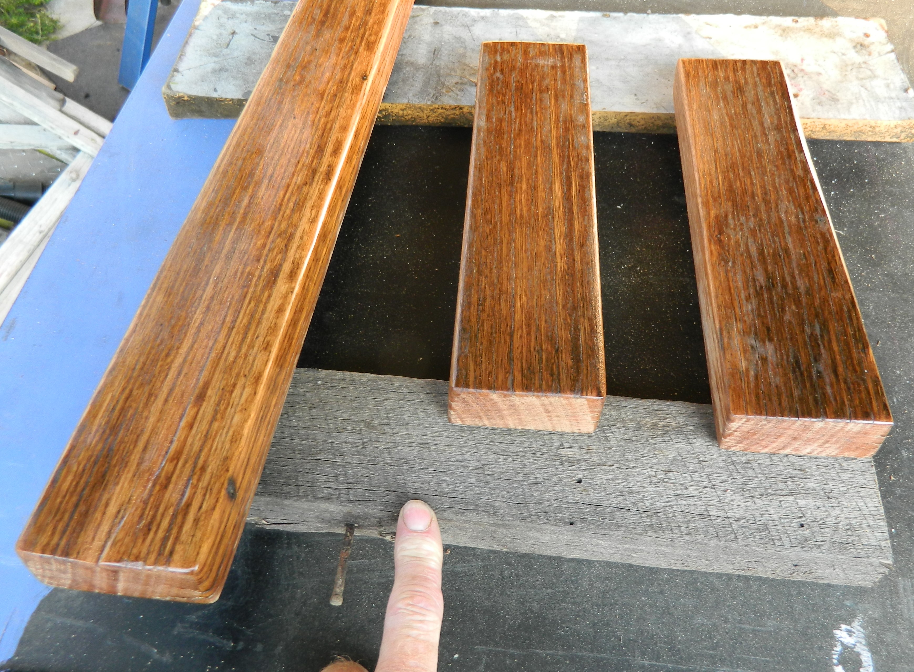

I decided to go with one made from wood, so I had a look around the backyard, and found a length of 3" x 1 1/2" Eucalyptus of some description. It used to be the bit of wood, that fence pailings are nailed onto.
I cut it into 3 lengths, and then sanded all the old and aged grey exterior wood off it, to reveal the real colour of the wood underneath.
You can see here, where my finger is resting on the old grey wood off cut (with Borer Holes and a Nail in it), and the three pieces of wood after, with a coat of timber oil on them.
- DSCN3016.JPG (1.87 MiB) Viewed 10265 times

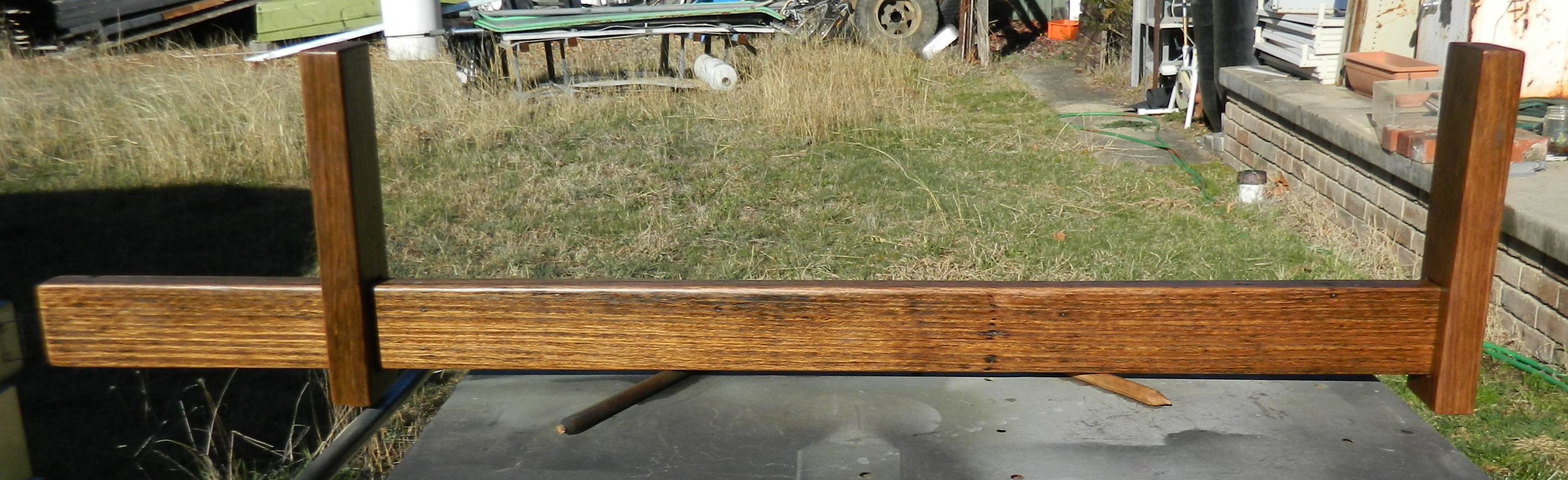

I then cut a few rectangular holes in the two short pieces, a slid them onto the long piece of wood.
- DSCN3031.JPG (899.69 KiB) Viewed 10265 times

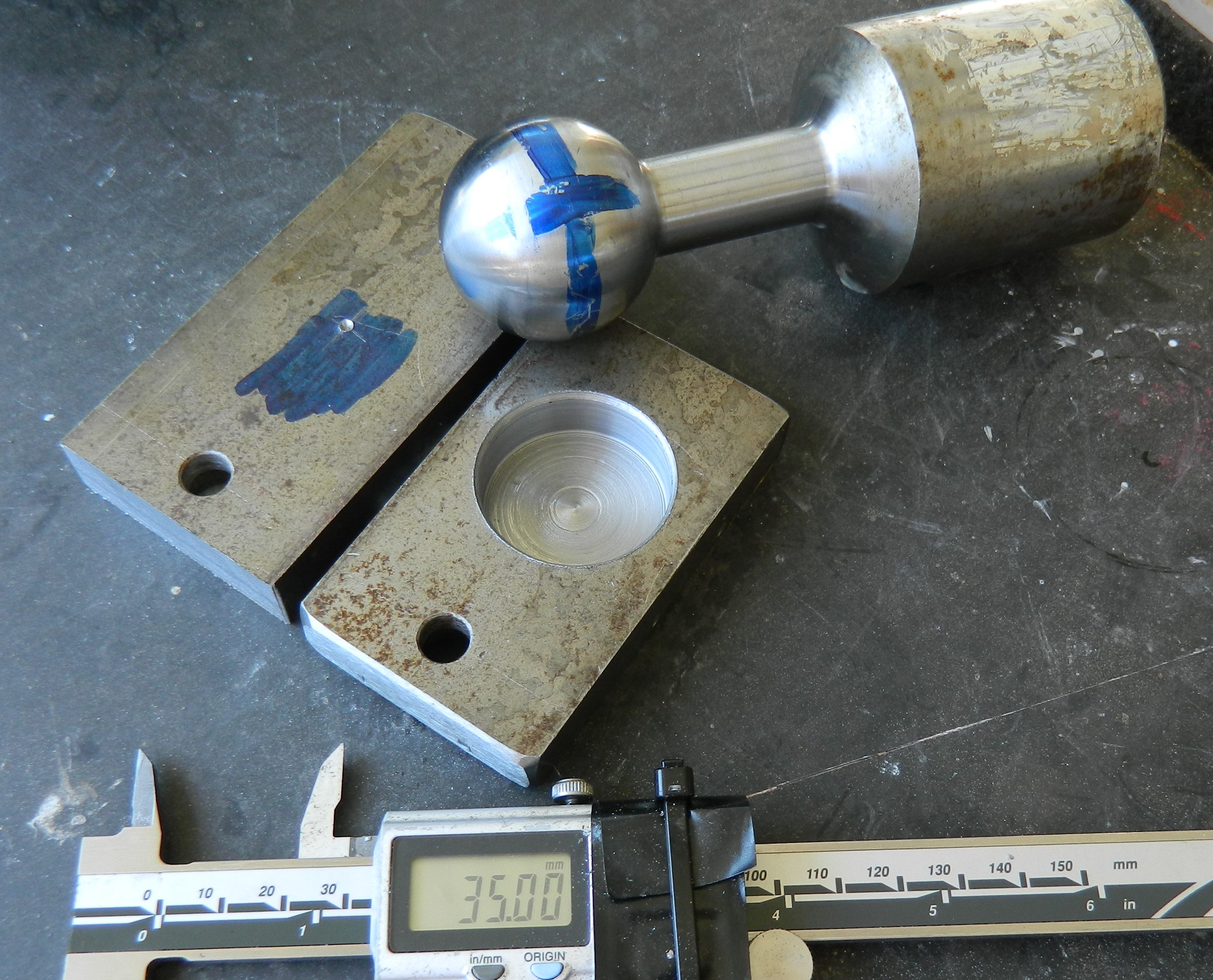

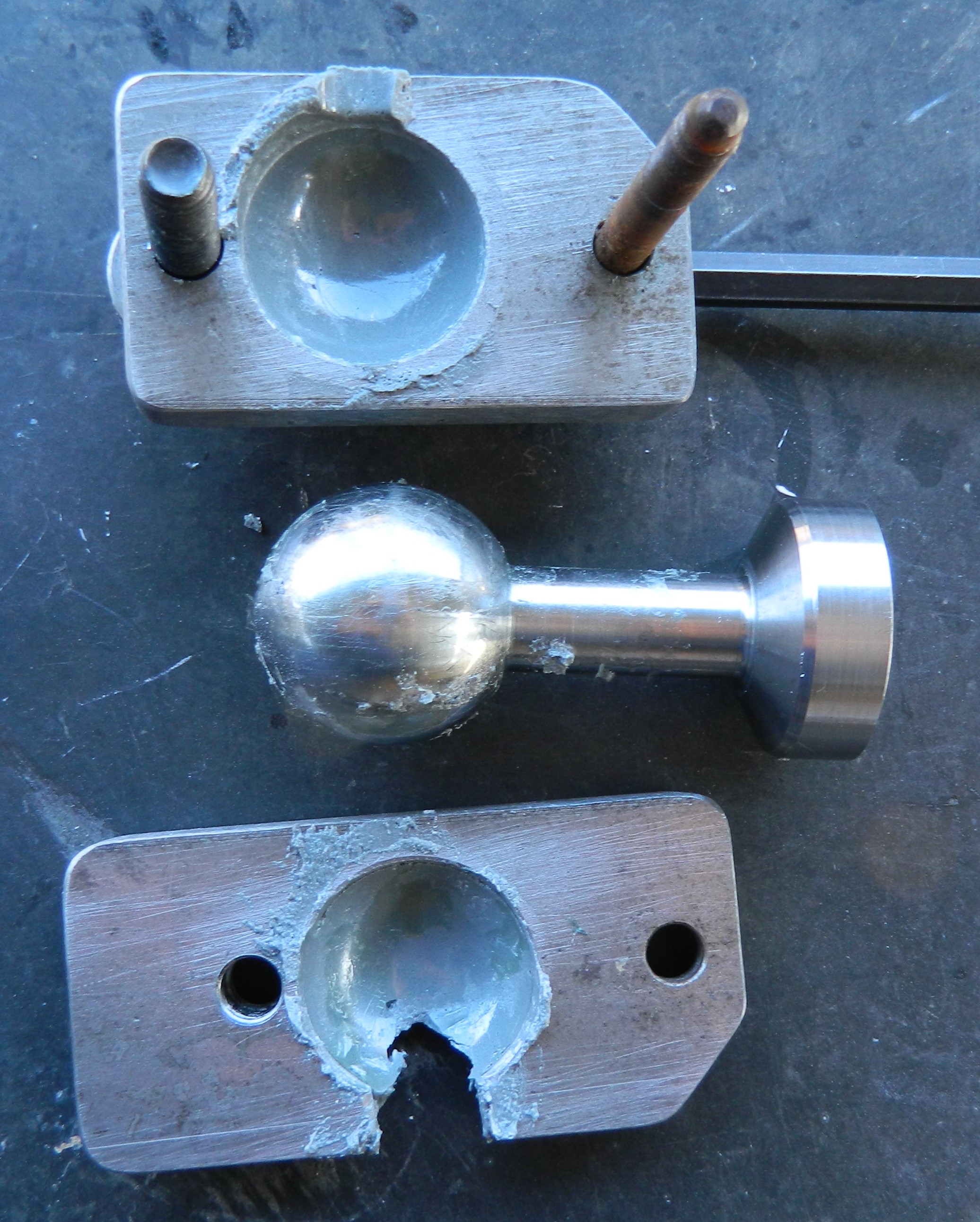

I found a 40mm Diameter ball, in the Bits & Pieces bin and made up two "Halve Cups", to go on either side of the ball.
You could do a similar thing, with an automotive/car 51mm / 2" round tow ball.
- DSCN3021.JPG (1.34 MiB) Viewed 10265 times
- DSCN3024.JPG (1.18 MiB) Viewed 10265 times
Once that was finished and a couple of extra holes were drilled, I then mixed up a batch of Epoxy resin with atomised Aluminium, and completed this part of the job.
- DSCN3030.JPG (1018.32 KiB) Viewed 10265 times
