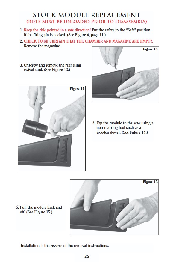

Post by bladeracer » 26 Aug 2025, 11:42 pm
Die Judicii wrote:Hi all, I’ve got a Ruger American in 22lr with the cheap and nasty plastic stock. The one that looks like its got an adjustable cheek piece and adjustable butt. Trouble is i don’t think they move at all,, or do they ?? Anybody here know if they come apart at all,, and if so, how ? I’d like to fit a butt spacer if possible because it just feels too short ( a bit like a toy gun ) Cheers,,
It's not adjustable, but you can replace it. They make two sizes, a short and long length of pull, and I think the comb height is different too. As mentioned, unscrew the sling swivel.
Screenshot 2025-08-26 234148.jpg (85.19 KiB) Viewed 13658 times

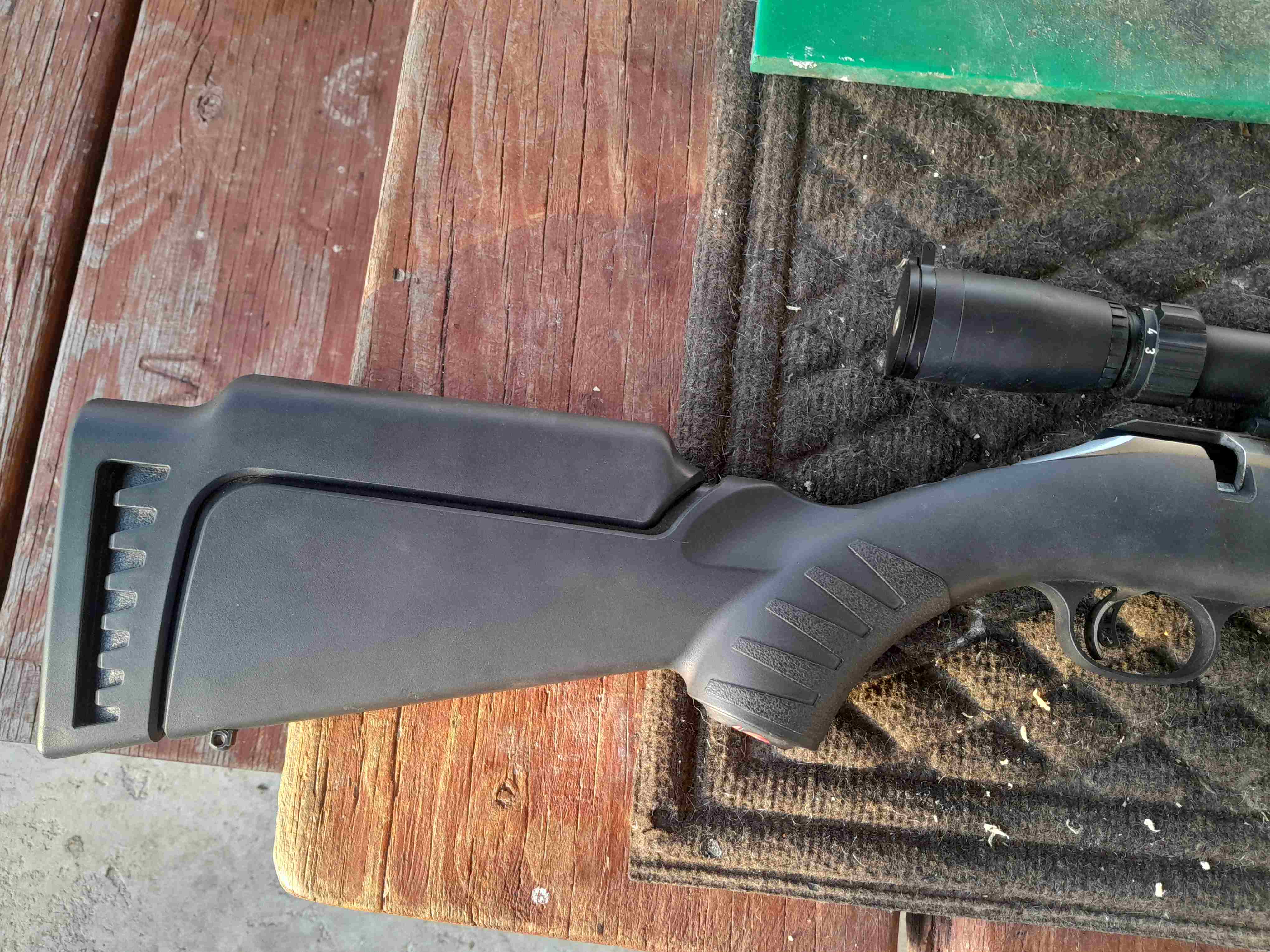

Post by Wapiti » 31 Aug 2025, 7:11 am
Mate I think Cleavers has those extra length buttstocks on their "specials" page.
Might be able to bring your 22 to a longer length, if those particular ones are available.
This is the long high comb one on my .17, it has moulded in sections in it, but it's completely solid poly. No cheap internal hollow bits in it anywhere.
The length of pull on this one is perfect for me, even with my orangutan arms.

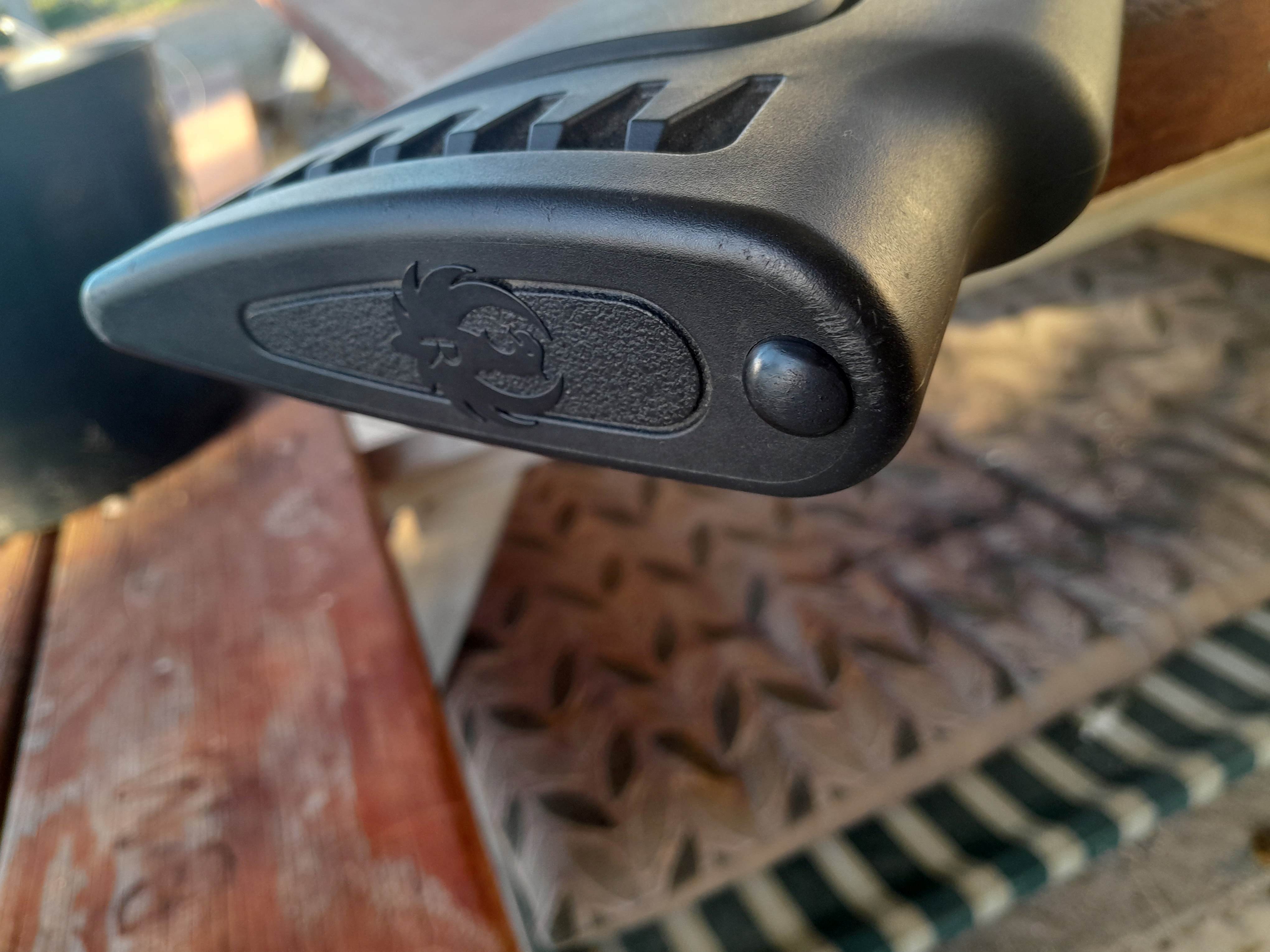

Post by Wapiti » 31 Aug 2025, 7:28 am
On my two, they have solid buttplates, I guess rubber ones aren't needed on rimfires. And all "Americans" are an economy line of rifles for Ruger after all.
But when I leaned the rifles against the shed wall or any hard slippery ground, the lack of grip cause the rifles to fall over a few times because that butt section is mega slippery. Great for quick mounting to you shoulder and won't grab clothing, but falls over.
So I used a small spade bit and this neatly drills a small hole of the correct depth into the solid butt. Into that, I polymer-sealer glued a neoprene rubber chair tip to be just sitting proud of the surface. This is dependent on the correct hole depth.
Again, this wouldn't work if the stock wasn't solid.
This stops it slipping on any surface it's leaning on.
Might seem strange to some people, who cares, "butt" this mod has made these stocks perfect for farm use. Indestructible, and with that bedding system, together with a stainless version as mine all are, can't be beaten as a farm gun that doesn't need to be pampered.
And of course they use the perfect Ruger 10/22 rotary mags, which makes all other rimfire magazines completely second-rate and cheap.
In fact you can see the scratches where it's slipped and fallen over prior to the tip installation.
