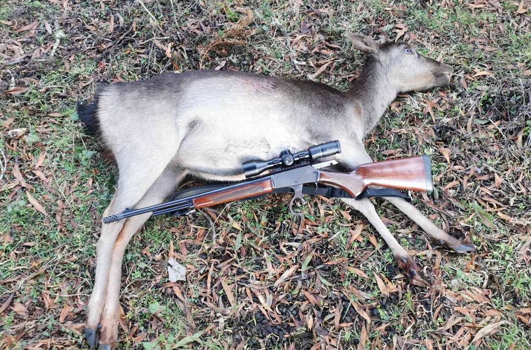

I'd like to take this thing deering.
The 160gr are dead accurate now out at 100m with an average of 2112.6.
Il just max point blank zero it and she'll be good out to 200...hopefully.

Fitted an illuminated Burris fullfield 4 because my eyes are toast and those open sights and very hard to see.
Very good scope for the price.
I actually like this gun now.
It nearly got moved on, but something told me to give it one more try.

Post by Damo300 » 20 Jul 2026, 2:57 pm
It works.
Radial break is so nice on this rifle.
It really has changed for the better.
