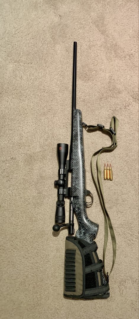

I did finish up taking my time and sanding it back a little at a time till the safety functioned. Looks like the newer HACT trigger has a different safety mechanism and my old 2010 Howa needs a bit more space.
Old Howa 308 in Carbon Stock
Howa Carbon - 308.jpg (179.84 KiB) Viewed 3360 times

Looks like my Howa 1500 (purchased in 2010) was a bit different to the current Howa 1500 offerings and the HACT trigger. Eventually got my barrelled action to fit with the safety working correctly.
