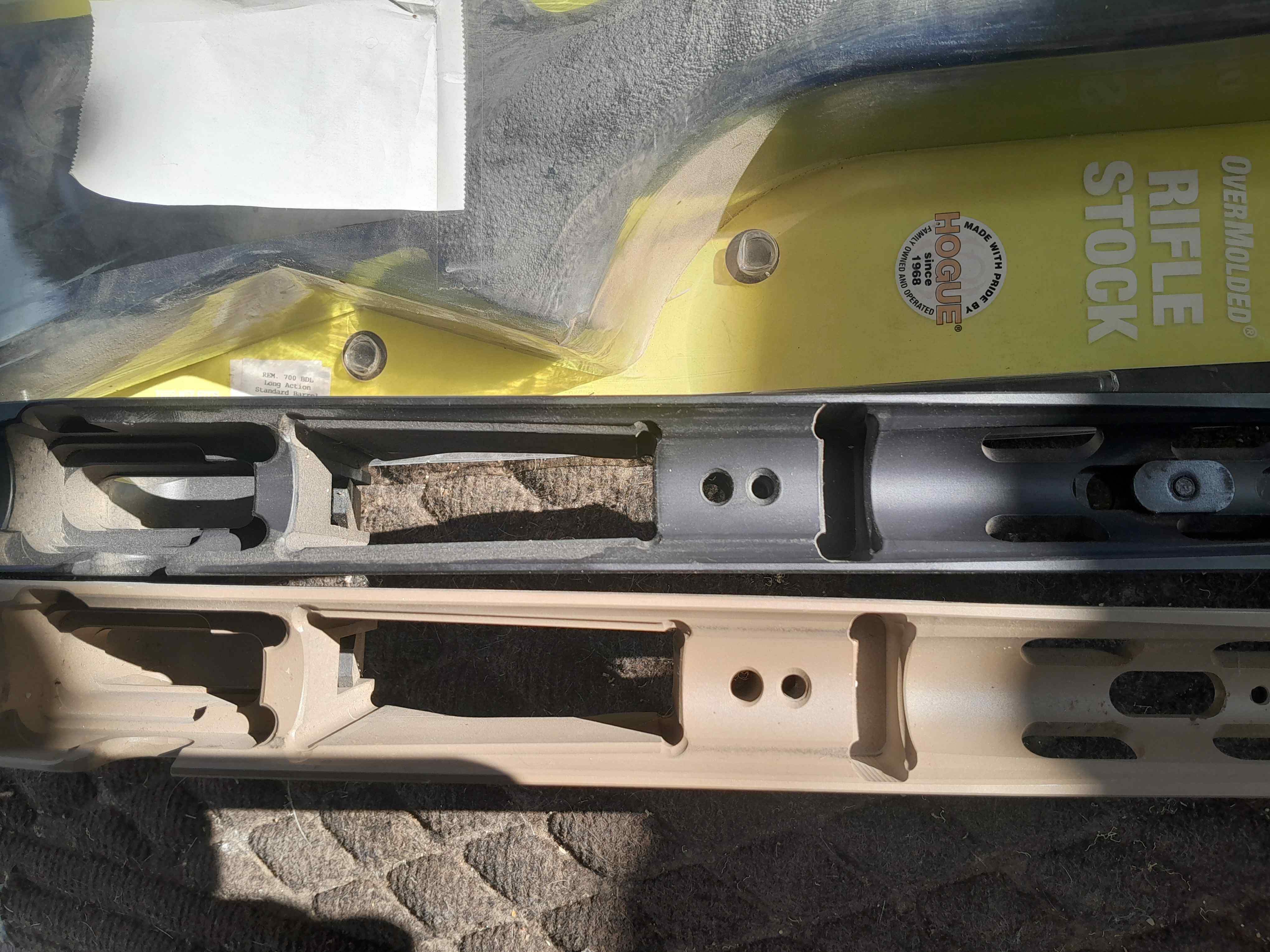

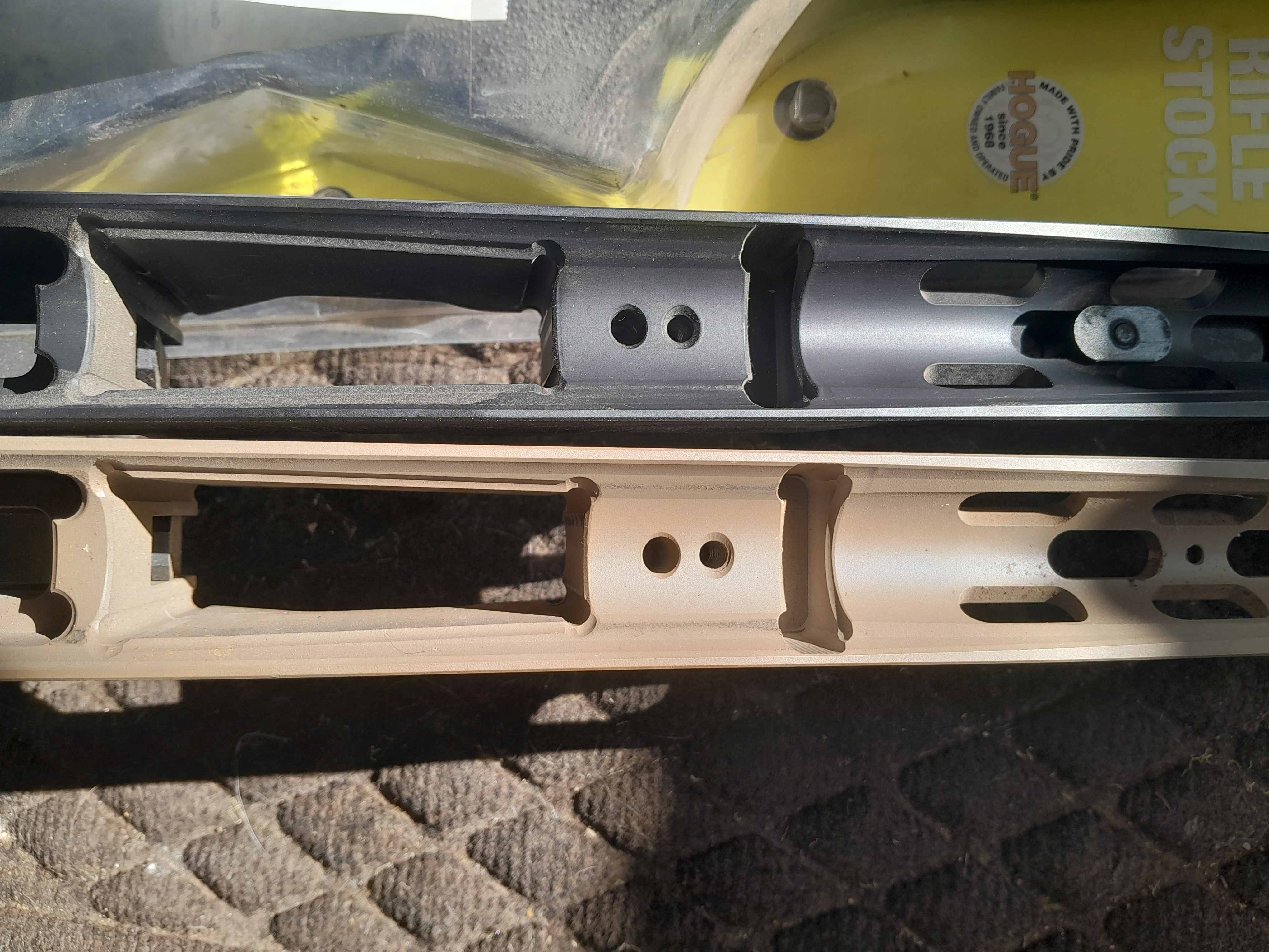

Mate I dragged out a few stocks to give you some ideas of ones you could use here.
I don't have any HS Precision stocks that aren't bolted up to rifles, I don't want to pull them to bits. But look at this Hogue.
It's a 700 LA full alloy bed stock, very stiff. A Hogue with pillar bedding is a flexible and awful, no good for this.
Edit: It doesn't look like it. but you could have a fully cylindrical Knox form out for a fair bit before it tapers down.

Post by Wapiti » 20 Jan 2026, 5:29 pm
These MDT LSS short action (308) stocks only locate the action itself and have a big margin forward of clearance for what you are after mate.
Only thing that's a bitch about these things is...
Extra $$$ for a buffer tube, butt, pistol grip, rocket launcher, 400W death ray etc that everyone needs nowadays for visual appeal.
And they point like a star picket.
2x LSS.jpg (689.76 KiB) Viewed 7977 times
Another thing too, have you heard about lapping scope rings?
Most people say, "never needed too" but they've never put a lapping bar into a set of rings with lapping paste and seen how much they twist the scope in many cases.
Well, same goes for allot bedded stocks, Often, the alloy bar has twists in it, these are pulled flat when clamped down prior to CNC machining, but then spring back again when released. The only way to tell is have a 4140 bar machined down to the exact diameter of your action, and rotate it by hand in the action to see how straight it is. When the stock is sitting bare, no stress in a cradle of some sort.
That twisting does not make for consistency, yet plenty will say, bullsh*t doesn't happen. But they haven't looked like I've described.
2x LSSb.jpg (699.62 KiB) Viewed 7977 times
Some gunsmiths have said that these stocks benefit from "skim bedding", which is where you bed your action into the alloy stock with bedding compound. All you are doing is a Frankenstein attempt to hide that slight twist, and it's just unnecessary and takes more money from your wallet.
Bedding compound is much more flexible (twist) than the thick alum block in there, and it's still twisted. The lapping bar with valve grinding paste solves that 100%.
Some people should have lstened during their machinists apprenticeship. What's that? Sorry, gunsmiths don't do that anymore?
Rain coat on....

Post by FoxSpotter » 09 Feb 2026, 12:16 pm
I'd be looking for a stock to match 22br ..which would be a 6br. And I assume short Action..
