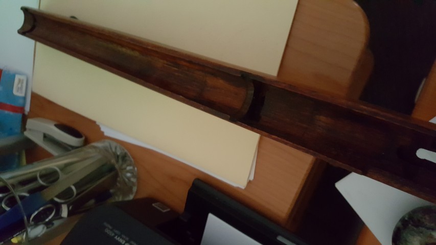

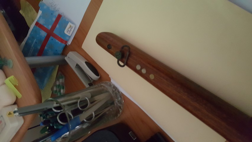

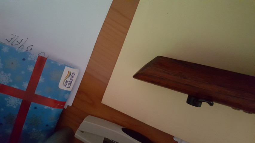

Post by Mulder030 » 01 Jul 2017, 7:40 pm
So a little update on my findings (refer photos below) after all your responses. Thank you
I firstly removed the barrel and action as curiosity got the better of me. I have never taken the stock off so was a little unsure of what to expect.
So found out that the rifle hasn't been bedded, and i could see what I believe is the contact points of the barrel and stock.
There looks to be a large section taken out where the trigger mech is very close to the rear mounting screw hole. not sure what to think about that. Does that look hacked out? is it alright?
after re-assembling I have been able to achieve the floating barrel. I would like to have the action fully bedded. It shoots well as it is, but want to try and get the most out of the old girl. then I can only blame myself for the s**t shooting. :lol:
let me know your thoughts, I could be looking straight passed something and wouldn't know it.

Post by Wm.Traynor » 02 Jul 2017, 9:34 am
Towards the end of my time with Omarks, it was usual to move the rear take-down screw to about 1/2" in front of the trigger cutout. Pillars were installed, around both t-d bolts. Do you want to spend the money? Might depend on what you paid :unknown:
Otherwise, you could bed it on Devcon, J-B Weld, fibreglass etc. Are you handy with carpenter's tools like gouges?
Important Question
Do you know how to test bedding? Reason for asking is that you could DIY. For instance, it is possible although unlikely, that the bedding might be OK, as it is. If you can test, you could save some trouble, however unlikely as pointed out.
Love a project :D

Re: Barrel Contact, seeking information
Post by Gwion » 02 Jul 2017, 1:13 pm
Looking at that inlet is giving me nightmares and making my OCBD twitchy (obsessive compulsive bedding disorder)! :lol:
If you lived near by i'd happily do the bedding for you because i have all the gear but it's a long swim to Tassy. Pillars wouldn't go astray, either.
Not all bedding jobs are equal, by the way.
Check this site out for more info on bedding: http://www.ballisticstudies.com/Knowledgebase.html
Nathan's videos are very informative.
